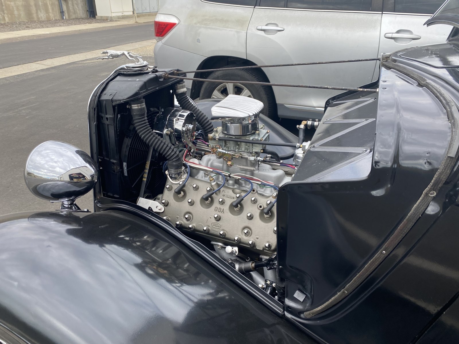

  4. 33Doll
    Joined: Sep 27, 2019
    Posts: 1,591
    33Doll
    Just got lucky with a better quality aftermarket
    Kit, never did find out what country of origin it was made in, but I compared it to the old one in some of my previous posts.
    Now the other issues are still there.
    Popping out of second, and rubbing in neutral on something once in awhile. I’m just gonna take it apart this winter again!!!!
    And change the whole synchro ***embly, AGAIN and maybe a few gears to see what the hell is going on. It’s a mystery at this point??

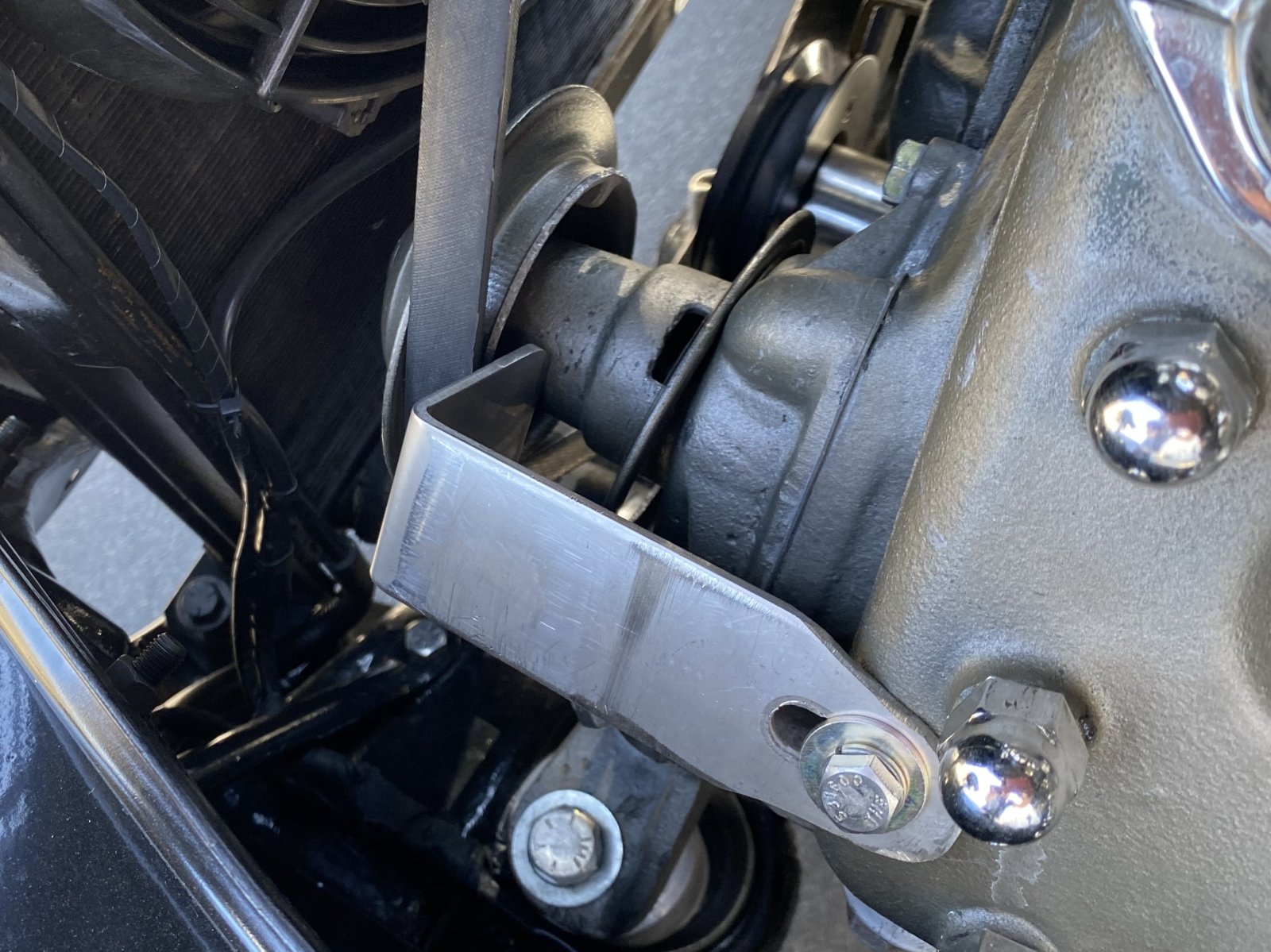

    My redneck pulley braces, working fine though!!!
    Ha!!!

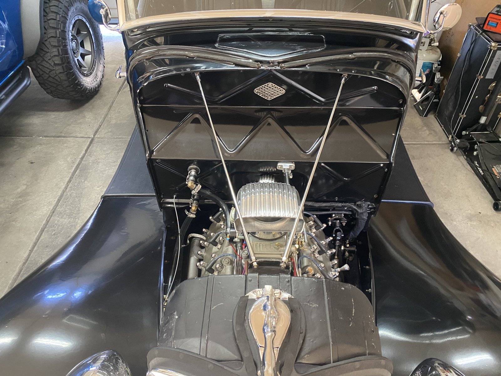

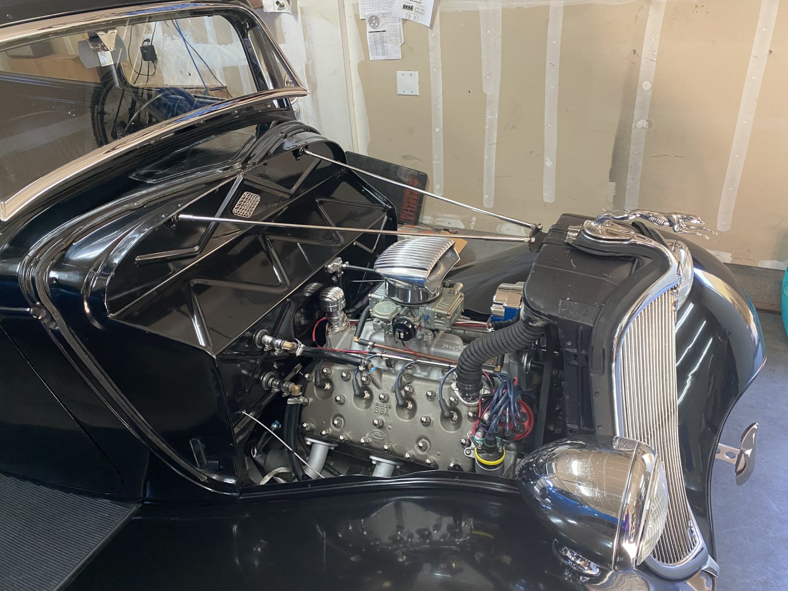

    IMG_3406.jpeg IMG_3407.jpeg I had the top part on, but it hid my cool Cal-Custom style Scoop, and the Flatty.
    I haven’t painted the Sides yet.
    here, put my stainless Support rods on.
    It’s more hood-off-normal-mode now!

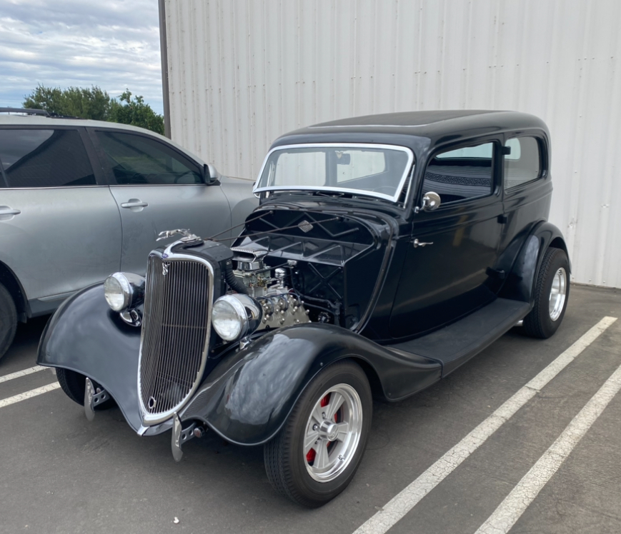

    IMG_3907.jpeg IMG_3906.jpeg IMG_4111.jpeg IMG_4022.jpeg Hey Guys!
    Been awhile! I have been busy with life stuff.
    And trying to sort out the Darn Electronic issues with the Doll! Bought another module for the Unilite and it Fried! Had to get towed this time! I thought the carburetor was the issue at first because it felt like it was starving for fuel. So I tore it apart could not find anything wrong with it. Except someone put size 62 jets in the 390 Holley!
    (Supposed to be 51 jets)
    Bought a new kit and also put 54 jets in. Figured, with the block being.060 over, headers, Holley 4-barrel and hotter Ignition. Plus it might have a mild cam, and it has adjustable lifters. 54 would be a good happy place.
    I also bought a new pertronix distributor
    And it was to huge, and couldn’t get it to work!
    Sooo…. I am losing my mind!
    I need some advice. I am Getting so Tired of the Chinese sensitive electiontronic parts!
    I found a guy who rebuilds stock distributors, with NOS parts, and Points.
    Sooooo.
    Heres what I am thinking
    They say 3.0 ohms is perfect balance with points
    I have a flamethrower 1.5 ohm Coil
    And read, that a 1.5 ohm ballast resistor is right
    What do you all think?
    Old School Simple? Points Distributor?

    IMG_4170.jpeg IMG_4156.jpeg IMG_4152.jpeg IMG_4151.jpeg IMG_4148.jpeg Well, after doing some investigating checking out some of you guys’s ideas, I decided to just do everything over again with what I got.
    I bought all the proper brand stuff, looked into problems with the alternator, spiking, issues like that. Bought a low cut-in regulator to help (mine kicks in at 1500 rpm’s, so when you stab the pedal, it just turns on suddenly, and watch the needle on the gauge go bam up, checked the rectifier, was good. So maybe with a 880 rpm cut-in maybe it won’t be so wonky?
    Also with the filter, and ballast it might be a lot calmer???
    Dunno?
    I also decided I didn’t like the Bubba style Chevy distributor. The cap is too darn big and Pertronix distributor has the same style cap but is 3 inches taller, so I had to send it back, also looked into a factory stock rebuilt distributor. Everybody says that the vacuum advance ****s, including my Pops, I thought well maybe I could just put a Pertronix conversion kit in a stock distributor because that seems to work well sometimes, but I figure this way at least everything is addressed from both sides with the common voltage/electric issues.
    I might get A stock distributor just as back up to keep with me so I can swap it out on the road if it breaks again!!!!
