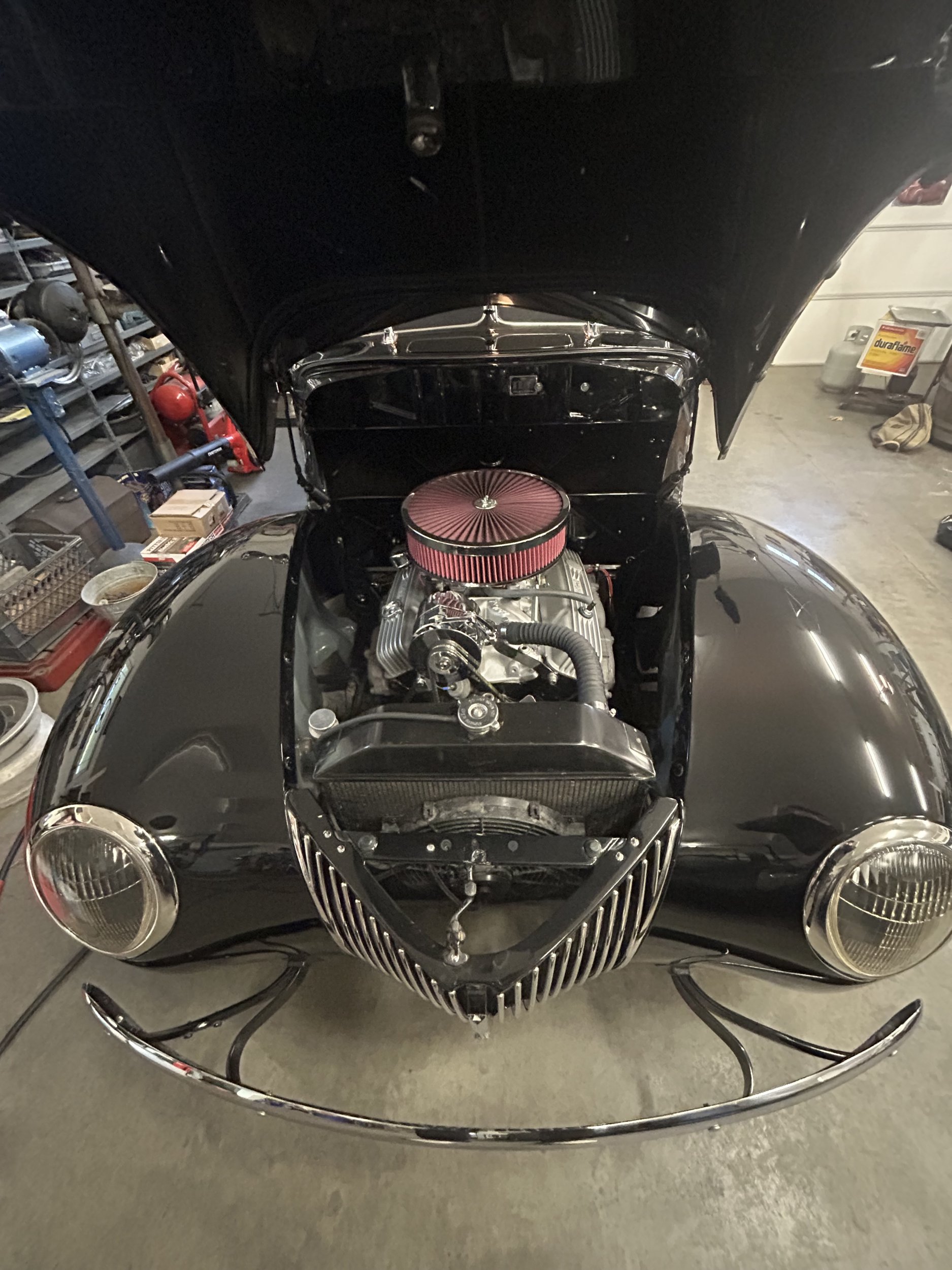

    33Doll

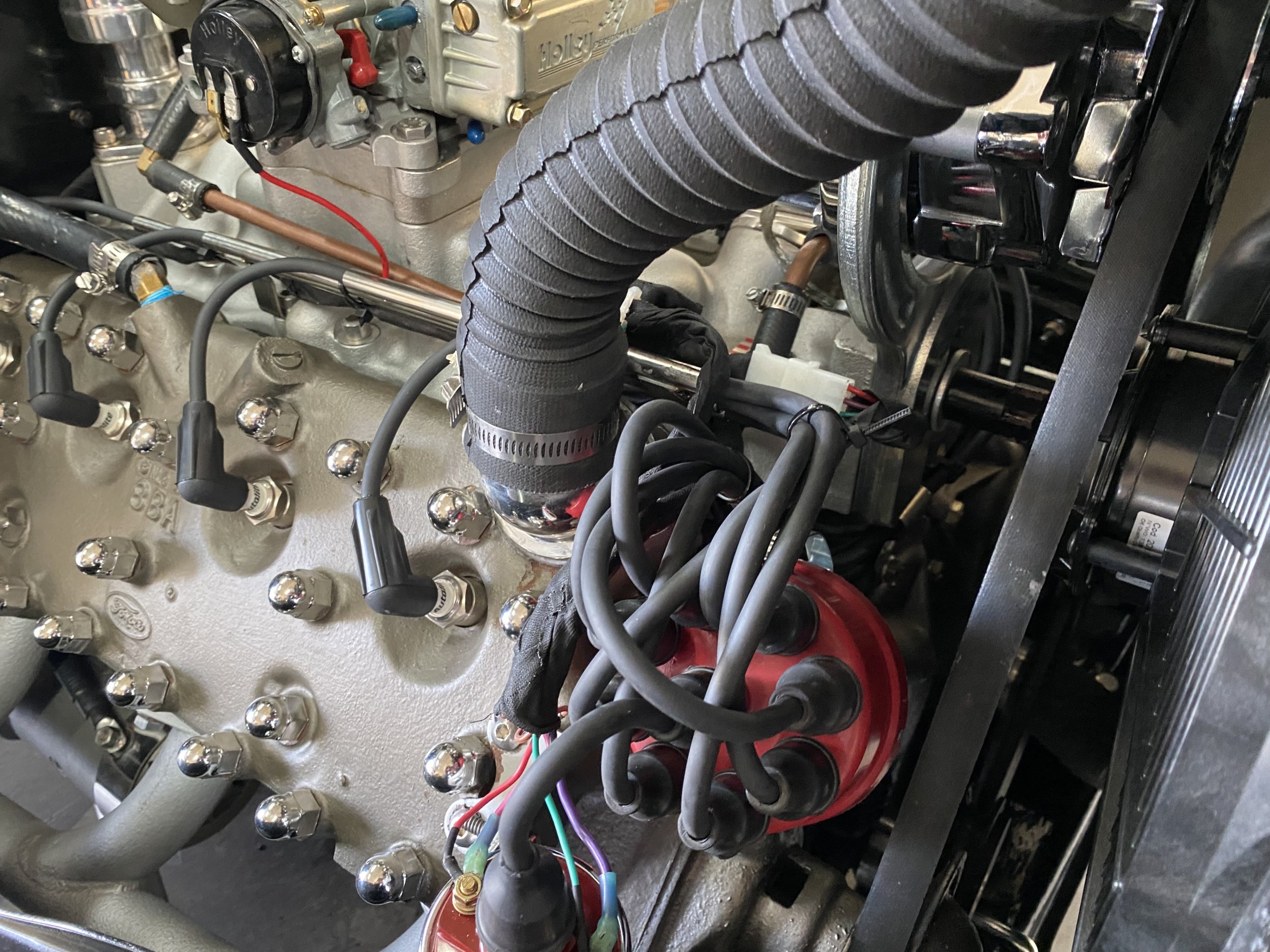

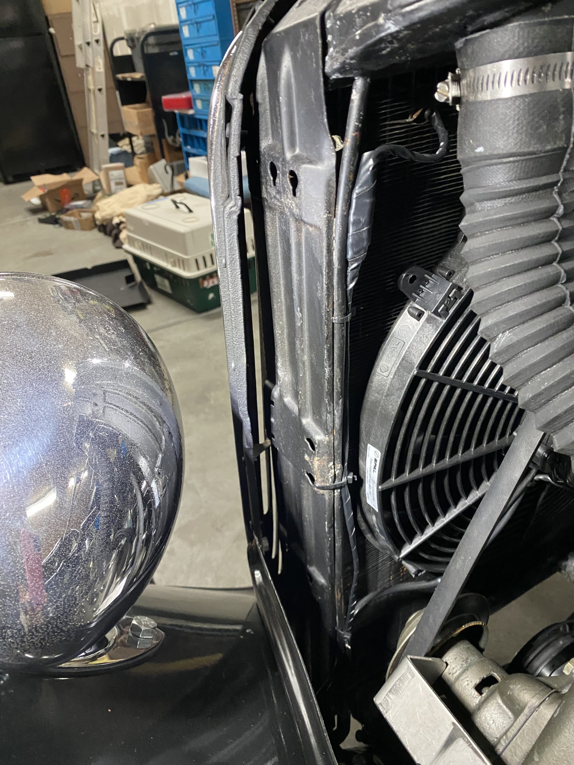

    IMG_4196.jpeg IMG_4199.jpeg IMG_4200.jpeg IMG_4201.jpeg IMG_4197.jpeg IMG_4198.jpeg Welp!!
    Got her going again! All Mallory parts this time!!!
    -New Low cut-in 1 wire internal Regulator
    (Seems way more stable, and a consistent 14.8v when it kicks on, somewhere around 1200 maybe now? No tac. )
    -Mallory Circuit protector ( hid behind radiator hose in black GM wire loom tape)
    -New Accel/Mallory E-Spark Module. (Actually manufactured in 2023, so no old style.).
    -An actual 1.4 ohm Mallory coil!
    -And actual Mallory 0.8 ohm ballast resistor!
    -New Pertronix Cut to fit Wires
    -437 Autolite 8N Tractor plugs.( slightly more electrode sticking out.)
    So far it’s been running good, just has a stumble off idle which I think it’s the 54 jets are too small. It had 62s in it which was really rich it called for 51’s, in a 390 Holley, (which I cant see it running at all?). so I’m gonna put 59s in it and readjust accelerator arm pump to .015 and see what happens!
    All in all,
    I still don’t trust it though so I’m gonna probably drive less than 5 miles around my neighborhood for a month or two in case I have to use AAA lol!!!!

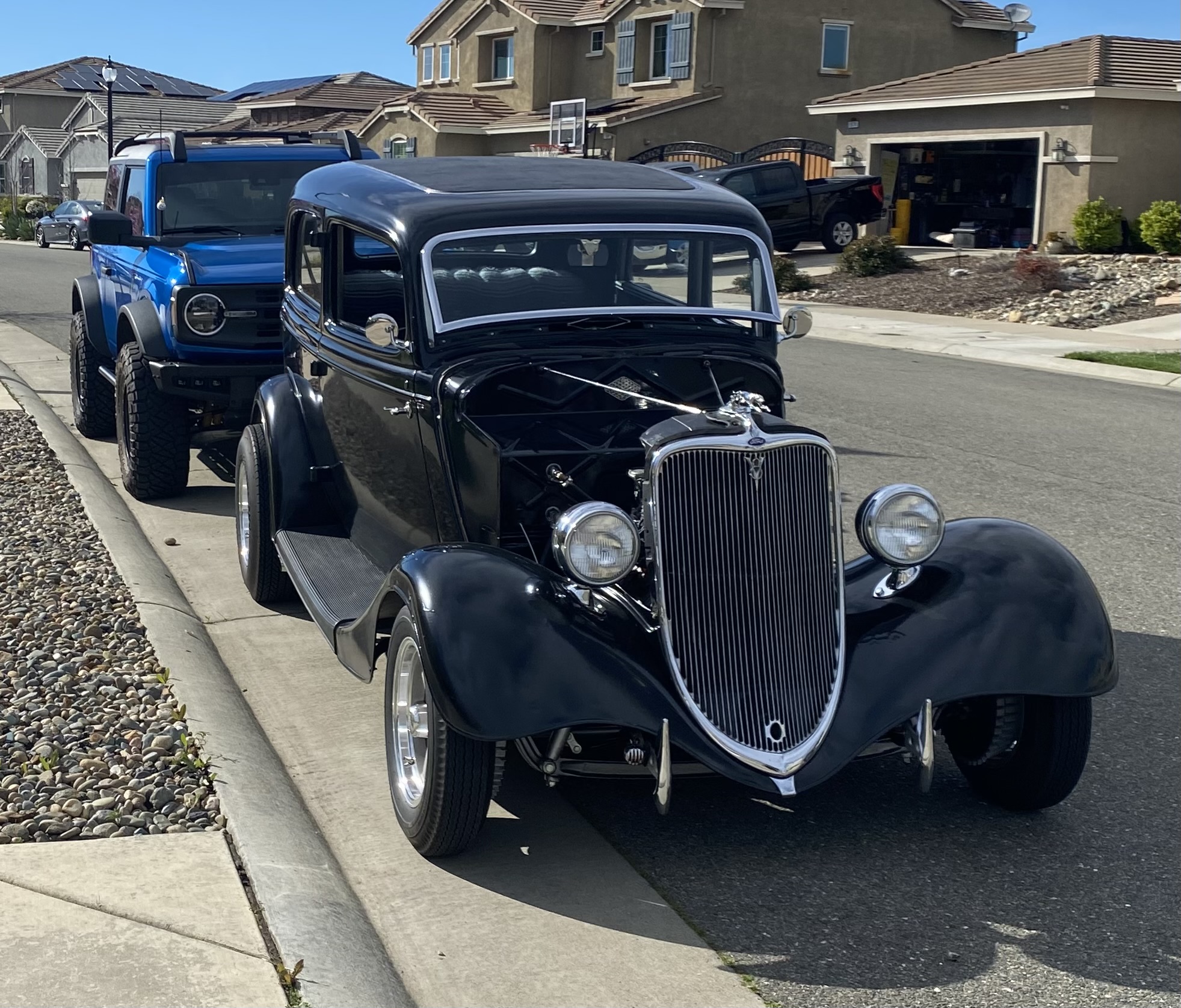

    IMG_4282.jpeg IMG_4280.jpeg IMG_4281.jpeg IMG_4283.jpeg IMG_4284.jpeg IMG_4285.jpeg Well my 33 front end is really narrow so I have no room for an overflow tank so last year I put a mustard bottle on the frame rail and it kind of works until it flipped over and dumps out so now I use my sewer plant plumbing skills and made a little overflow tank With a burp valve on top and a polyurethane line on the inside, going to the bottom with a little fluid there so it ****s it like a late model. I don’t know if it’ll work, but we’ll see !

    Been venturing out a little further around town
    I think the electrical issues are solved!
    Wife still won’t let me drive it to work yet.
    After the 200$ tow bill last time!
    Couple more weekends less than the Tripple A 5 mile radius !!! Lol! Neighbors are sick of me driving around in circles around the block!!

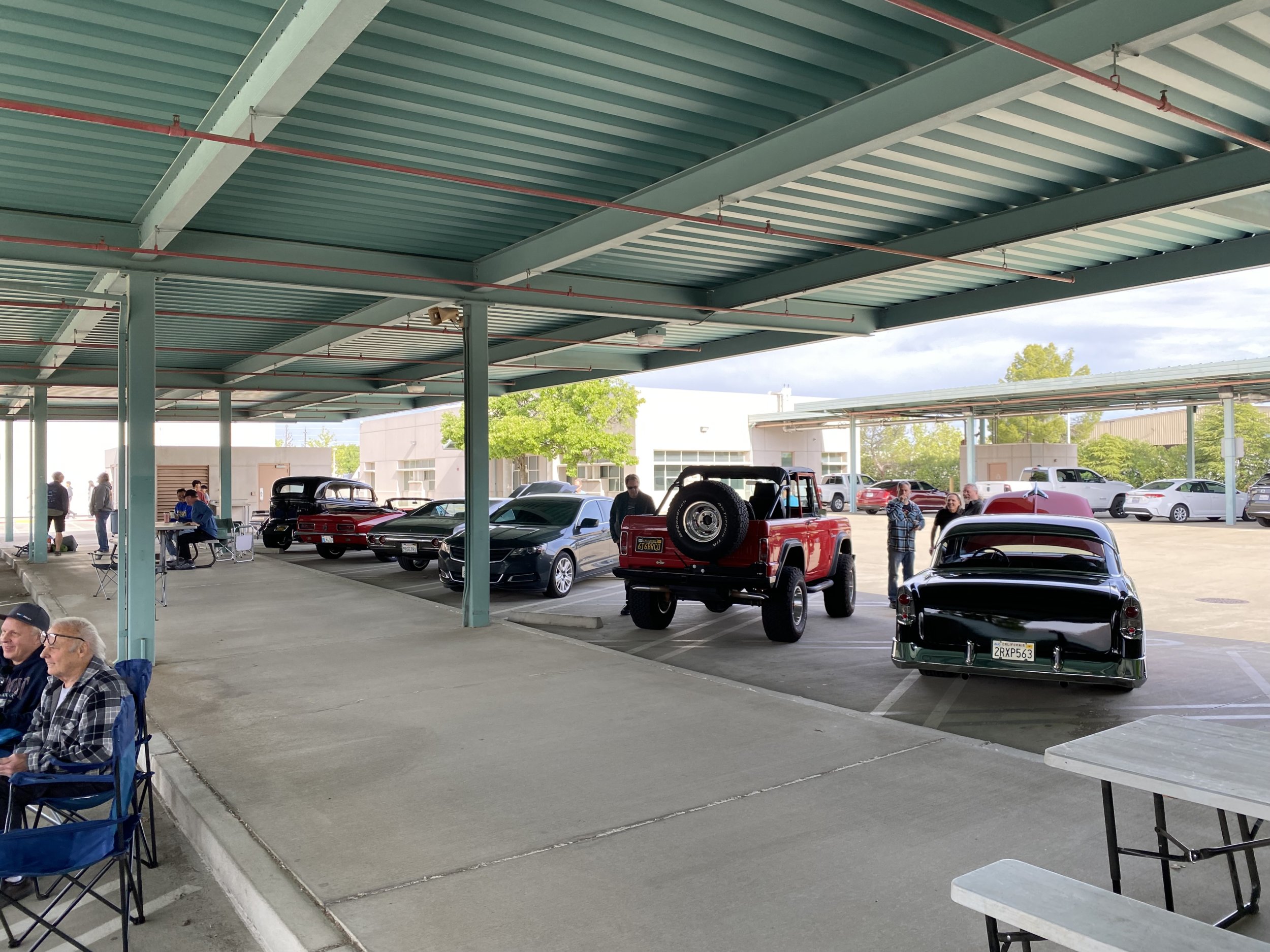

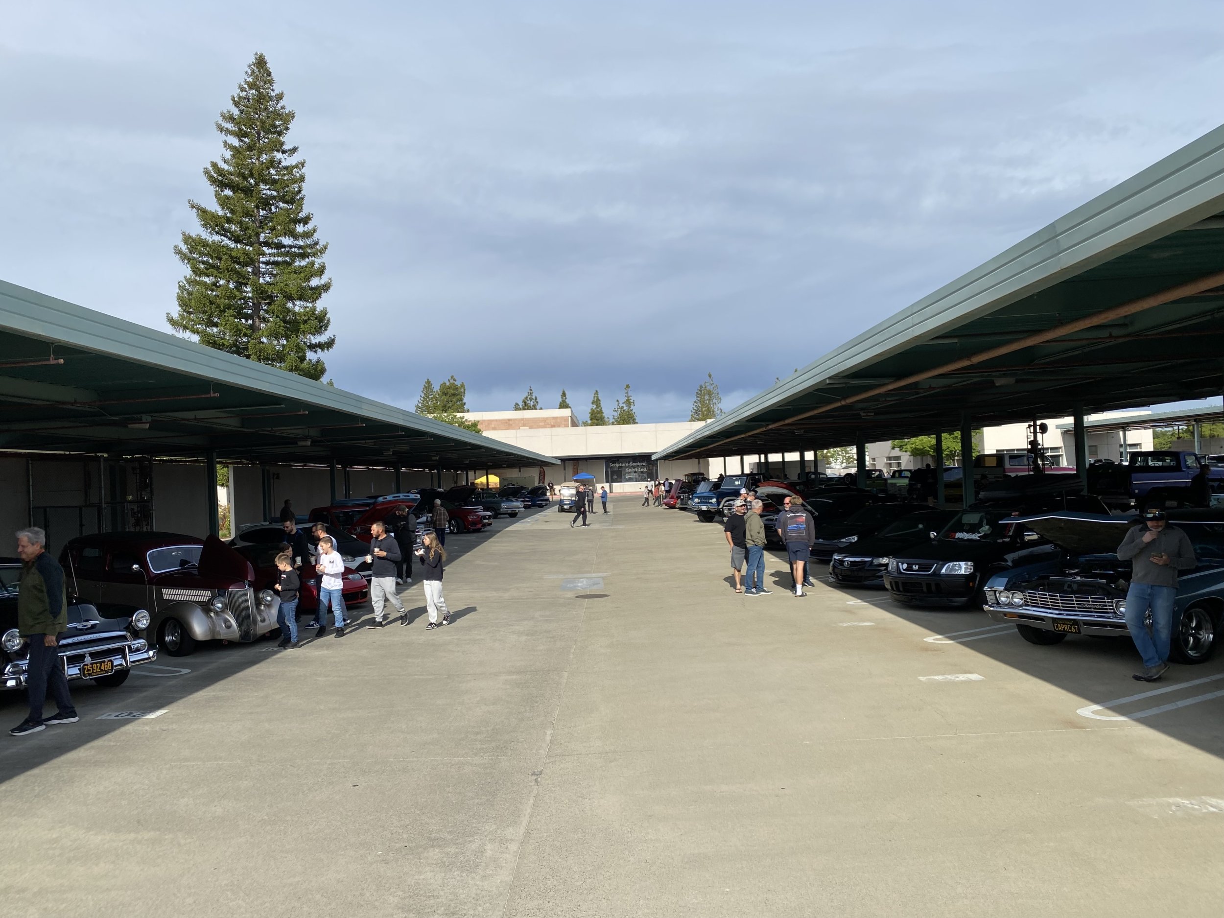

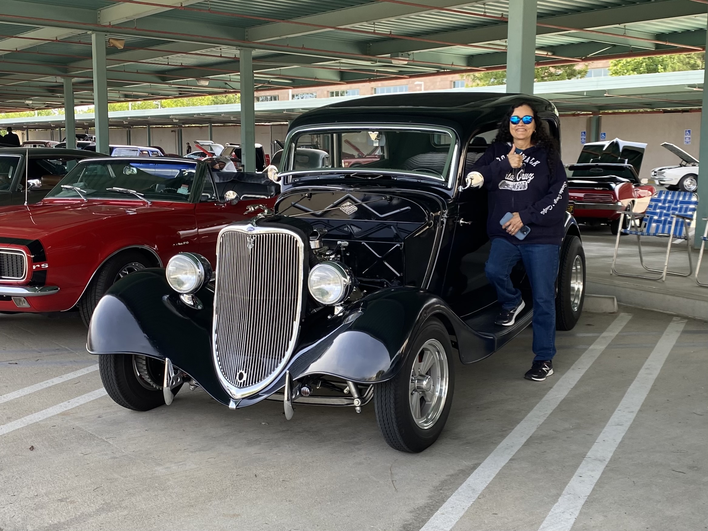

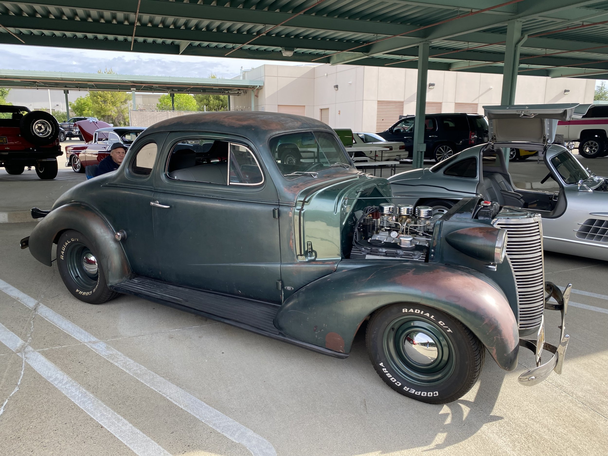

    Cars And Coffee Bridgeway Church
    Rocklin Ca.
    Surprised how many.
    Not enough 30-40-50s though…
    IMG_4573.jpeg IMG_4572.jpeg IMG_4569.jpeg IMG_4565.jpeg IMG_4552.jpeg IMG_4553.jpeg IMG_4548.jpeg IMG_4543.jpeg IMG_4542.jpeg IMG_4537.jpeg IMG_4535.jpeg IMG_4536.jpeg IMG_4527.jpeg IMG_4526.jpeg IMG_4515.jpeg IMG_4559.jpeg IMG_4562.jpeg IMG_4560.jpeg IMG_4557.jpeg IMG_4538.jpeg

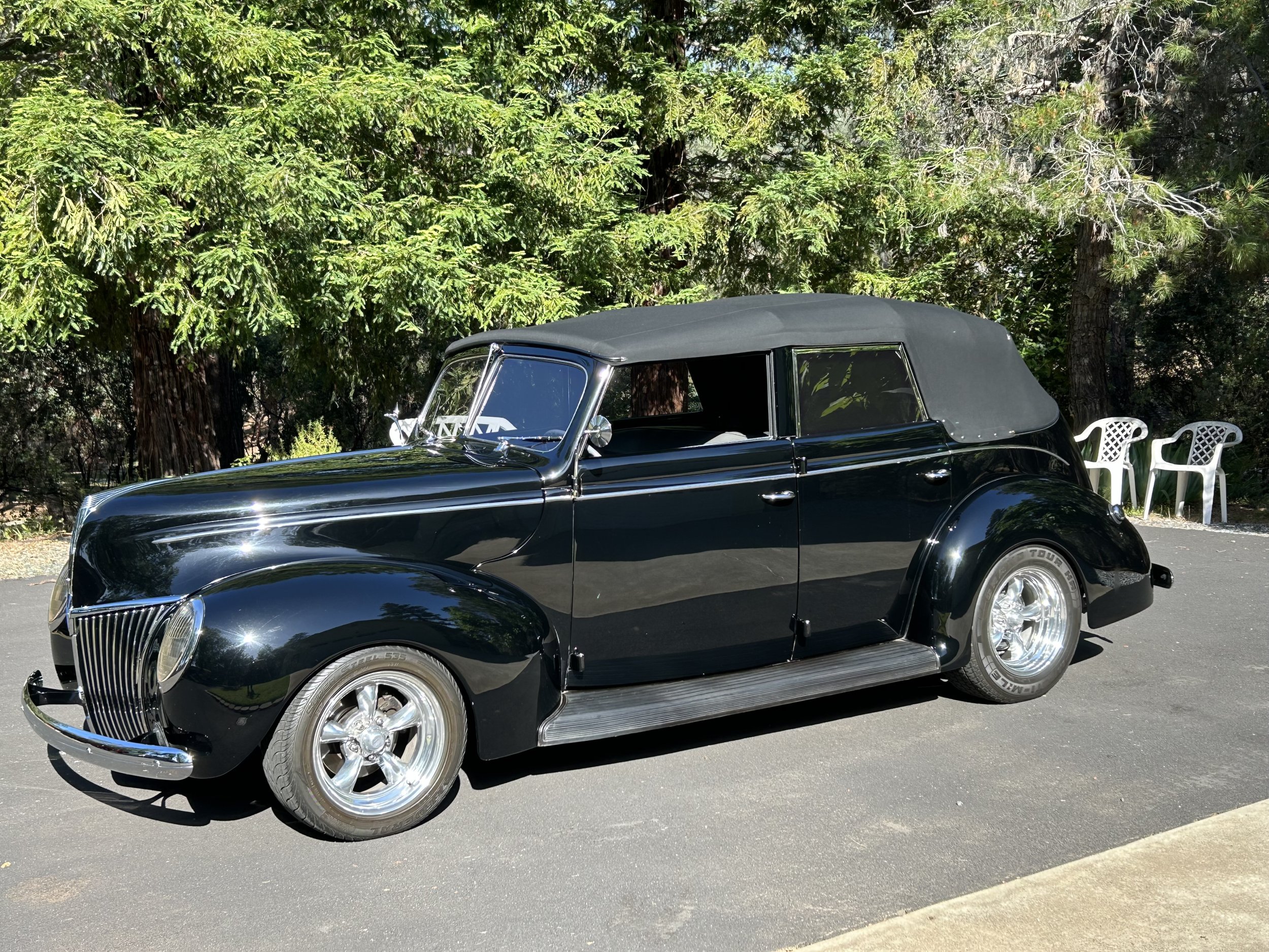

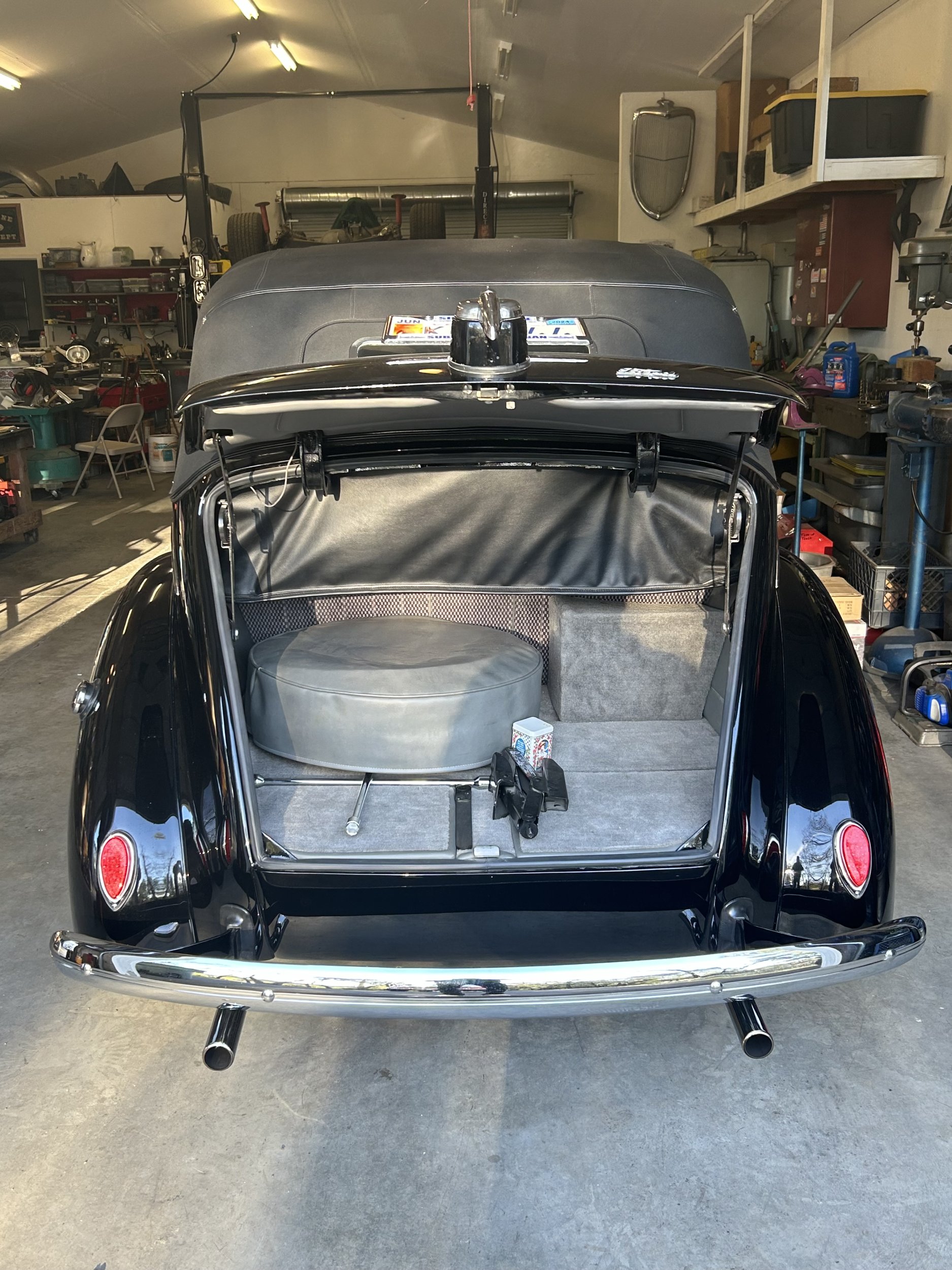

    IMG_0980.jpeg IMG_0979.jpeg IMG_0977.jpeg IMG_0976.jpeg IMG_0975.jpeg IMG_1056.jpeg IMG_1057.jpeg Hey Guys!
    My Pops Health is deteriorating fast, his Heart is slowly Getting worse… he is wanting me to sell more of his stuff.
    I was reading the Cl***ified Rules
    And Couldn’t tell if it is Traditional Rods only?
    Or are Resto-rods, and Street rods ok also?
    My Pops wants me Help sell his Ultra Rare 4-door Convertible 39’ Sedan It is Stock bodied, but 350-350 Aftermarket Ch***is Etc.

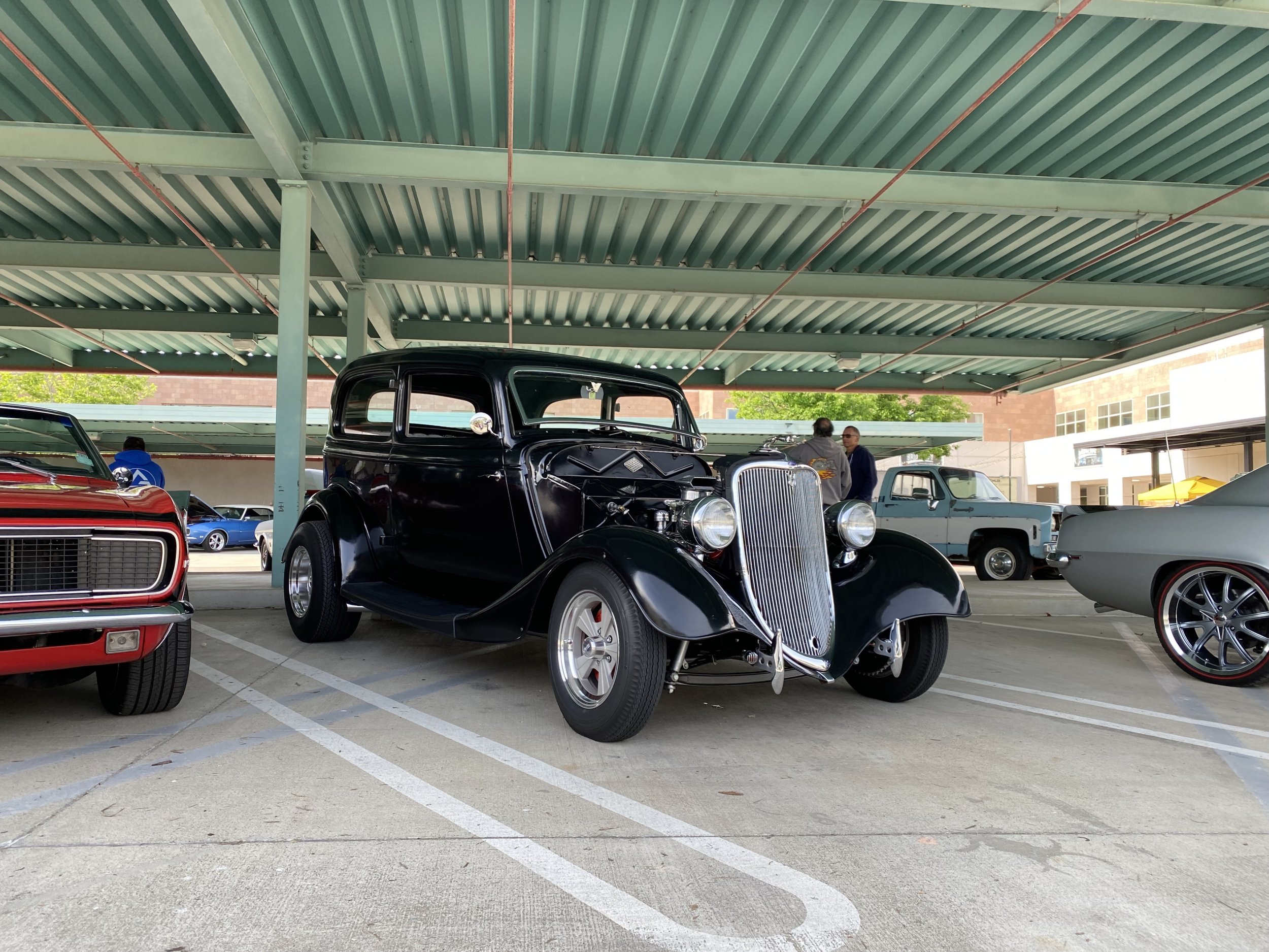

    Well been awhile Folks!
    Happy Holidays!
    the 33 has been doing great. I drive it to work
    At least once a week when it’s not raining.

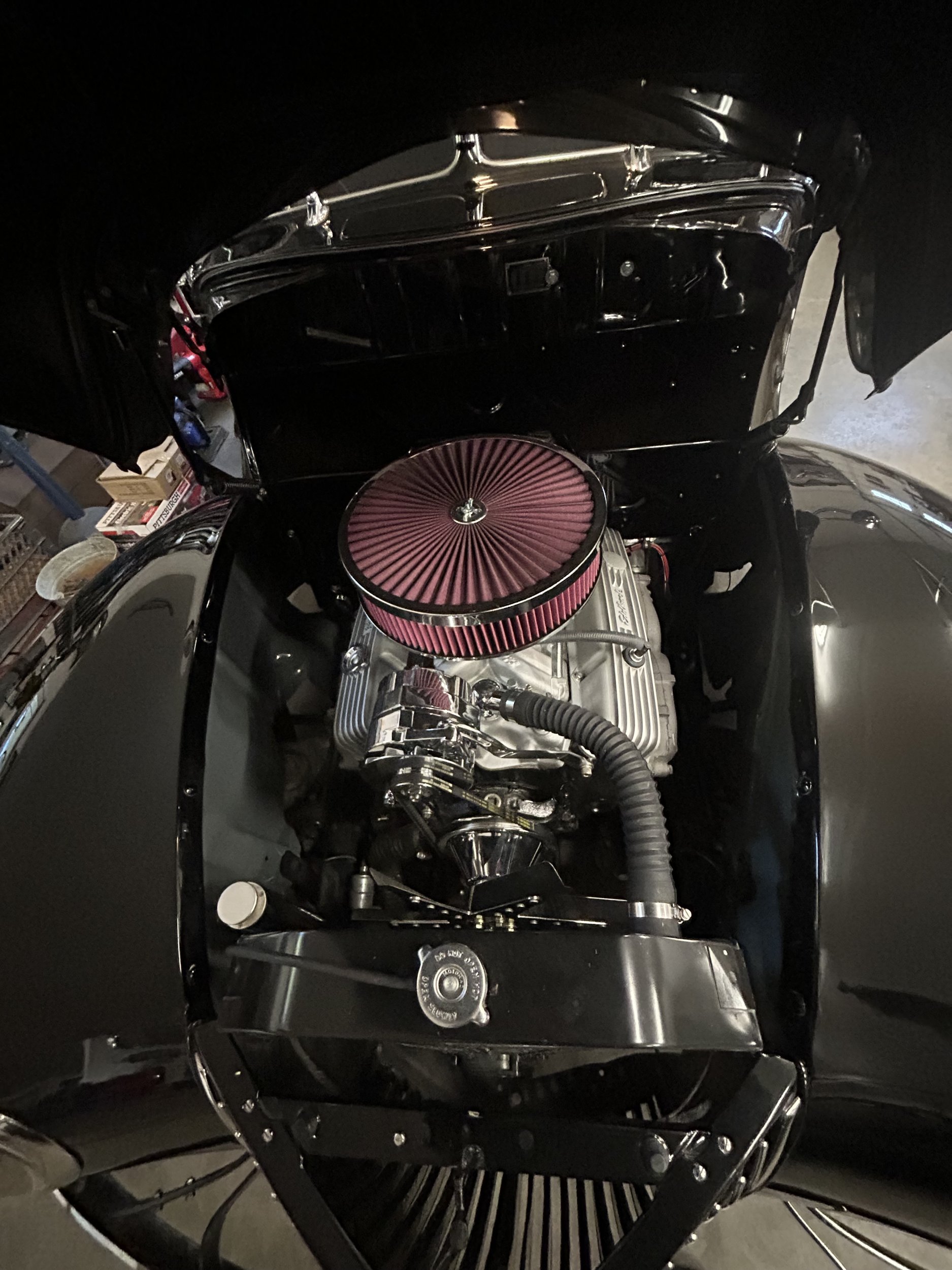

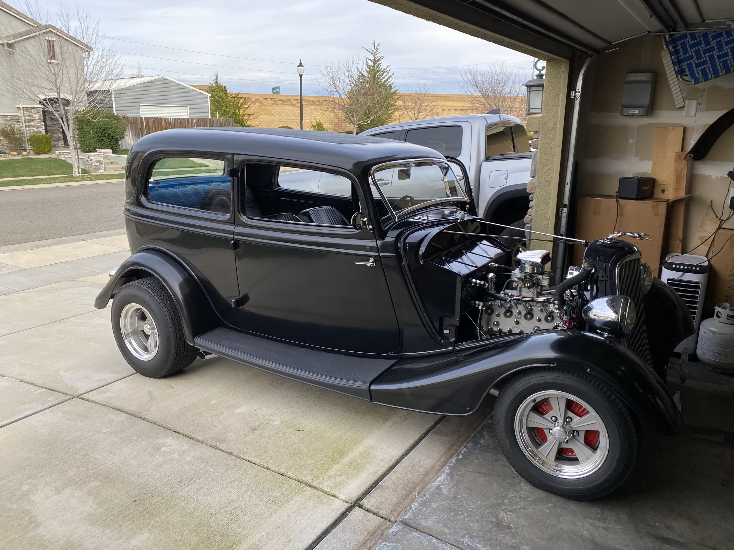

    Finally painted the Last 2 pieces, the hood sides. And Put the whole hood together, and on with all new rubber bumpers, and seals.
    Hated to cover that beautiful Flathead!
    But it looks Complete now!!! IMG_5512.jpeg IMG_5513.jpeg IMG_5514.jpeg IMG_5515.jpeg IMG_5519.jpeg IMG_5520.jpeg IMG_5521.jpeg IMG_5522.jpeg IMG_5523.jpeg IMG_5524.jpeg IMG_5525.jpeg
