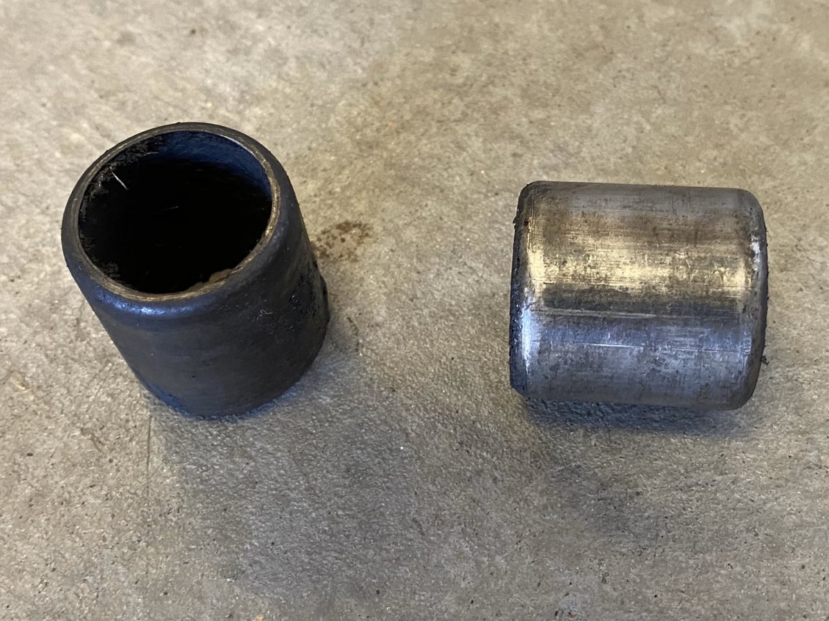

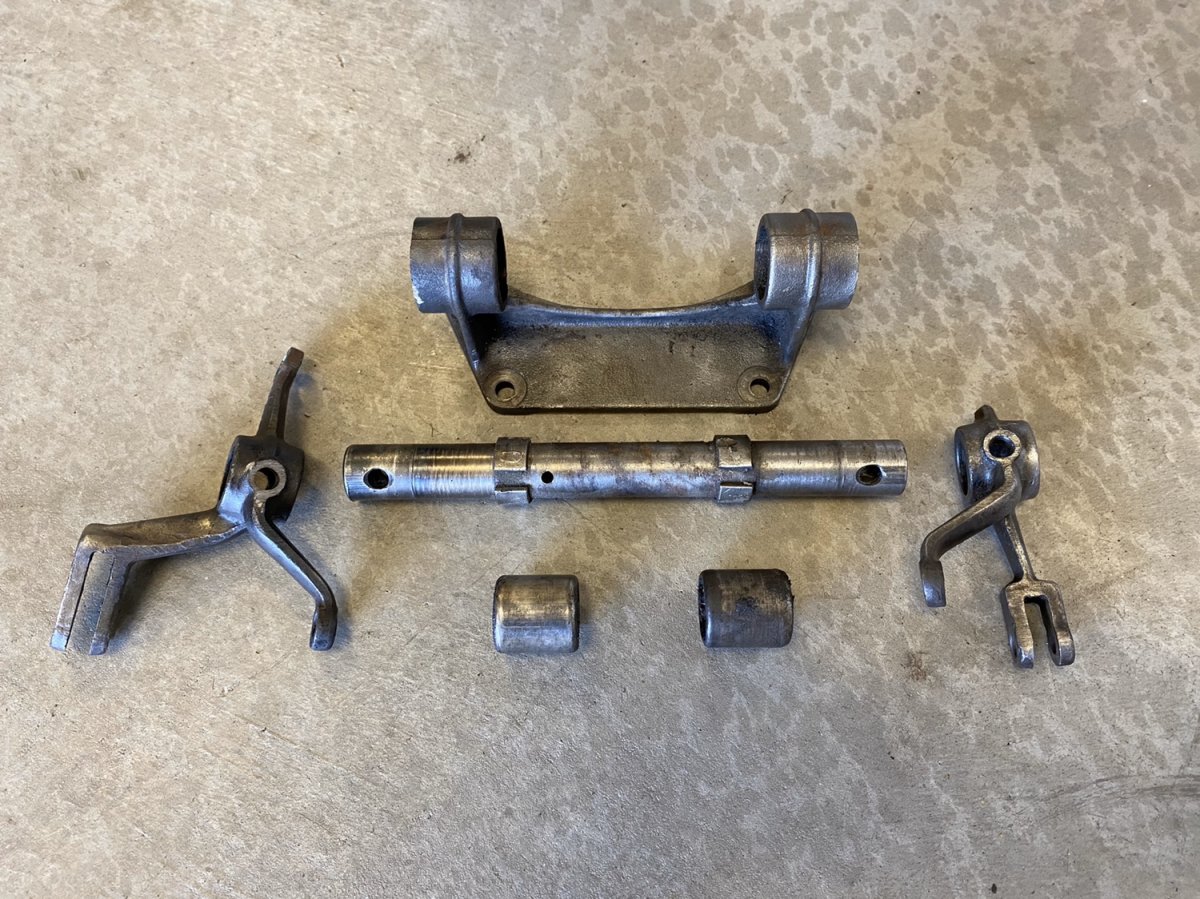

    Well, These Amazon Oil impregnated Bronze bushings seemed to do the trick! Cut-off All the Non-Essential old Mechanical brake Arms, just left the 2 for the Hydraulic Master cylinder, Replacement/conversion!
    Spent a whole 6$! Yes I’m cheap!
    And I could’ve spent money and bought a new pedal ***embly from some aftermarket Chinese knock off place but, I wanted to use the original parts as much as possible.
    Now, I think I’ll use the same type bushings on the clutch/brake pedal ***embly!
    Save me 35/40 bucks for a kit!
    Chirp-Chirp!!!

    Those rivets are almost impossible to get out with out drilling. I don't know how Ford did it, but he made sure they wouldn't fall out. I know you already found them but McMaster-Carr has the bushings you needed. The one you have is their PN 6391K275 but they make a heavy duty oil impregnated bronze bushing, with more of an iron content in the same size, PN 2868T196. I purchase all my bushings from them, they have any size you can want.
  9. 33Doll
    Joined: Sep 27, 2019
    Posts: 1,602
    33Doll
    Thanks!
    They were a *****! But at least now I have a serviceable Part!!
