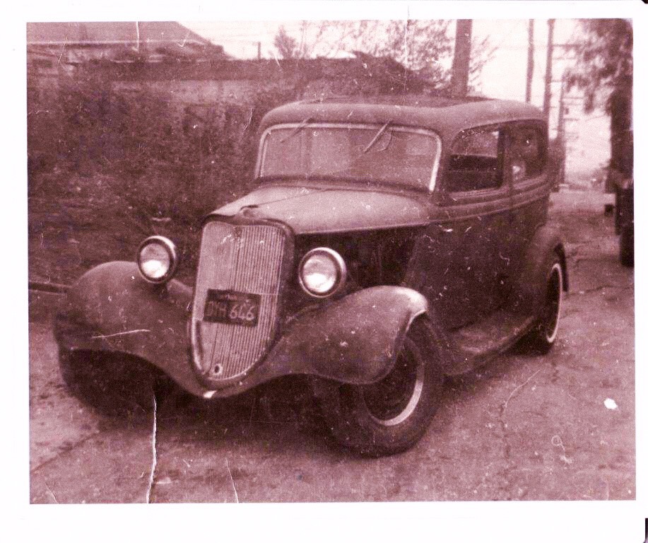

    No, that’s actually a 34’ with a 33’ Grille it was my Pops High school Rig, which I got in 2006’ but sold it to buy a cl***ic Bronco..... Which was a sore subject...
    So I was Threatened not to sell the 33’ or I’m dis-owned as a son. This 33’ Doll is special to me though, I grew up with it.
    Heres
    The 34’

    Few More of the 34’( with 33 grille)
    Camping, Mom's BD, Roses, Hiking 08 158.jpg emmaus 018.jpg Adjustments.JPG C64E3E0E-FF90-4DBD-BD02-4F51FE8F32F5.jpeg
    It was to much for me at the time.
    Frame was bent, and Someone replaced the rocker with the body upside down and got the door all out of alignment and it wouldn’t shut so I got frustrated and sold it, and bought a 1971 small body cl***ic Bronco. So my dad didn’t talk to me for a few years after that.
    It’s all good now. I tried to tell him that I didn’t grow up with that car, that was his high school car, and memories.
    the 33 Doll is the car I grew up with.
    He finally gets it now.
    Well!.....that’s enough for today’s history lesson folks!

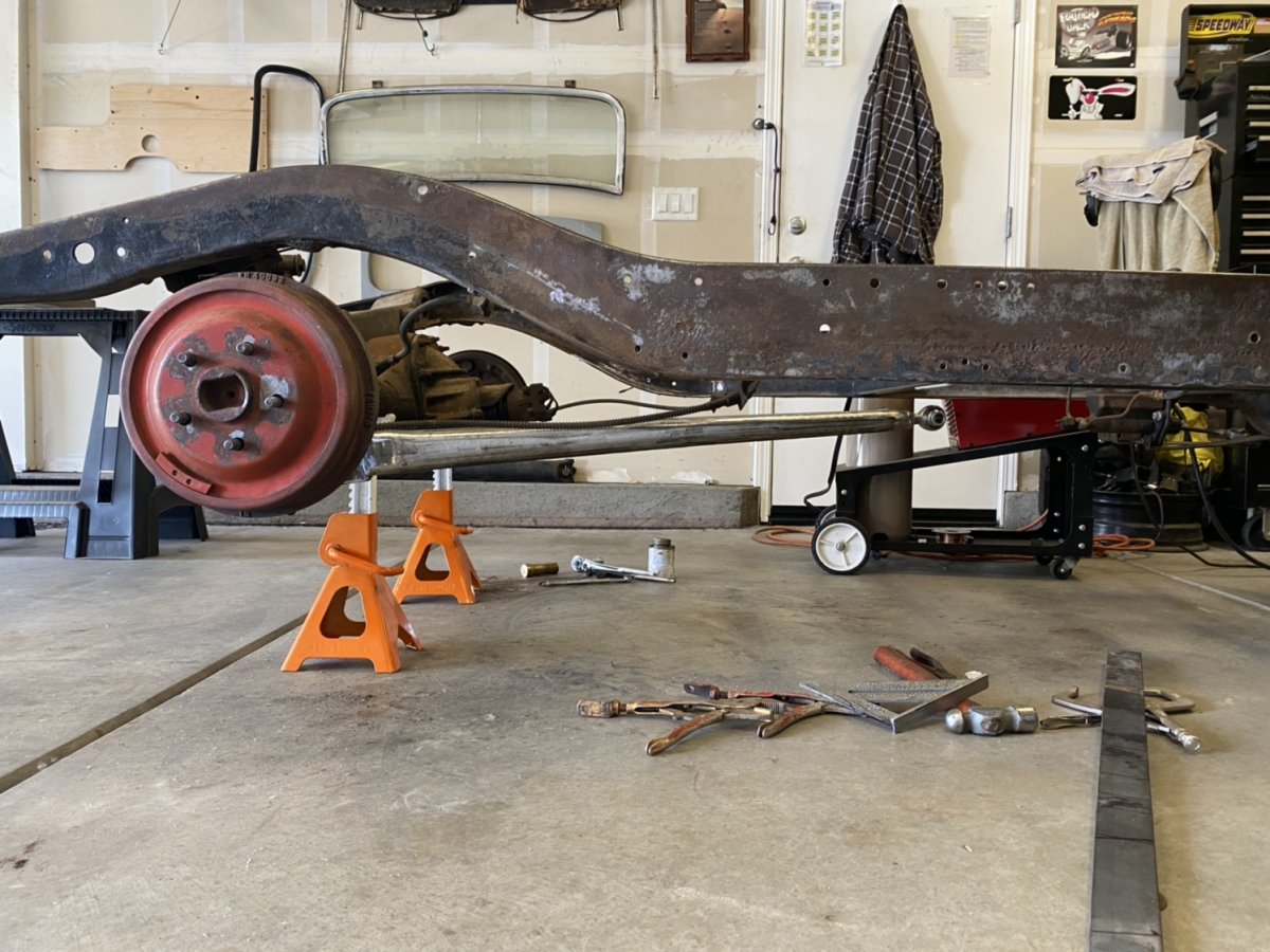

    Coming along Slowly. Plenty of clearance around the driveshaft.
    Although it kinda bugs me its the off center style third member. Oh well!
    its not like I’m gonna be hanging out underneath the car! Especially driving down the Road!

    Got the Cross mount built, just gotta make a template for the mounting tabs.
    Gonna make them wrap around the tubing slightly so they have good back and forth strength.
    Hey Dirk! I tried flipping it over, and it looked cool, but I looked under the body, and I would have to do some serious Mods to the Driveshaft Tunnel, and floor. The Driveshaft is gonna be hard to get in and out with the crossmembers like that, but it will work, I laid some sheet metal across the frame to simulate the floor, and with some finagling. It will come out.
    ( maybe replace the u-joints before I put it in just in case!)

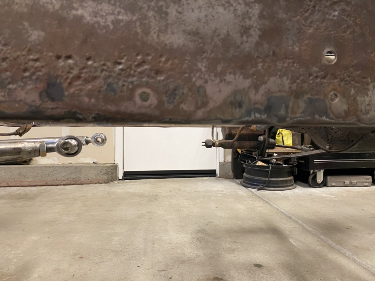

    33Doll
    Its tight, but doable.

    This will do!....Kewl!
    Man! This rear suspension fabbing is really testing my patience!
    Its Going So Dang Slow! I see everything thing played out in my head. And just want it done!
    But in reality its so slow...
    I don’t want stuff all crooked and stupid looking so I have to move slower!
    I think you all figured out by now, that I have zero patience???
    This car is slowly teaching me that. Oh but I’m fighting it!!
    Lol!
