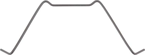

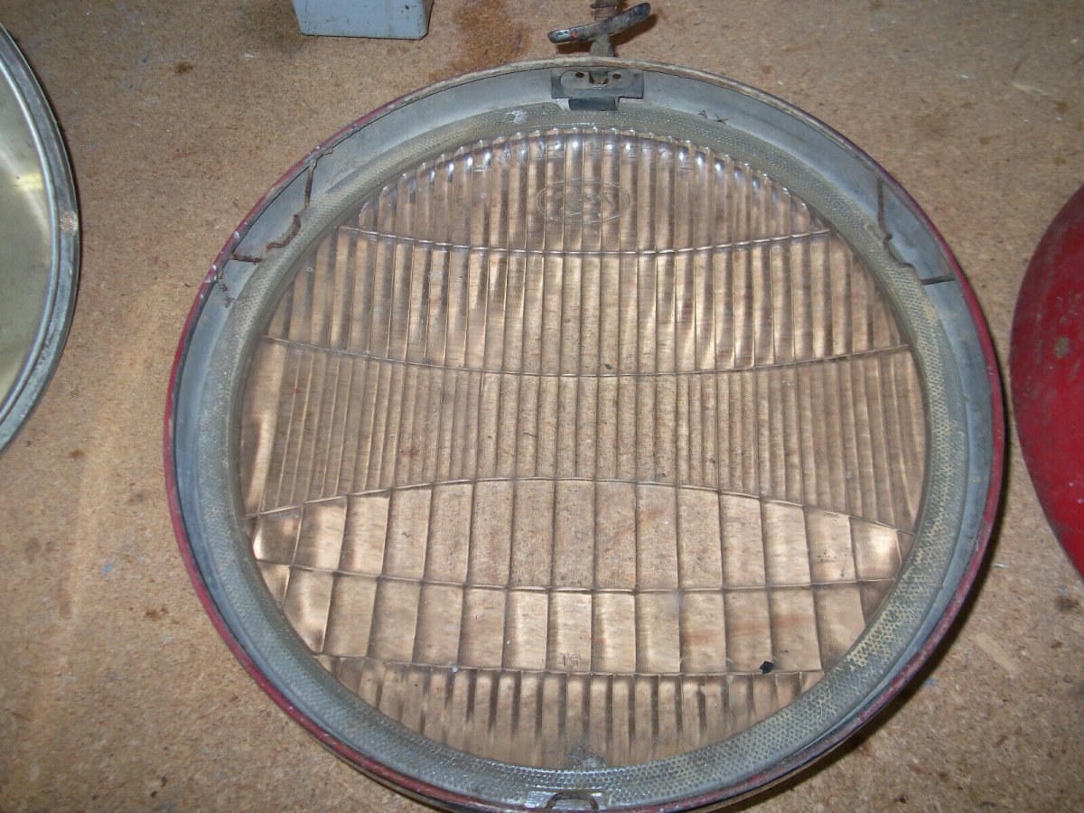

    I think I am missing the retainer clips. Do you have any pictures of the clips in place?
  9. FritzJr
    Joined: Feb 11, 2007
    Posts: 859
    FritzJr
    The clips look like this:
  10. Deuce Lover
    Joined: Feb 15, 2009
    Posts: 1,214
    Deuce Lover
  11. 335wcoupe
    Joined: Jun 19, 2012
    Posts: 53
    335wcoupe
    Thanks Deuce Lover! I'll order some.
