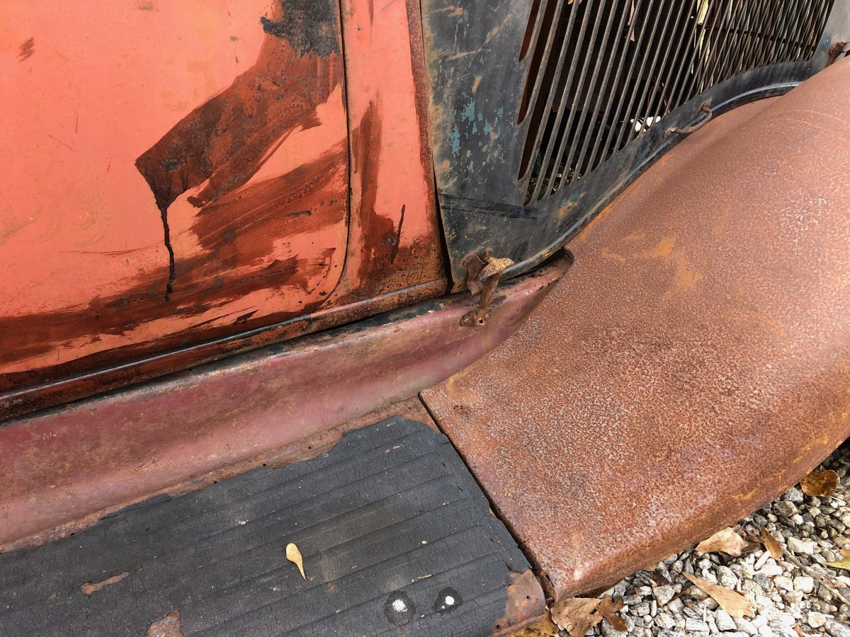

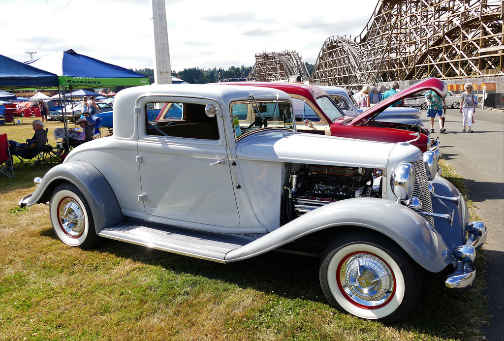

    Looks like I have some mix matched parts. I think my splash aprons might be for a PD instead of a PC. I propped everything back up today, and zip tied everything together. Seems my aprons are a few inches too long on the front side where they meet the fender. C82A1F7C-AAD1-4C3D-82D5-48F1C3E297FD.jpeg
