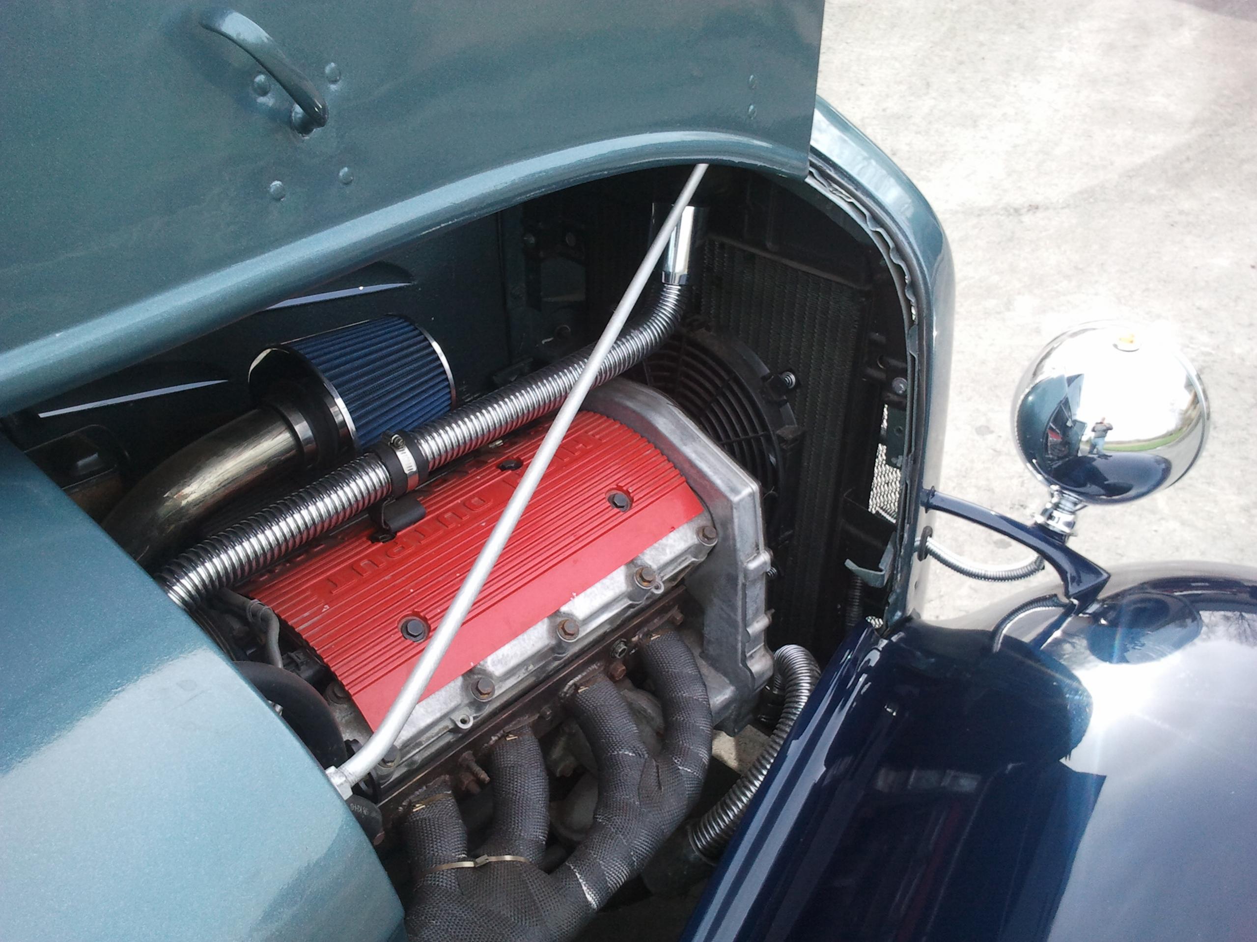

    Changed my quad over to carb. I cut apart the stock aluminum intake and re***embled it upside down and backward. Made a carb plate and welded it all together. Way cheaper than side drafts. Starts, idles and revs but I am sure it will need some tuning when the snow melts.
    Quad 4 rods stand alone ignition and a 350 cfm 2 barrel off an AMC 304.

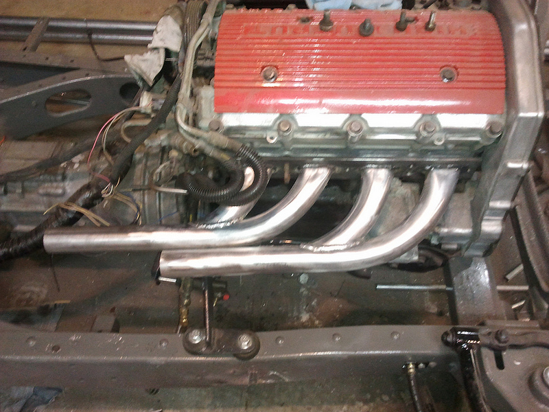

    Bonzo, Thanks for chiming in. Do you have any pics. of the exhaust system? I am at that stage now and deciding which way to go. My header flange fits 1 7/8" tubing and I'm thinking that for the headers into 2 1/2" exhaust. Does yours finish off at the cowl or go under the car? thanks! I would like to keep this thread alive but not sure if it is HAMB friendly, though it does seem to get some likes. Nice job on reversing the log on manifold. I did something similar but plan to use the throttle body if I can make it work.

    Here are some header pics I wanted duals all the way out the back. 2 inch (OD) and the header goes all the way under the cowl to a slip fit joint. Which you can just see by the running board mount.

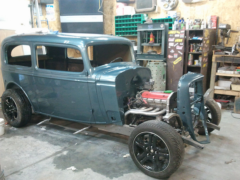

    I can't believe my last post was in 2013. As it turned out I completely blew the car apart so I could flip the frame over and finish weld everything. I pretty much have the floors finished. As the pickup is channeled I set the foot well on the drivers side flush with the bottom of the frame for a bit more leg room. The header is done and a lot of little things as well including the clutch and brake pedals and the gas pedal as well. I'm in the process of wiring everything so I can get the engine running. Moving slowly but still moving!
    [​IMG][​IMG][​IMG]
