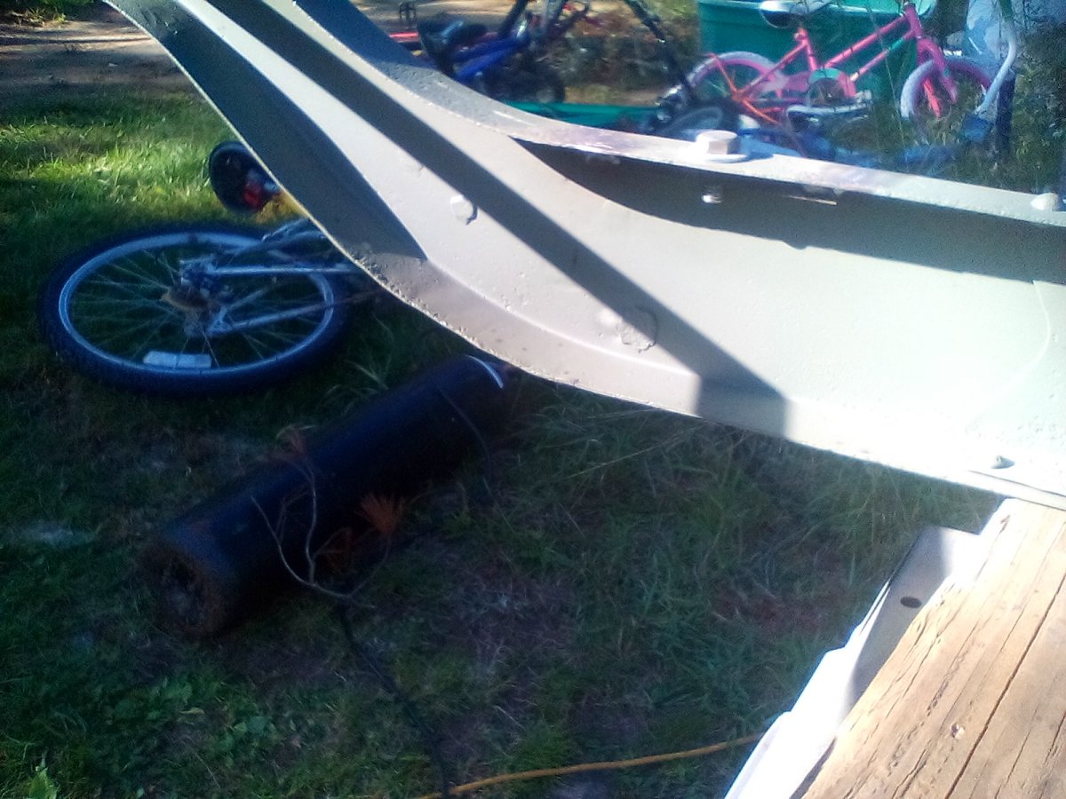

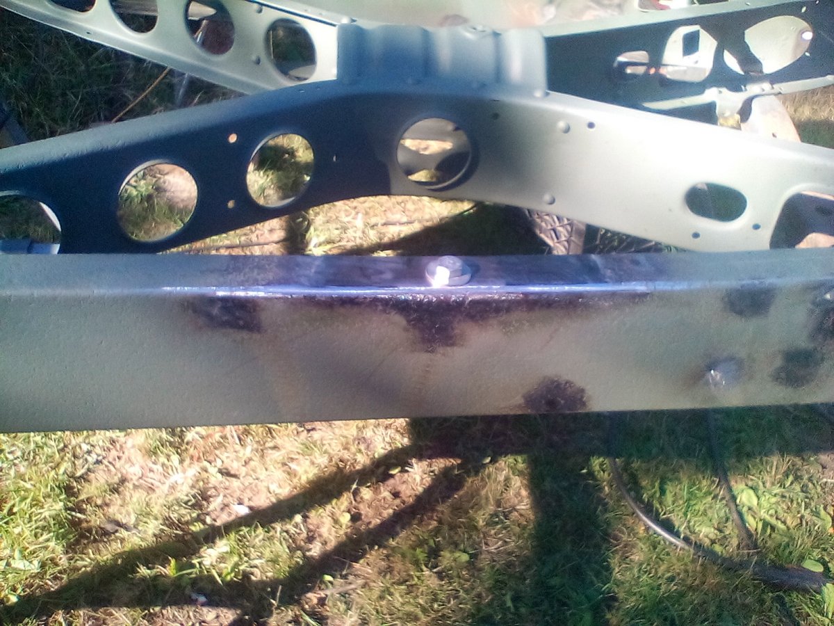

    IMG_20150927_161054.jpg IMG_20150927_154341.jpg IMG_20150927_154334.jpg IMG_20150927_154146.jpg IMG_20150927_154242.jpg IMG_20150927_154219.jpg Well today I fixed some bad spots in frame. Welded in a ton of not needed factory holes. I also welded the threaded blind plates in I made. Just getting ready to box frame. I had a small sway in the rear of frame. Got that fixed too it was not bad,but would have buged me knowing it was there. Anyway here are some pics.

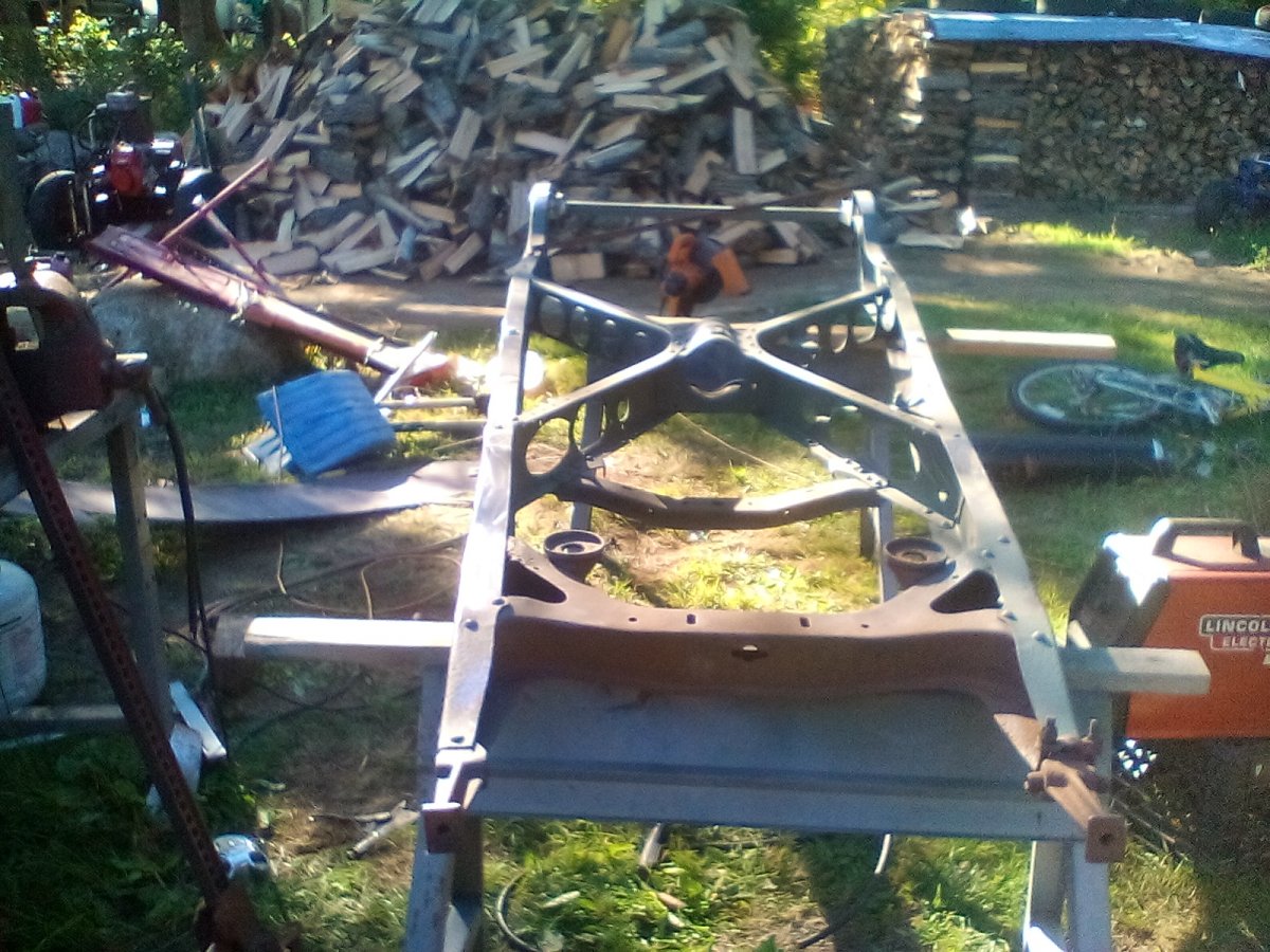

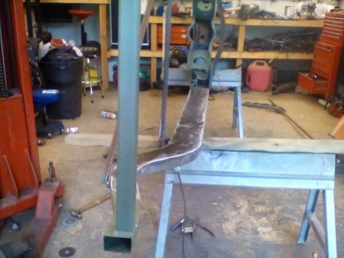

    Today I boxed in over half the frame. I took the frame up to a friends garage. I was a little too cold for me outside today. The x member I'm putting back in after I put the rear end in. That way I can be sure it will not be in the way of brackets. The excavator got droped off tomarow the site work for my garage is being done IMG_20151001_170035.jpg IMG_20151001_170048.jpg IMG_20151001_164545.jpg IMG_20151001_164534.jpg IMG_20151001_164121.jpg IMG_20151001_164111.jpg

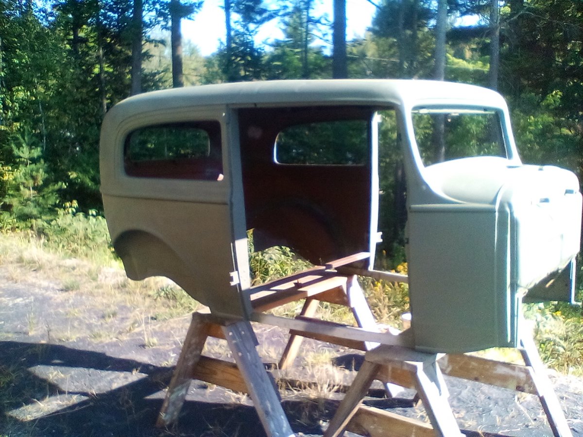

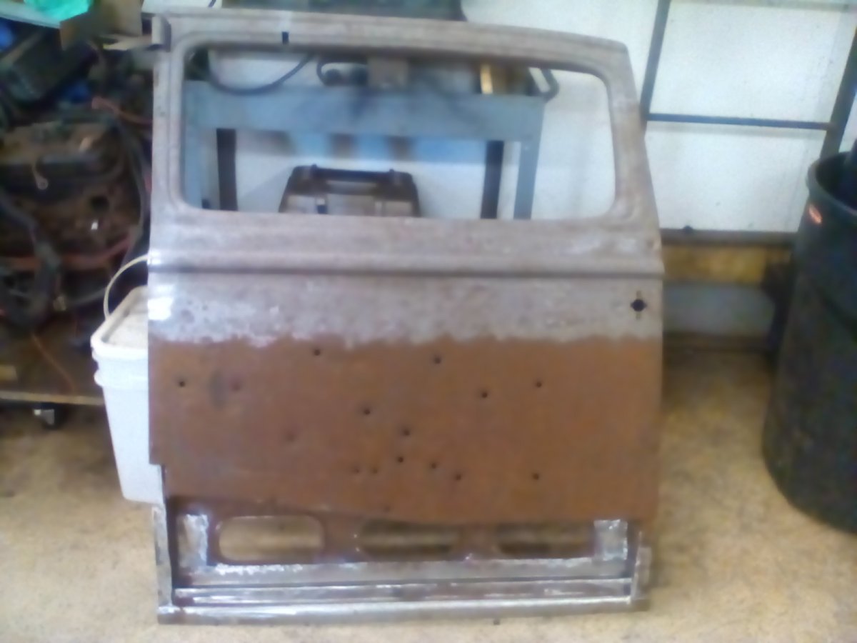

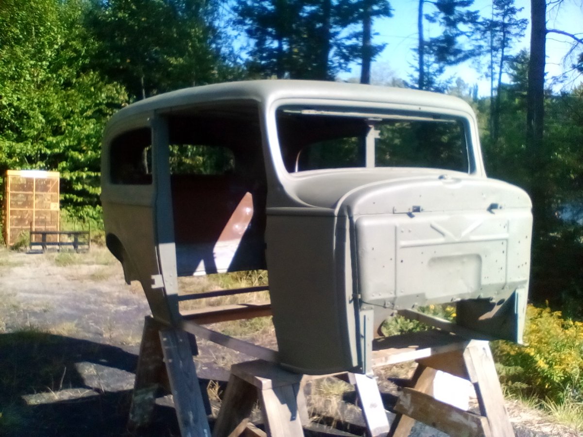

    IMG_20151008_170845.jpg IMG_20151008_170603.jpg IMG_20151008_170645.jpg IMG_20151008_170707.jpg IMG_20151008_170749.jpg IMG_20151008_170757.jpg IMG_20151008_170845.jpg Here are some pics of my doors. I started on p***enger door first was most gone. I have been working on them here and there. They are just really rusty. The bullet holes don't help any either. I have been keeping my eye out for some better doors or a set of nice doors off a 4 door. I can make make 2 out of the 4. In the meantime I'm going to fix these over winter. There are also pics of driver side door. I have not done any work to yet. IMG_20151008_170603.jpg IMG_20151008_170645.jpg

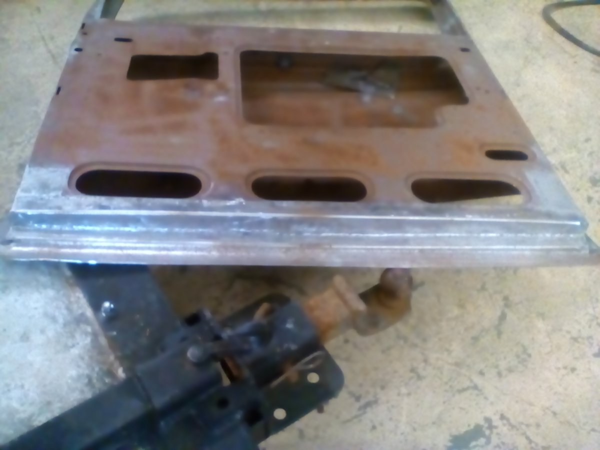

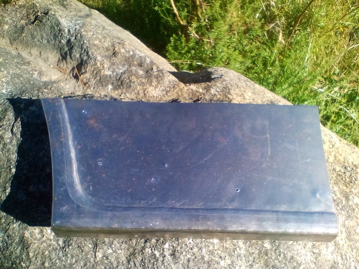

    For anyone who would like to see some more panels made from the wood buck I made. Here are some pics of panels. I just got done makeing for a friend who also has a Terraplane. They are lower quarter s behind doors and lower cowl. They will still need finish work. IMG_20151010_150303.jpg IMG_20151010_150248.jpg IMG_20151010_150236.jpg
