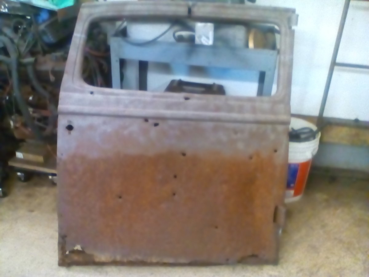

    I don't know what your final plans/look of the car will be but after you fix the rusty doors you could leave the bullet holes - to "ratty"??? but would show what you started with..... just a crazy thought.

    I'm not going to leave any bullet holes too ratty. I have lots of pics from pick up of car to now. As far a rat rods well I think some of the thoughts and ideas that go into them are good but over all just too ratty and some make you wonder how safe are they?

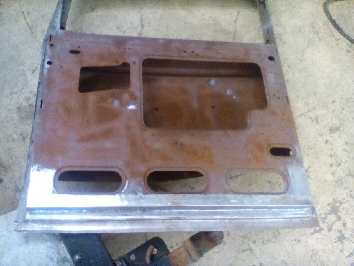

    Thanks for the insight on doing custom body patches , i have knew of bucks being used , but now I get it ! Love the suicide doors and especially the leaned back trim around the windshield !

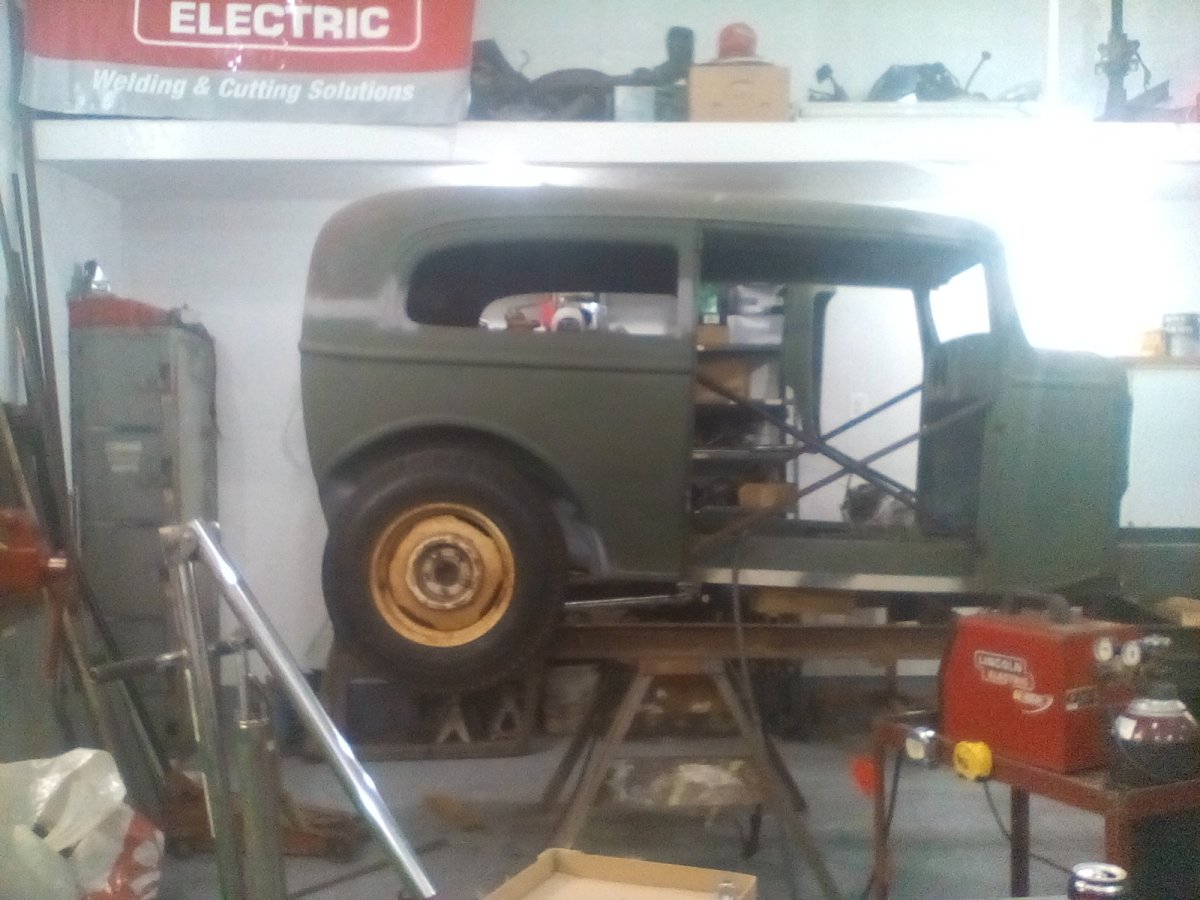

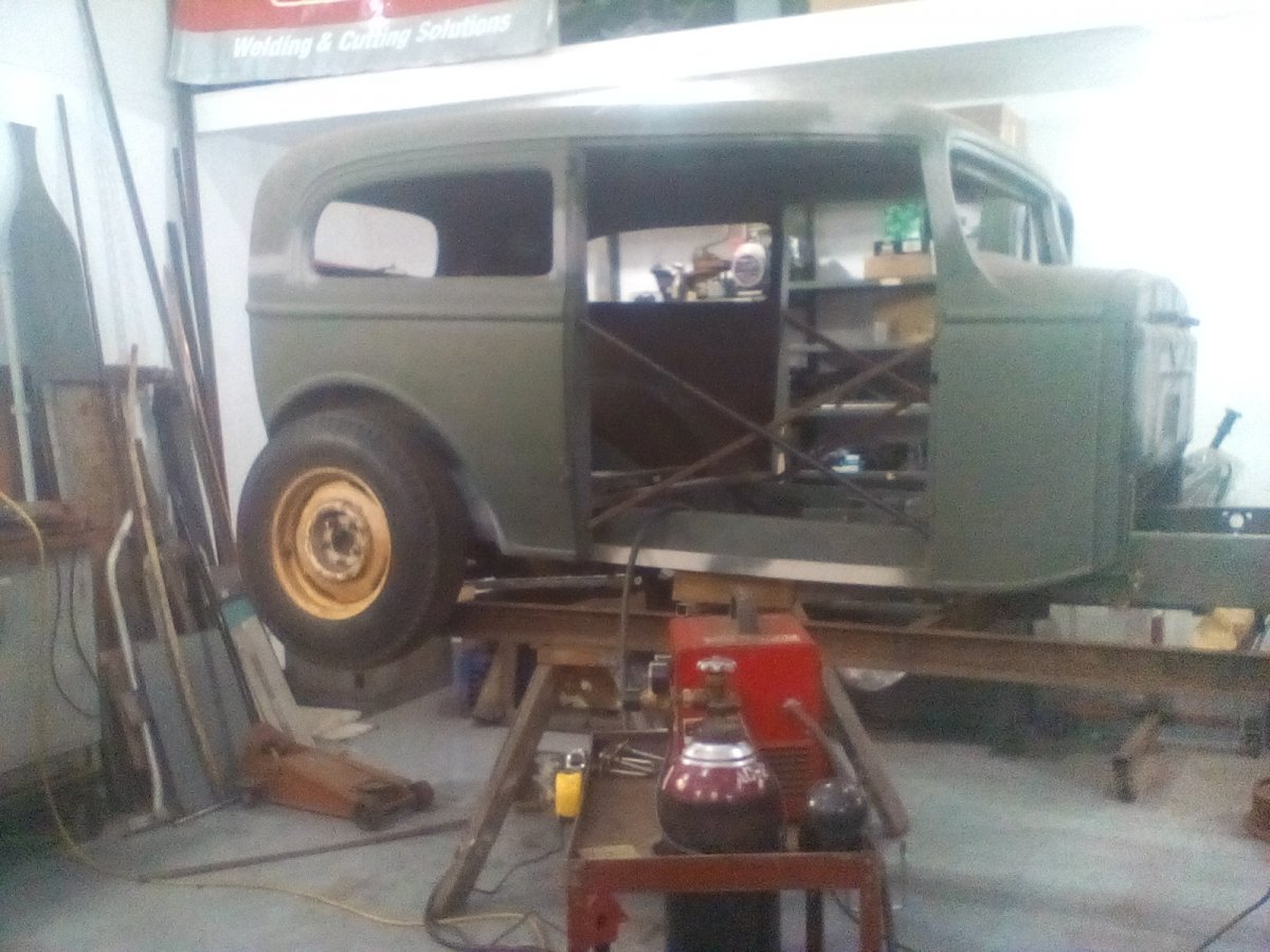

    So I got my car out yesterday. I have been thinking all winter about. If I chopped it enough I came to the conclusion and it needed more. So I took another 1 1/2 out that makes a total of 3 1/2 inchs. This time through I left the back window alone. It's already 8 inchs tall. I still got to do some more welding. First pics is at 2 inchs second pics are at 3 1/2. I think it looks way better. IMG_20150620_182826.jpg IMG_20150620_182911.jpg IMG_20160528_191407.jpg IMG_20160528_191351.jpg IMG_20160528_191340.jpg IMG_20160528_191428.jpg

    The lines flow nicer this way^.

    Proportions look good Chris. Nice work !!

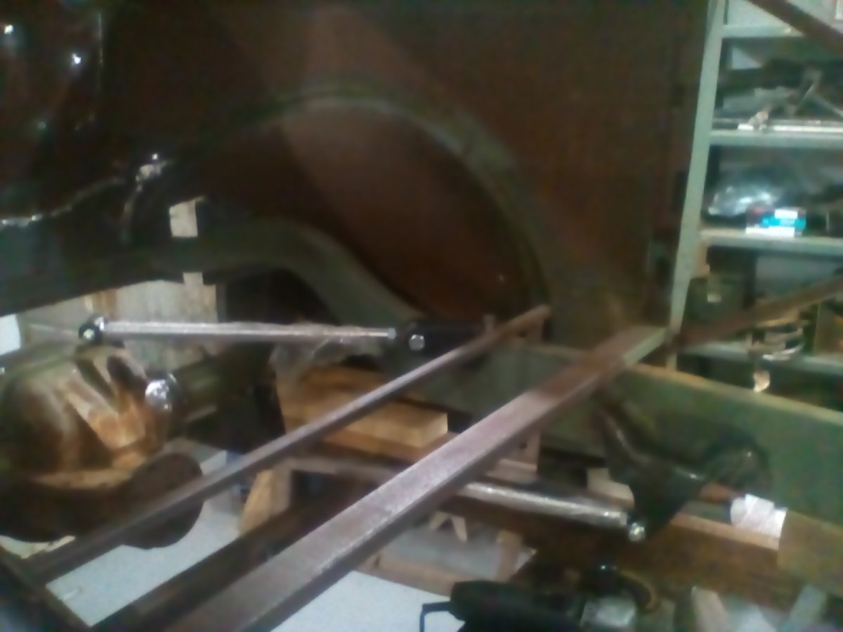

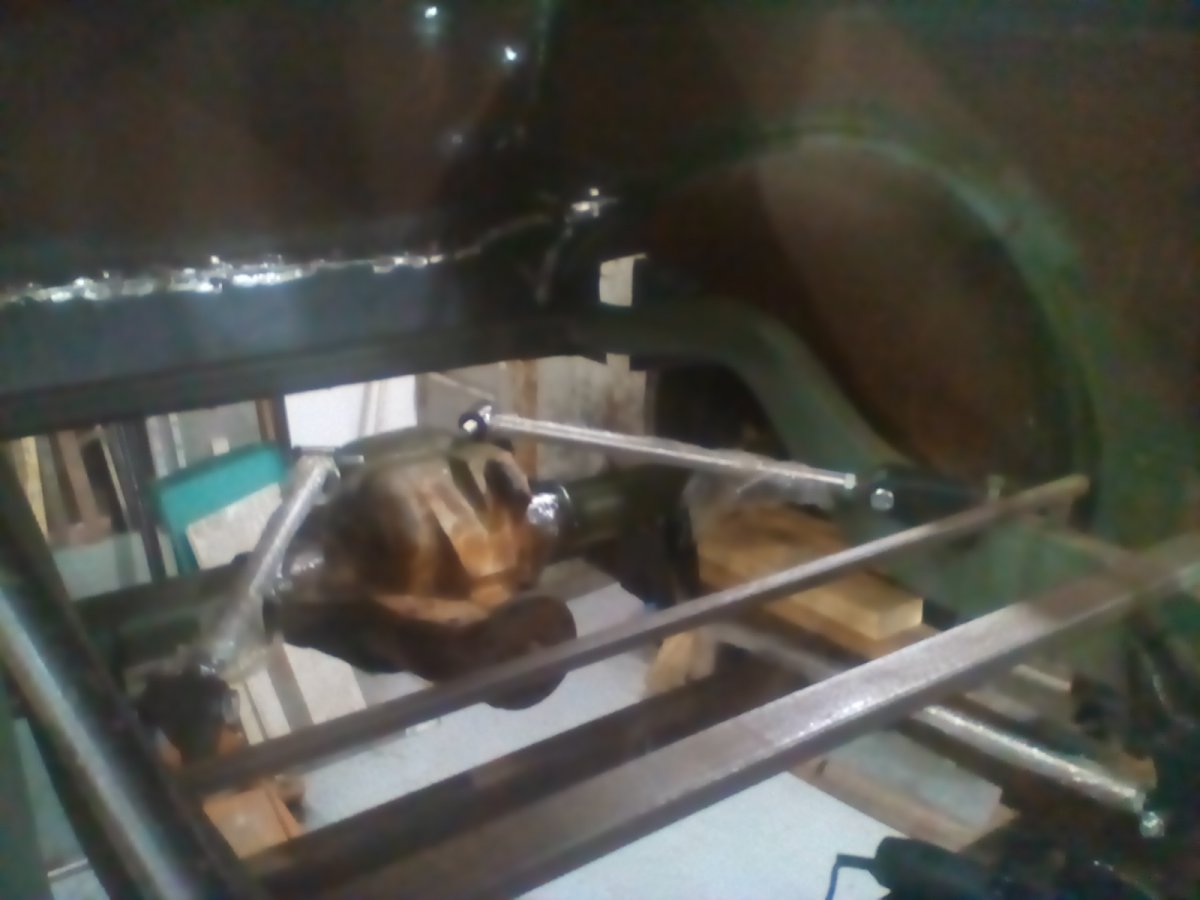

    So anyway it has been awhile. I have been very busy with the garage. So finally kind of settled in the new garage now. I built a frame jig/rack to work from. Today I have started putting the rear end in. I will post more very soon. Hopefully get a lot done over this winter. IMG_20171209_161001.jpg IMG_20171209_160947.jpg IMG_20171209_160947.jpg IMG_20171209_161023.jpg IMG_20171209_161014.jpg

    Got some more done today on rear suspension. Just need to do some final checking. Then finish welding also some pics of tires. I have that were going to be thrown away. After I get done with rear suspension on to the front suspension. I almostforgot I got to get some 2 1/4 flat stock. I need some erailer today did not have any. So looked around shop there was a flatstock brace on the engine hoist. I will replace that later can't have a little thing like no flat stock holding up progress. IMG_20171210_162719.jpg IMG_20171210_163017.jpg IMG_20171210_163003.jpg IMG_20171210_162752.jpg IMG_20171210_162900.jpg IMG_20171210_162930.jpg IMG_20171210_165754.jpg IMG_20171210_165817.jpg IMG_20171210_163052.jpg

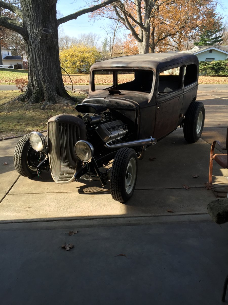

    image.jpeg 33es*** your making good progress. I'm getting close just have to get threw back issues. I'm also thinking mine needs a slight hair cut. Keep focused.

    I agree it dose need a hair cut. Looks like yours is running and driving? Way ahead of mine if it is. Hopefully you will be back working on yours soon!
