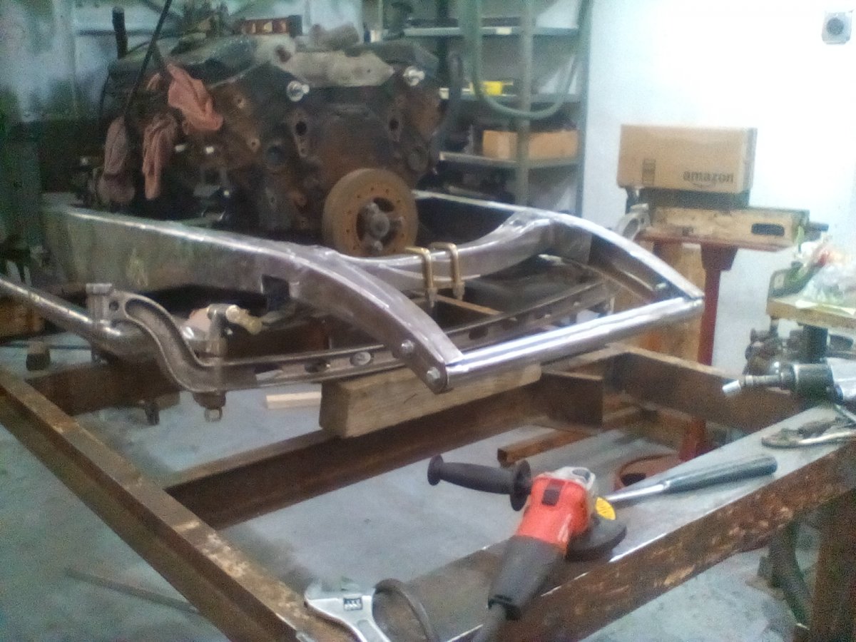

    Did some work on the the car today. Not a whole lot but some I put the transmission and engine together . I have for mocking up and set in car getting ready to do the front suspension. Yes that is the engine crane I robbed the flat stock from. IMG_20171217_162151.jpg IMG_20171217_162241.jpg IMG_20171217_162225.jpg IMG_20171217_162214.jpg IMG_20171217_162259.jpg View attachment 3748642 IMG_20171217_162126.jpg IMG_20171217_162259.jpg IMG_20171217_162214.jpg IMG_20171217_162241.jpg

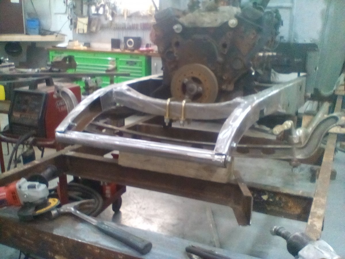

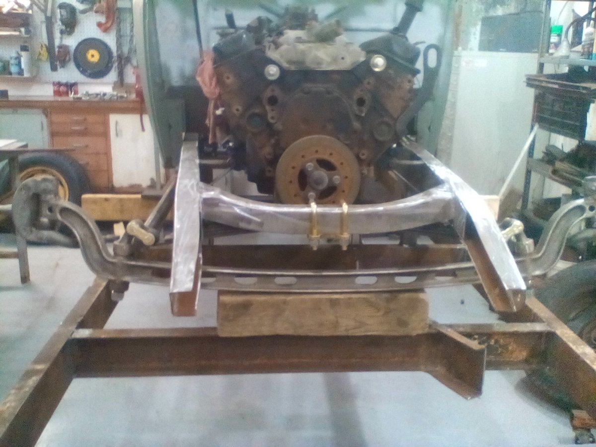

    Here we are another day of working on the car. This is what I got done today. I cut front frame horns off welded on new ones. I also finished boxing the frame rails. Tomorrow will be putting cross member in and motor mounts. IMG_20171223_103916.jpg IMG_20171223_105257.jpg IMG_20171223_105303.jpg IMG_20171223_105313.jpg IMG_20171223_192117.jpg IMG_20171223_192134.jpg IMG_20171223_192147.jpg IMG_20171223_192203.jpg

    Well got the cross member in and motor mounts in just got to box them. I still got to build a transmission cross member. Then it's on to putting the front end together. I did get the front end just sitting there. I wanted to see how things were going to look. IMG_20171224_145812.jpg IMG_20171224_145833.jpg IMG_20171224_145848.jpg IMG_20171224_145910.jpg IMG_20171224_145934.jpg

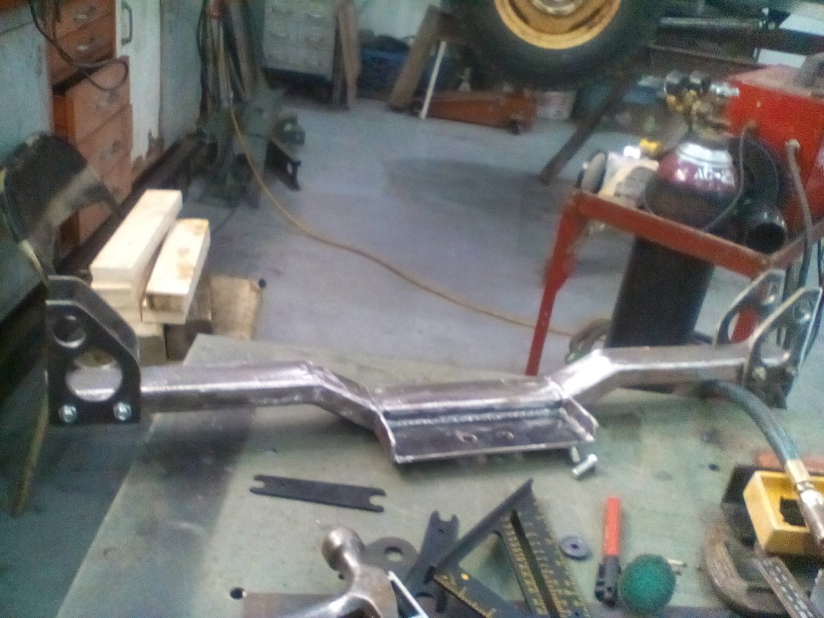

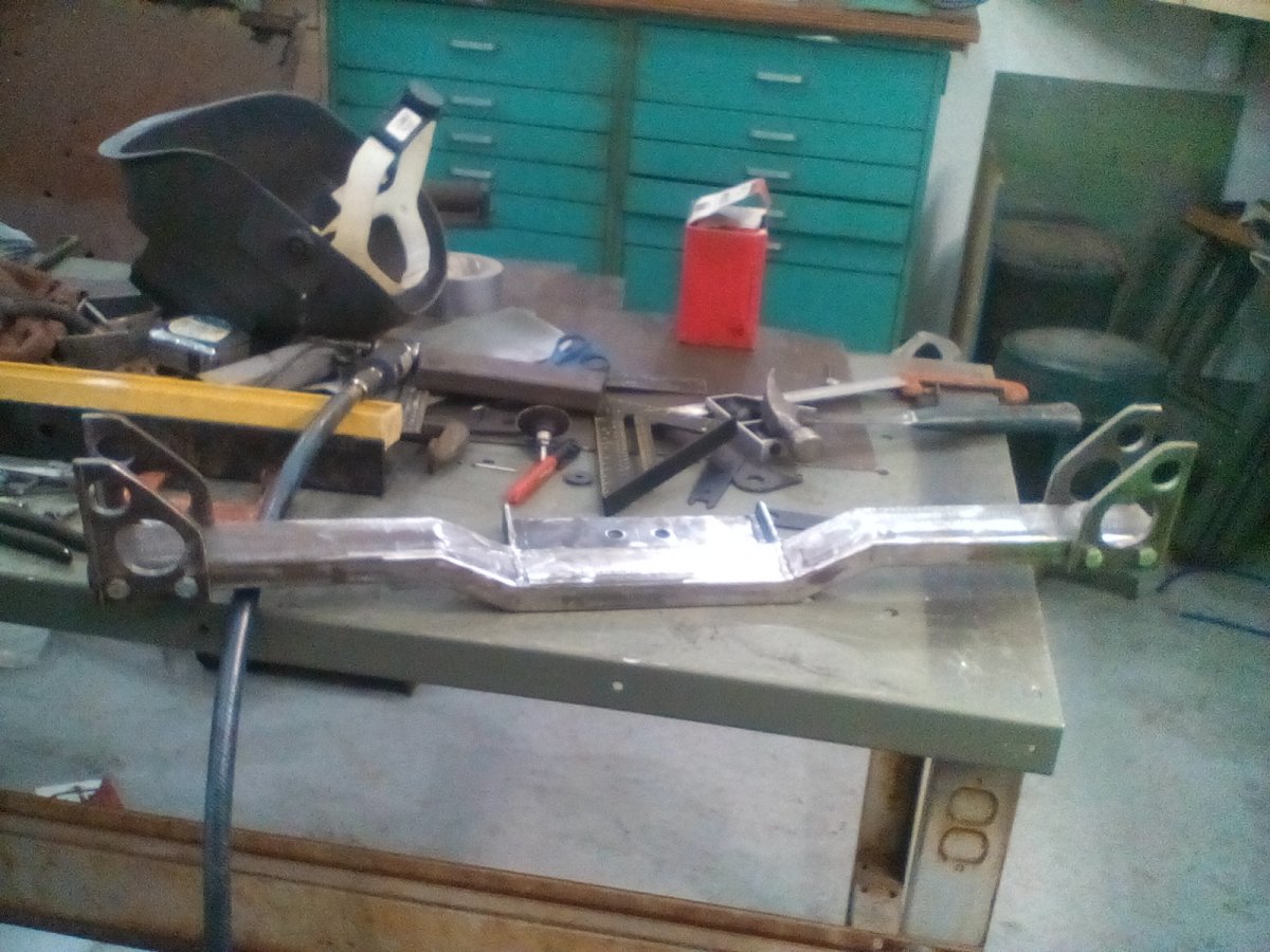

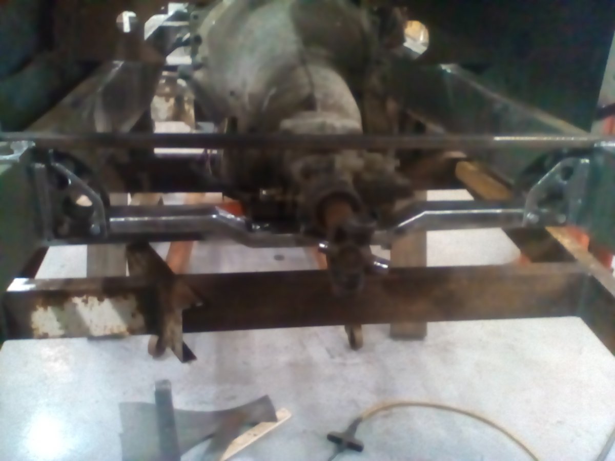

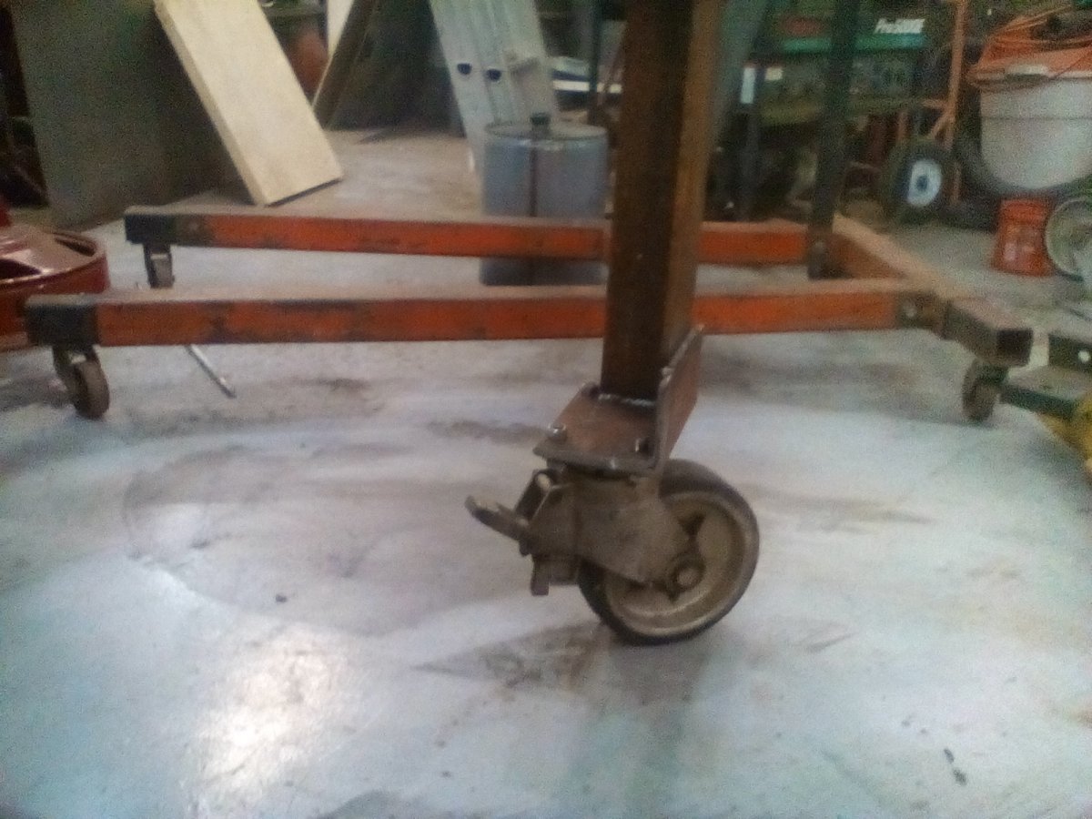

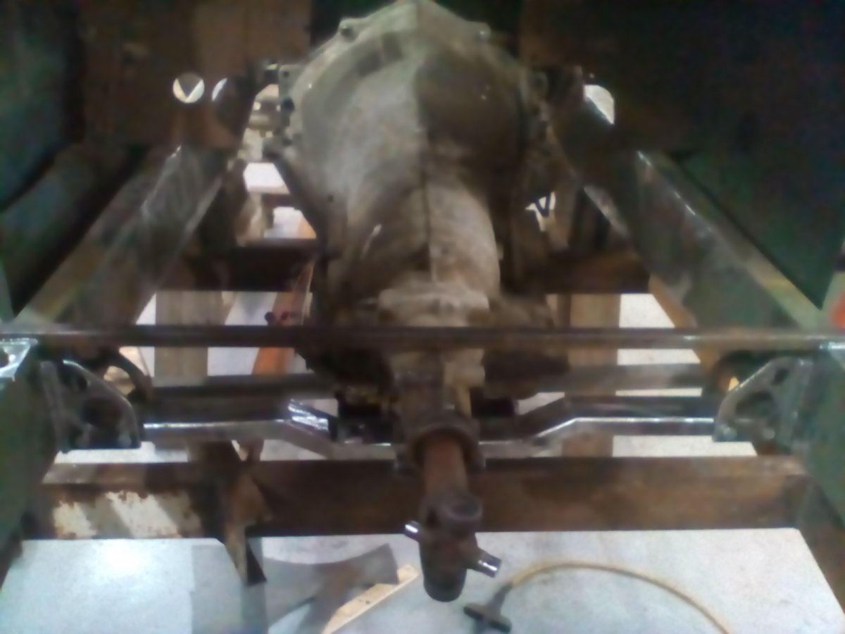

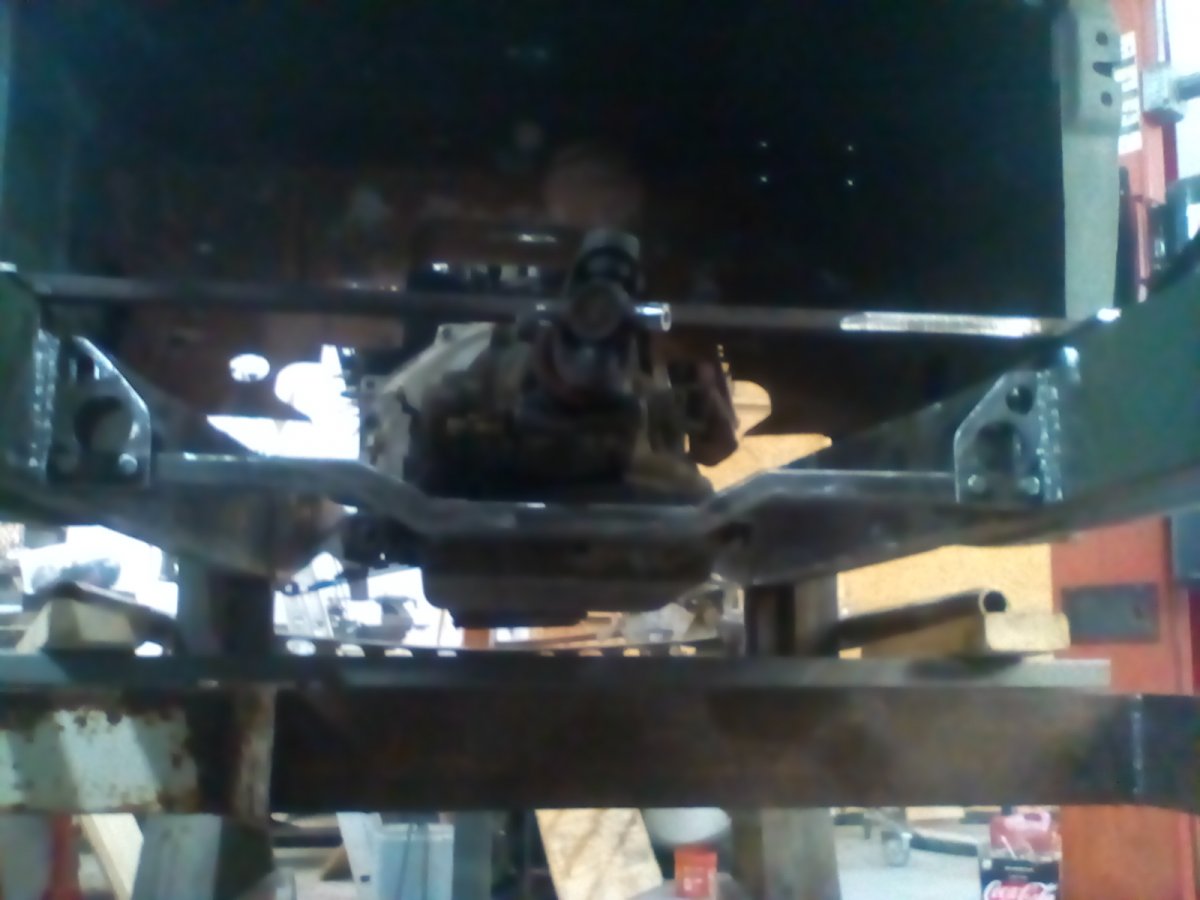

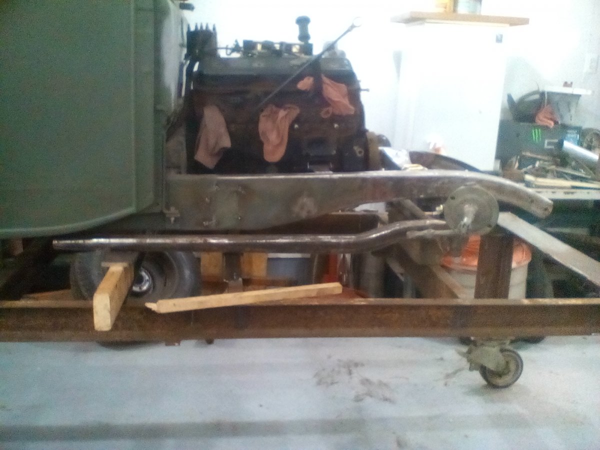

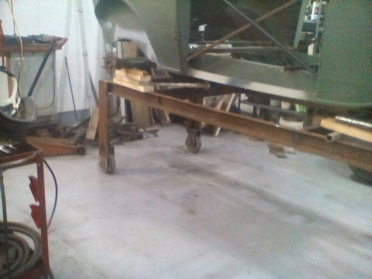

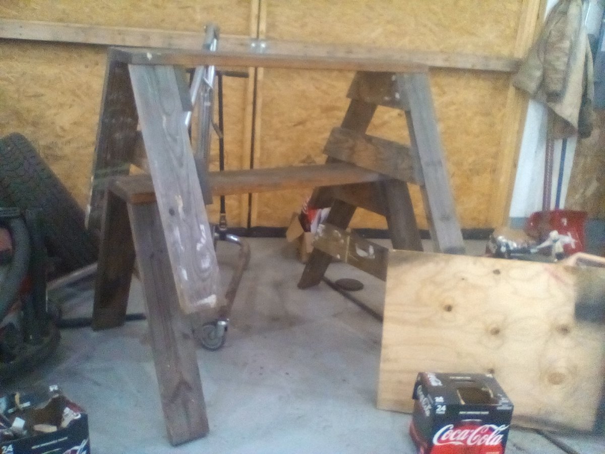

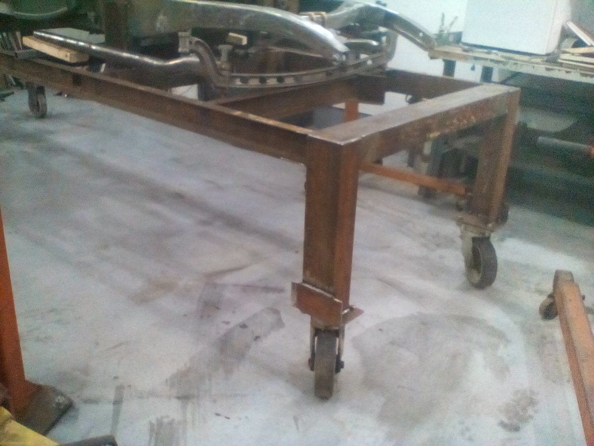

    Today I built the transmission cross member. I got it all built and started thinking about the wood sawhorses.:eek: That everything is sitting on and the fact. I keep adding more and more weight. So I fixed the sawhorse situation by putting the casters on the frame rack. Tomorrow will be cleaning up the huge mess I made.:rolleyes: IMG_20171230_142942.jpg IMG_20171230_142951.jpg IMG_20171230_154633.jpg IMG_20171230_154821.jpg IMG_20171230_154723.jpg IMG_20171230_154909.jpg IMG_20171230_212549.jpg IMG_20171230_212642.jpg IMG_20171230_212604.jpg IMG_20171230_212627.jpg

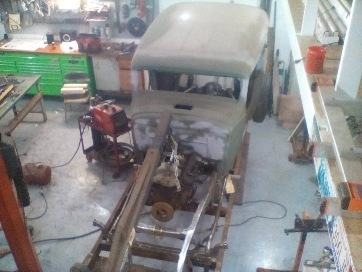

    Today I got the shop clean and started putting the front suspension together. IMG_20171231_181332.jpg IMG_20171231_181319.jpg IMG_20171231_181307.jpg IMG_20171231_181242.jpg

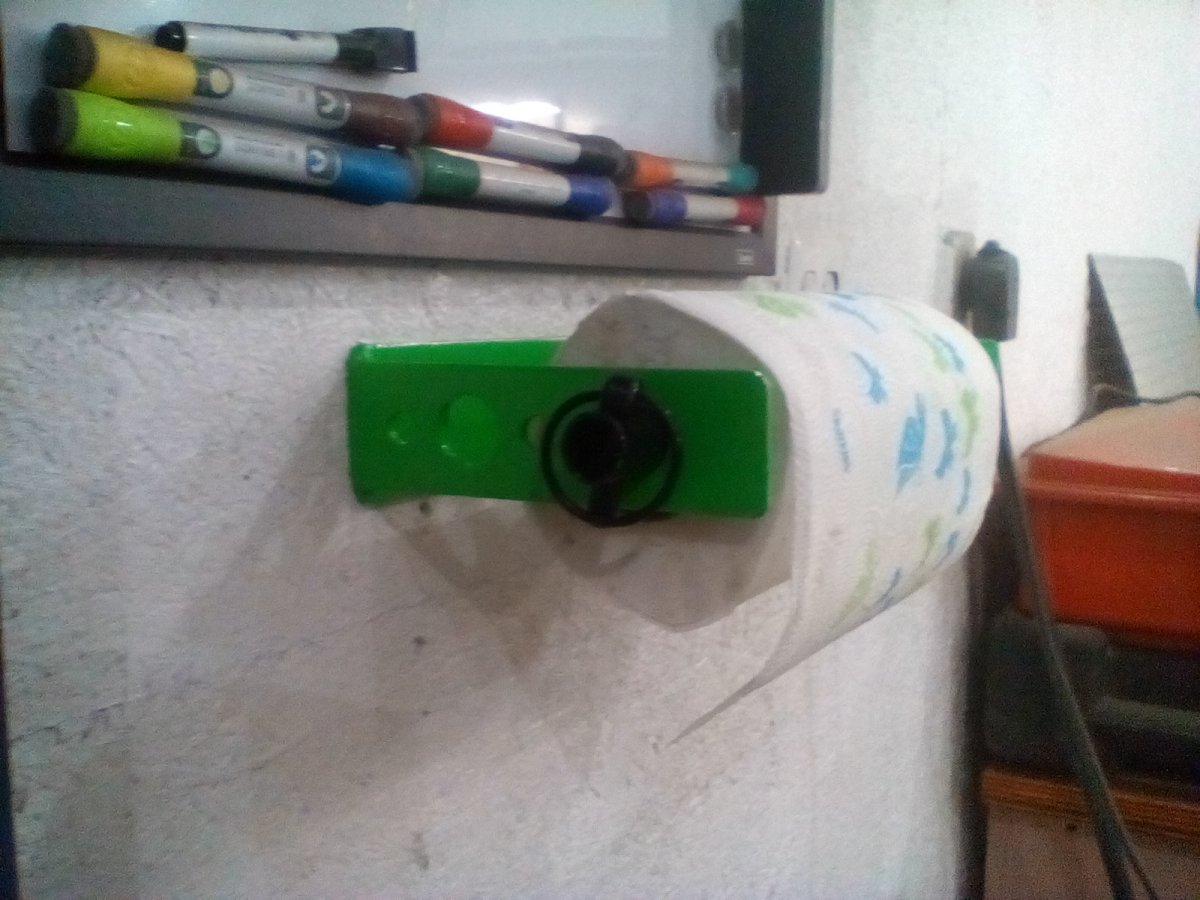

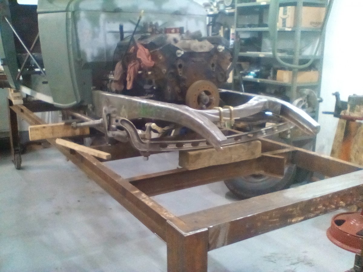

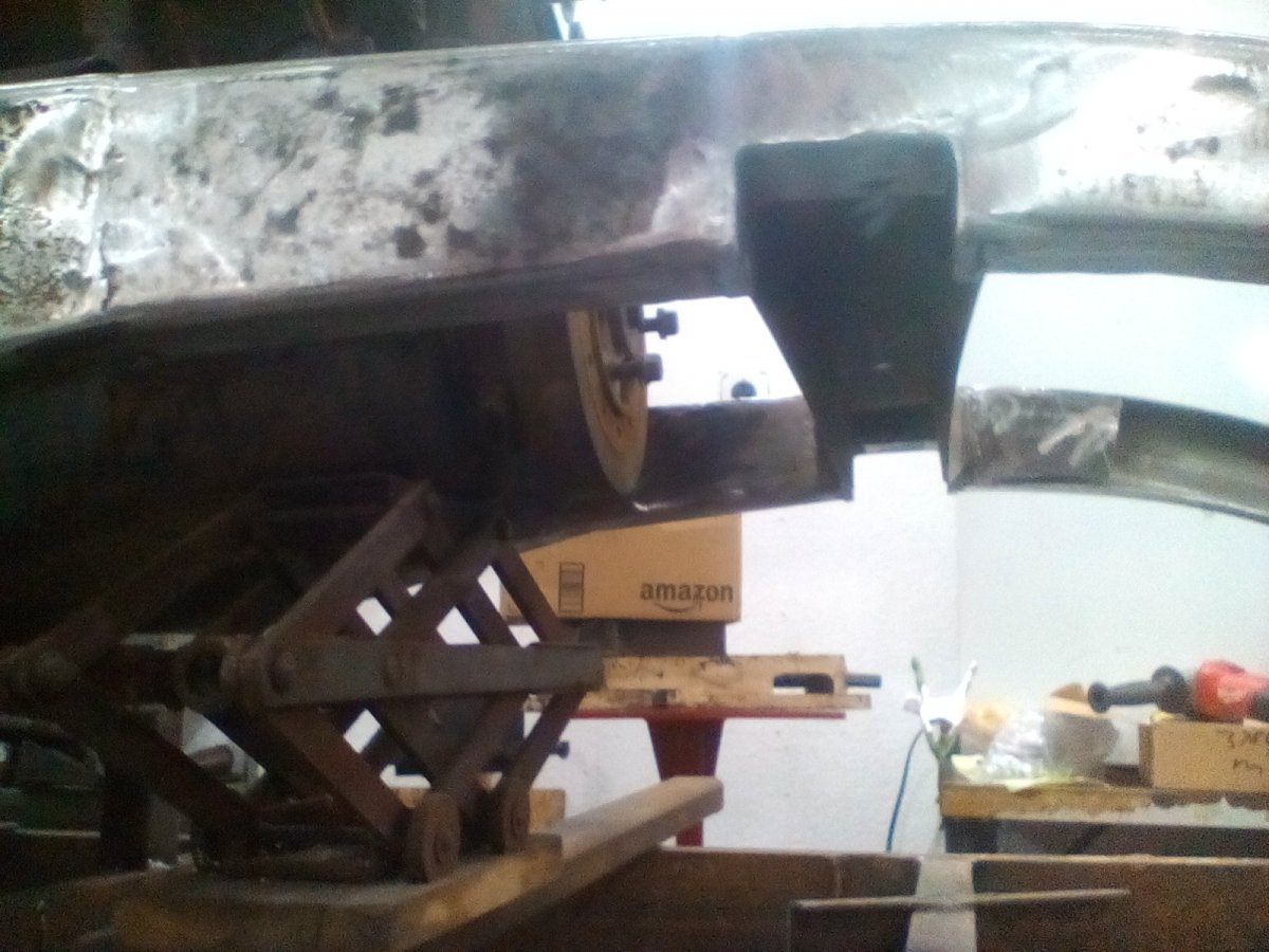

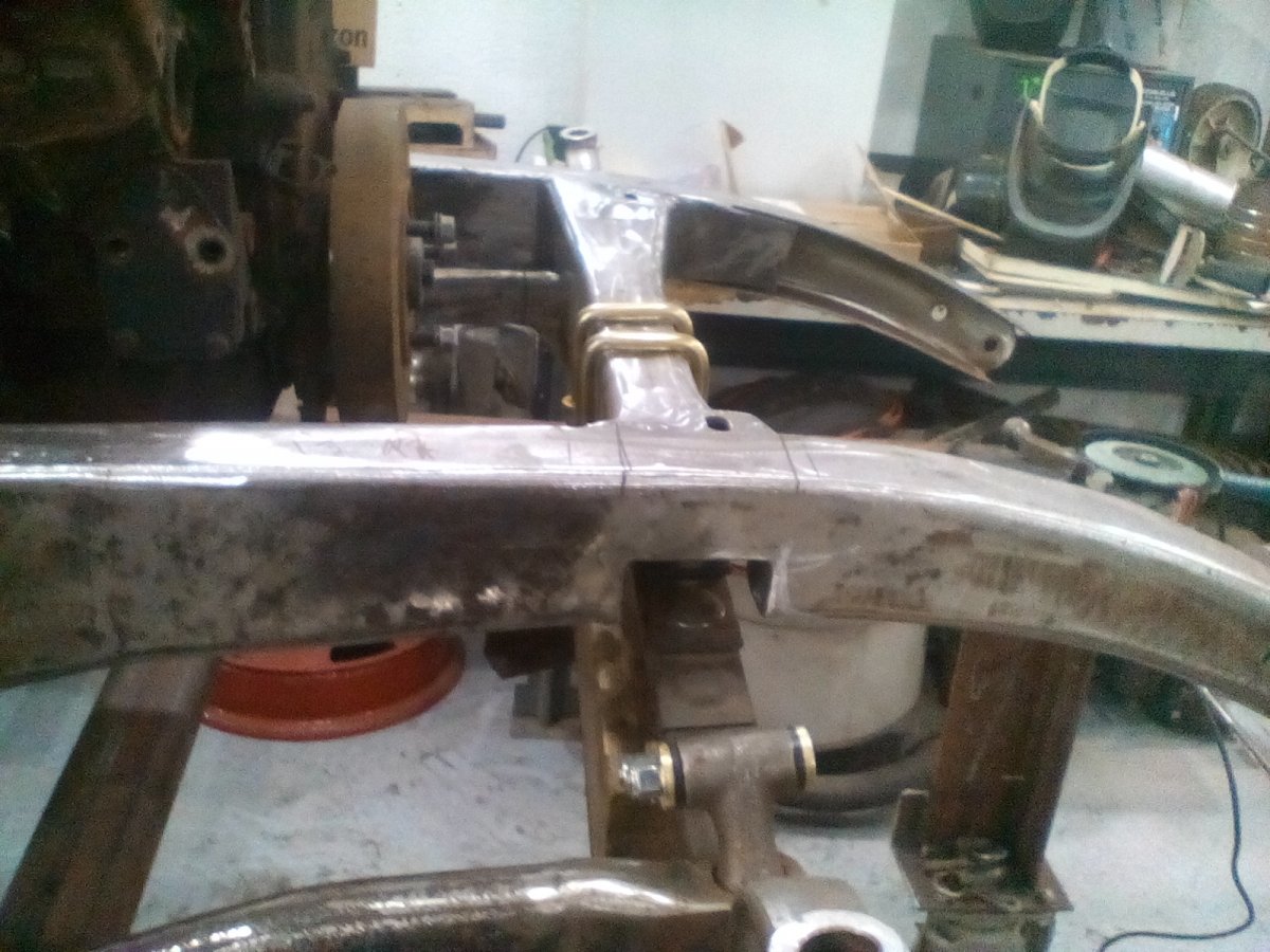

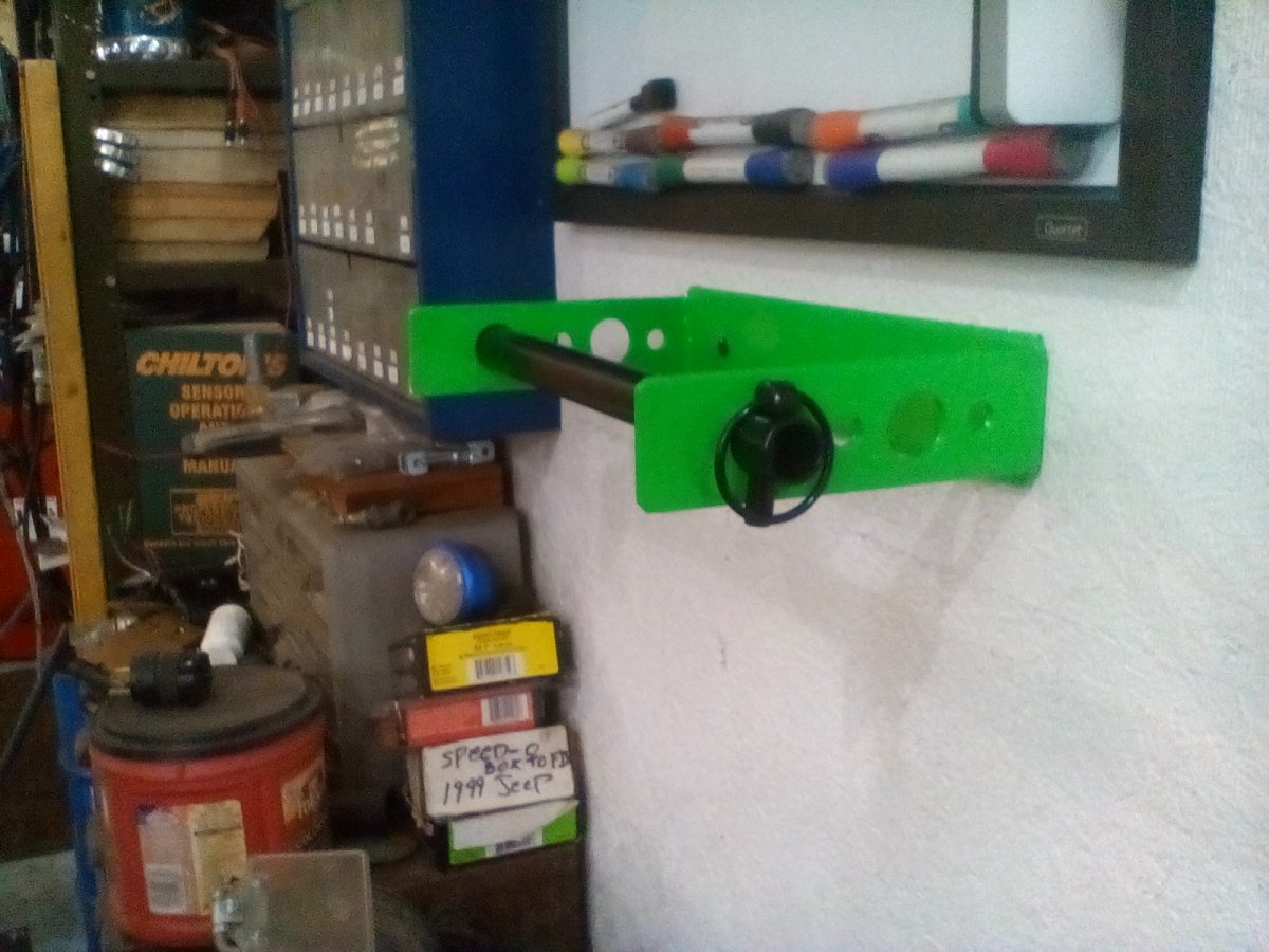

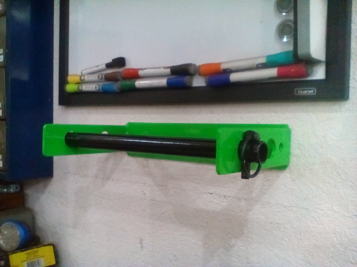

    Did some more work on the car today. I had to notch the frame in the front. Spring was going to hit. I also made a spreader bar. Then I got side tracked and built a paper towel holder.:rolleyes: IMG_20180106_163535.jpg IMG_20180106_164759.jpg IMG_20180106_203141.jpg IMG_20180106_203154.jpg IMG_20180106_194807.jpg IMG_20180106_194758.jpg IMG_20180106_194923.jpg
