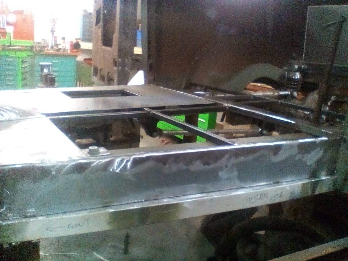

    Did some more work this weekend. Slowly picking away at it. I did some more on the floors and started putting in a battery box. IMG_20180415_200026.jpg IMG_20180415_195950.jpg IMG_20180415_195930.jpg IMG_20180415_195923.jpg IMG_20180415_195902.jpg IMG_20180415_195832.jpg IMG_20180415_195845.jpg

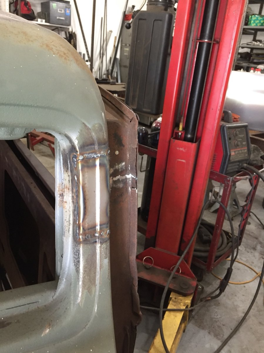

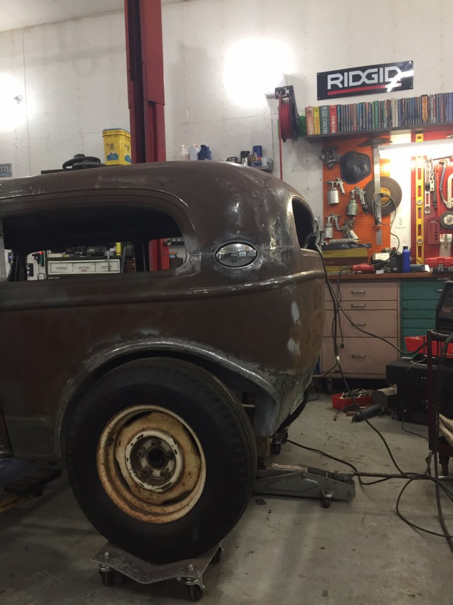

    Well have not been doing too much. I got the front post looking good. When I did the chop. It made it not look right. I also did some work on the rear of the body and have been doing some dolly work. IMG_0131.JPG IMG_0132.JPG IMG_0134.JPG IMG_0139.JPG IMG_0141.JPG IMG_0045.JPG IMG_0044.JPG

    Your looking good. I had to fuss with my wind shield posts also after welding from the chop.

    I like what you did with reshaping the back and the beading. Looks nice.

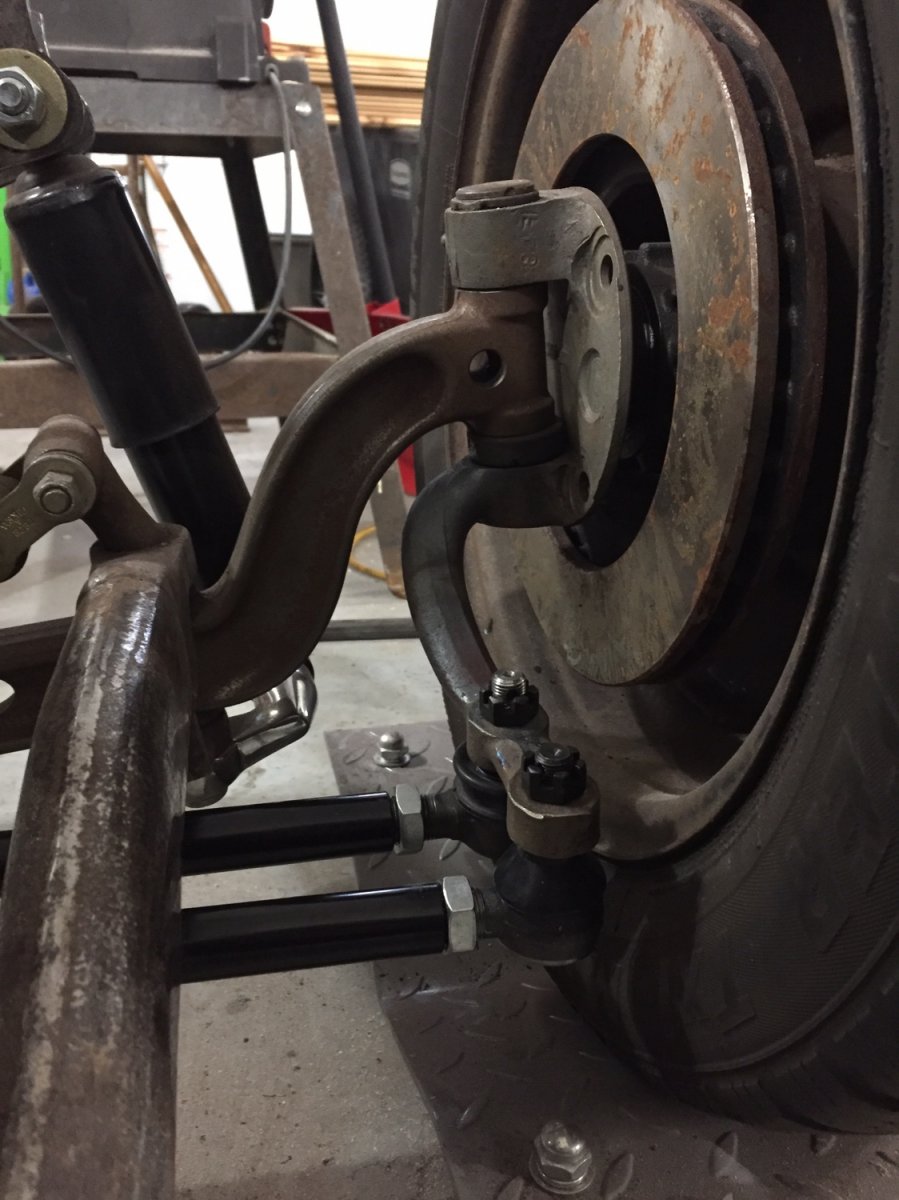

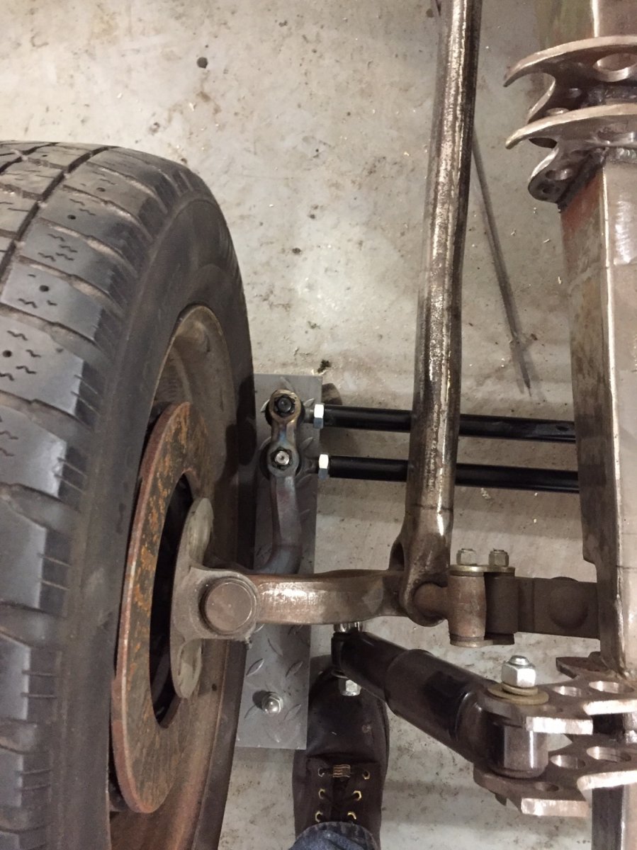

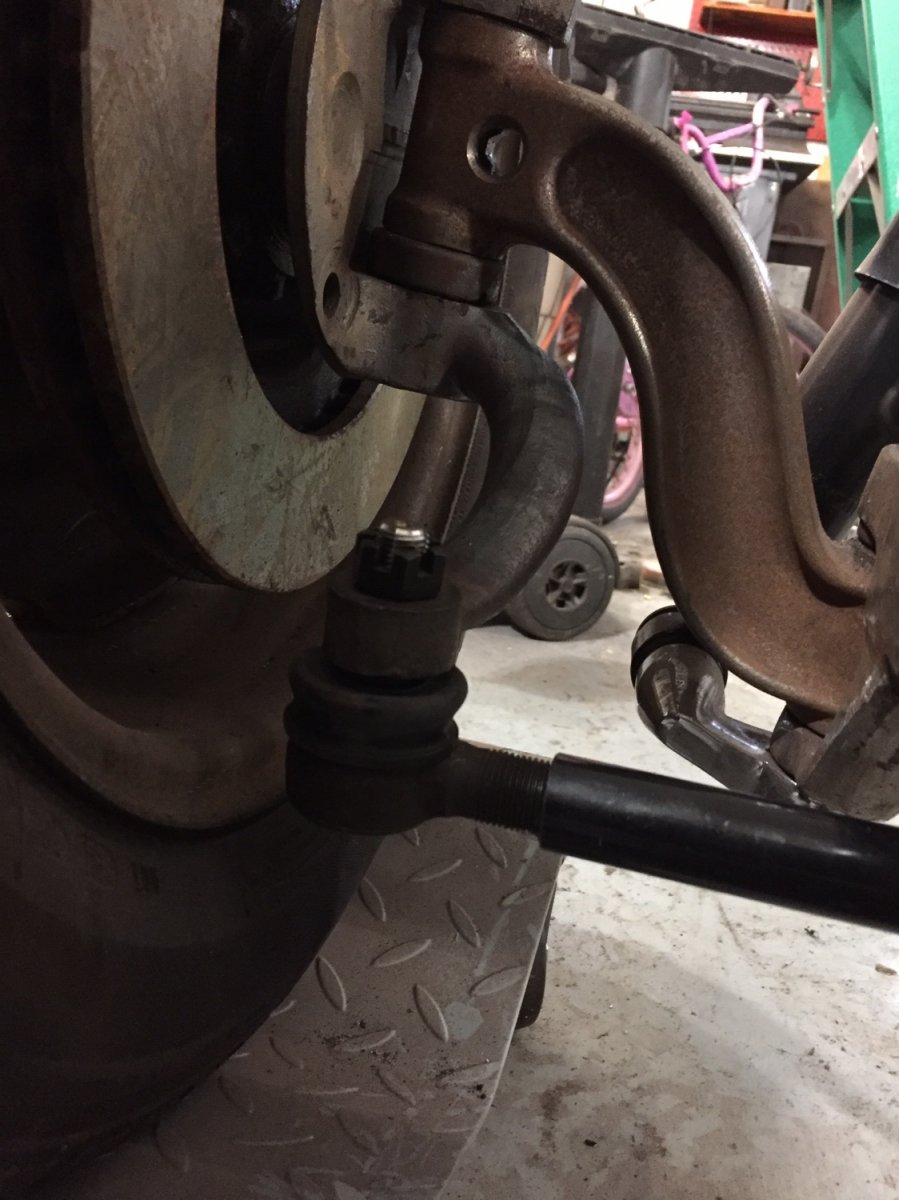

    So not been doing too much. Doings small things here and there. I finally got around to bending the steering arms and got some steering linkage on. I will still need to magna flux them. I also need to get the pitman arm on the Vega box figured out. The ford tie rod don’t fit right. The hole seems a little too big. So if someone knows. Where to get pitman arm to fit the 35 Ford tie rod part number would be great. I did also work on the driver side door some. IMG_2726.JPG IMG_2728.JPG IMG_2733.JPG IMG_2732.JPG IMG_2309.JPG

    Your looking very good and have accomplished a lot. On the pitman arm I am pretty sure ( can not find my invoice) I used Speedway part # 7022924- SS ( stainless $74.99) there is also Part # 7022924-PLN (plain $54.99). Would like to see more pictures on your door repairs. Mine are also ****.

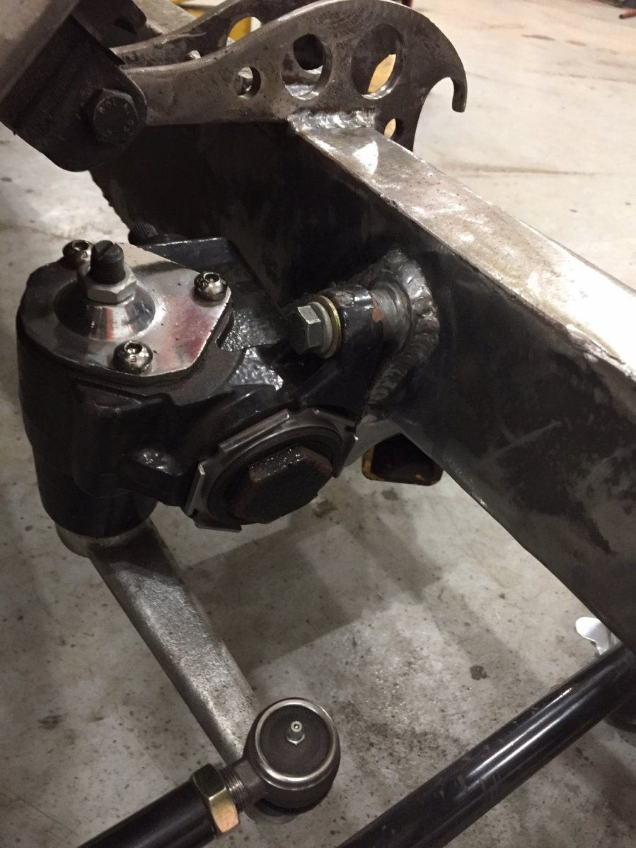

    I got some more done this weekend. I’m slowly picking away at it. I got the steering box mounted and the wishbone mounts done[emoji846] IMG_2759.JPG IMG_2761.JPG IMG_2770.JPG IMG_2773.JPG IMG_2778.JPG IMG_2779.JPG IMG_2780.JPG IMG_2786.JPG

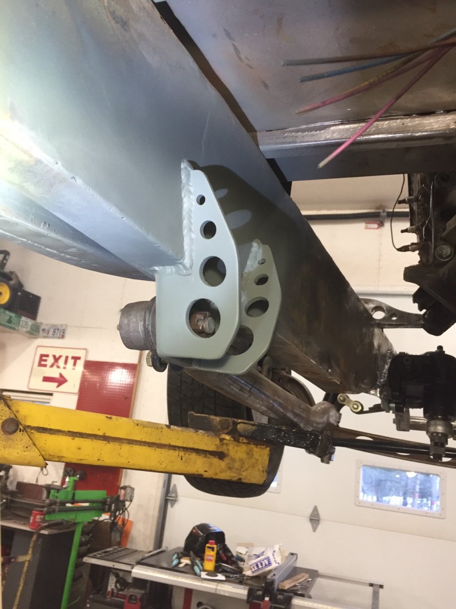

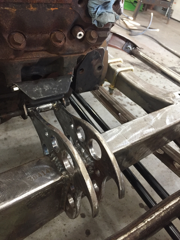

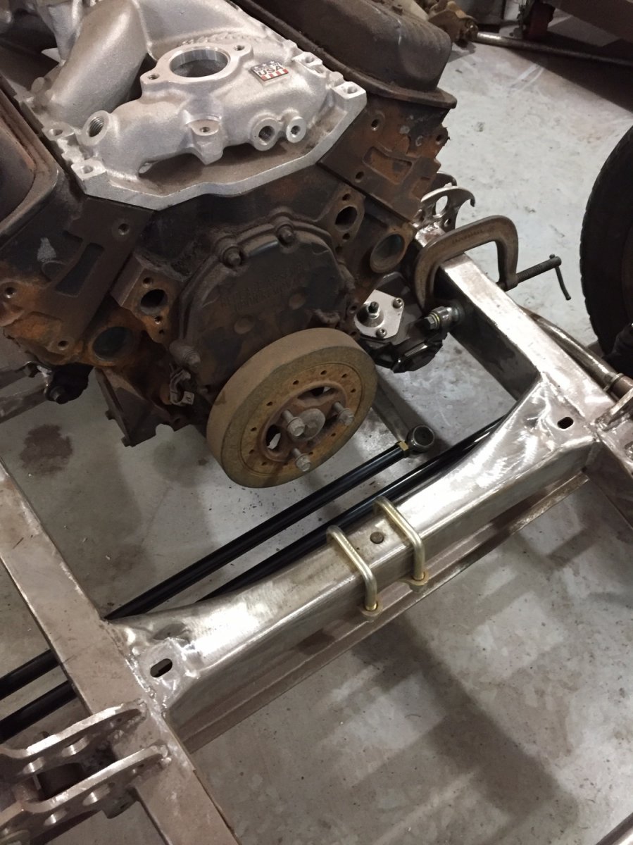

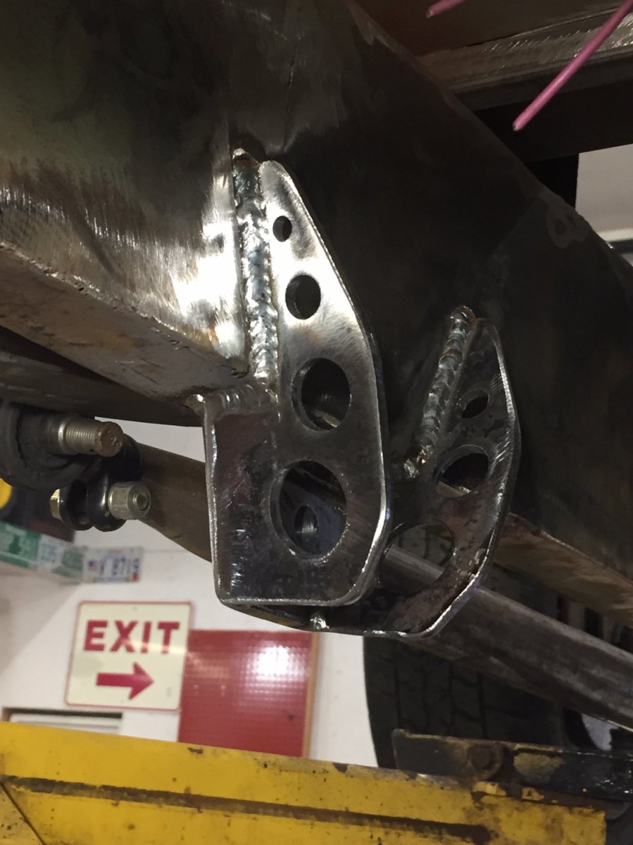

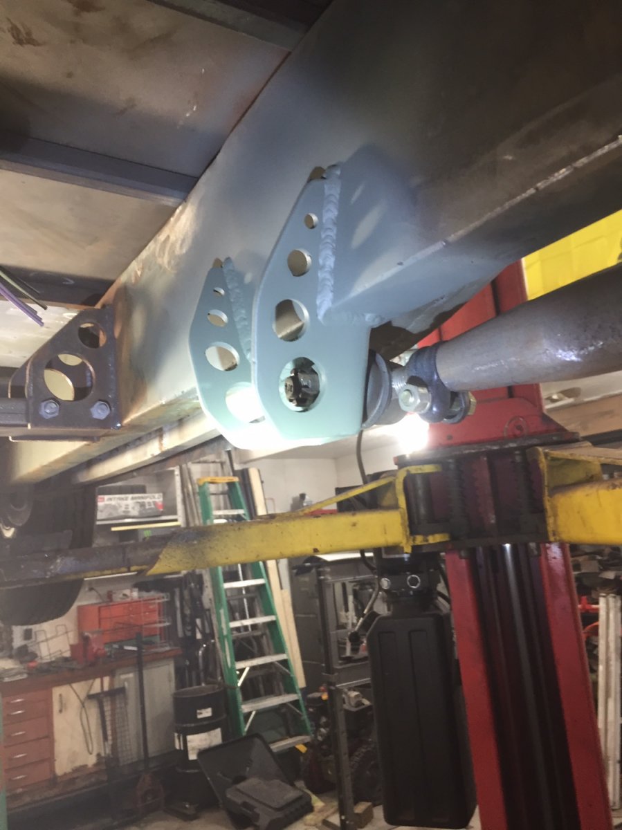

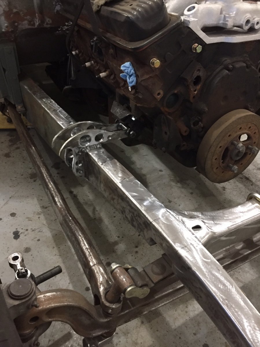

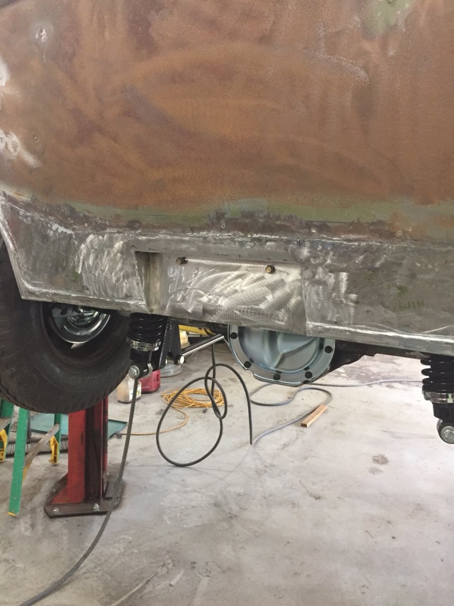

    Today I added a small reinforcement to the bottom of the motor mounts. Some befor and after pictures.[emoji846] IMG_2847.JPG IMG_2845.JPG IMG_2848.JPG IMG_2850.JPG [​IMG][​IMG][​IMG]

    Love what you are doing ! Those mounts are very artfully done -and they aren't going anywhere !
