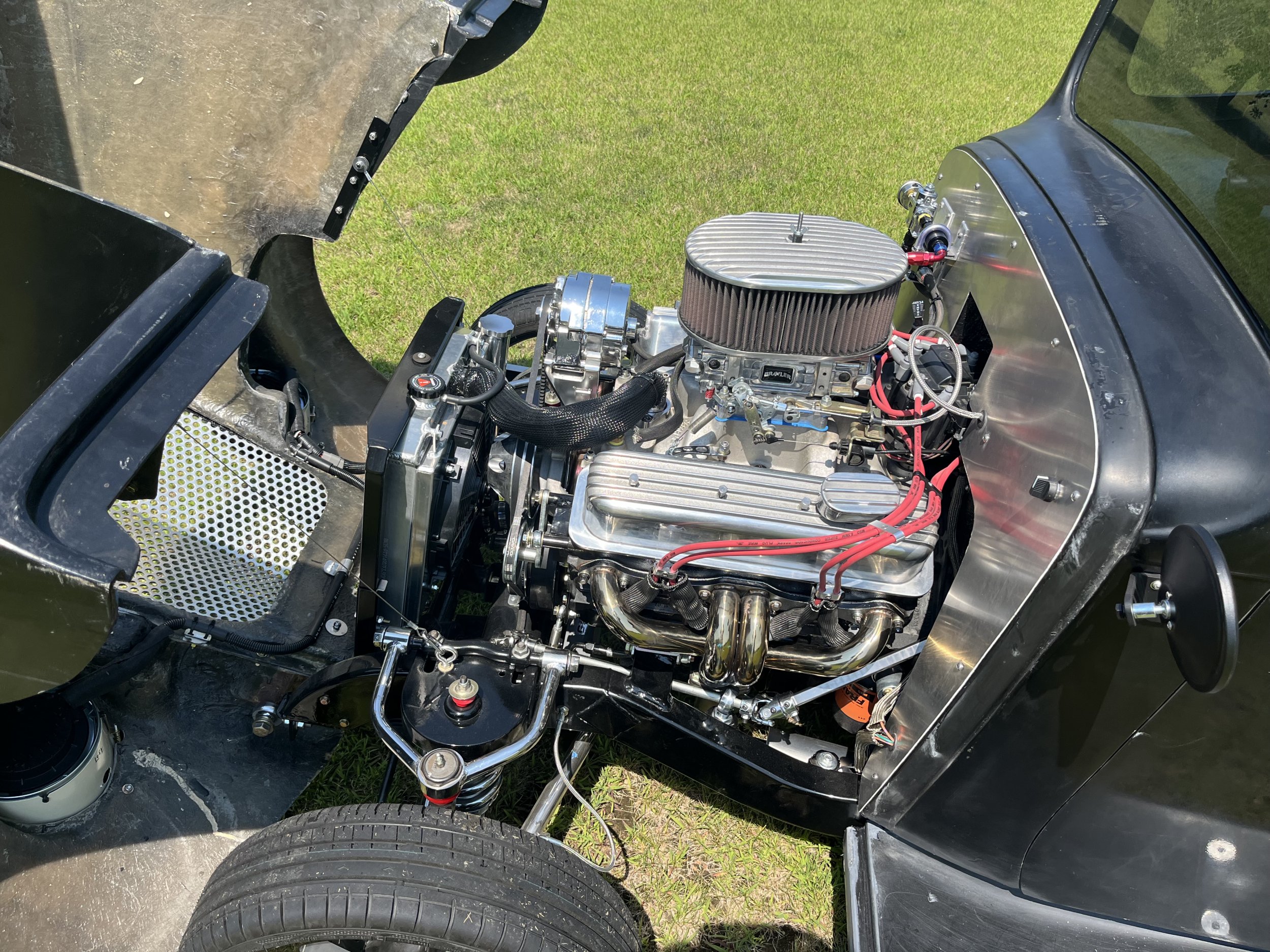

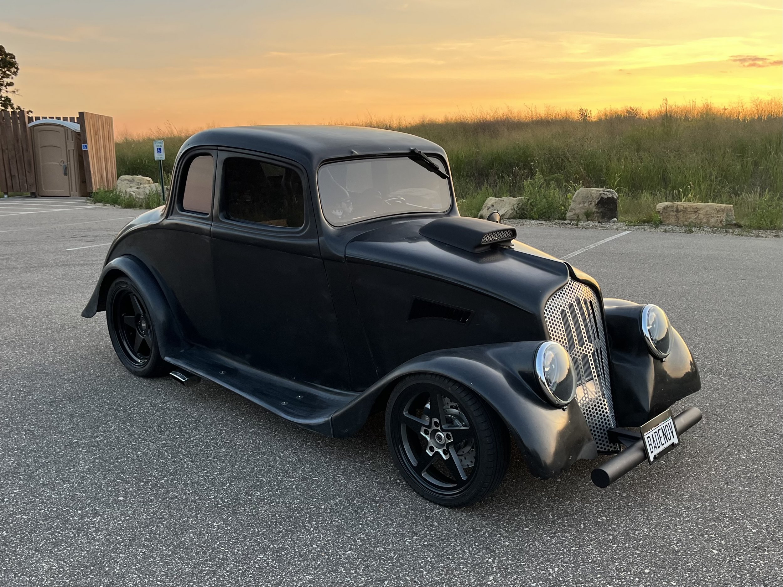

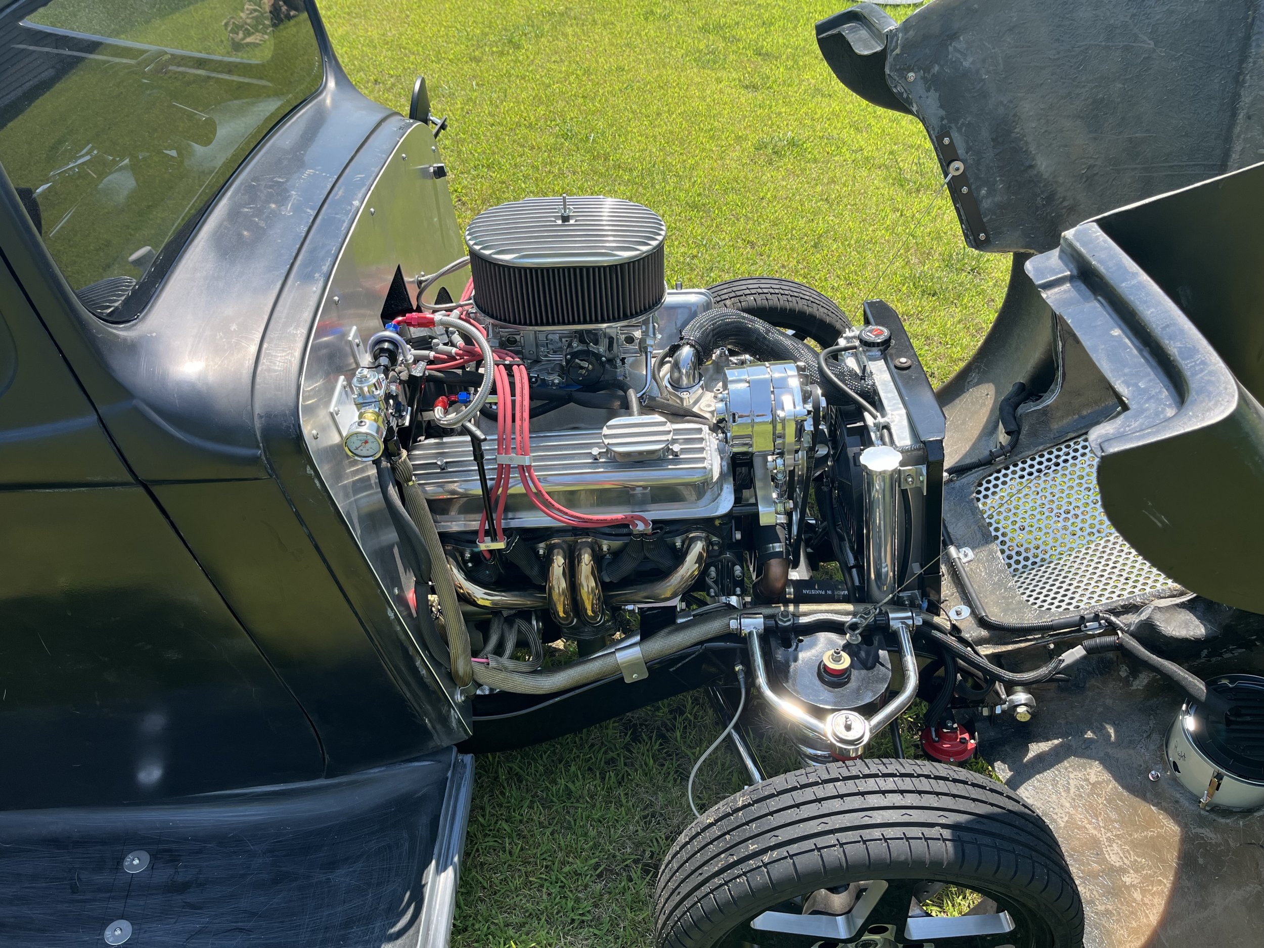

    Got my Willys project running this summer and would like to get it to run a little cooler. Pretty much stays around 200 down the highway. In town or running hard,jumps up to 210-220 and takes too long to recover. Tried 165,180, 195 thermostats, the 195 seems to keep it the most steady. SBC crate motor I used in a prior rod I sold as roller. Always ran 185-190. This car is 1000 lbs lighter, same timing, but the radiator (4 row) is a little smaller. Looking for someone who ACTUALLY has tried adding a larger lower tank capacity to the radiator, and if it helped. The one I’m using now is only about one inch deep, thinking of adding about 3 inches, which would add about 2 quarts capacity. Right now total cooling system is about 12/13 quarts. Been having a hard time finding a different radiator that will fit, can only be about 18”wide x 21” height. Don’t feel like spending $1500 on a custom one, rather say I did it myself.

    That is a tiny radiator but 220 isn't crazy hot. I have a re-cored '30s Plymouth radiator in my ;36 Willys with a 14" blower fan an my 354 hemi runs in the 195-210 range, mostly @ the lower end. '35-'36 hoods are taller than '33-'34 hoods but it looks like you could fit a bit taller radiator in your car?

    Yes, your hood looks 4-5 inches taller, think I’ll add on to the lower tank, if that doesn’t help I will have to buck up and have one made. Cheapest ones I could find were about $600, but that still sounds better than $1500. Thanks

    Adding to the tank won't do much, it will only delay the time to heat all the water. You probably need more core area. It looks like you could go taller, but then the shrouding will need rework. I have a '39 Willys with '41 front, they too have limited grill area.
