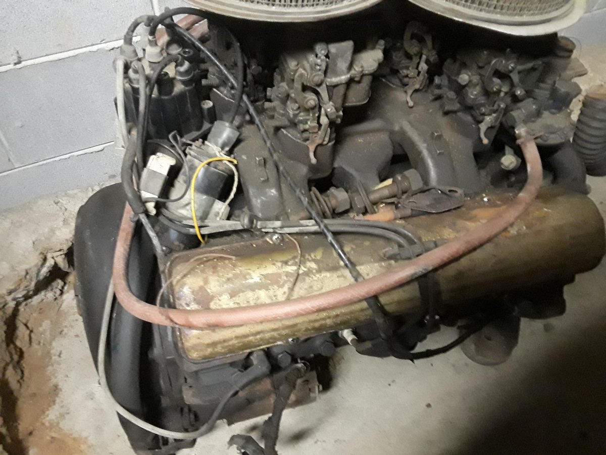

    I got a 1956 365 with 4 dueces.
    joshuajardine, TERPU, ls1yj and 3 others like this.
