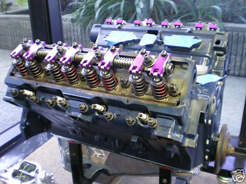

    Unfortunately not mine...
    ls1yj, Mike Paul, warbird1 and 3 others like this.
