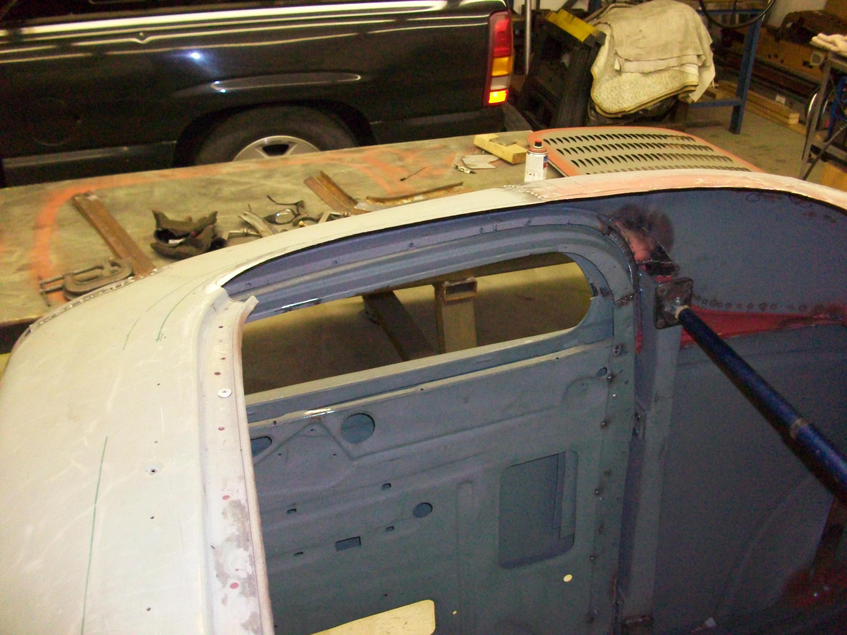

    Got the roof corners repaired and welded in as best as I could. Will be able to tweek them a little more now that they don't bounce all over the work bench as I beaton them. I needed to get the door tops in place in order to adjust the roof gaps. The metal in the roof was damaged and then hammered on so much that it has a lot of spring back. I just wish it would spring back into the original shape.
    The window opening is about 5". [​IMG]

    Progress is slow or maybe it just seems that way. I keep choppin but there ain't many chips flyin.
    Been working the door top and A pillar on the drivers side. Not looking forward to doing it again on the other side. At the same time I'm making small repairs to the roof above the door.
    I am very envious of the guys that have done this chop on a car with a decent body. When done this body will have very little of the original sheetmetal left on it. Just the doors,trunk lid, and the rear roof section. Every thing else has been replaced and I have work to do on the rear roof yet to come.

    Work has been going slow. Lowering the roof only took one day. Then comes all the little nit-noid jobs.
    I reinstalled the structure under the forward roof that has the W/S hinges and wiper motor mounts. Got the W/S hinges in, the scissor in adjusted and working.
    Now have the roof area around the door tacked in. Made them from extra 35 sedan roof left-overs. Still need to make and tack in the jams pieces.
    I am using steel B pillars instead of the original wood and planned to support them with tabs off the roll bar. The B pillars support and hold lateral alignment the body. I intended to install a roll bar anyhow so now it will also provide additional support to the body. Saving the door work till last. I have a pair of Waldens Speed Shop inner door braces and I'm looking forward to installing them and the new skins.
    I set the hood and grill in place to get an idea what the profile will be and I like it!

    The roof around the opening was distorted and cut up. I removed the channel and dollied the remaining lip. The channel from a 34 4dr has the same profile as the 3W so I cut pieces from a 4dr roof I have and welded them in. The louvered roof insert was then welded in as well. Things are looking better, not good, but better. The area around the insert still needs more work.
    Decided to clean up the shop floor from all the grinding so I moved the car out on to the driveway and nosed the 5W up to it for fun. Big difference in build style.
