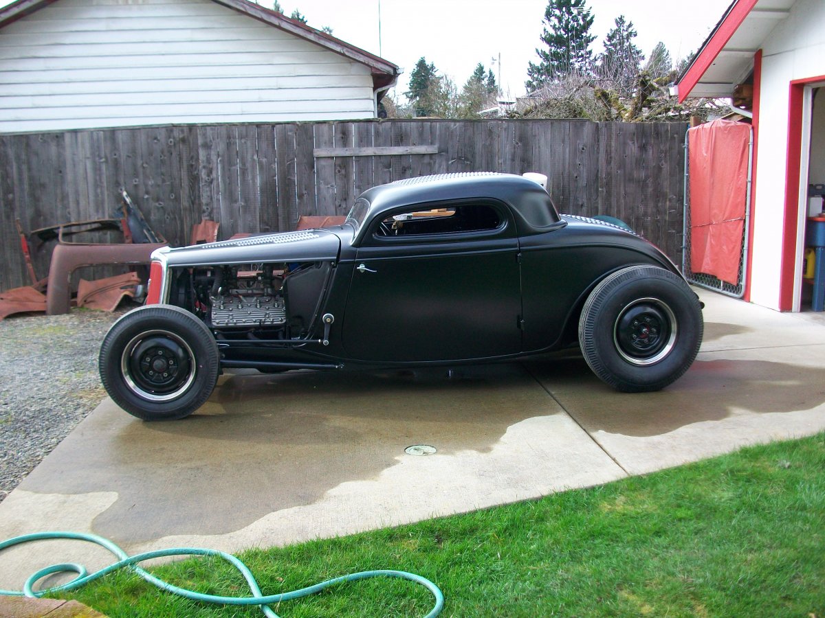

    Thanks guys for the kind words. Always gratifying when your peers appreciate your efforts. The doors, deck lid, hood and inner fender panels are now getting final sanding for color. The louvers are a serious pain in the ****. Will post more pic's soon.
    The belt line and sail panels took a lot of work. I used a nail gun and dent puller for days to get it as close as I could. I then turned it over to my friend to finish the hammer and dolly work. He is a wizard.
    I ran the engine today and it sounds healthy as hell. This thing is going to be fun! Would love to make it to TROG in Pismo Beach.
    I'm going to let the SAR body go. I always wanted a full fendered, unchopped 34 3W but I'm happy with the chopped one.

    I pulled the 34 out of the shop so I could run the engine for an hour. I put the clutch in for the first time with the engine running and heard a defining scream. So it looks like I'll be taking a big step back and pull the trans out to get to the T/O bearing. Very Frustrating!!! 100_1082.JPG

    I had new throw out bearings with a short life. They don't seem to last anymore. Even when they are backed away from TO fingers!

    Way ahead of you, I made sure that when the left tire just touches the wish bone, the door still clears the pitman arm. Interesting that you caught that though.

    AGO - I think I know the issue with the T/O bearing. I'm using a diaphram pressure plate and flathead T/O bearing. I think I need to replace the pressure plate with a flathead 3 finger type and match it with the throw-out bearing. I'll know better after I get it apart.

    Jimmy, Thanks for the pic's. I think your right, his chop is about the same as mine but you can see that windshield is laid back a bit more. Very cool and functional for Bonneville.

    You guys have made my day, thanks. I have the complete hood but want to wait till I have the engine sorted out before putting it on. I just laid the tops on for the pics.
