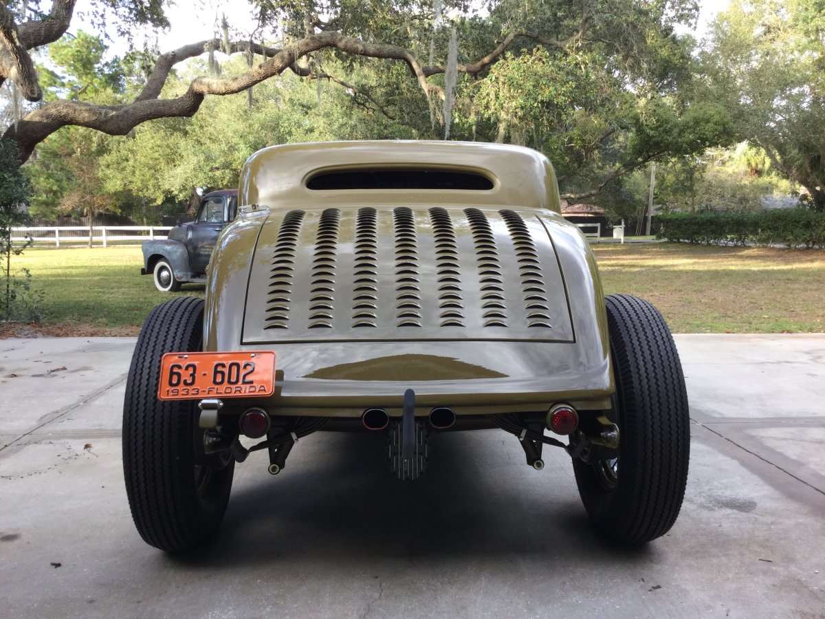

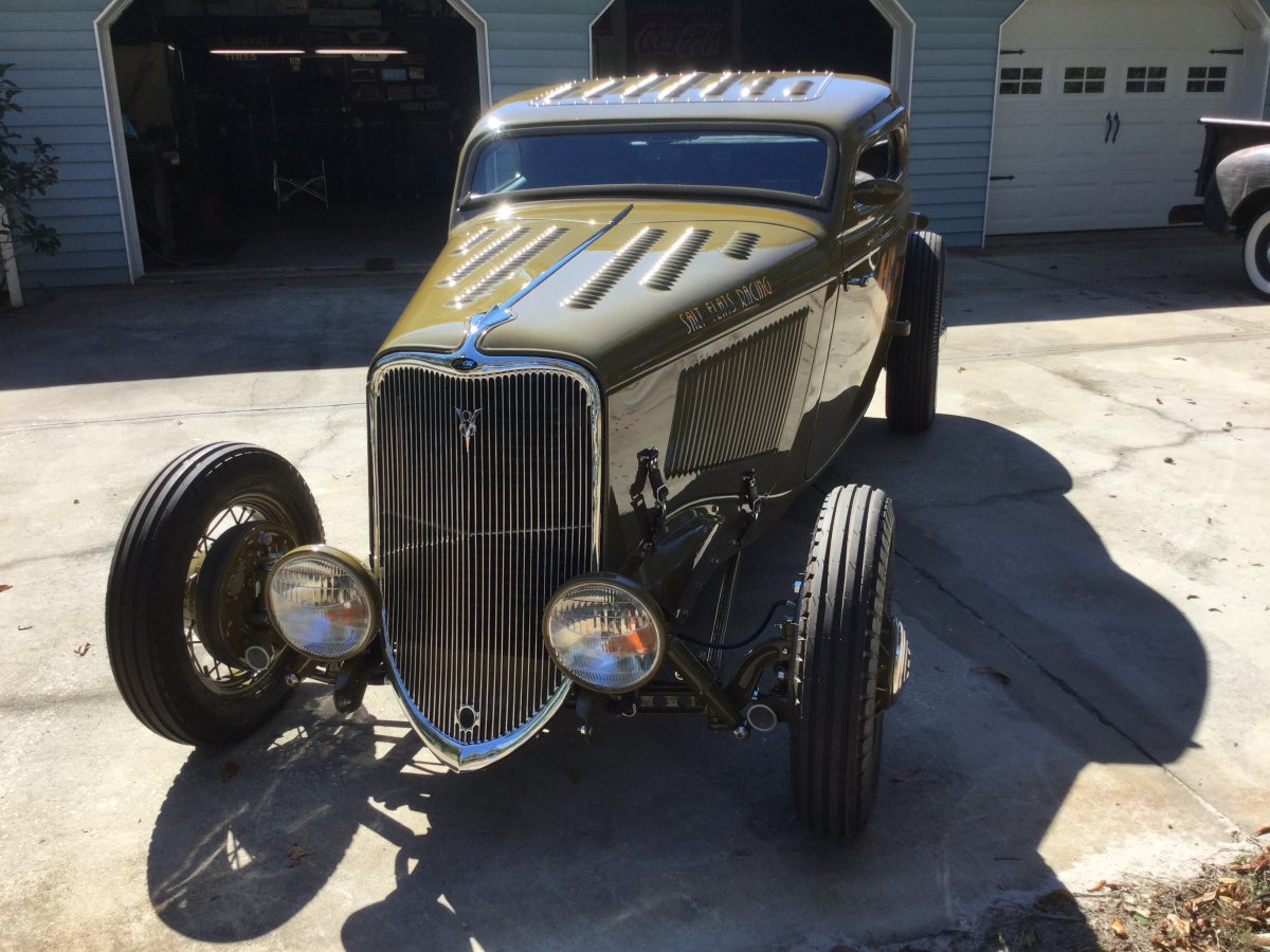

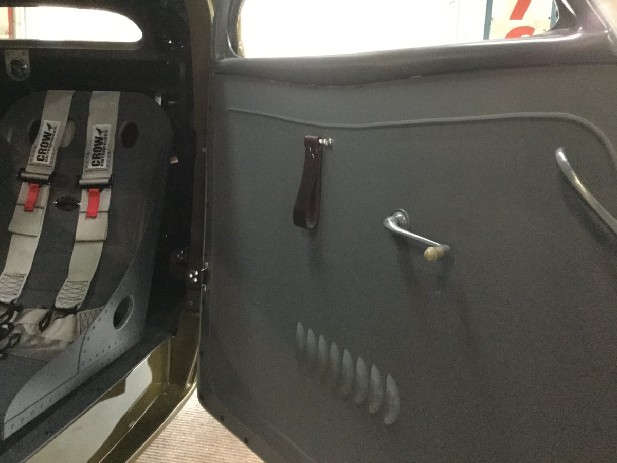

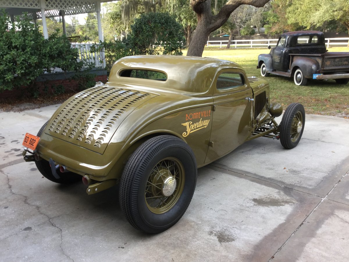

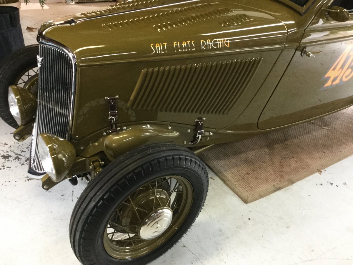

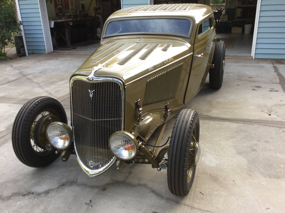

    Love your 3w. Here’s some photos of my recent build. Looks like I’m in good company! I build about two cars a year , and this one went to OK. about a year ago.

    My car bad 34.jpg as it is today. Yours is incredible!

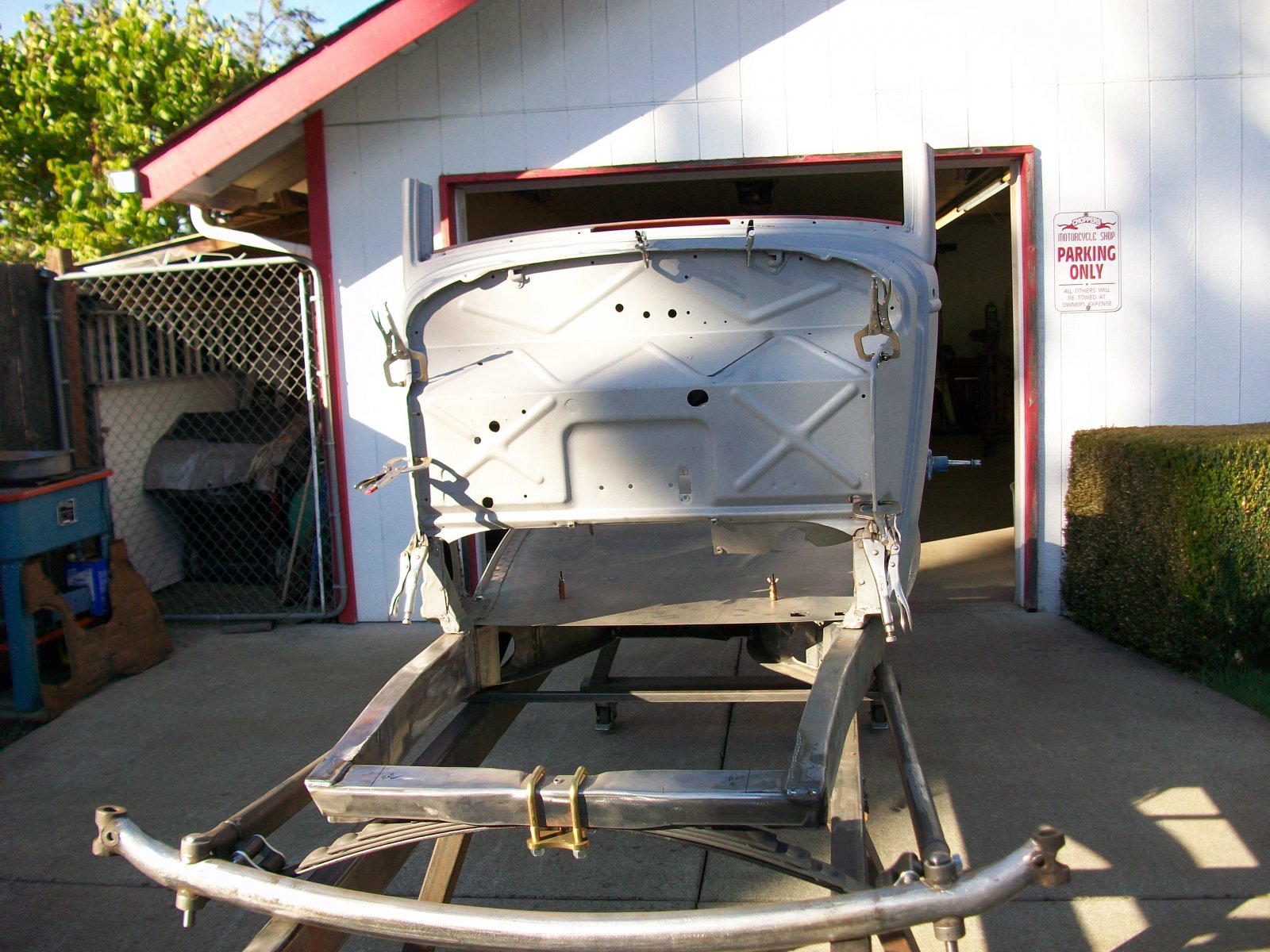

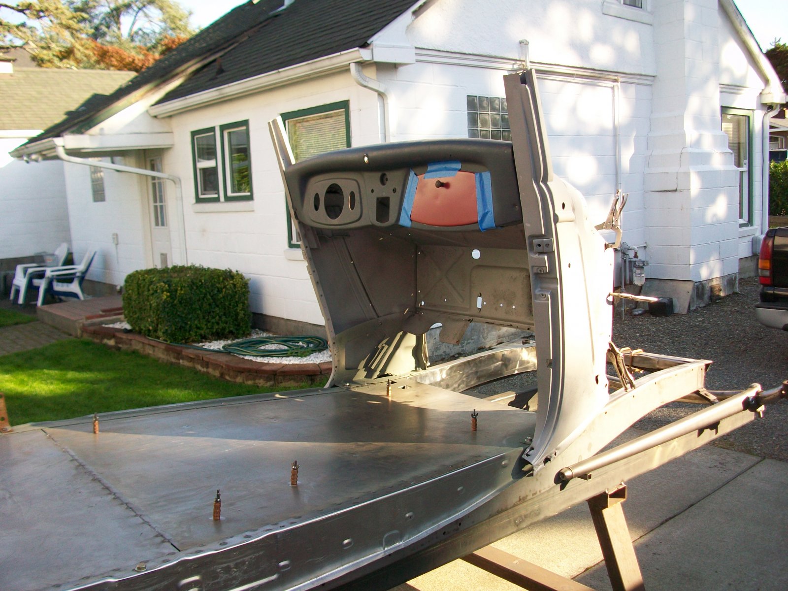

    I have the new frame put together and a quickchange mounted. The front will be a spring behind with a V8 60 axle. I cut the center out of an aftermarket crossmember and used it to make a flat one that is mounted at the top of the frame rails. This is very close to what I have done in the past.
    I am also finishing up on the build of a Mustang Bullitt so the 34 project has to share my tome. 100_1295.JPG 100_1300.JPG 100_1307.JPG

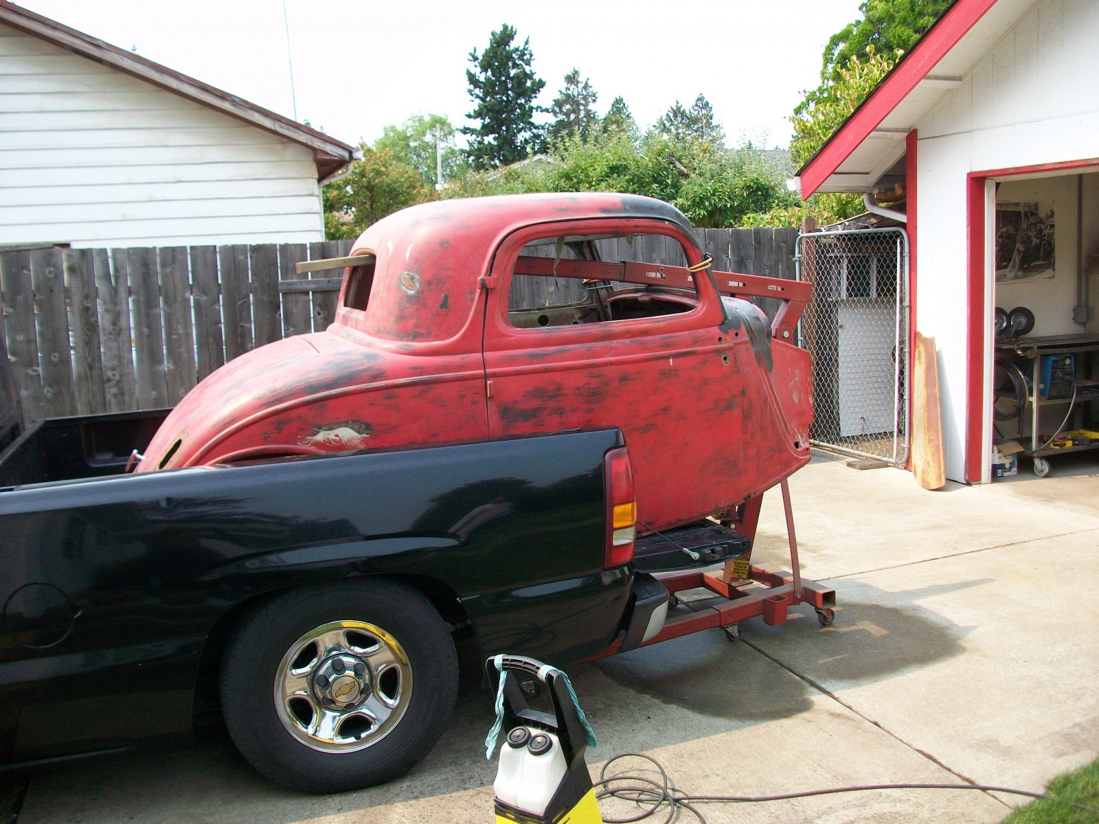

    I removed all the wood from the body and will be taking it to the strippers to totally clean all paint and rust out. I'll have nice fresh metal to work with.

    100_1344.JPG 100_1345.JPG 100_1347.JPG So, I loaded the body and small parts up and drove down to Portland Oregon to get it dipped. Had a quote before I left and thought it was high but probably worth it. After unloading at the stripper, the price more than doubled. Said FU and brought the car back home. Having it blasted locally.
    I have the new floor mostly done. Used Tom Bays subrails and sheet metal from a local supplier. Since I will be chopping it I decided to go ahead and cut the cowl section off and get it mounted to the new floor. It will be easier to work on it while its on the frame rack as well.

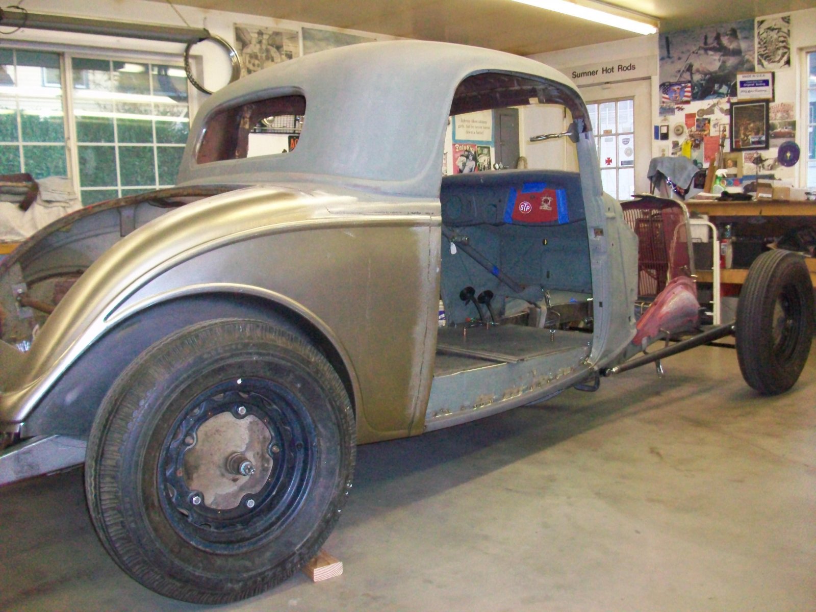

    Getting ready to channel the body 2 inches. Never done this before so I'll be going slow and take my time. My other chopped 34 was channeled 2 inches but that had a Don Smart full floor. I'm no Don Smart but I'm going to give it a try. IMG_0770.jpg IMG_0771.jpg IMG_0291.JPG

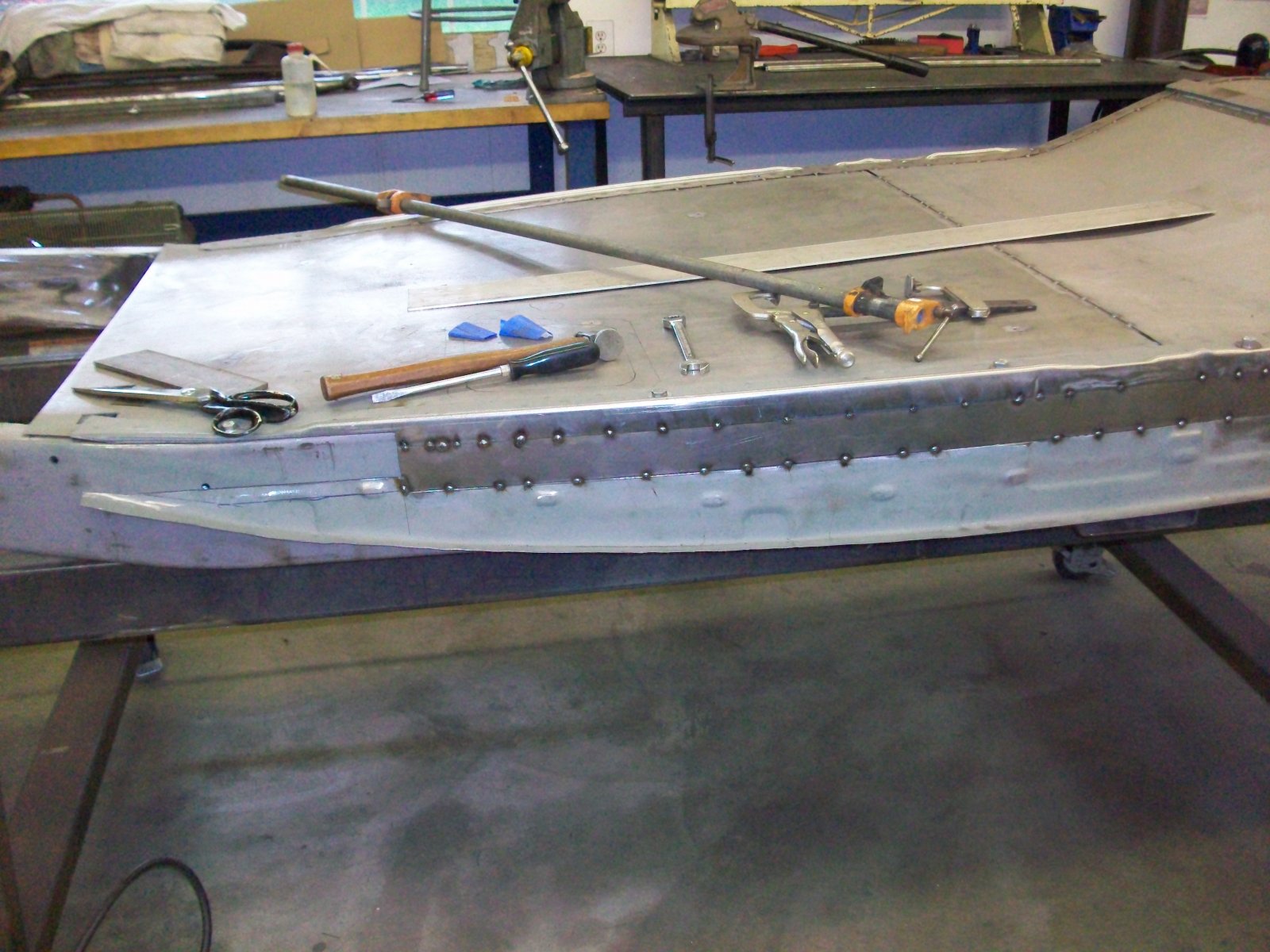

    Almost done with the 2" channel. I started by modifying the feet of the cowl. Then cut and tack weld in the 2" strips in the sub rails. Then bolt the cowl back on the floor that is solidly bolted down on the frame. I could then put the rear body in place and start tacking everything in so nothing would shift. I'm currently working on the rear floor area so it will flow together and not look cobbled together. I'm very happy with the progress so far. By the way, I did put both doors in place with gaps set dead nuts before tacking the cowl and body section in place,(very important step).

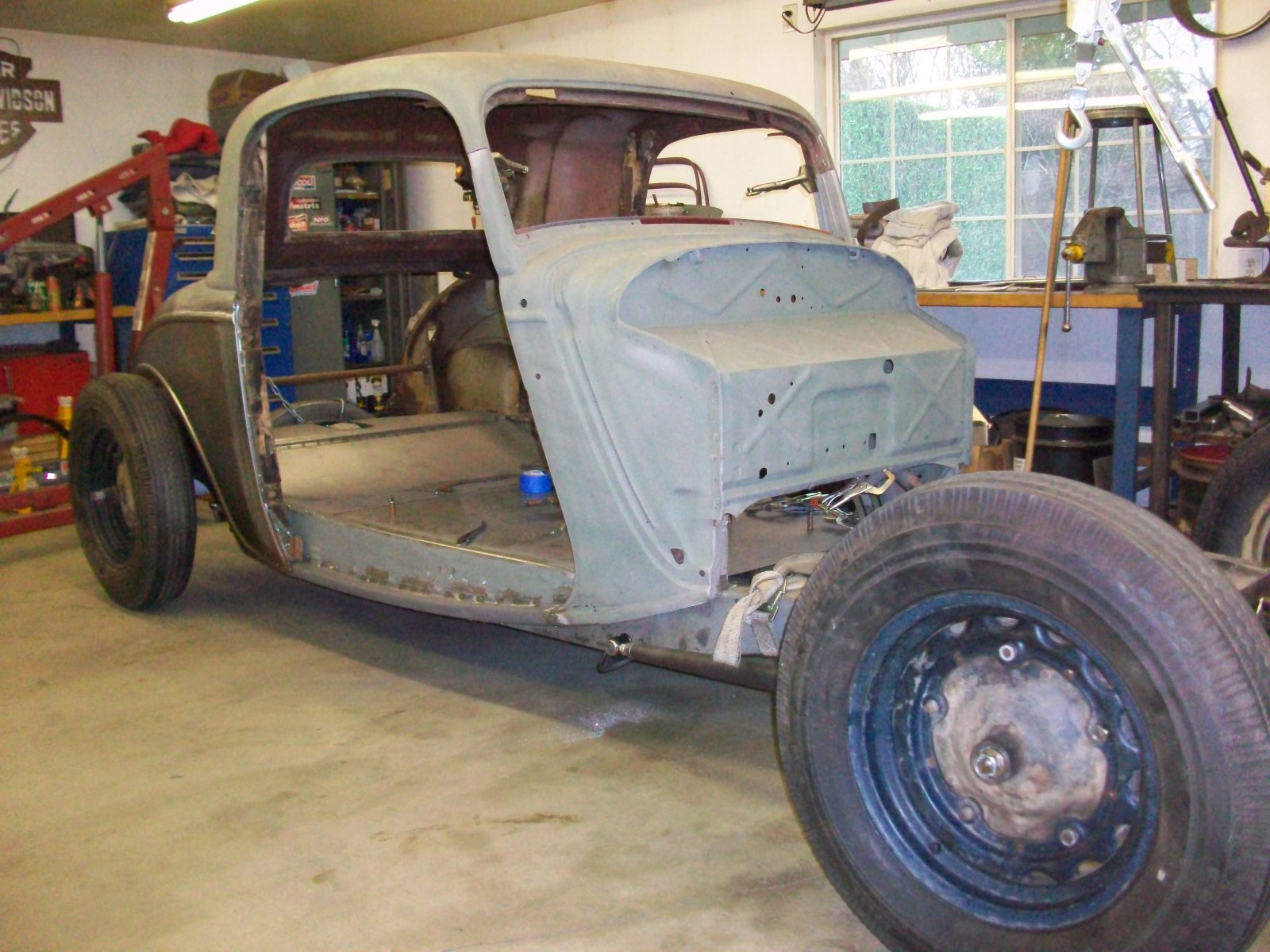

    I decided to ***emble the car as a roller so I could see how the stance was going to look. I think it's going to be just right after the engine, trans and other weighty stuff is installed, so I; ok with it at this point. Checked my windshield frame and it is too nasty to use so I'm 100_1362.JPG 100_1360.JPG on the hunt for a good one! Anyone have a good one?
    Not sure about the wide 5's look but I'll use them to roll the car around in the shop.

    After I posted the pictures, I see I forgot to point out that all 4 tires are 600X16s. The stanse will be very different with 550X16 front and 750X16 rear.
