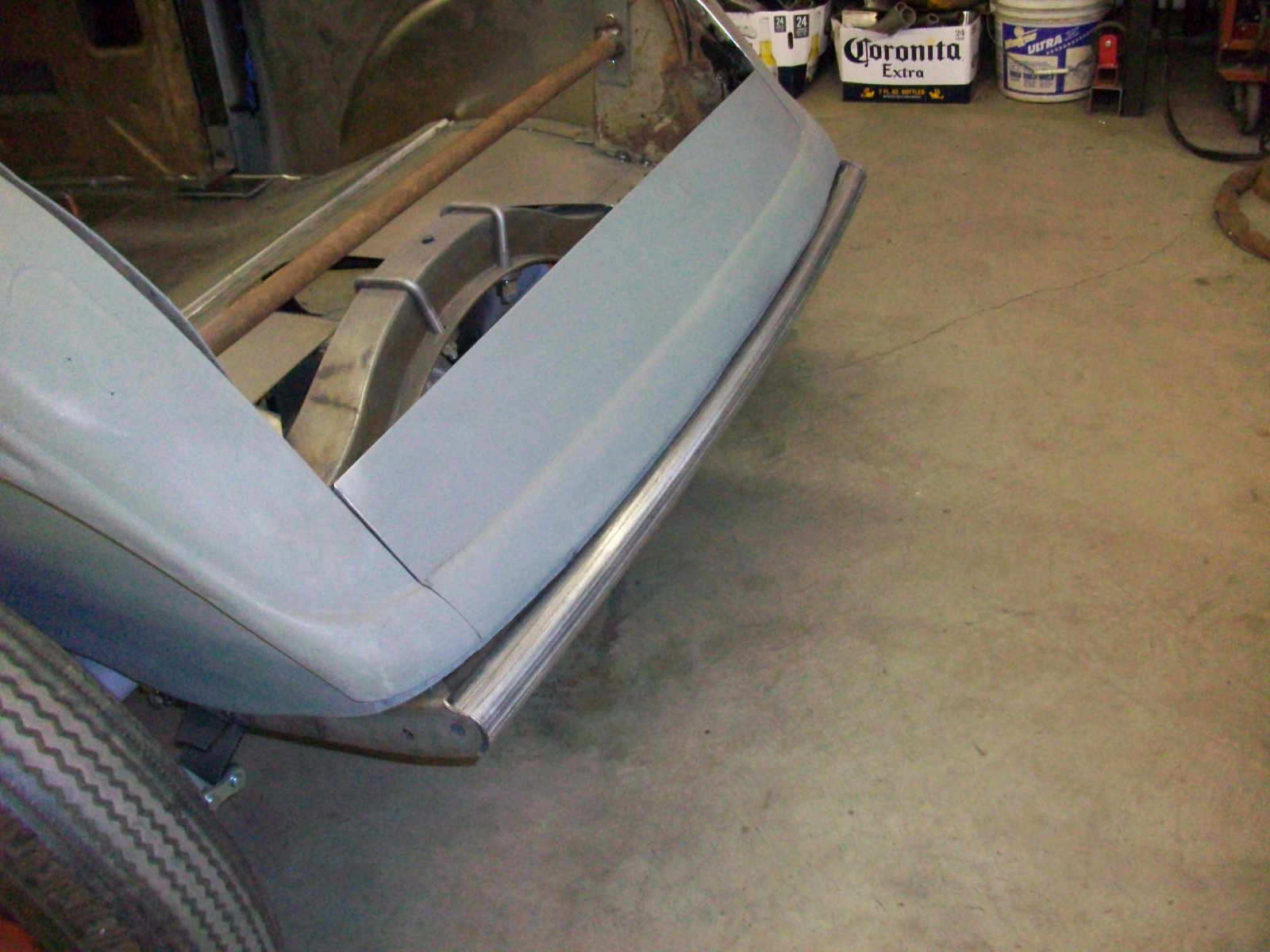

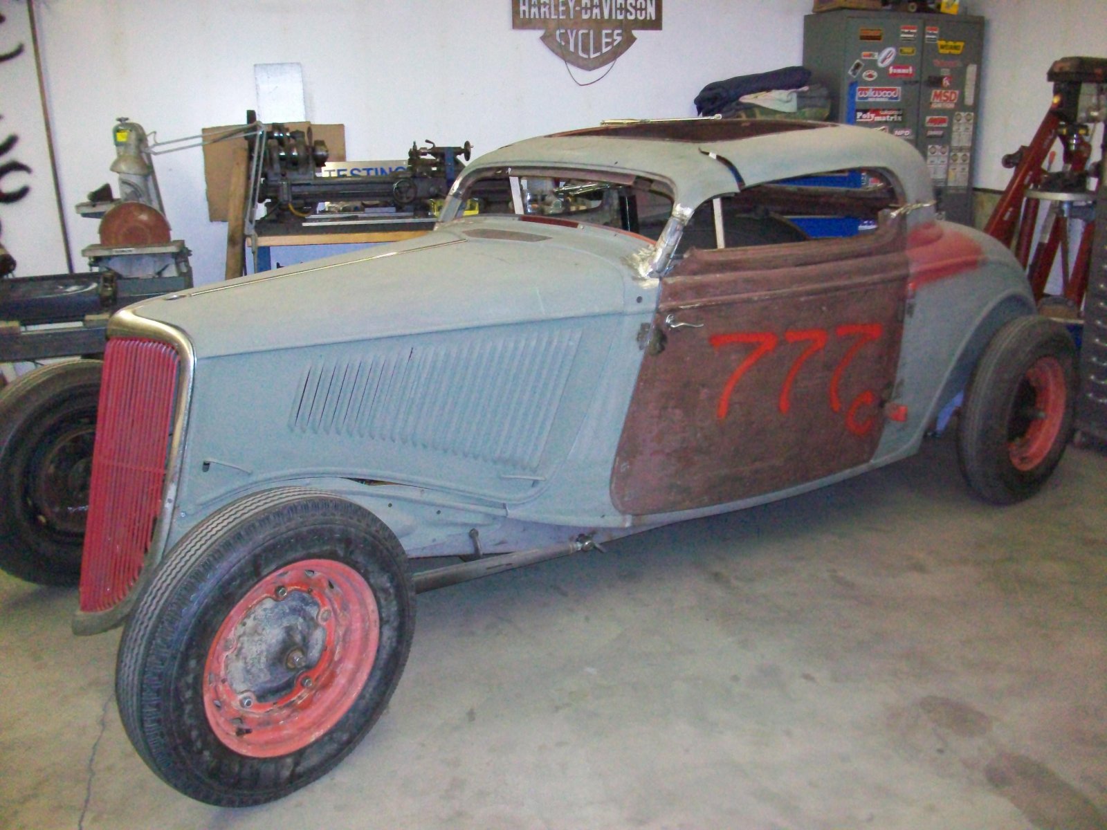

    100_1406.JPG 100_1409.JPG I had the 6 in chop about half done when I got the stupid idea to take another 2 inches out. So back to the drawing board. It will start to take the look when I get the door tops in. I have the roof insert panel in Pheonix with Chip Quin getting the louvers done. That will help the final look. Rear window was 4 in and now 3 inches.
  7. panhead_pete
    Joined: Feb 22, 2006
    Posts: 3,718
    panhead_pete
    Holy cow Xman, no going back now. :)

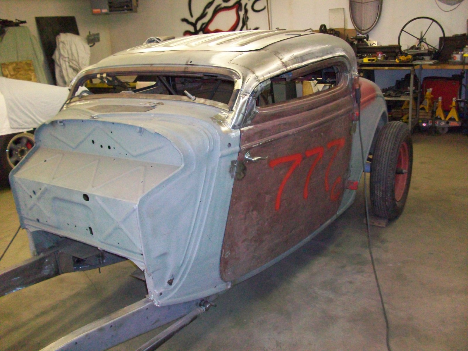

    Got a little more done on the chop. Must say, taking this much chop is creating issues I never ran into with the 4- and 6-inch chops I've done in the past. Bought an english wheel in order to make the skins above the A pillar. Just started fitting the door tops.

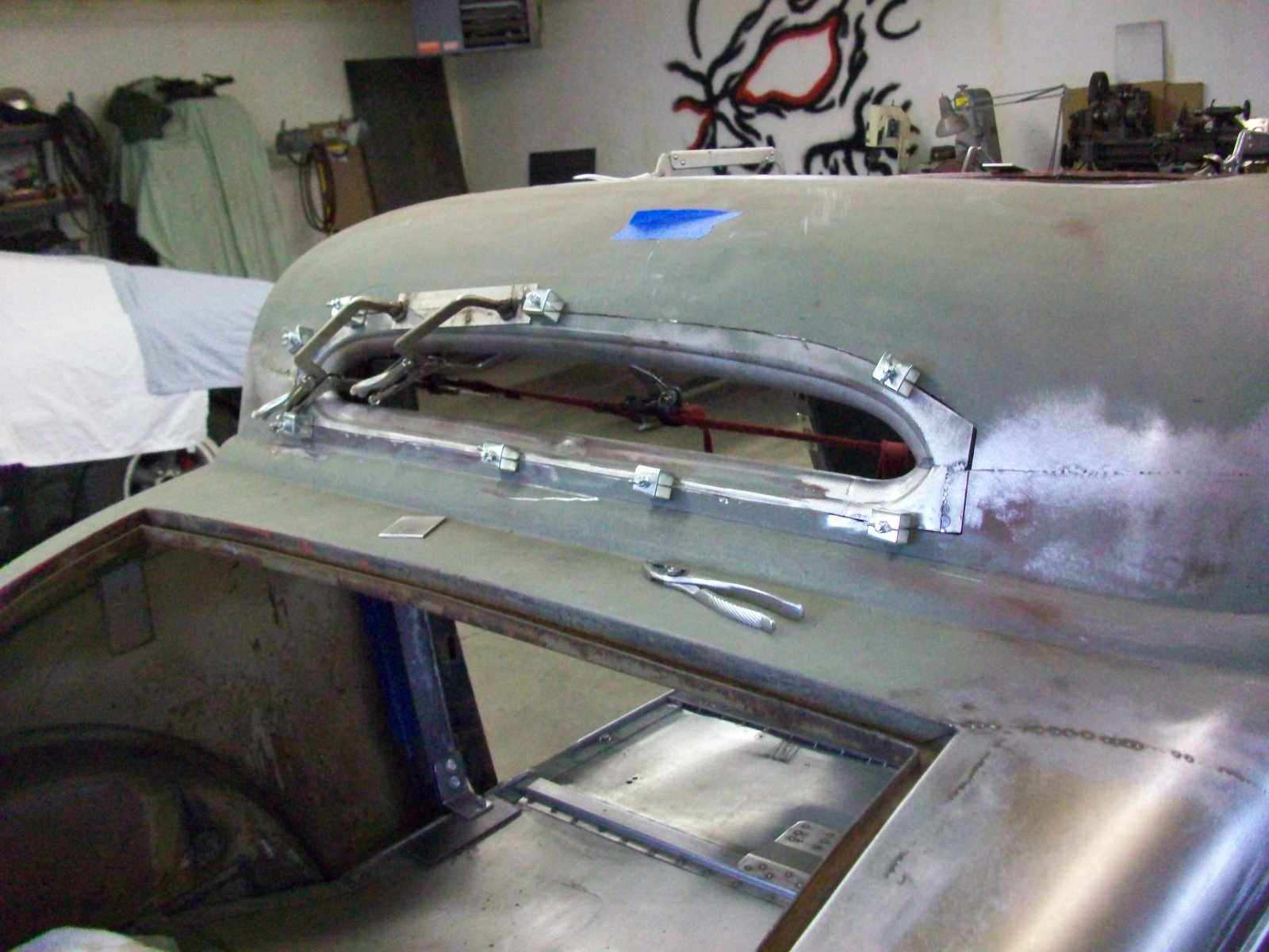

    Not working on it to hard but have made some progress. Got the roof panel welded in, the trunk lid and hood louvered, engine is ***embled with Navarro heads and intake. I'm getting ready to put in a floor section forward of the B pilers and mount the new Schroeder cowl 100_1450.JPG 100_1452.JPG 100_1457.JPG 100_1456.JPG steering.

    Looks good, good to see a flathead in there. I like the looks of that intake too, looks like you could still get a center-mount generator on there without interfering with the carbs.

    Yes, a generator dose fit center mount. I took the gen and magneto off to lighten the engine up for mockup.

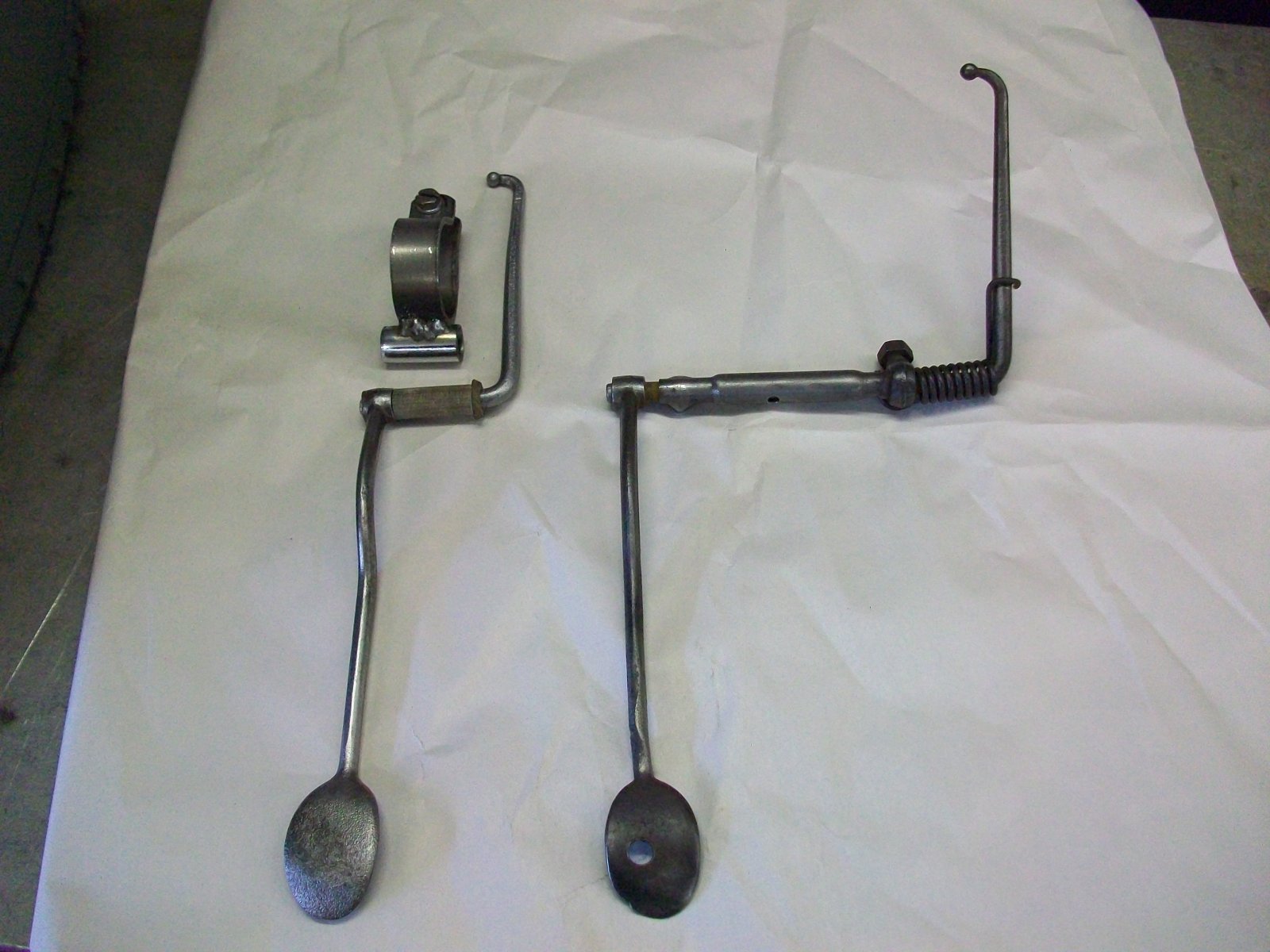

    I cut the front floor section out, didn't like it. Now have the new floor installed along with the toe boards and trans tunnel. I was a little concerned about how to mount a gas pedal. I came up with the idea of using one of my s**** throttles and cut it down and mounted it to the schroeder . It's going to work perfect. clears the brake pad and tunnel.
    Put it off long enough and have been working the door tops. To my mind this is the hardest part of chopping a 34 3W. 100_1466.JPG 100_1465.JPG 100_1481.JPG 100_1474.JPG
    rod1, Tman, Just Gary and 6 others like this.
  15. Squablow
    Joined: Apr 26, 2005
    Posts: 18,506
    Squablow
    Coming together nice! I like the pedal mount, as long as that's a comfortable spot for your foot I see no reason not to do it like that. Space is always a factor, sometimes you've gotta get creative.

    Everything has to be moved back due to the Schroeder steering gear needs to be mounted right where the stock pedals were. The 34 3W I built before this one had the throttle pedal mounted on the trans tunnel. It was a little awkward to go from gas to brake. I'm fixing several issues like this that I had with the other one.

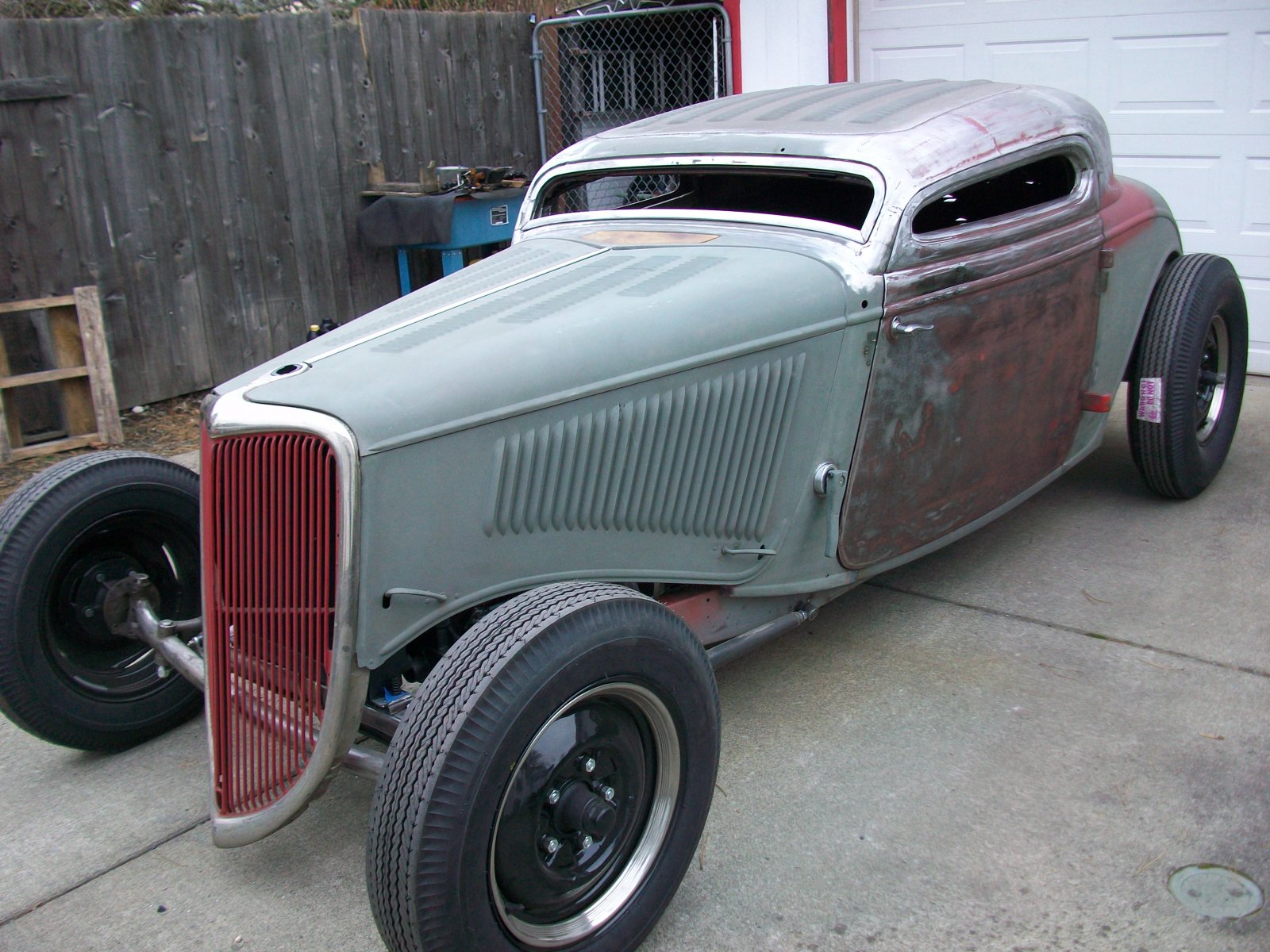

    Pushed the 34 outside for a couple pics. Gives me wood! 100_1488.JPG 100_1489.JPG 100_1491.JPG 100_1492.JPG

    Shazam! Makes my 5 window look like a school bus! What a stunning profile!

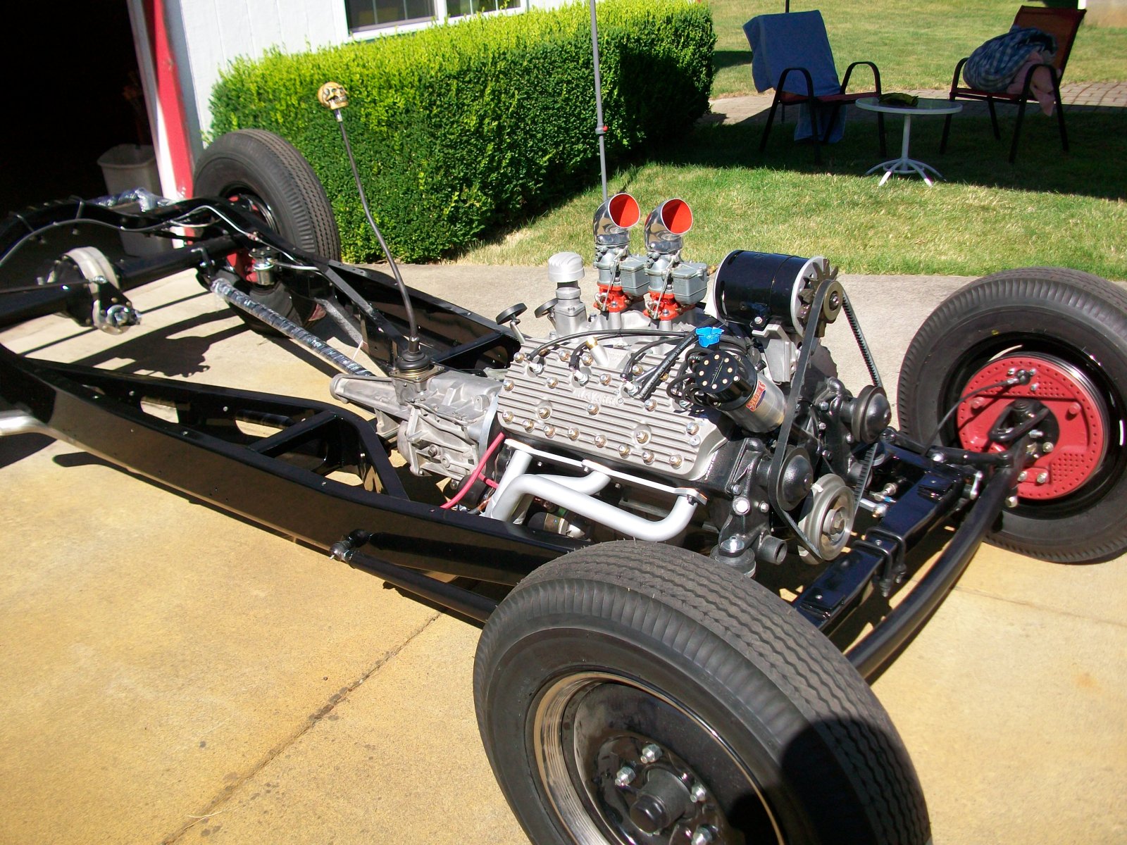

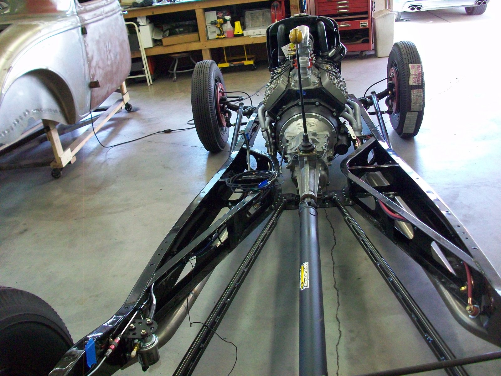

    getting the ch***is done so i can put the body back on and run the engine. Trying something a little different for me, I built the exhaust system using 3" oval SS tubing running under the frame. 100_1504.JPG 100_1506.JPG 100_1504.JPG 100_1520.JPG 100_1518.JPG

    Some fun now! Looks Great.

    Squablow
    That's lovely. I like the lever shocks up front too, not sure if I noticed that before. I have similar ones on my T.

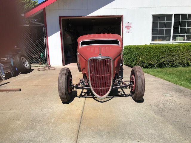

    I ran the engine, runs gret, idles nicer. Very loud, too loud! Not going black this time. dan 34 side.jpg dan 34 front.jpg
