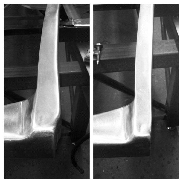

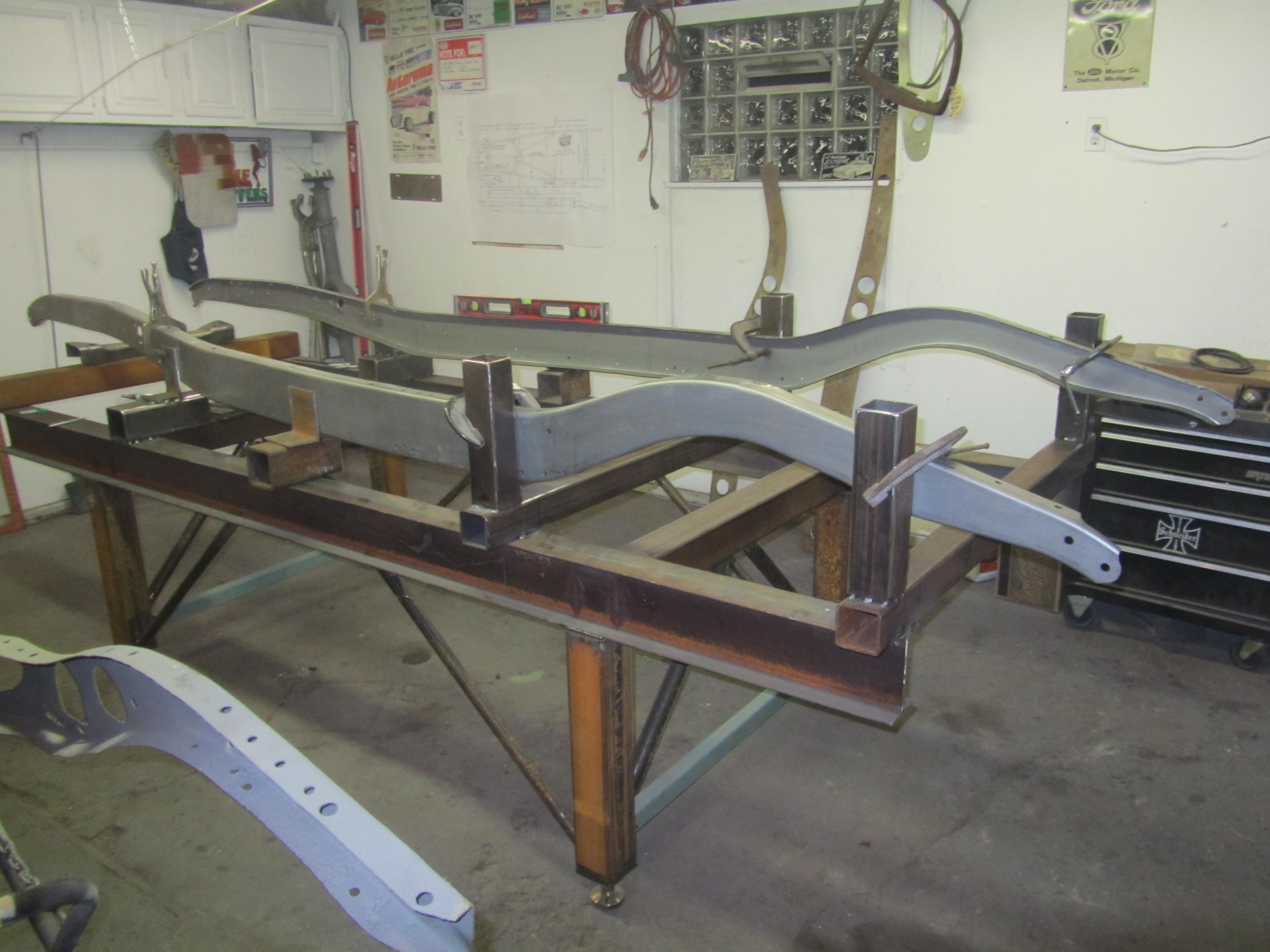

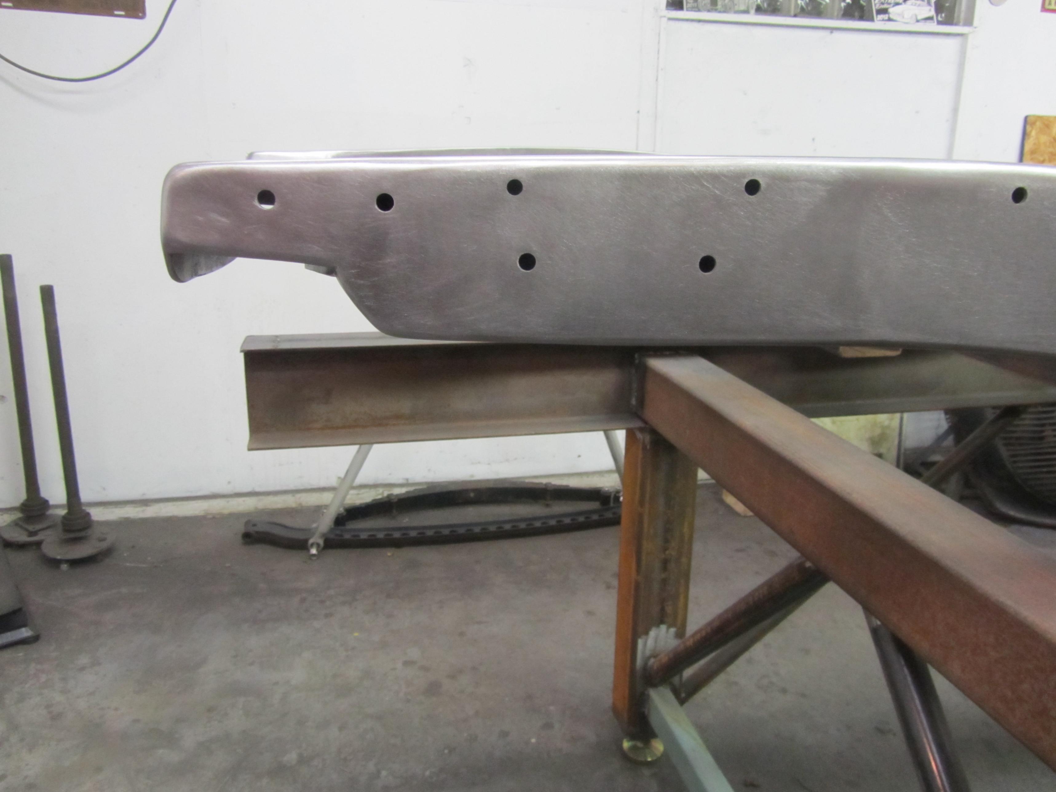

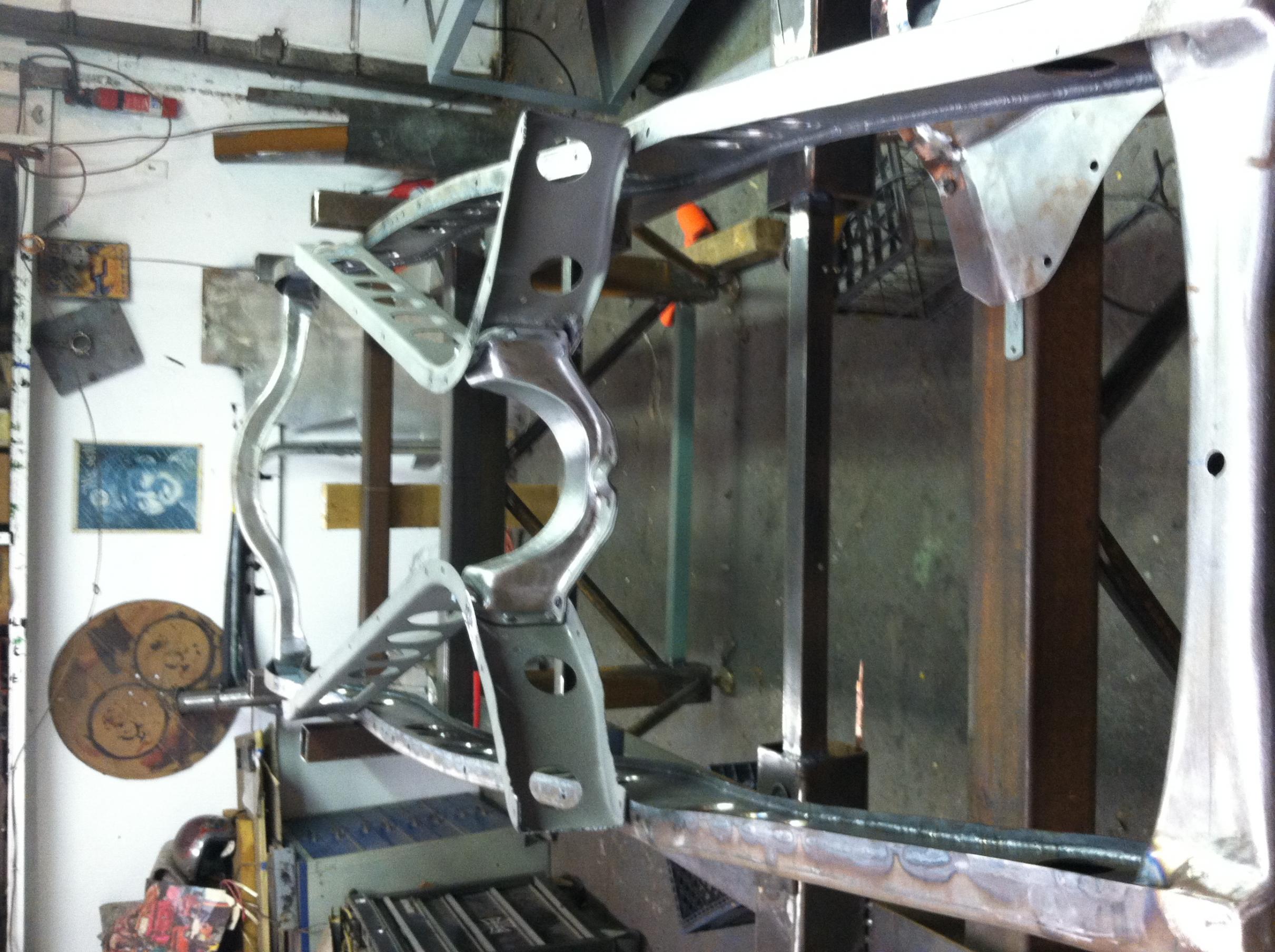

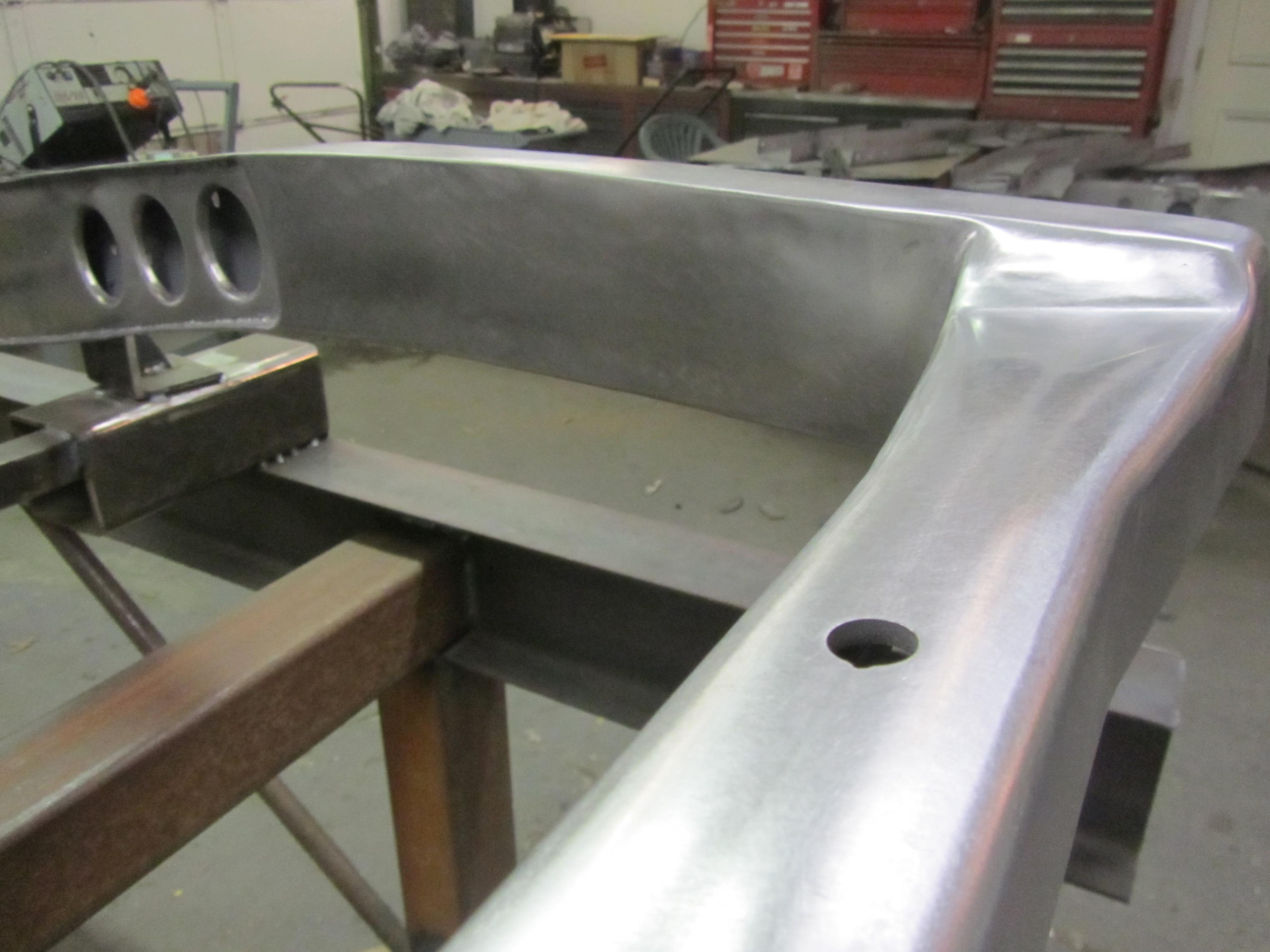

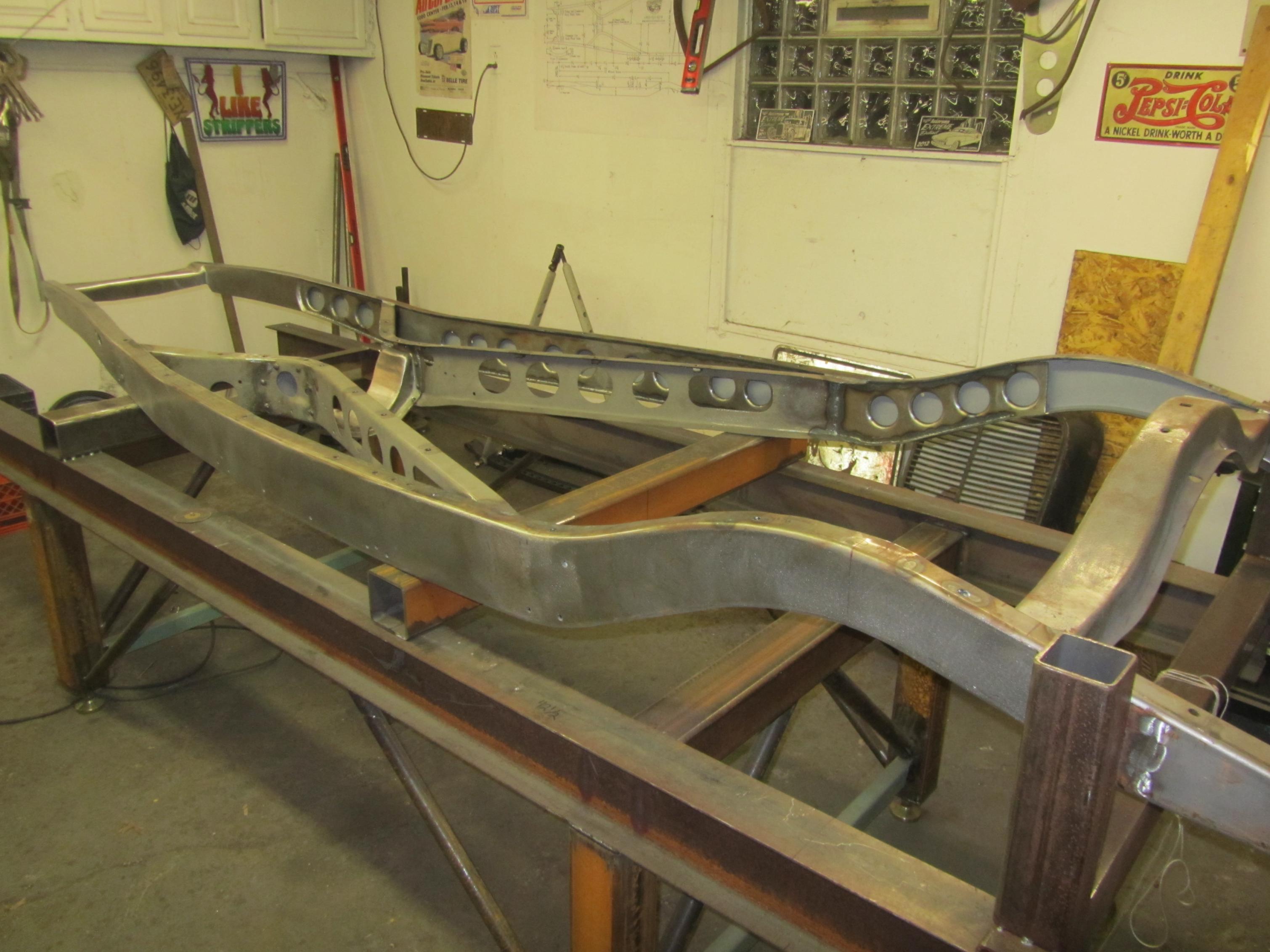

    This is for a few of my IG friends. Some of you guy will remember the frame table I built for tech week. Well Iv put into good use. I started with a stock frame but the rails were pretty rusty so I ordered some from ASC. I used Ionia boxing plates and the stock X member model A front and rear cross members. Center was modified to clear a Muncie trans and riveted back in place then welded. Front rails I doubled the boxing plates to make doing the motor mounts easier.
    I will update with more pic as I get more stuff done

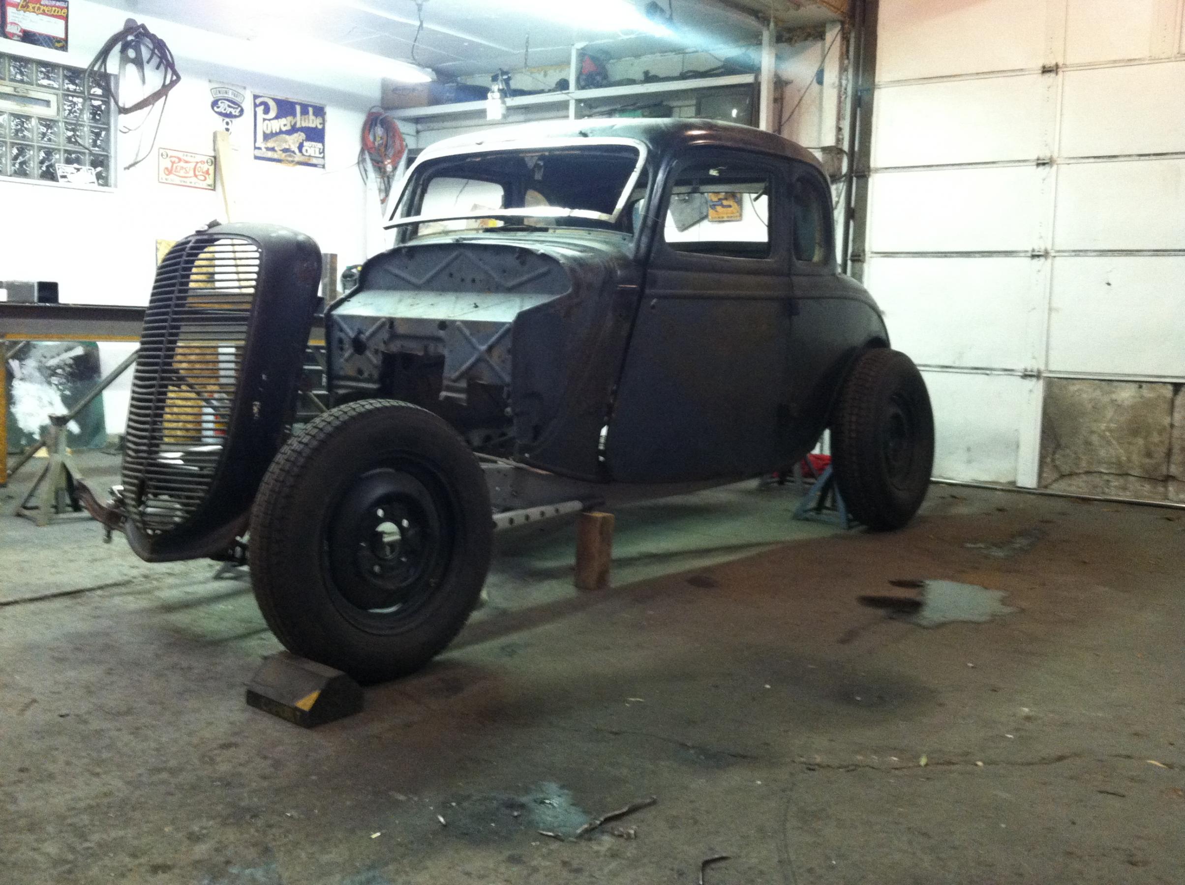

    Here's a quick little mock up we did the other night. I'm using a 37 truck grill so that's why the frame was pinched and the horns cut off. I plan on chopping it around 5 1/2 in the front and 5 in the rear also going to lean the pillars back quit a bit. Planning on a aluminum hood, Hood sides, Roof insert, Deck lid and roll pan punched full of louvers.

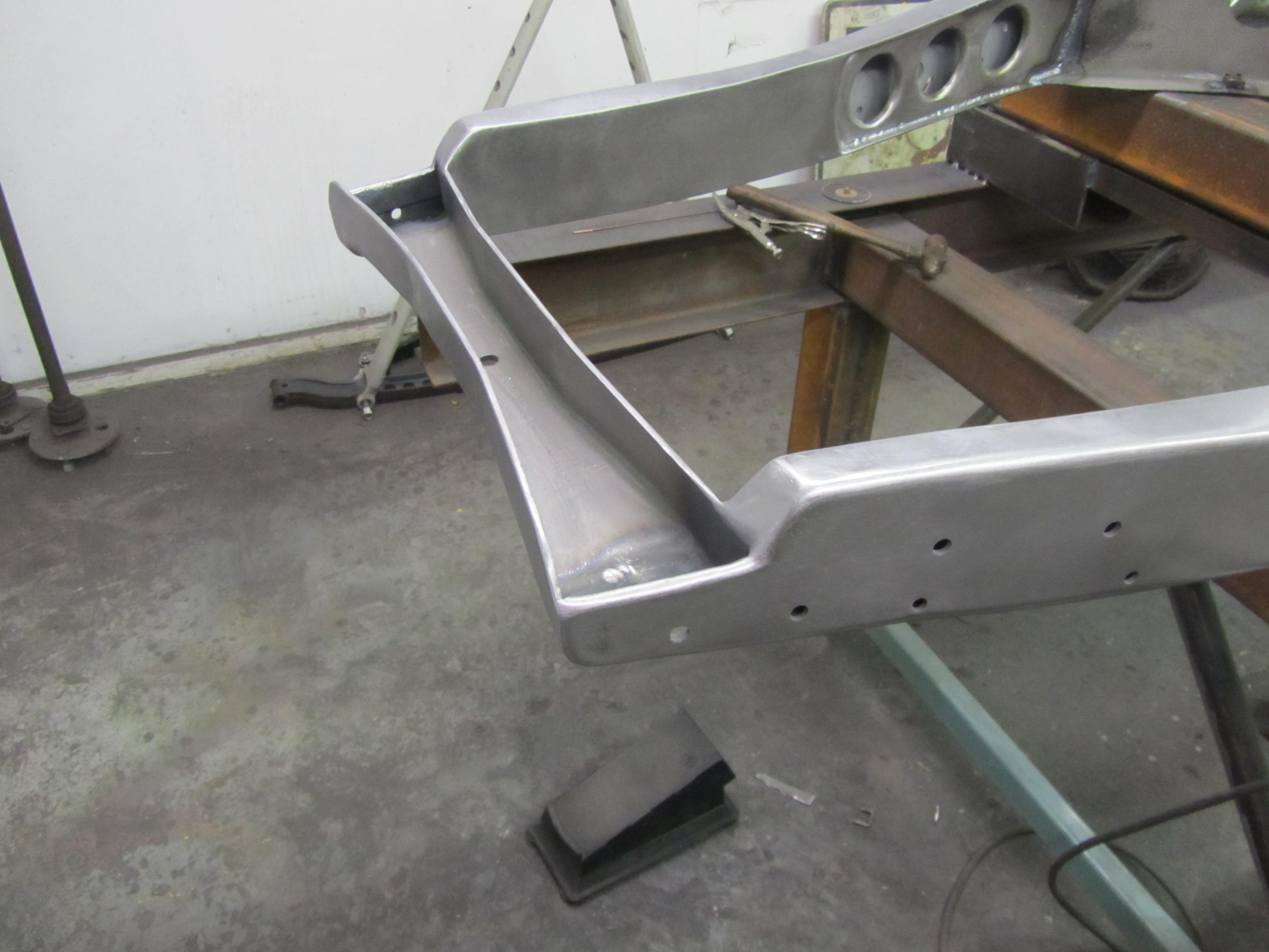

    Here's a few more pics. I got some work done on the bottom side tonight. Had to make some room for the spring.

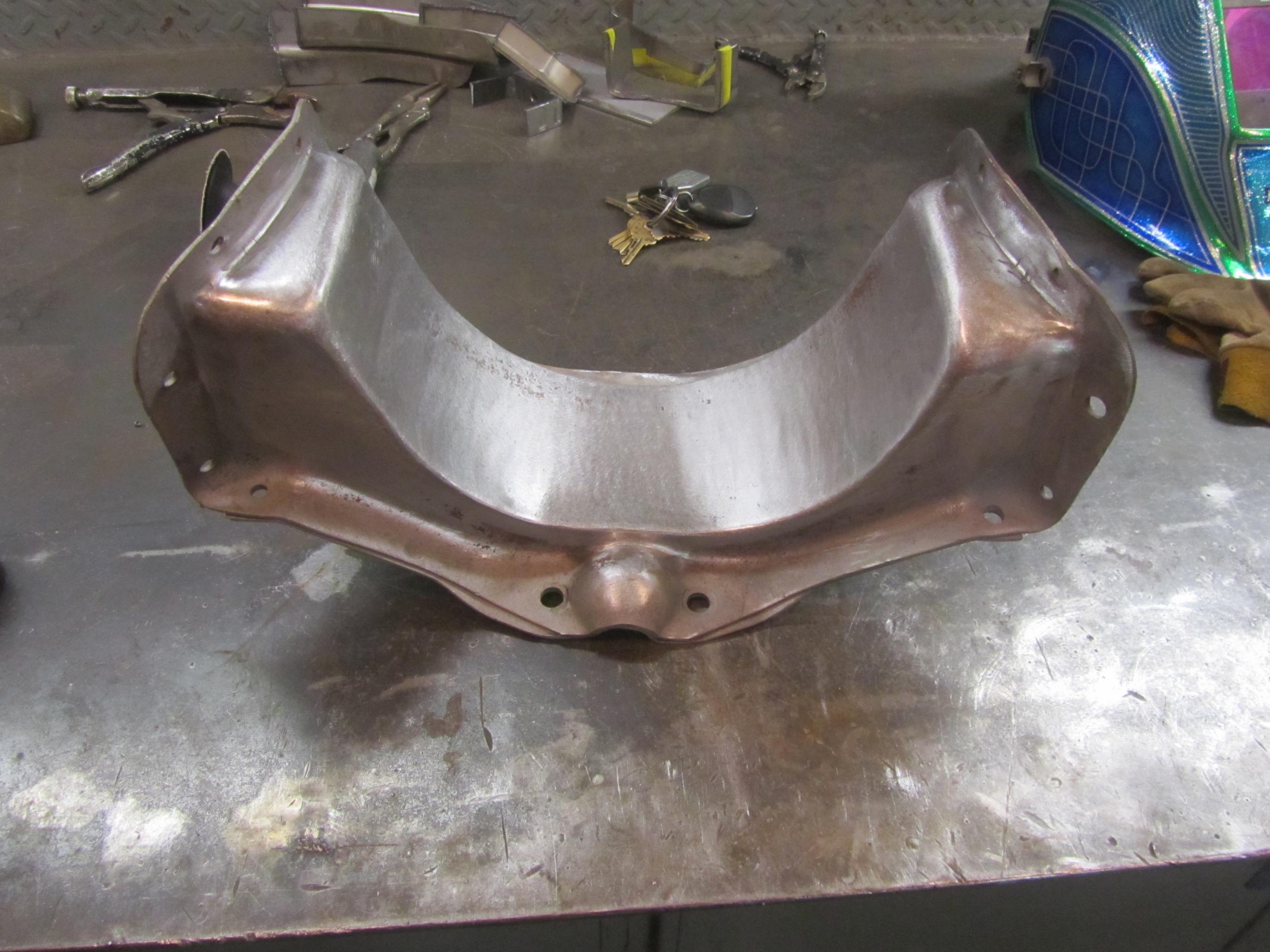

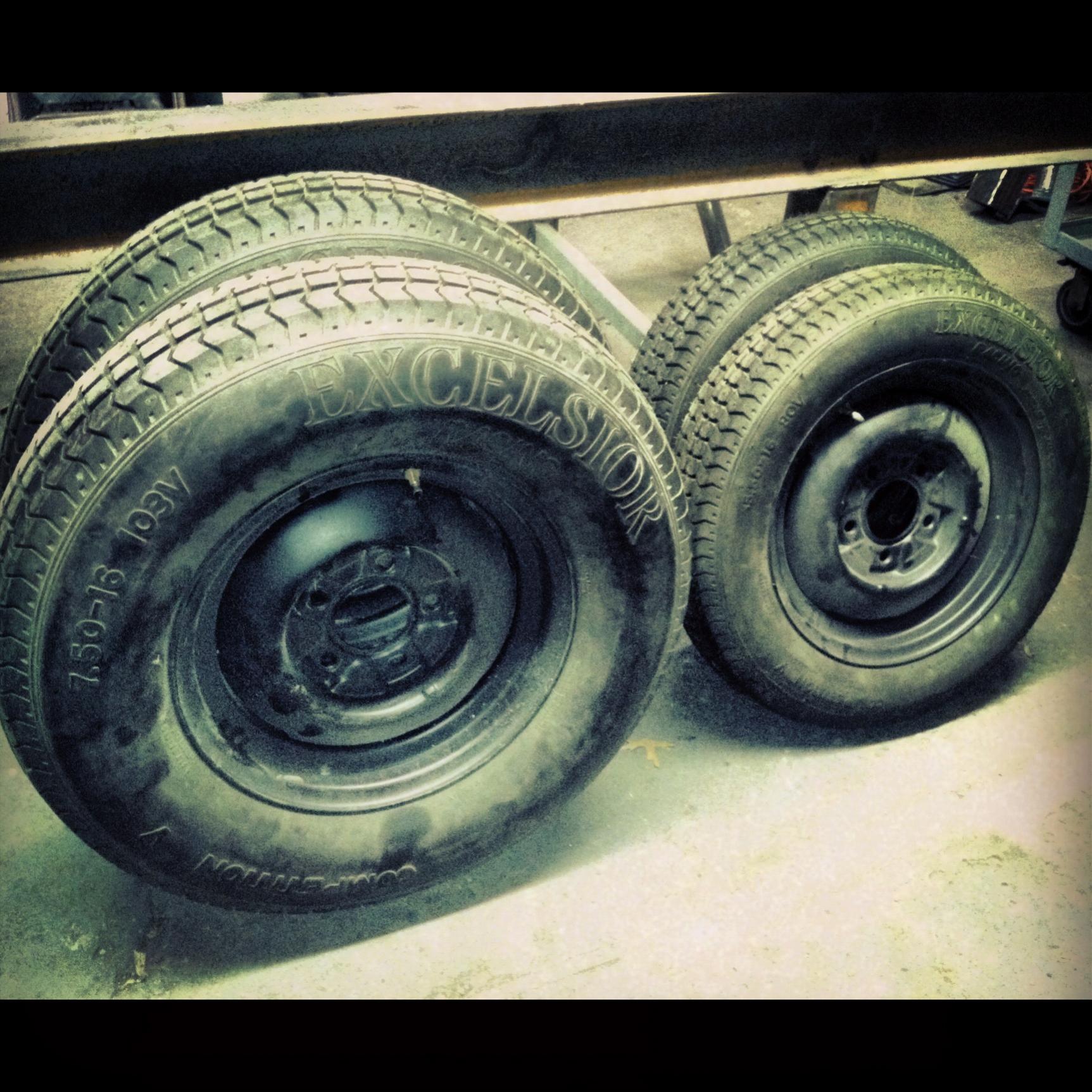

    Been working slow and steady
    Here's some pics of what Im doing and using
