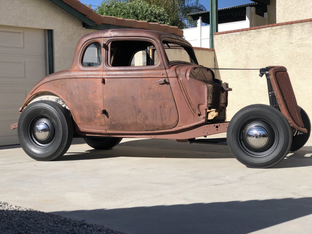

    First thread and build earlier than 64. Been lurking around here a while lots of great builds here I am learning from. You guys pushed me to pick up an all metal 34 ford coupe.
    Not 100% sure what I want to do with the build but going to start stripping it down and plan on do***enting the build.
    Got a blown and blueprinted 383 with an 871 going in it. Over kill on the blower I know but that's what I have, it may change later.
    We'll be going down to the frame and all new parts. Thinking about bare metal on the body.
    Currently a 8.5 rear end swapping for a 9".
    The split wishbone which I have not found info on yet maybe someone here knows what front end is in this car. The axle is behind the leaf. Death wobbles at 40 not fun.
    I'll post some pics of the front end.
    Ordered most of the front end parts going leaf over axle and ditching that R&P for a Vega box from borgeson with cross steer. New willwoods all around currently doesn't have much for brakes.
    Going to attempt a 3" chop possibly I can put some ok tig dimes down.
    Lots to do just getting started and a lot to do before the power plant install.
    Probably 100 questions along the way.
    Thanks for stopping by

    Welcome aboard , But honestly the ch***is looks pretty rough... I would build a new one.

    It's pretty beat for sure I was thinking about going ch***is up not a bad call. I am contemplating it. Definitely going to grind everything down and see what I have to work with first.

    Looks to be a '46-'48 front axle.

    The front axle is a ‘46-‘47, ‘48 was the same but had a hole machined in it between the perch and king pin holes for a shock to be bolted on. Those are some caliper brackets(!) but the calipers have me wondering, where are the bolts that they slide on?

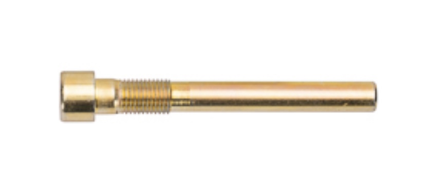

    Caliper bolt^ Maybe I overlooked them but I don’t see them. The bleeder valves appear to be mounted toward the bottom too, how does the brake pedal feel?
    The frame is scratch built from 2 x 3 rectangular tube and the split wishbone mounts look stout but the rod ends look to have a lot of thread showing making them kinda sketchy. You have already mentioned wanting a Borgeson steering box, good choice, R&P never works well with a straight axle.
    Bottom line? Honestly I think the engine is overkill for the bones of the project. I hate to sound harsh but I want you to study hot rods a LOT and build a safe car.

    It's a mess for sure to be honest IDK on the bolts I'll have to pull the front rims off and look around.
    The brakes are horrible I bled and put a new MC in but rotors and pads are shot.
    It's all being replaced it's super sketchy to drive at this point
    I agree with you 100% it's sketchy for sure but the engine will probably stick some carbs on and use the blower for another project but in the mean time have some fun with it.

    American Stamping sells an accurate repro 34 frame rail. It is a lot of work to weld together a frame from scratch and have it square and hold the proper dimensions. Maybe best to start with a frame already welded by a reputable shop. If you’re in the market, ask and you will get some good recommendations.

    New ch***is for a start.
    Bottom of the body looks to have 'work.' Quality?
    Suspect everything.

    Yeah I think the bottom of this coupe is a couple inches shorter than stock.

    @X38 and @alchemy spotted some inconsistencies with the body. Note the distances between the bottom hinge and the bottom of the body. The lower reveal has been removed and the door bottom strangely modified. It also appears to be slightly channeled and the frame stretched at least 6 inches.
    Still a really cool car with a lot of potential!!! I'd be happy to have it in my garage. :D

    Does look a bit longer interesting. I do have a metal hood and side panels that are metal and fit like a glove. Wonder if they are custom. I'll post some pics with them on the car.

    Mark ground or floor center of the axle to center of the front spindle,
    Measure , Stock 112 inch wheel base .
