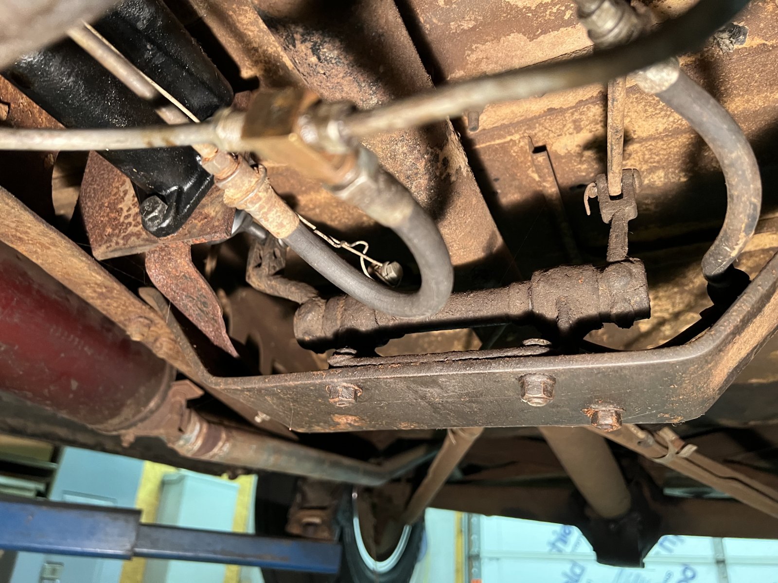

    IMG_0850.jpeg A few years ago, I scored a “garage find” ‘33 3 window coupe. The car has always been well cared for and loved, even when parked for several years. I’m the fourth owner of the car. Either the original owner or the second owner is responsible for the conversion of my car to hydraulic brakes.
    Their master cylinder actuator & mount is simple and works well. The original pedals & the mechanical brakes “equalizer” ***embly work as originally designed. The master cylinder is mounted on the p***enger side of the X member, facing backwards. The mechanical brake equalizer ***embly is used to push the master cylinder rod . It works well and nothing was hacked. If this solution interests you, I can snap a few photos. It’s incredibly simple.
    A simple piece of flat steel strap, bolted to the rear X member legs serves as a mounting bracket for the stock mechanical brakes equalizer shaft. Another simple bracket is bolted to the p***enger side X member leg to serve as the mounting bracket for the master cylinder.
