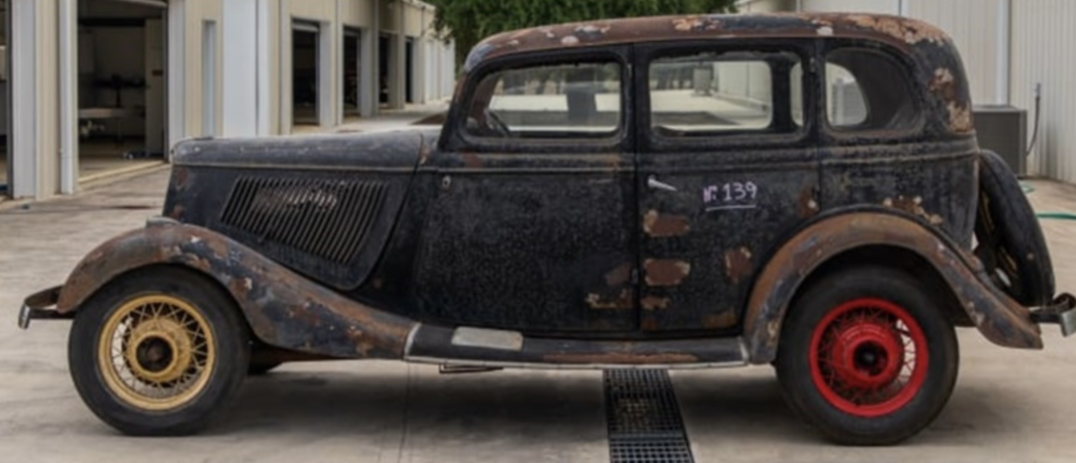

    Hello,
    I am looking to convert a 1933 Ford 4 door sedan to a 2 door. Just curious if anyone has the door dimensions for a 2 door and the A pillar to B pillar measurement. Any help would be greatly appreciated. Thanks

    Thanks, looks like i might have my work cut out for me if i do it. Didn't think i would have to get into the c pillar but clearly some difference there. Was hoping to build a chopped and channeled 2 door sedan but came across a super clean 4 door for next to nothing and couldn't p*** on it.

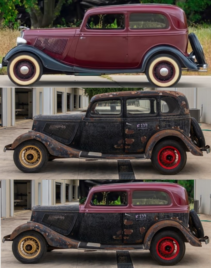

    This pic needs a photoshop chop…anyone? (3” or so)
    Needles15 likes this.

    I agree, maybe someone is good enough with photoshop to make it look like this as well but keep the 4 doors

    Not a Photoshop user, but I can cut/paste. This is a ballpark and it's using the no windshield lean no distortion approach. You can distort the photo to shorten the top, but that's not realistic, it makes the curves all proportionally smaller.
    A Boner likes this.

    Turns out it was a 34 Chev 4 door after i was able to get it out and get a good look at it.
