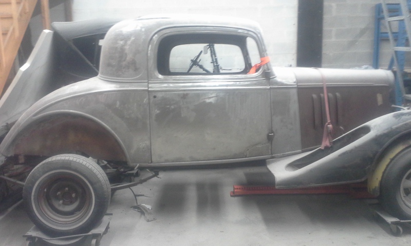

  1. I just picked this Chevy coupe up and I'm getting ready to start the body work. I'm not seeing reproduction sheet metal right off for the 33-34 chevy coupes.
    Does anyone know of a source for reproduction floors for these Chevy coupes? I know the original was wood. I'm wondering if a 34 Ford 3W coupe floor would be close enough to make work if there is not a repop available.

    I think that's a standard. Master rear fender bolts point in towards the center of the body. Standard fender bolts point "up" for the lack of a better word. I could use a deck lid, got any pics? Any pics of the dash and deck lid for this car?

    '34-35 standards were 3 windows. '34 masters were 5 window.

    They indeed did make a master 3W.

    It's a master, the firewall has more of a recess for the motor to set back when they are a std.

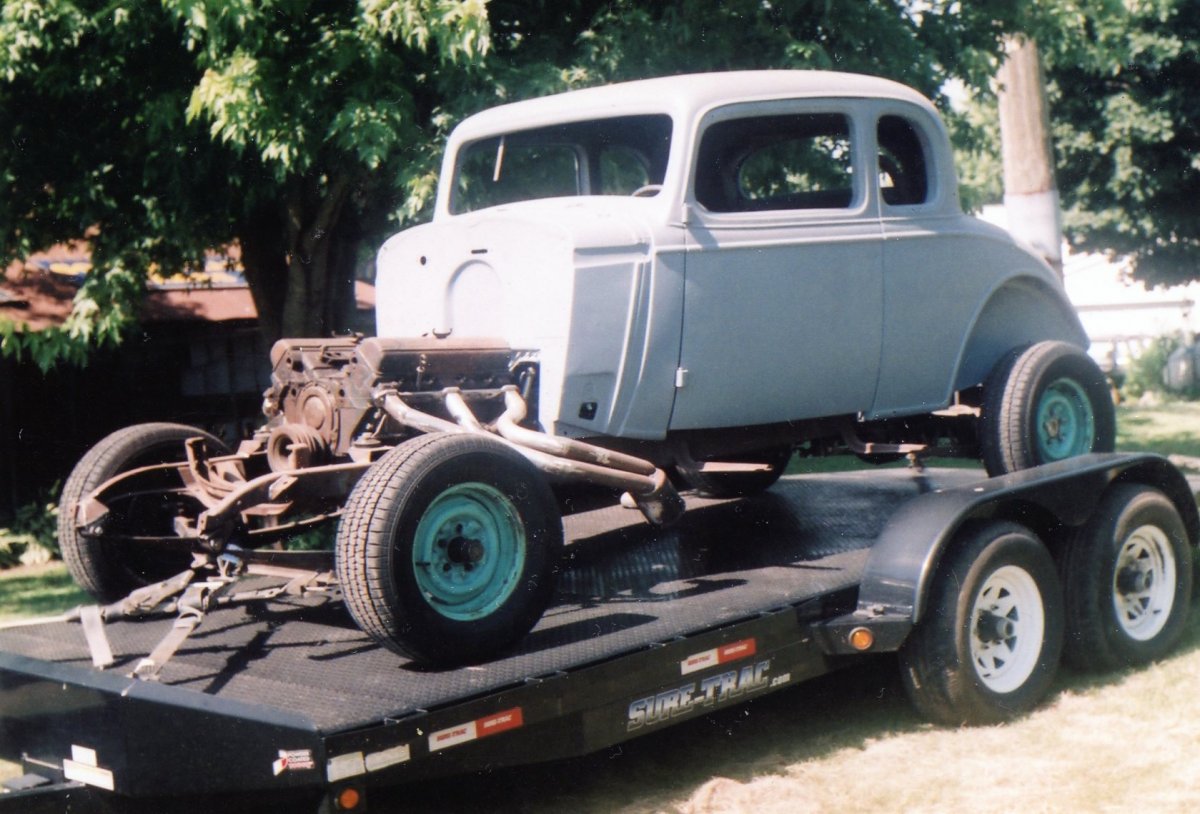

  14. Mine is a canadian 33 master 3 window .
    This is the proper hood for canadian cars.
    Ground assaults car is a 34 master !!!

    Oops, my bad, been a while since I messed with a chevy. I took a master 4 door, and added modified standard 2 door sedan doors, and a standard 3 window back half. I used the master rear wheel wells and enlarged the trunk opening to accept a master decklid. I got in a cash crunch and sold it, but I have another mess of a '35 standard I'd like to get together. 34chev.jpg

  23. Yes, there was a '34 Master 3W coupe. It was the "Sport Coupe" and had a rumble seat and not a trunk. There were a lot more '34 Master 5W coupes produced. It's hard to eyeball these '33-'35 models as there are subtle differences. It appears that the OP's body tag is still on the firewall. I wud look at the Style No. on that tag for a more definite answer as to exactly what the OP's coupe is and compare to the wheelbase and style of the frame. Style Numbers for the various 3W coupes are as follows:
    '33 Mstr Spt Cpe - 33578
    '33 Std Spt Cpe - 33628
    '33 Std Cpe - 33607
    '34 Mstr Spt Cpe - 34578
    '34 Std Cpe - 34607
    '34 Std Cpe - 351207 ('35 Std style body on '34 Std style (DC) frame
    '35 Std Cpe - 351207A ('35 Std style body on '35 Std style (EC) frame
    Wheelbases for the various 3W coupes are as follows:
    '33 Mstr (CA) Passenger models - 110 in
    '33 Std (CC) Passenger models - 107 in
    '34 Mstr (DA) Passenger models - 112 in
    '34 Std (DC) Passenger models - 107 in
    '35 Std (EC) Passenger models - 107 in

  30. Yes, I have the doors which are in excellent shape. The worst thing on this car is the rear lower corners that I'm having to rebuild and weld back on. Other than that, this is a pretty sweet and complete coupe.
