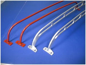

    I am installing braces and a nice hinge kit with a cable operated latch release. The hood braces really stiffened up the hood and made it feel very solid.

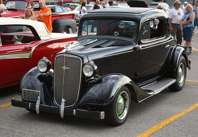

    Grille shell is stock Chev. For a one piece hood you have to modify the shell to match the hood. Orig radiator cap hole has been removed and shell peaked.

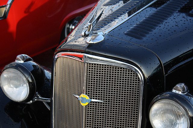

  10. Looks like a stock 34 hood and shell with the ornament base removed to me....here's a close up picture
  11. beautiful........makes you wonder why they filled it.:)

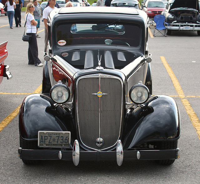

  14. I think that this looks pretty Hotroddy
    mgtstumpy, tb33anda3rd and kiwijeff like this.
