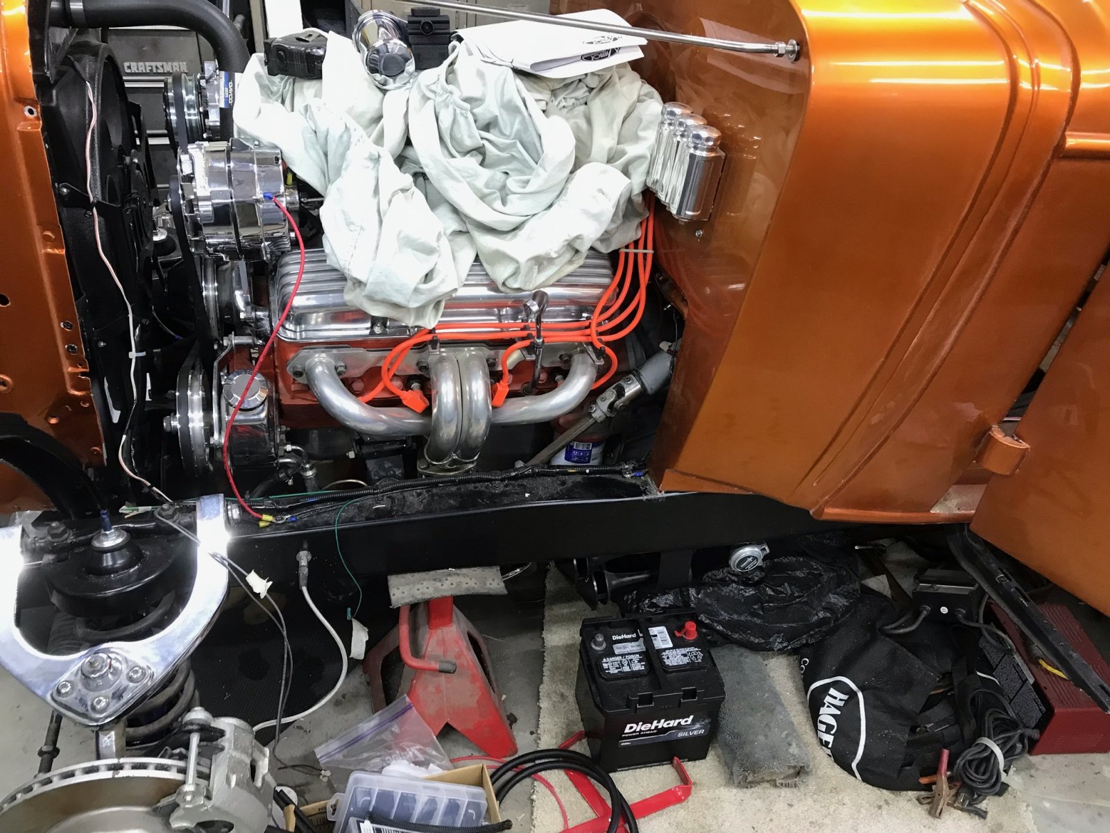

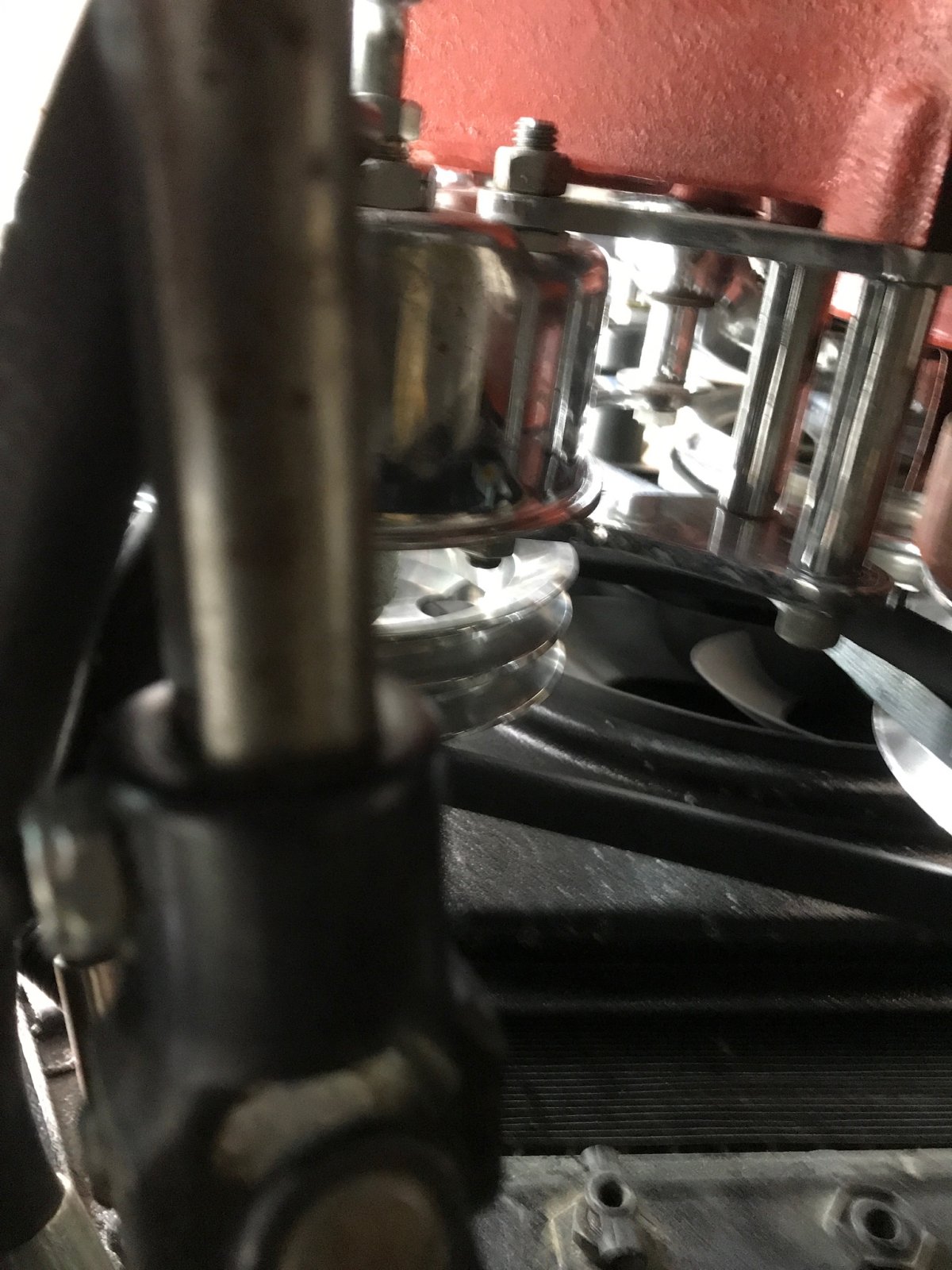

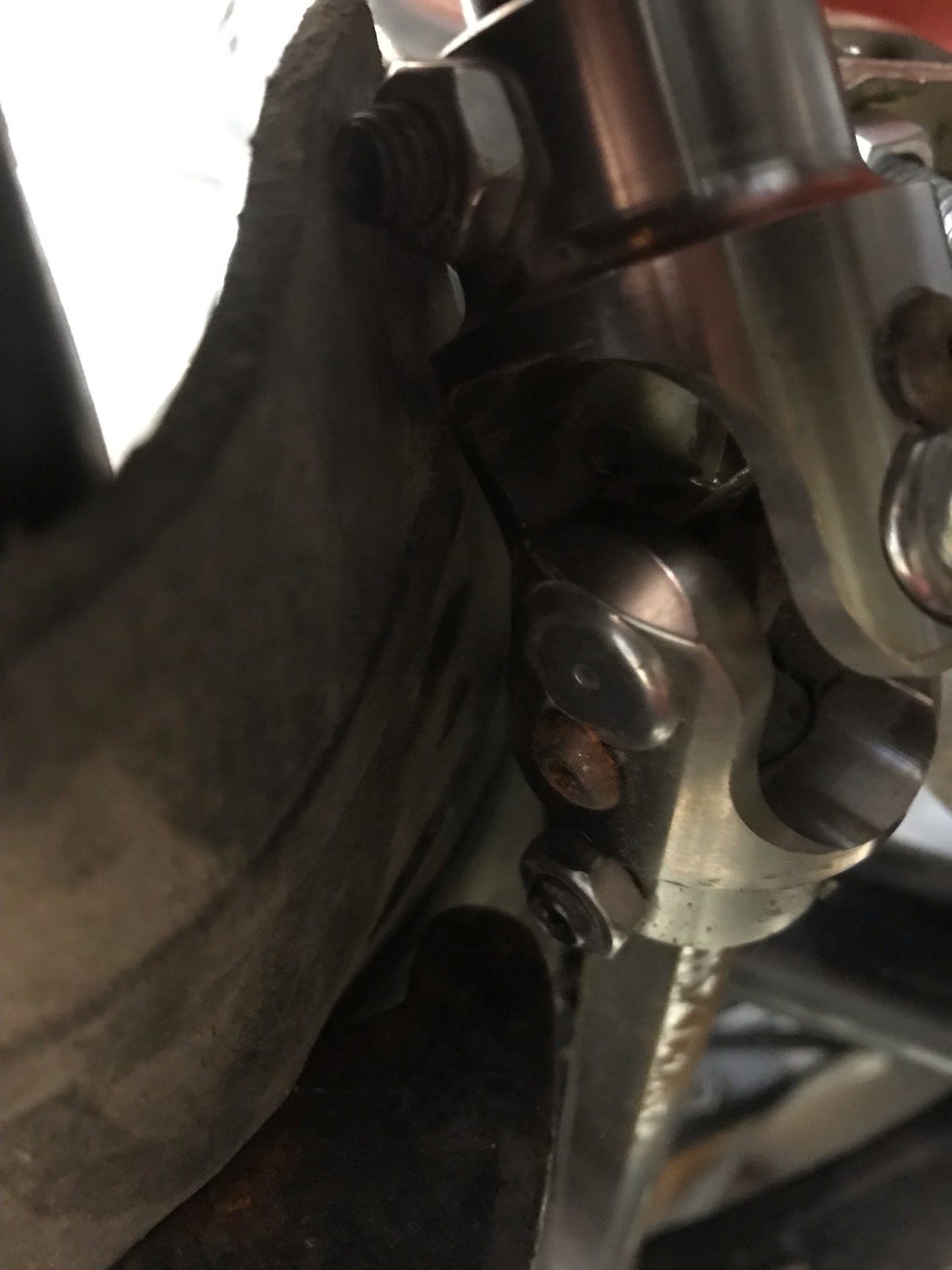

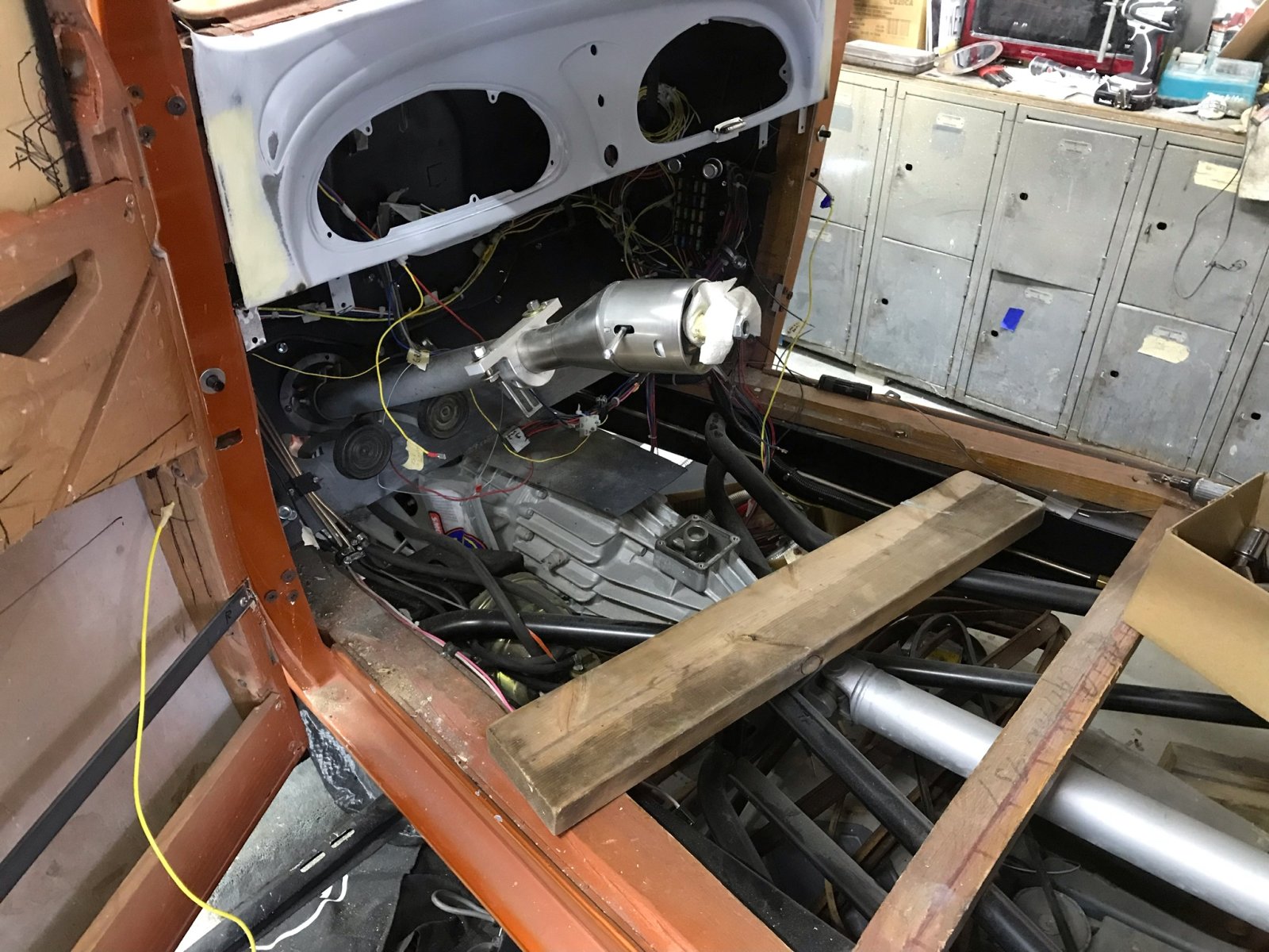

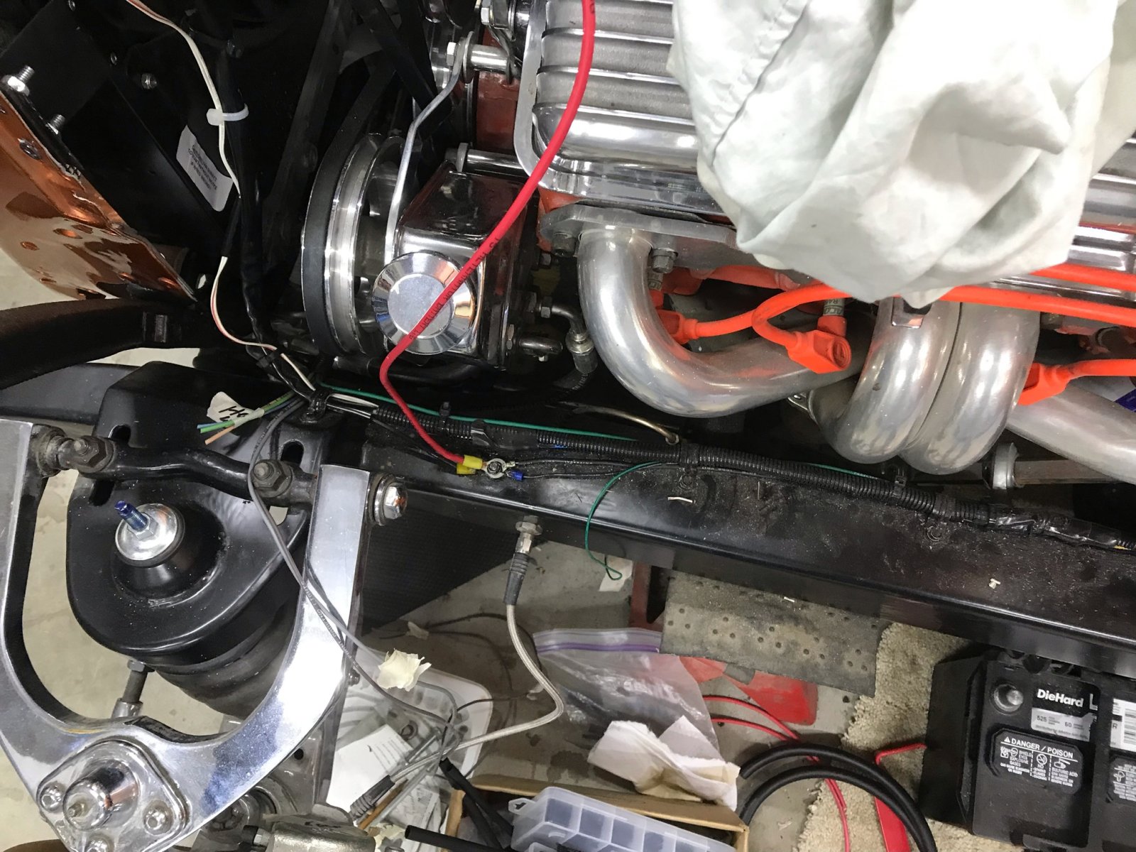

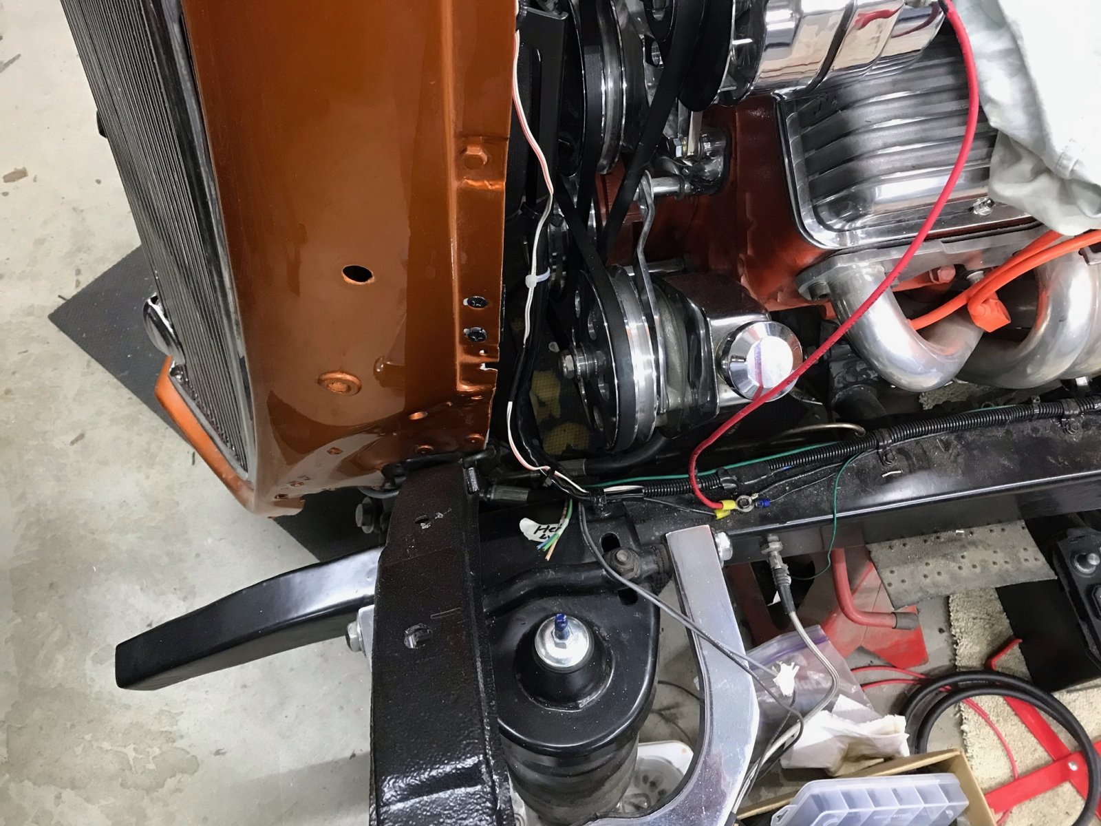

    My brother is building a 34 master 3 window
    he has a flaming river column with a power rack
    he will take some pictures and I’ll post them
    lothiandon1940 likes this.

  9. CSPIDY
    Joined: Nov 15, 2020
    Posts: 981
    CSPIDY
    I believe he bought the u-joints from Borgenson
    4E18D421-3410-4C90-907D-AEBFC9151009.jpeg 6CFB01F0-6865-4270-9BC2-3336A0364042.jpeg 0538A7D2-8A75-4CCC-9546-199A7EAABAFA.jpeg 5667B674-76BB-41A2-8050-9E0F1CD7850D.jpeg AE6C4DBC-8FE7-40FB-B104-0D03B0CBF7AF.jpeg A8E4D79D-1C97-404B-A5F4-F44D5A051993.jpeg 07119915-D535-4189-913B-58150BEA3124.jpeg 075D165F-8544-4ECD-9011-8720234FC5D4.jpeg B55E3B69-EFD9-4489-BC22-5EEF41C8A052.jpeg
    Hope this helps
