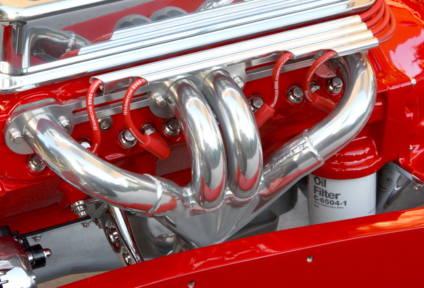

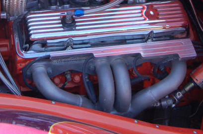

    I run ram horns. Too cheap and lazy to have a set of headers made. Just me, but I think the ram horns flow just as good as the block hugger shorty. And they don't cook starters. My master cylinder is under the floor and I have drum brakes.

    Make your own custom headers. But using the ram horns I do like as well.

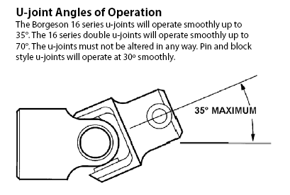

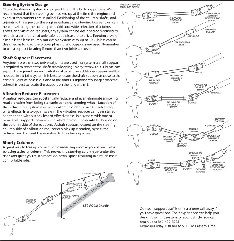

    My 35 Standard with inline flat collectors, engine tube is slightly notched for shaft clearance. I envisage that you'll have some issues as Master is slightly different but close enough. I used a rear mounted R&P and clocked it and shafts so that universal joint operating angles are within safe ranges.
    I've no issues with engine side mounts as I bought a flat pack header kit that allows you to position tubes before final welding. I use underfloor pedals with column and pedals in OEM 1935 position.

    Thanks so much for the diagram. Also where under the floor did you put the master cylinder and did you use after market pedal? Thanks for the information
