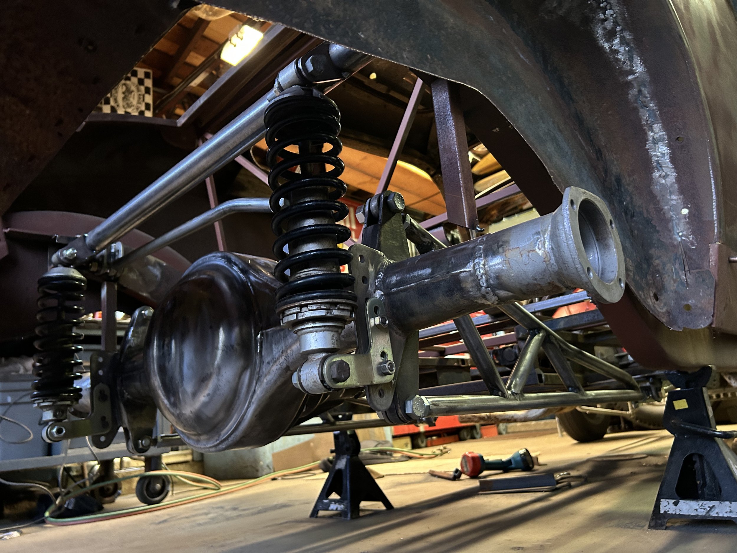

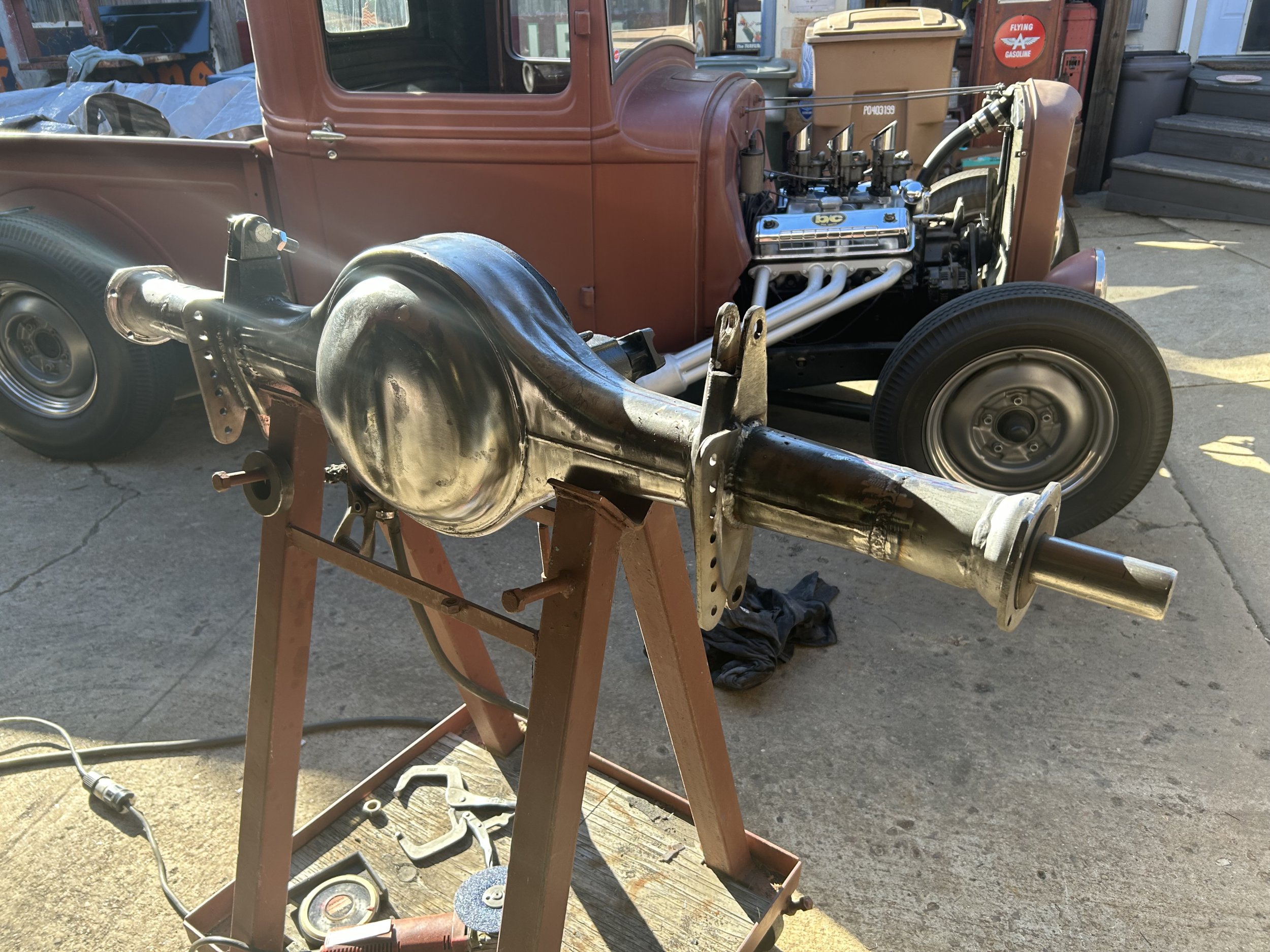

  6. IMG_1317.jpeg Made some progress, I got the Olds rear end housing from the Hugh Tucker roadster narrowed a couple of inches on each side. I wanted to keep the ladder bar brackets in place, old arc welds as they were. I added some lower coil over shock mounting plates with multiple height adjustment holes.

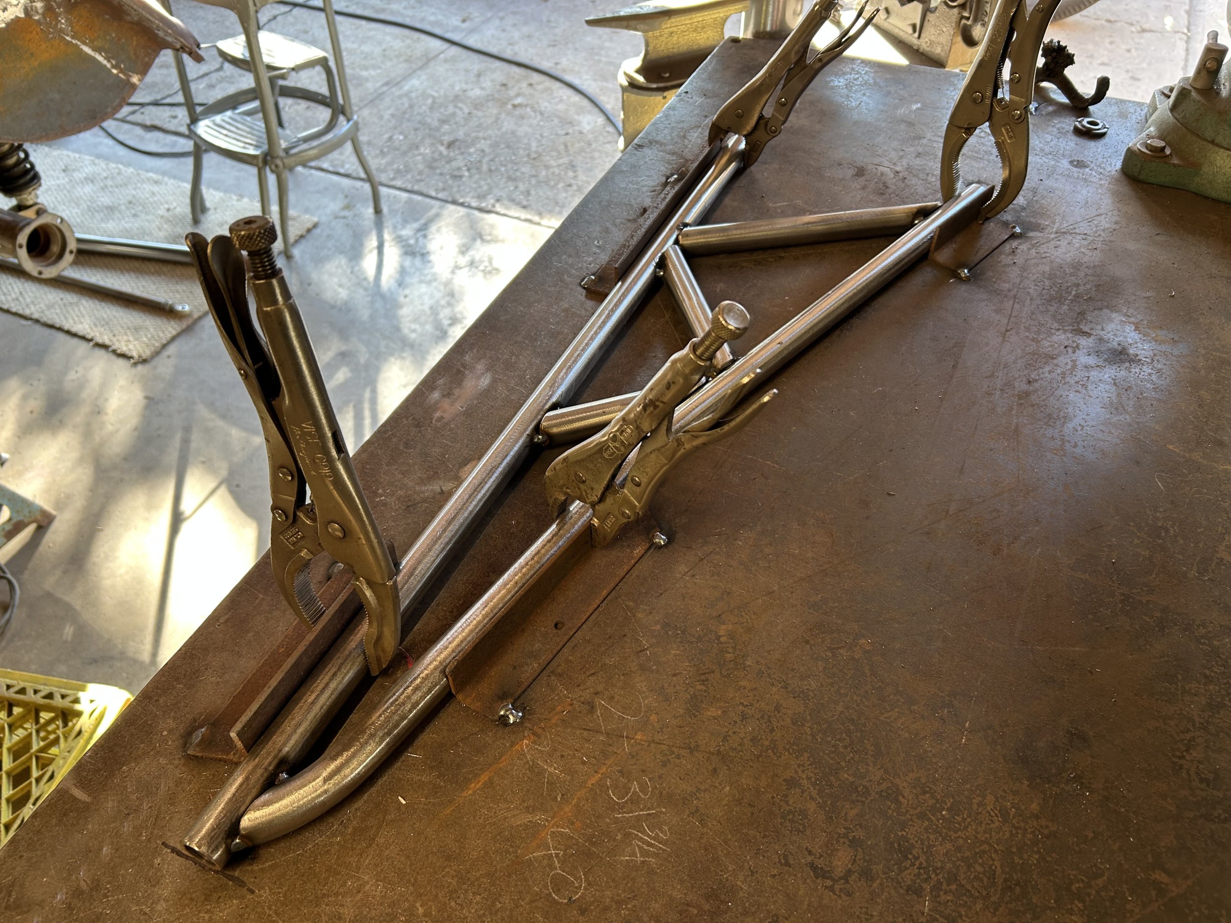

  7. Mocked up the housing in the car and made a cardboard pattern for ladder bars . I had some rod ends left over from other projects and some heavy wall one inch tubing on hand someone had given me a while ago, I cut the pieces I needed and had my machinist neighbor Jerry thread the ends and bend the top bars to match the shape I needed. Some fitting and welding and ladder bars are done. IMG_1323.jpeg IMG_1326.jpeg IMG_1327.jpeg IMG_1333.jpeg
  8. Added a top crossmember for the coil overs ,front ladder bar mounts, panhard bar etc and the rear suspension is pretty much done. Just your basic drag race ladder bar/coil over setup. IMG_1354.jpeg IMG_1356.jpeg IMG_1359.jpeg IMG_1362.jpeg

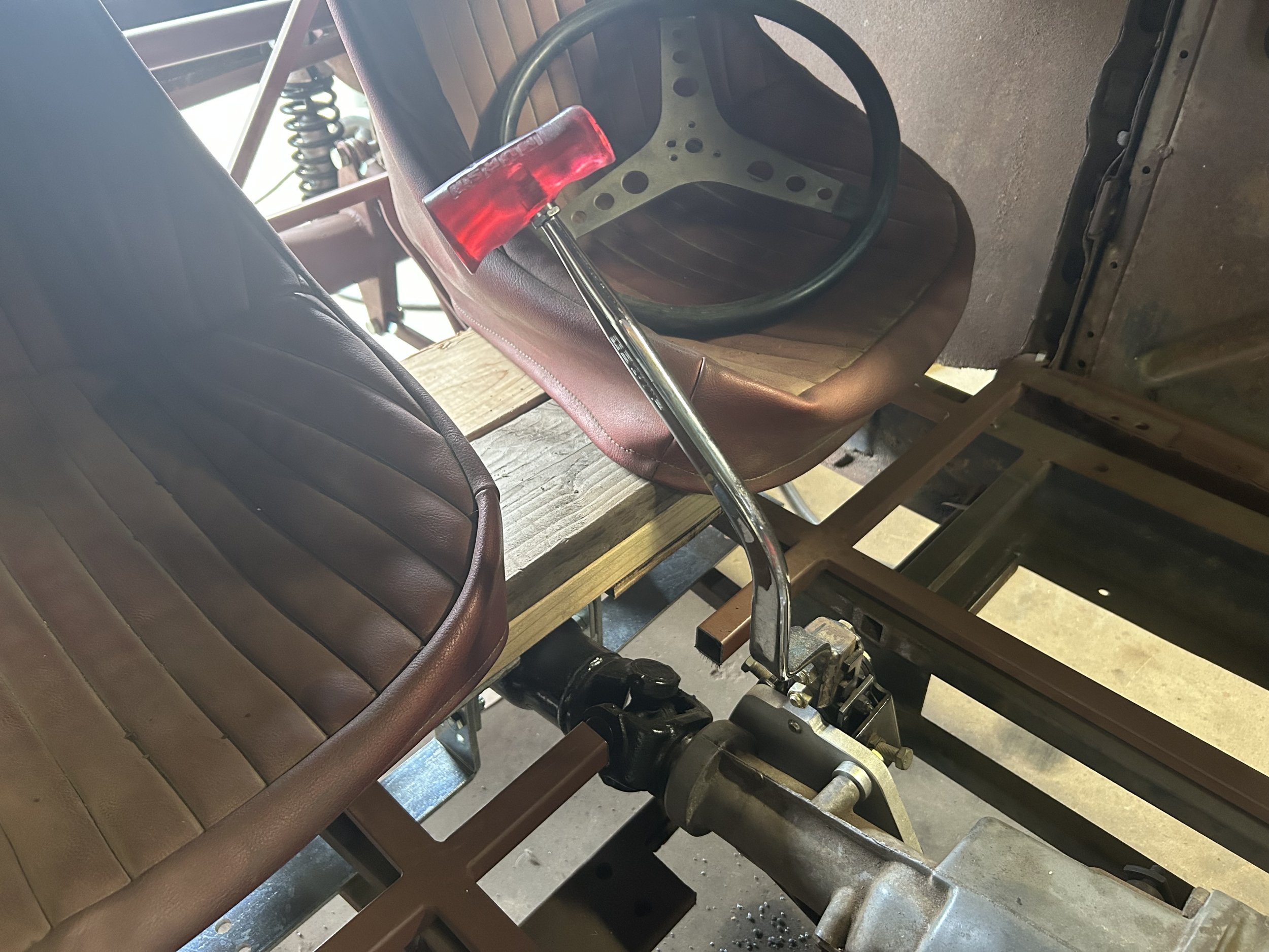

    I nailed some wood together to get the seats where they need to be. Now I can sit in there and figure out
    Steering and pedal locations. The seats came out of this old Camaro drag car that was sitting in Turners auto wrecking in Fresno several years ago. IMG_1422.jpeg IMG_1423.jpeg IMG_1424.jpeg

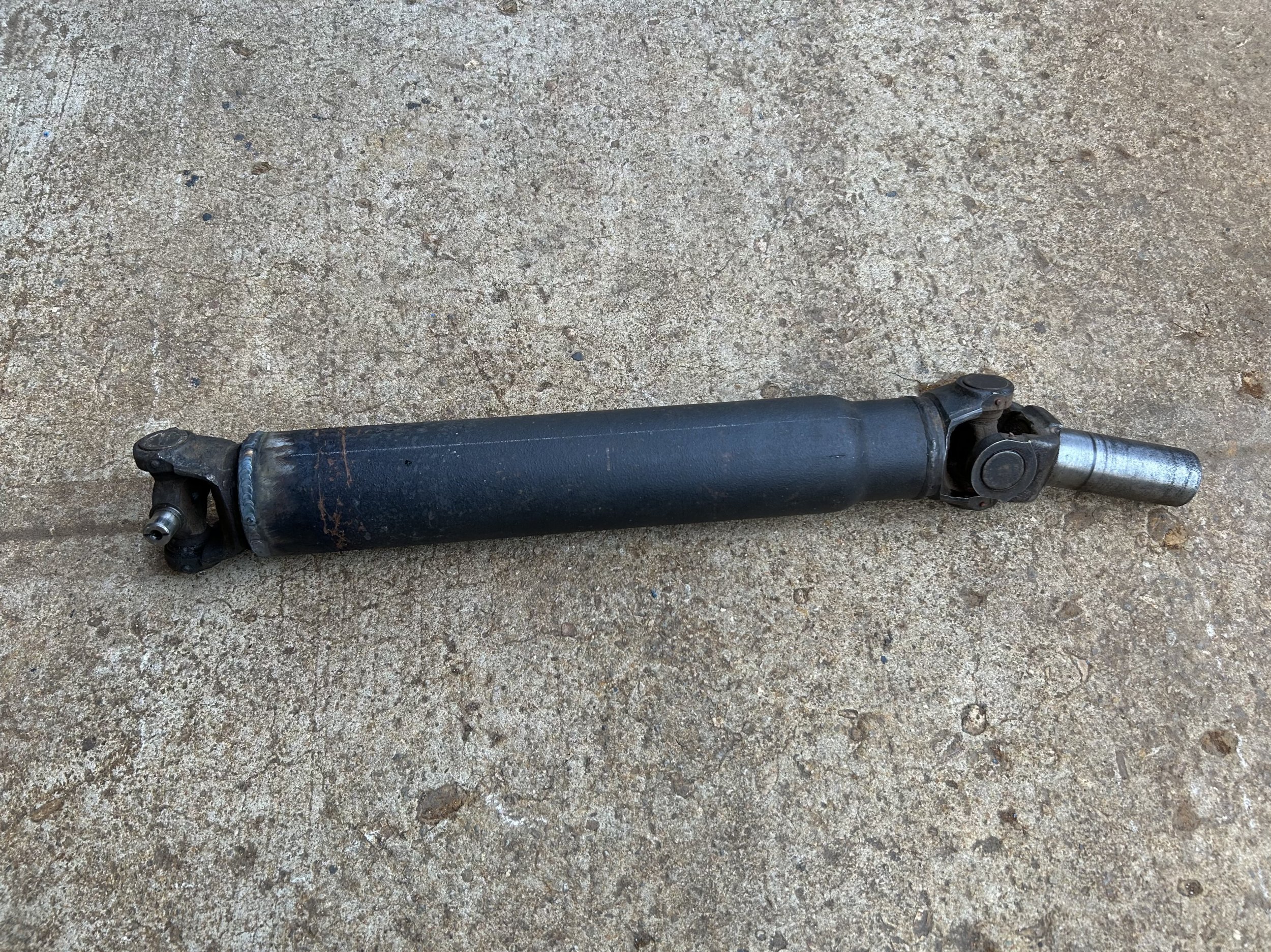

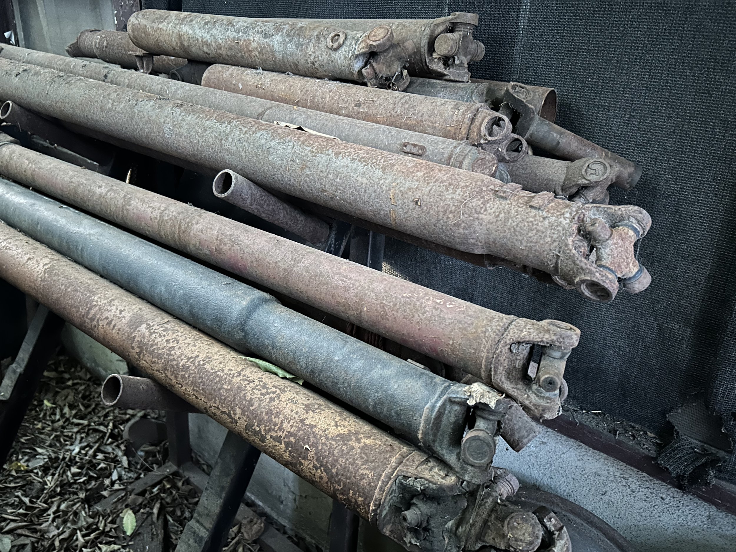

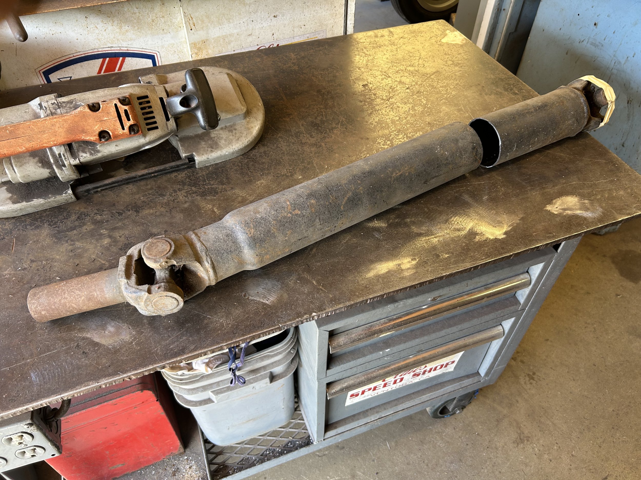

  25. With the rear end in place I could measure for a drive shaft. I sure don’t need one yet but having it in place will help figure shape or tunnel, crossmember, safety loop, floor shape etc.

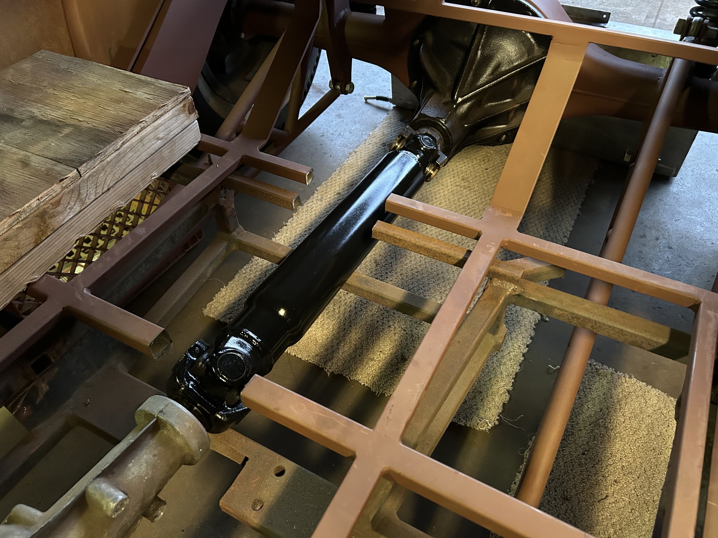

    With measurement in hand I went to my pile of used drive shafts that I have been saving for years, finally, a reason for my pack rat madness! I found one just what I needed only a few inches too long. I cut it to length, squared up the end, separated the other part at the weld and cleaned it up on my funky little lathe, pressed it in to the tube, phased the ends and welded it together. Another piece to the puzzle! Later in the build I will get it balanced and new U joints.

  28. Still figuring out seating location so I can set up steering column etc so I made a new aluminum plate to mount the shifter a little lower on the transmission. I also welded a block to the bottom of the shifter lever to move it toward the center of the car and heated and bent it a little to get it in a very comfortable position. IMG_1519.jpeg
