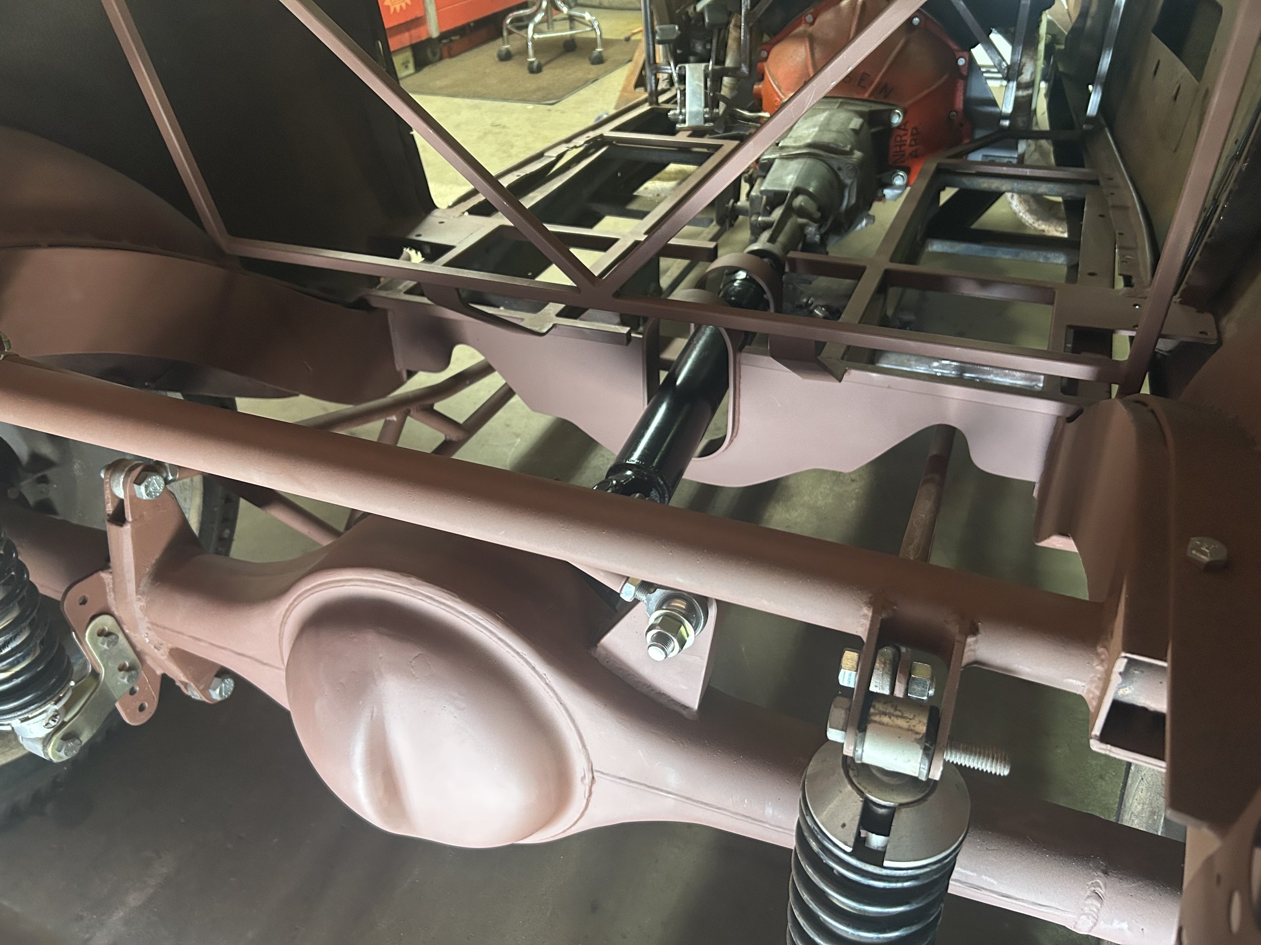

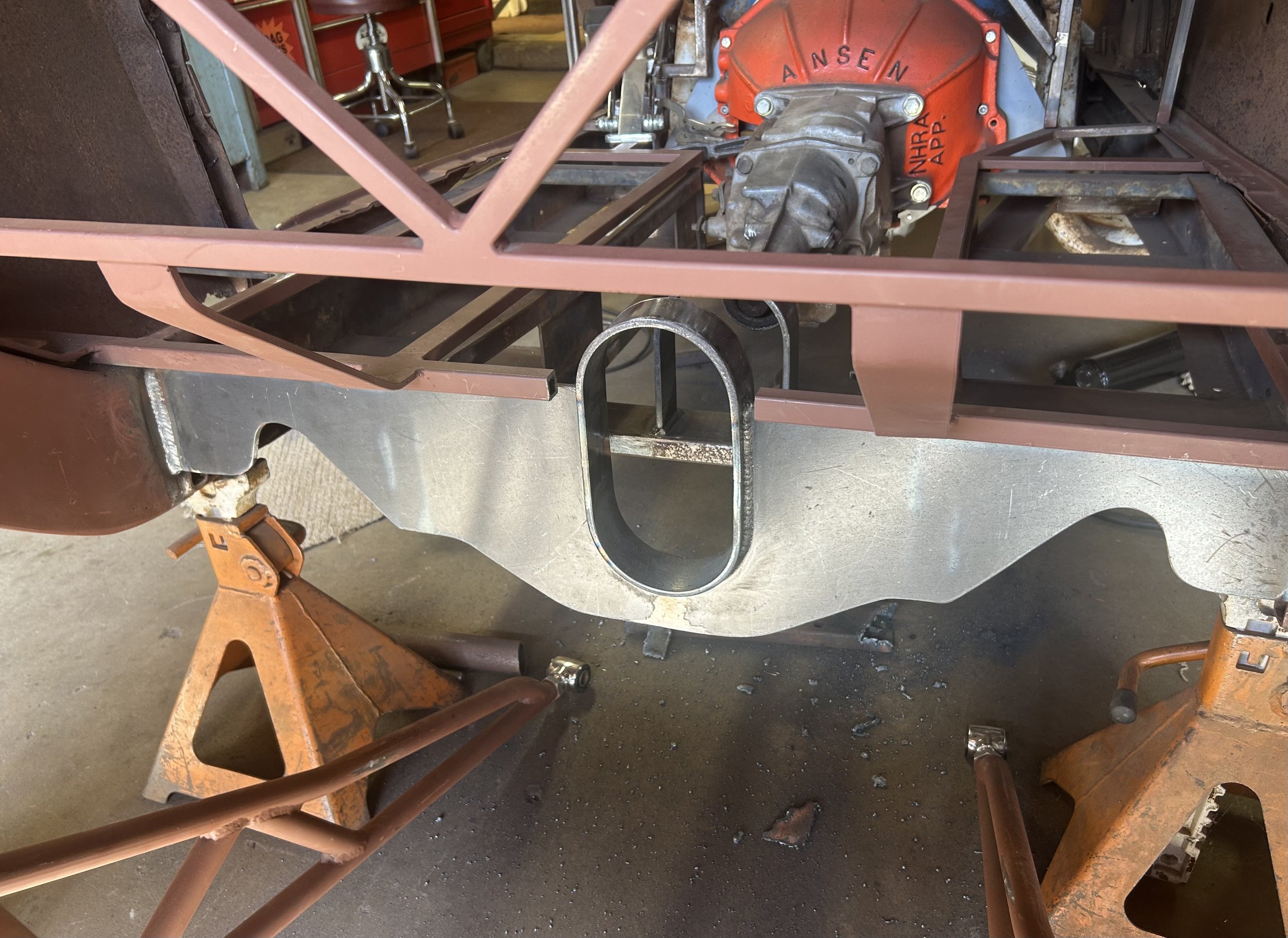

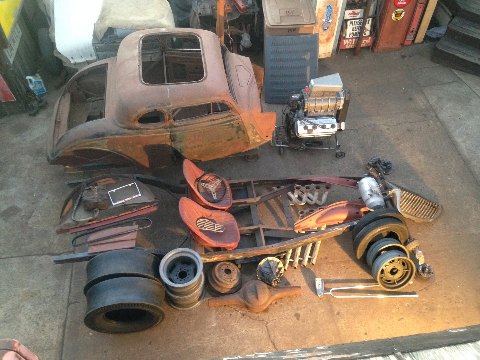

  1. I began adding some structure into the frame where I had cut some of the 1 inch tubing
    out for ladder bar clearance. I added a couple of drive shaft loops, now I know what shape to make the floor. There is a lot of work to do to the frame when the body comes off later. Boxing, gussets, finish welding etc. IMG_1669.jpeg IMG_1678.jpeg IMG_1681.jpeg IMG_1684.jpeg

    Great work, nice little list of parts going in this. What material did you use for the ladder bars?
    elgringo71 and 427 sleeper like this.
  3. Ladder bar material is 1” OD x .250 wall seamless tubing. Heavier wall than needed, I was gifted a few lengths of it.

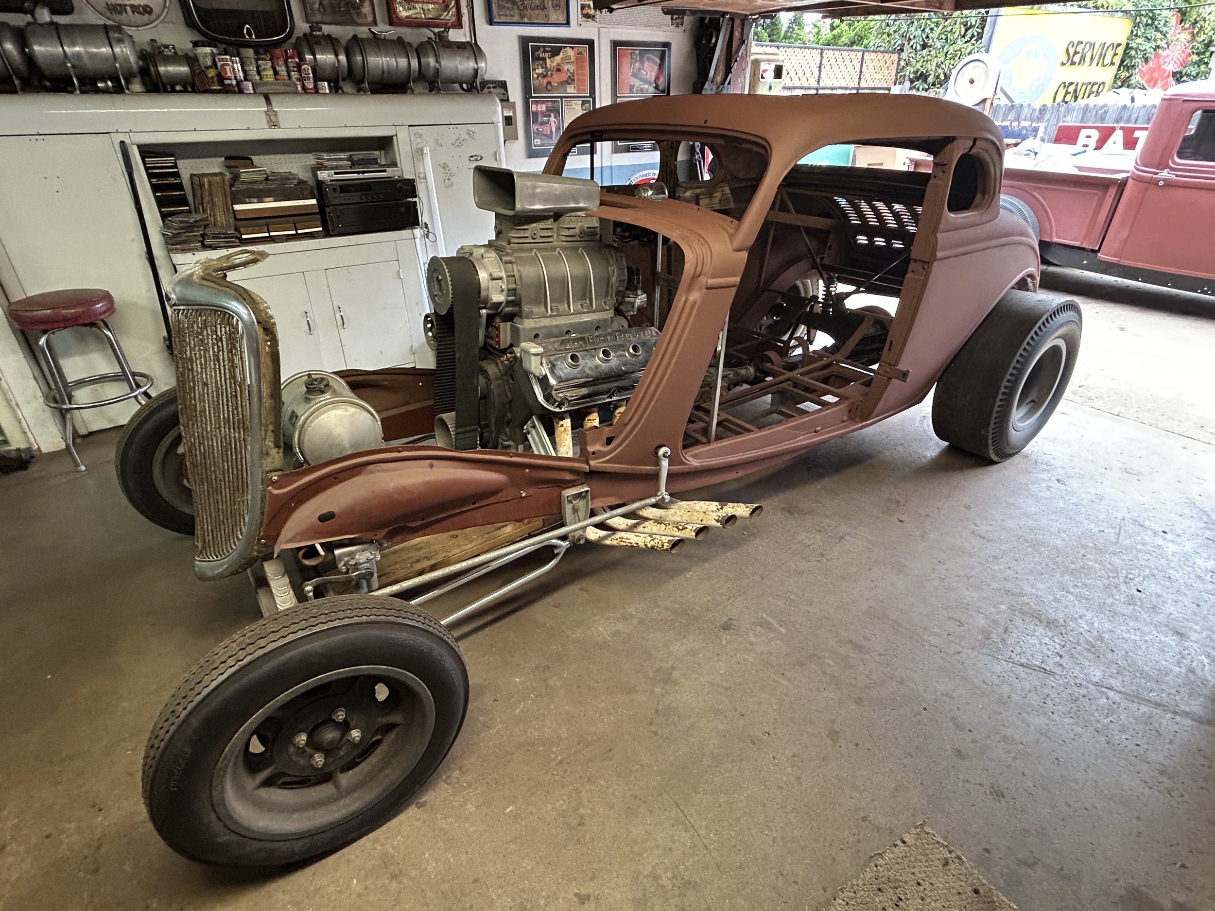

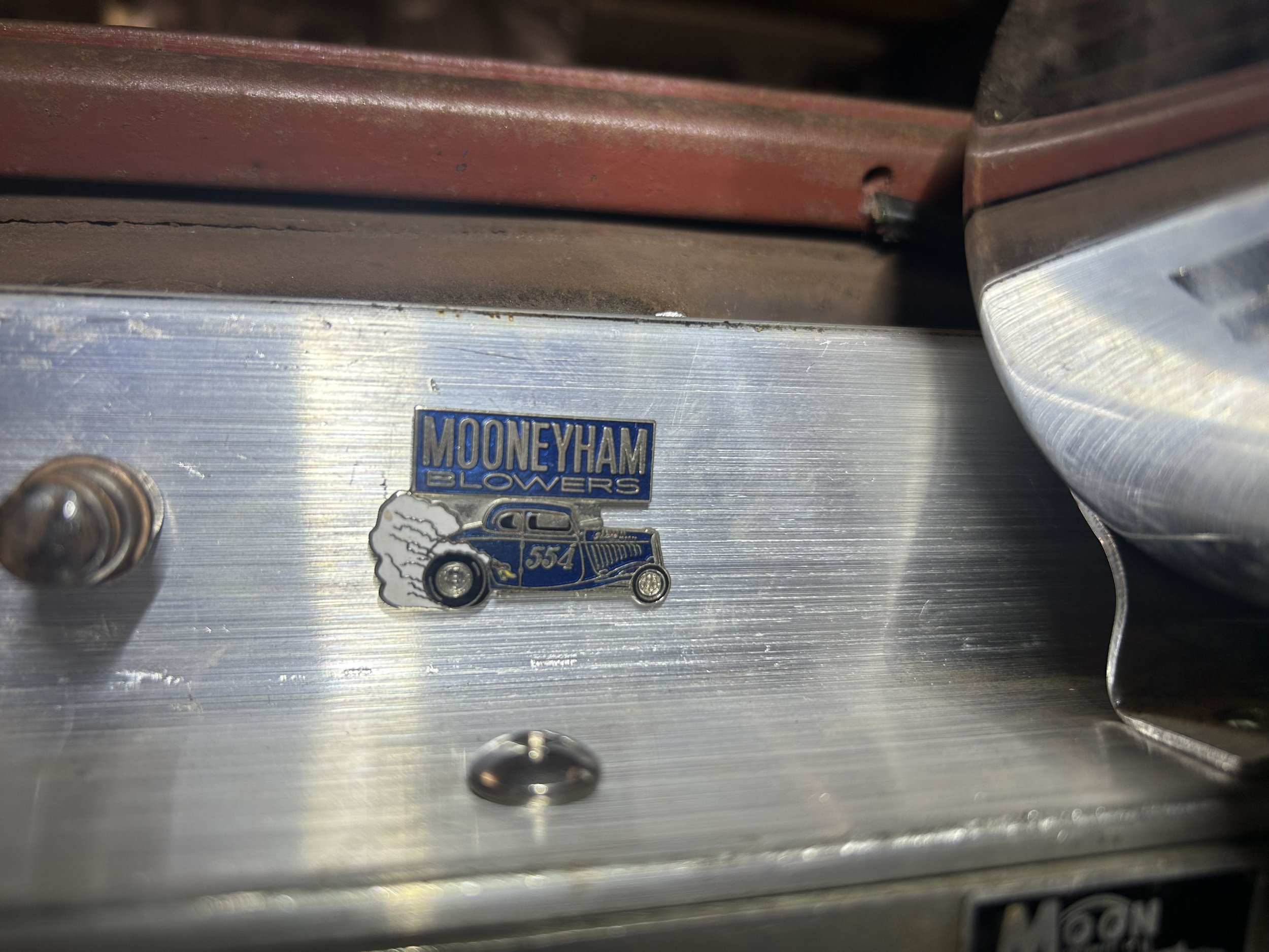

  5. IMG_1834.jpeg IMG_1838.jpeg IMG_1848.jpeg I have been spending many hours putting patch panels, new rockers etc in the lower body, pic’s to come. I also figured out how I want to mount the gauges. There is not going to be a dash board, just flat aluminum recessed firewall. Like I said earlier in this thread, nothing over engineered on this car. A piece of 2” aluminum angle will work just right. Eventually I will make a nicer version with the top shaped to match the cowl. Also I think I found a home for my Mooneyham Blowers pin. I am not sure if I will run this tach, I have a Jones cable drive I would like to run but not sure if I will be able to use it or not.

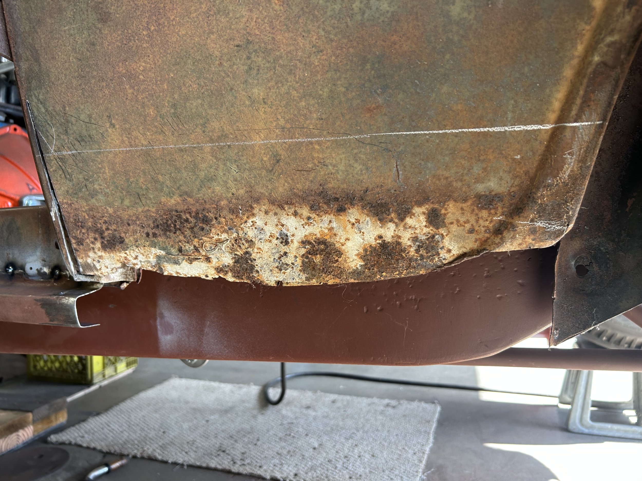

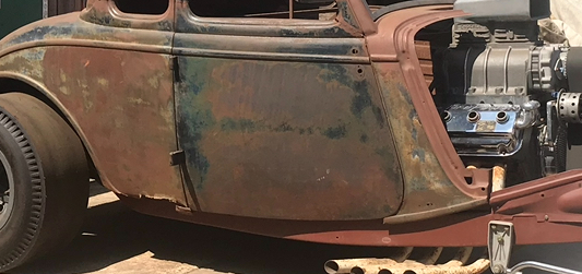

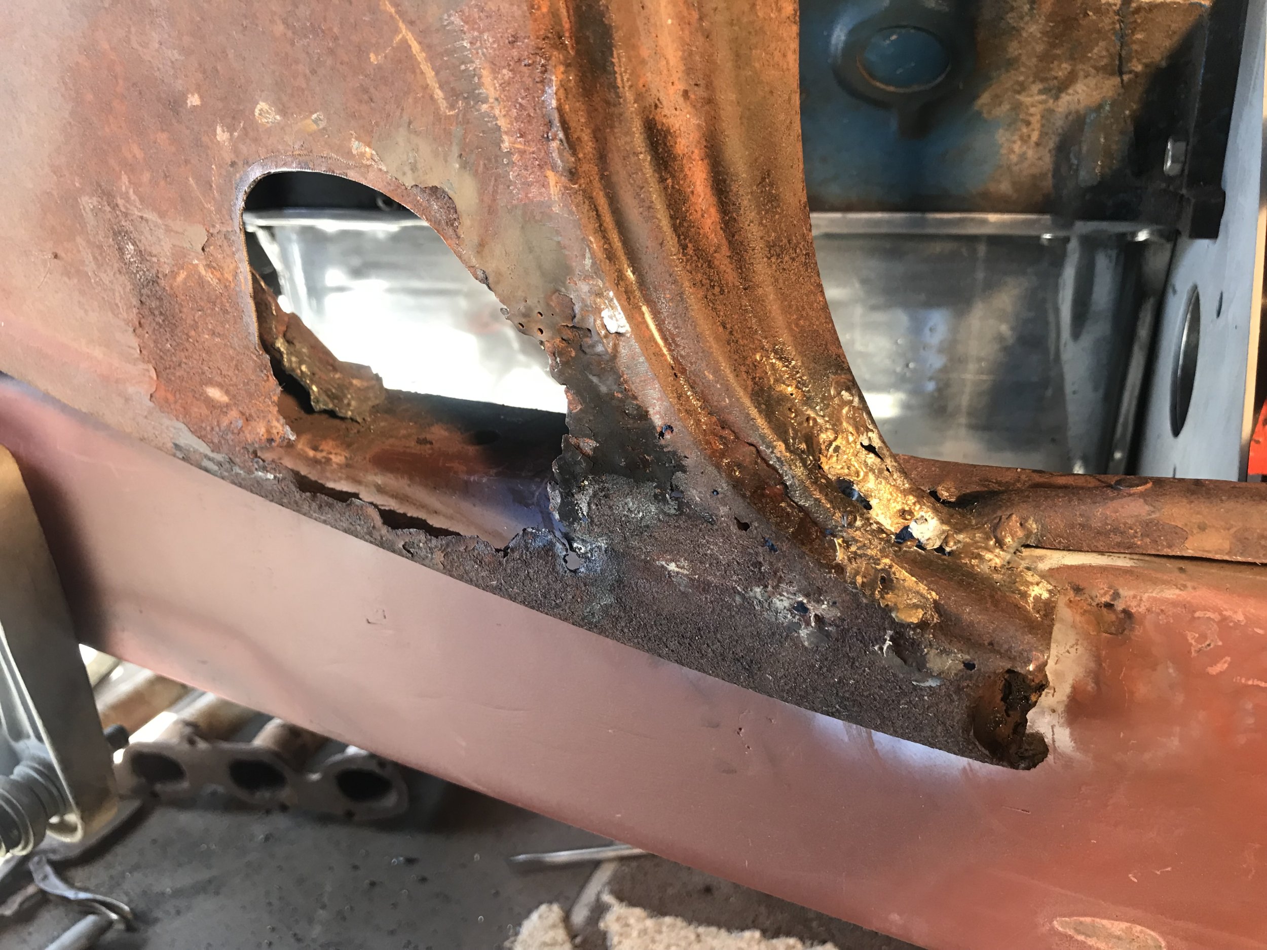

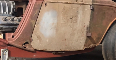

  9. These pics show the condition of the lower quarter panels, rockers and cowl sides. New metal needed everywhere. IMG_1855.jpeg IMG_1856.jpeg IMG_1694.jpeg IMG_2041.jpeg
    Upper driver side cowl had an old repair where someone had brazed up some holes and left a warped mess so I cut that out and welded in some new metal. IMG_1696.jpeg
    New rockers needed to be modified to clear the frame I am using, 35/36 highly modified swap meet special. Doors clear fine. Kind of funky but on this car funky is good.
    After many hours some satisfying progress….

  10. There is a lot more patching to do. It needs a new panel below the trunk, top chop needs finishing, doors need fitting and one needs a lower panel, new latches etc, etc. To keep myself motivated I sprayed on a few cans of primer to give it a different look. IMG_1858.jpeg IMG_1869.jpeg IMG_1870.jpeg
