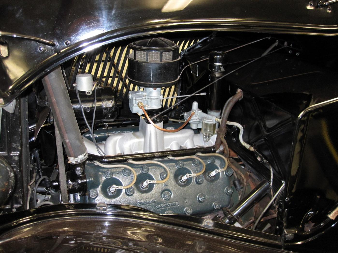

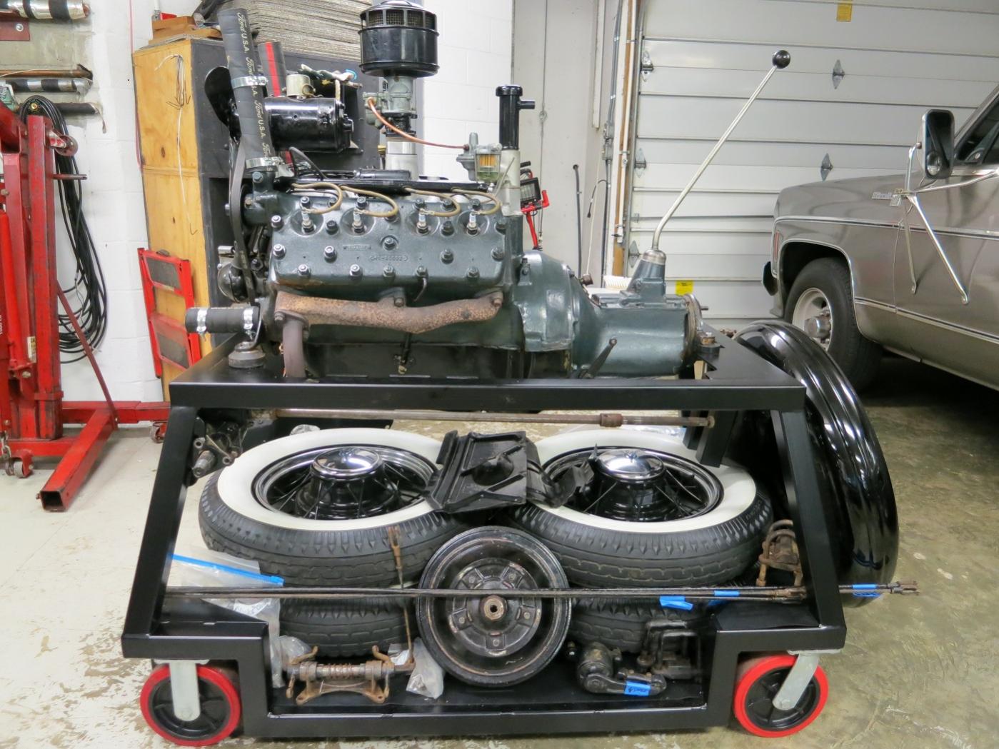

    Randolf,
    I am not sure that anyone would be that interested in my idea of taking a perfect original '34 and turning it into a hot rod ....... but not drilling any holes, always respecting the original condition .......... and keeping all the stuff so that it could be put back to stock if you wanted to.
    I realized that in more than 50 years of messing with cars that I had never seen anyone be able to undo what they had done ....... so that is what I am doing .......... I mean I was very lucky to be in the position to acquire the car and this car was so good it had the complete original wiring harness, wooden floors, interior, never been hit, no rust, and always stored out of the sun ..... and so on ..........so I decided that I would respect all that and at the same time ........ have my fun.
    This is so that the next guy (after I'm gone) ....... can put it back if he wants to. I think of this car as being fully adjustable ...............tp
