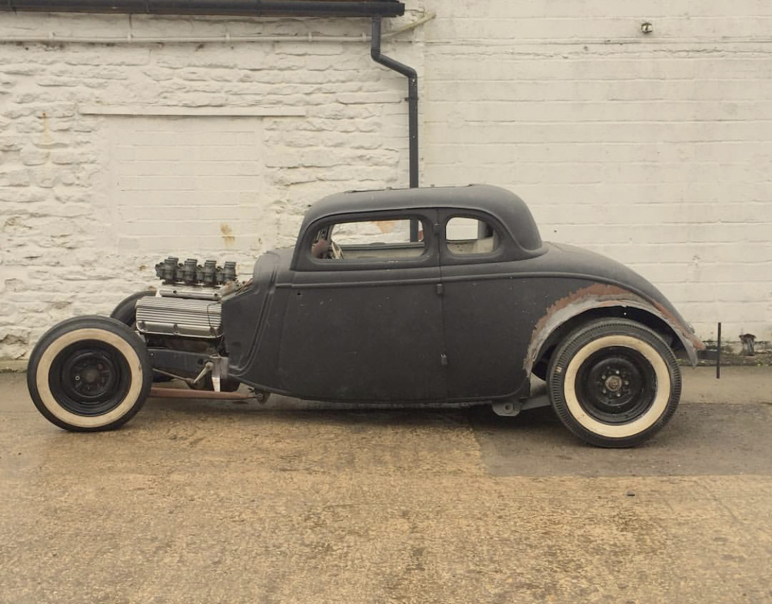

    Sadly it was in a bit of a mess. Some of the initial Hotrod work was probably typical of the time. Adequate, but not great. The ch***is step being plated with chequer plate and the practice of just welding metal everywhere where something was needed meant lots of random steel with no real plan. It was ok for the time, but needed sorting.
    This is the only photo we have of the car as it was.
    The good bits: it was a survivor 34 and the body wasn’t in that bad a state. It came with lots of really good parts, a couple of hemi's, a couple of Lasalle gearboxes plus plenty of other good parts.
    The bad bits: it was going to take a complete rebuild to put it right.

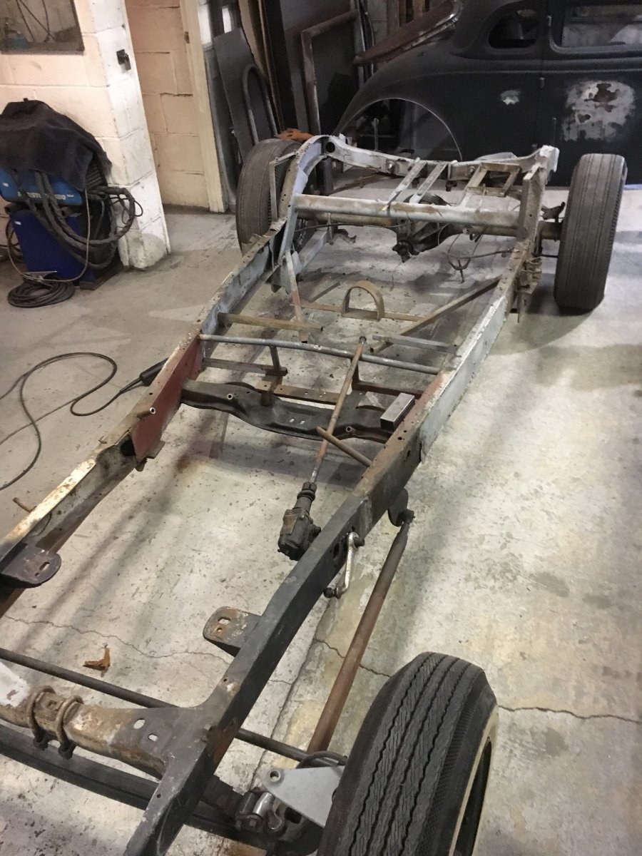

    This is how the car was when we started.

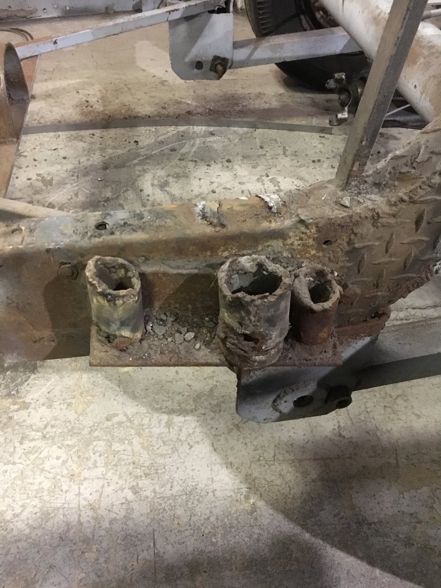

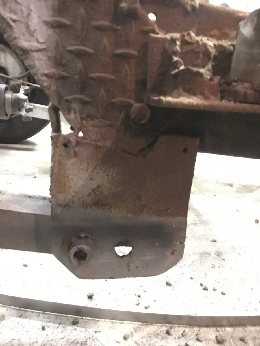

    The body had had the floor cut out, channeled over the ch***is and welded on wherever it touched. The flooring was just tin that had been screwed to the top of the ch***is.
    it took a fair while to remove the body without destroying either the body or frame.
    Once off, the full extent of the ch***is add ons became obvious. There was a square roll bar welded to the top of the ch***is, but there was also a piece of angle on either side of the ch***is that had three previous roll bars welded on that had been removed with a gas axe.

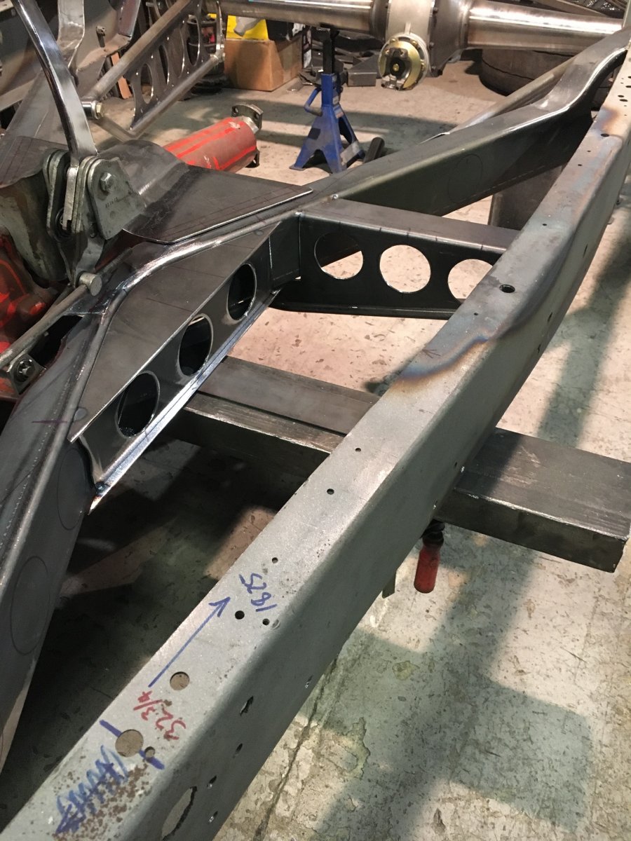

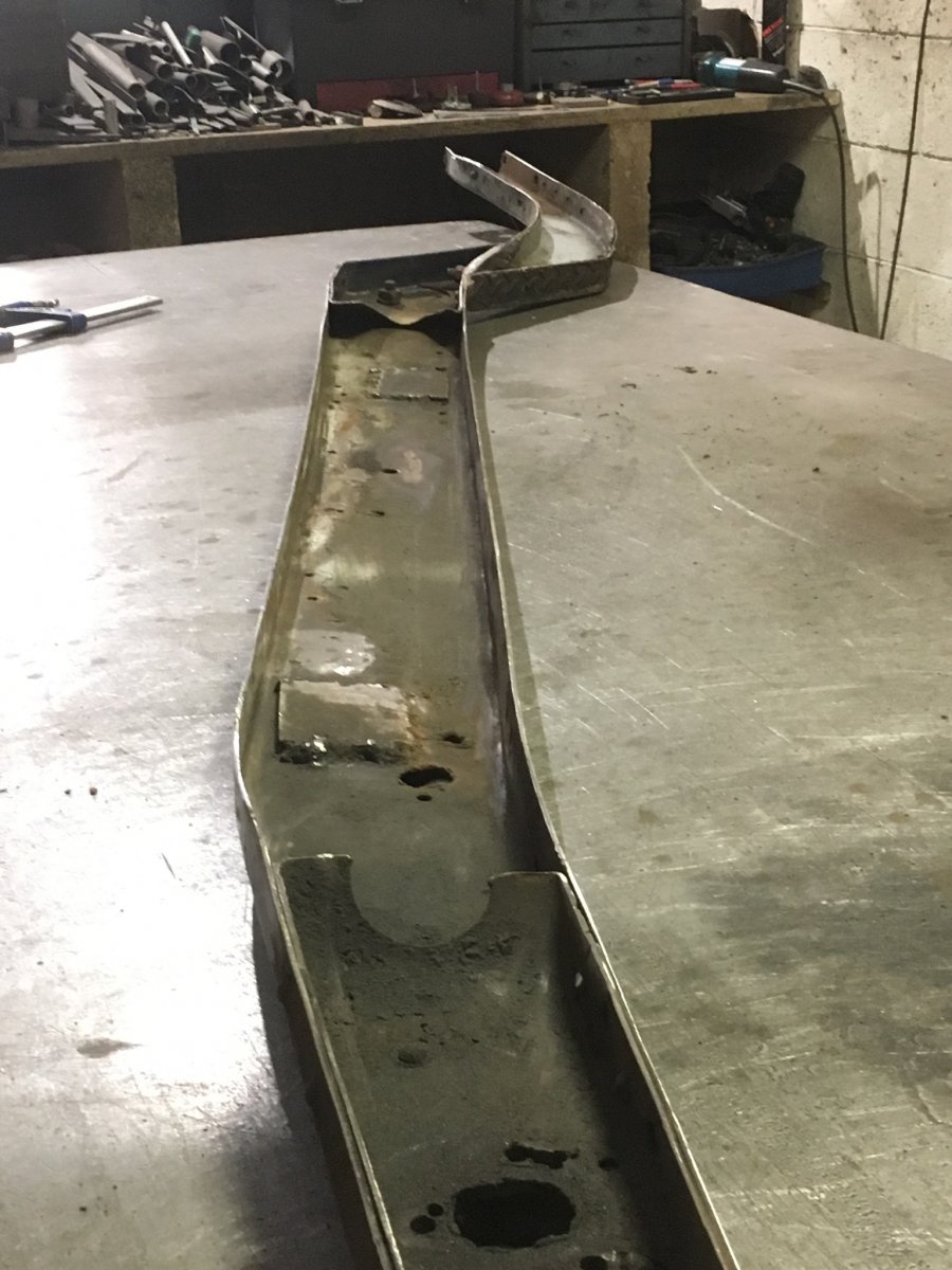

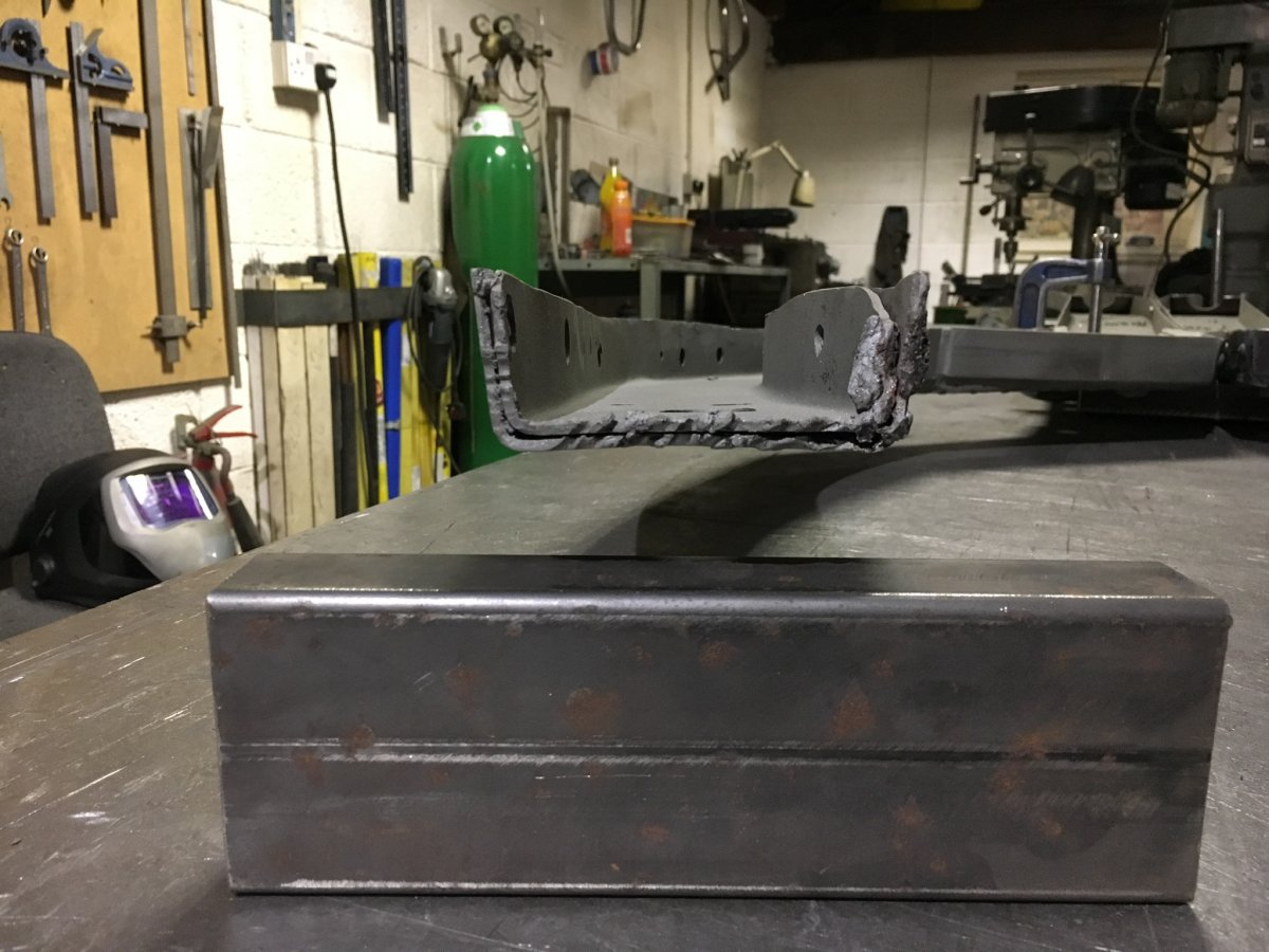

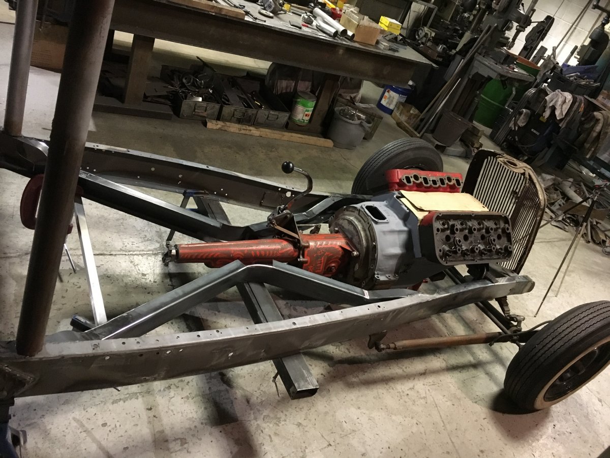

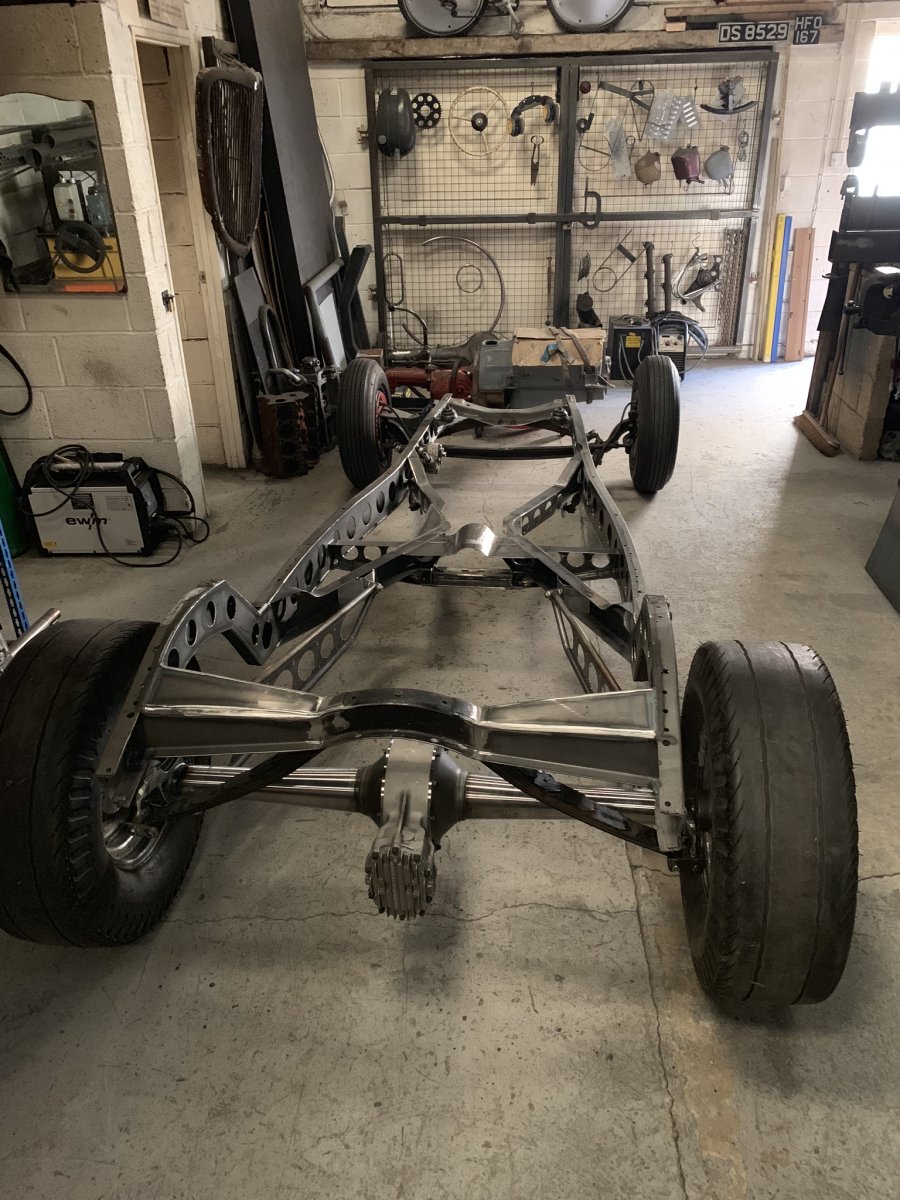

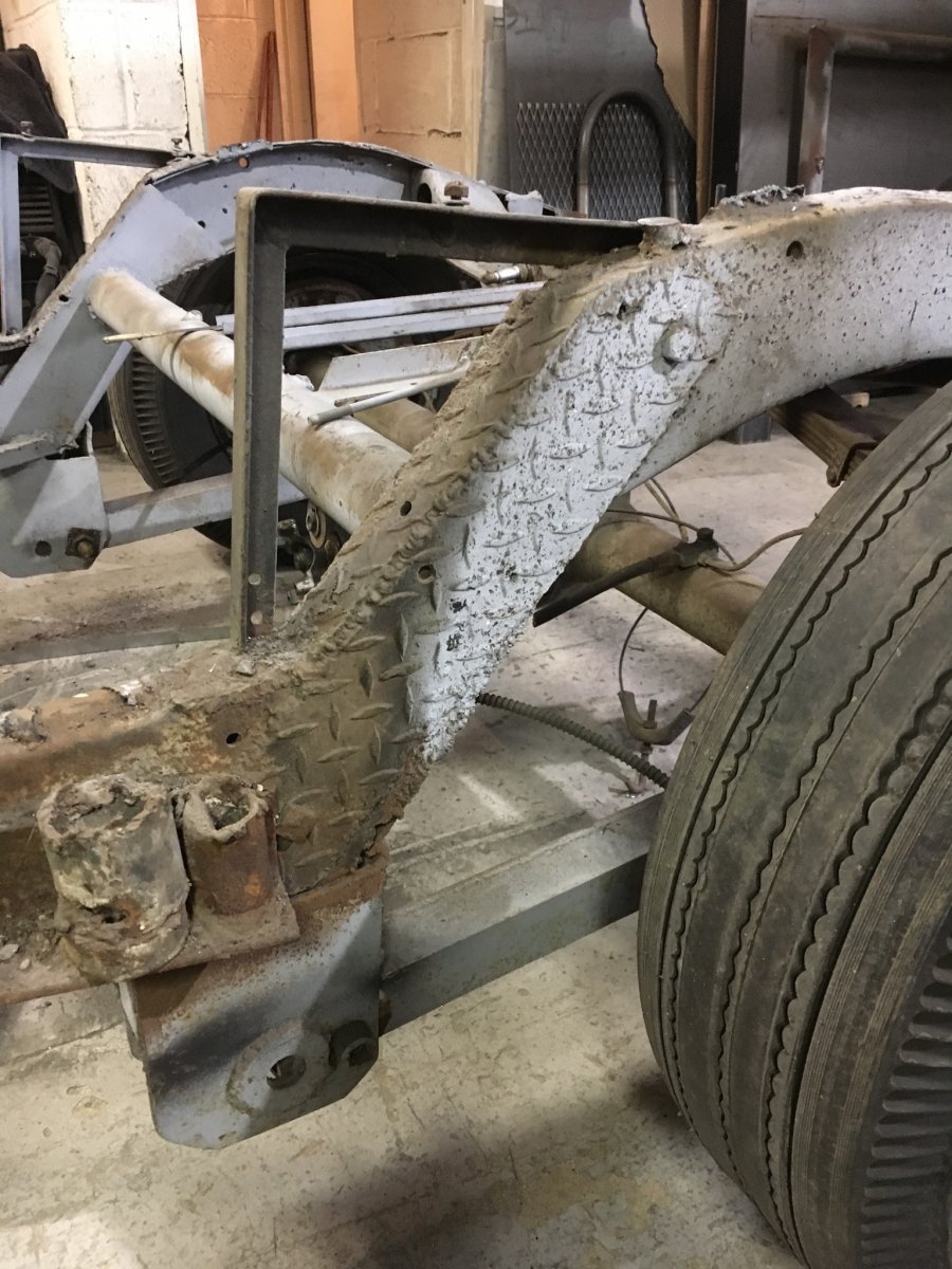

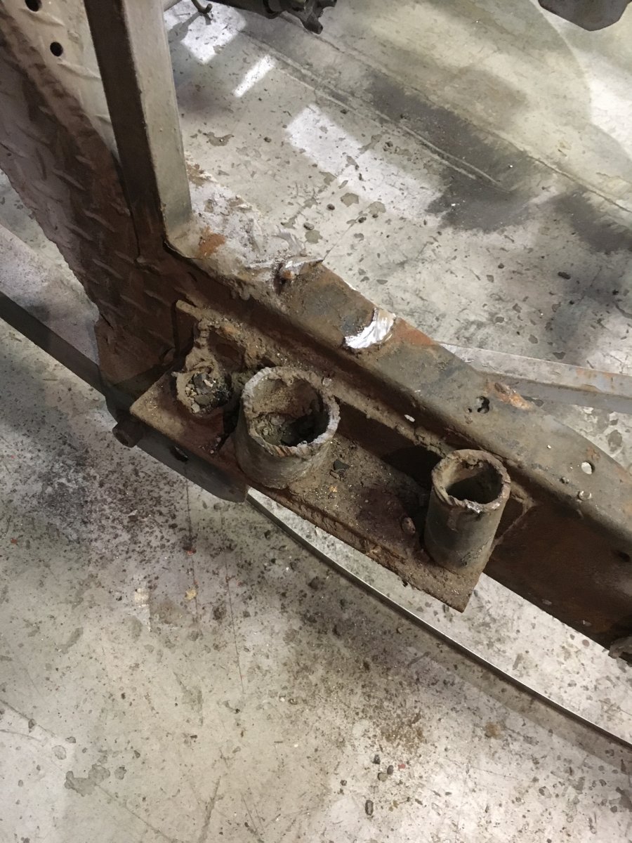

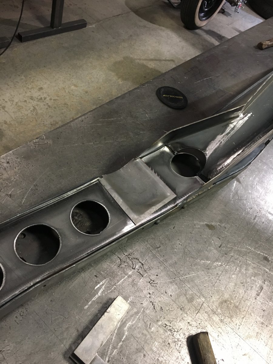

    With all the unnecessary steel removed from the ch***is I stripped it down to straighten and repair the ch***is rails.
    The chequer plate was added when the ch***is was originally stepped and it was decided to keep it that way. The welds were all ground off, the plates removed, cleaned, straightened and welded back on.
    The original cruciforms had been removed.
    E64B0816-F338-49CC-88C3-E614076BF03A.jpeg B1652B5F-F7D6-4DB0-8638-ECB7A361425B.jpeg 4294F677-2F40-490B-9359-A6189697C134.jpeg

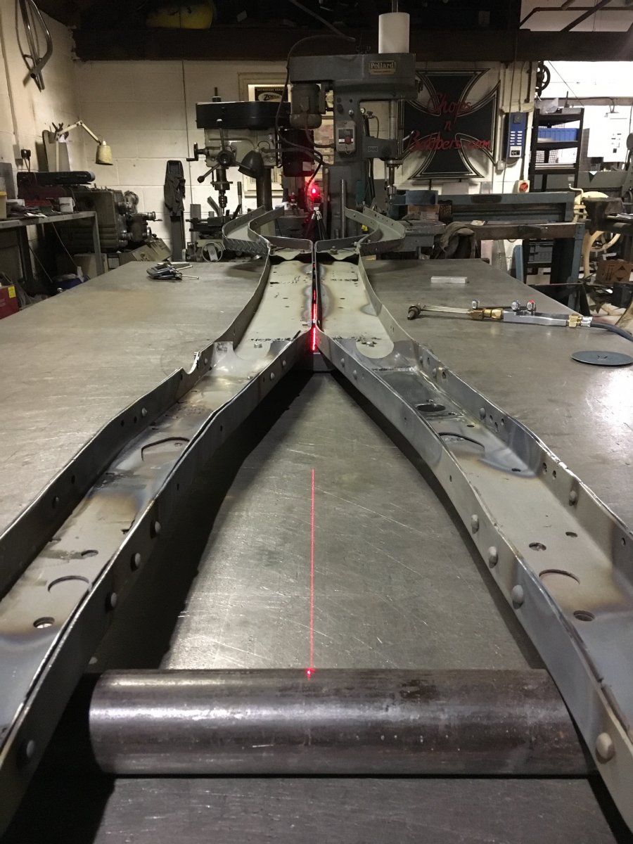

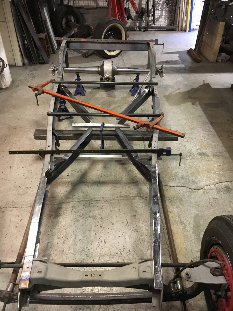

    The ch***is rails were twisted and bent.
    4AB1AAAB-0EDB-4334-A2C2-736657C86649.jpeg FA30E47A-3F1A-472A-8E1C-1EC085215976.jpeg

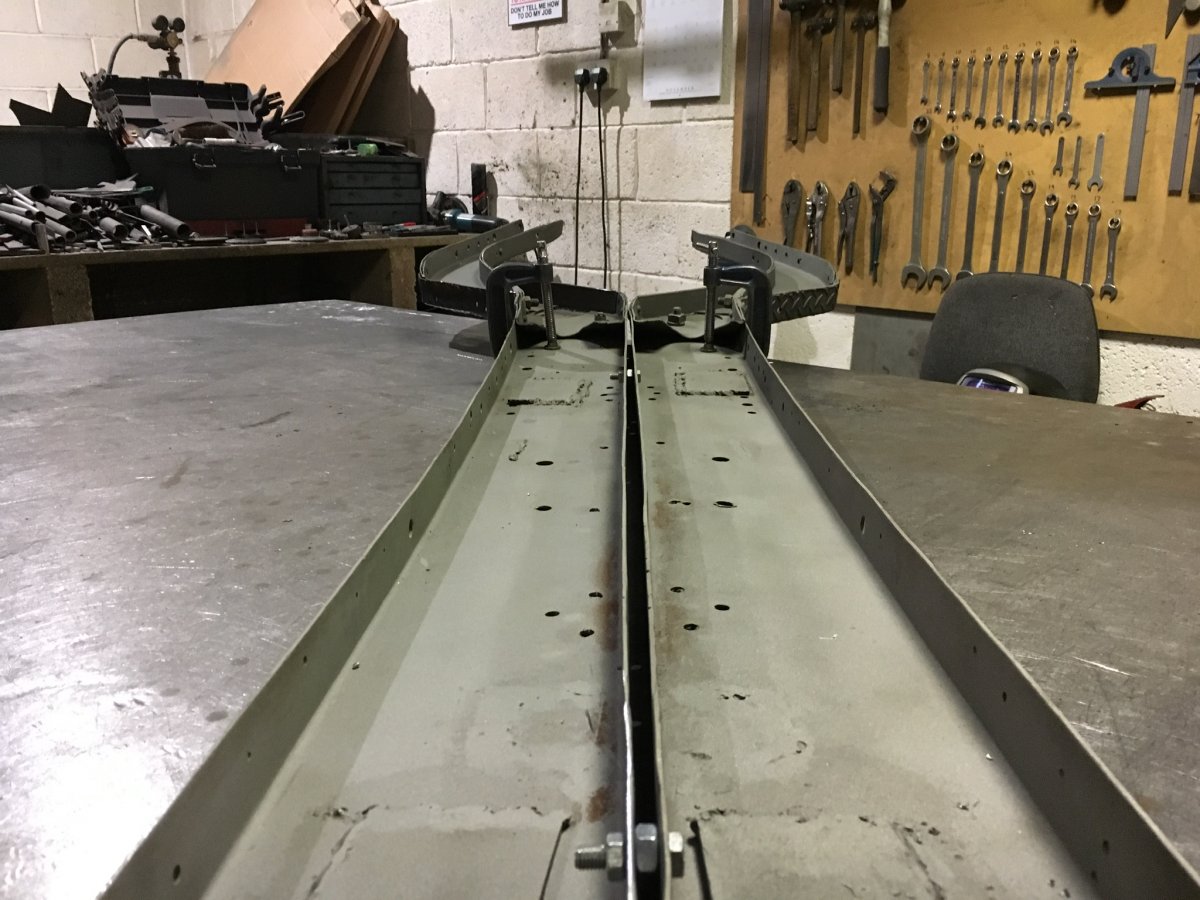

    I used a laser to get the two ch***is rails exactly the same

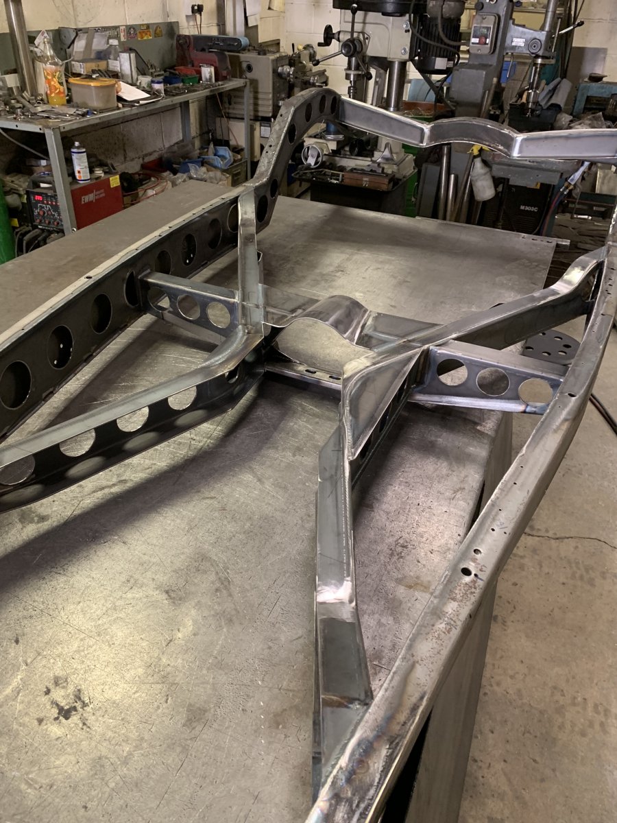

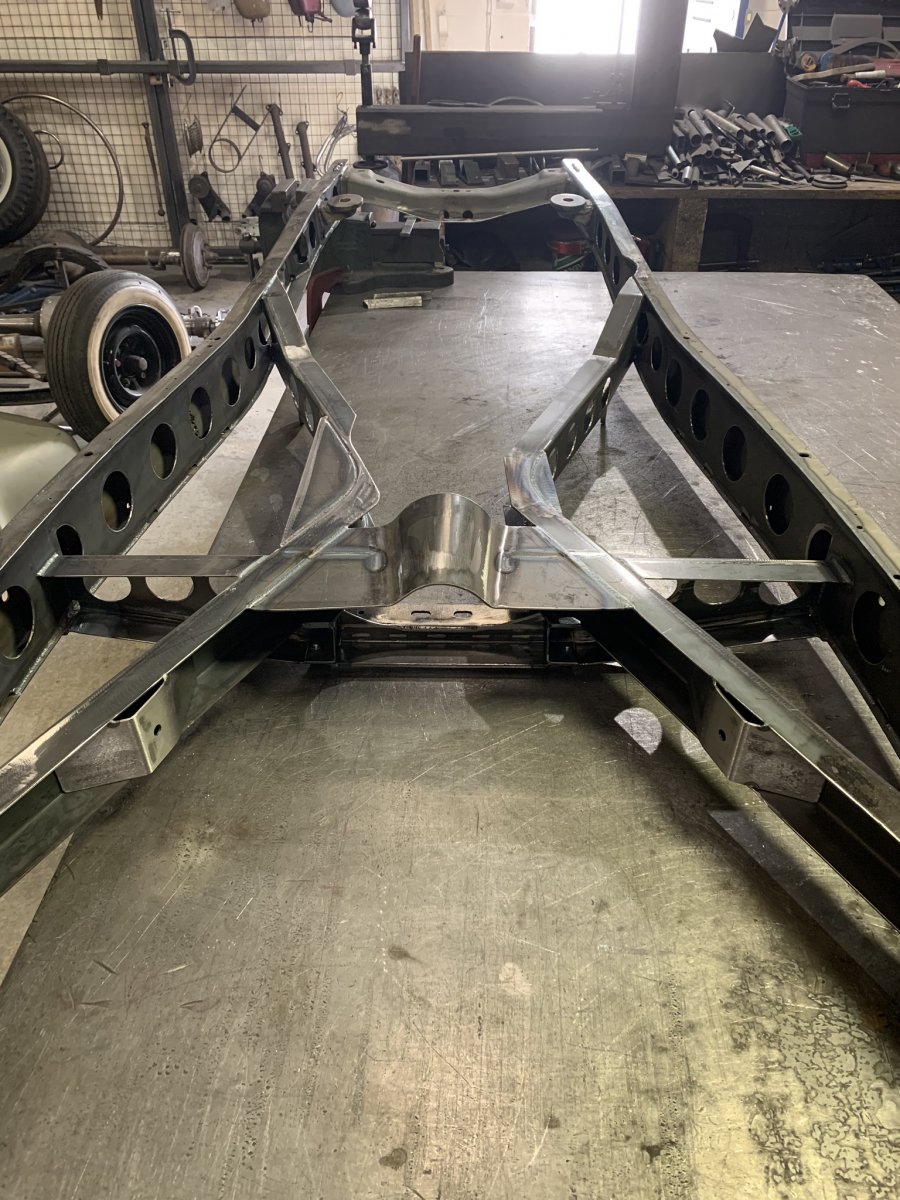

    I started to make new a cruciform. Made lower than original so the floor and seats could be lower in the car.
    C66D34F5-5BDF-4213-BF14-63DAEC5BD71B.jpeg E21BEC8C-60D4-4C2A-A38B-78AA12870806.jpeg
    Early long bell housing hemi and Lasalle gearbox trial fit
    9C678BE3-AFF5-42A6-A6FB-D1514D992ABB.jpeg CDB01BC9-270E-42BD-8AA2-47C360E3F9DC.jpeg
    More strengthening around the cruciform
    Cut out for oil filter clearance that won’t be used. It was there when it was first built so we kept it there.

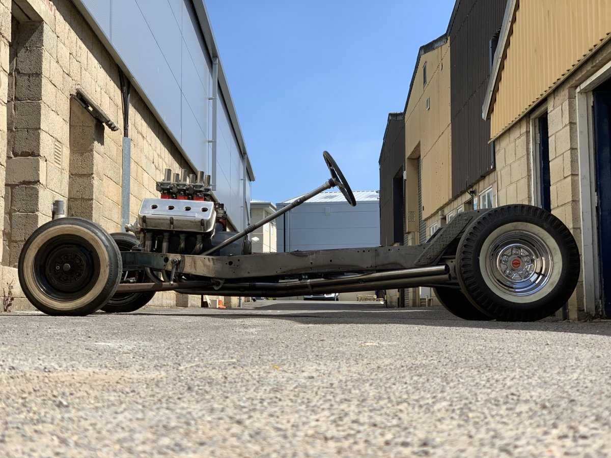

    all the basic ch***is work done.
    CCB8DE67-A037-4EC8-BFA8-431C2731446E.jpeg BE32D888-CC9B-4672-845B-4BEA8BA1B2DE.jpeg 3F28E67F-EB67-4E6F-91DC-85A8CEEA5B2E.jpeg

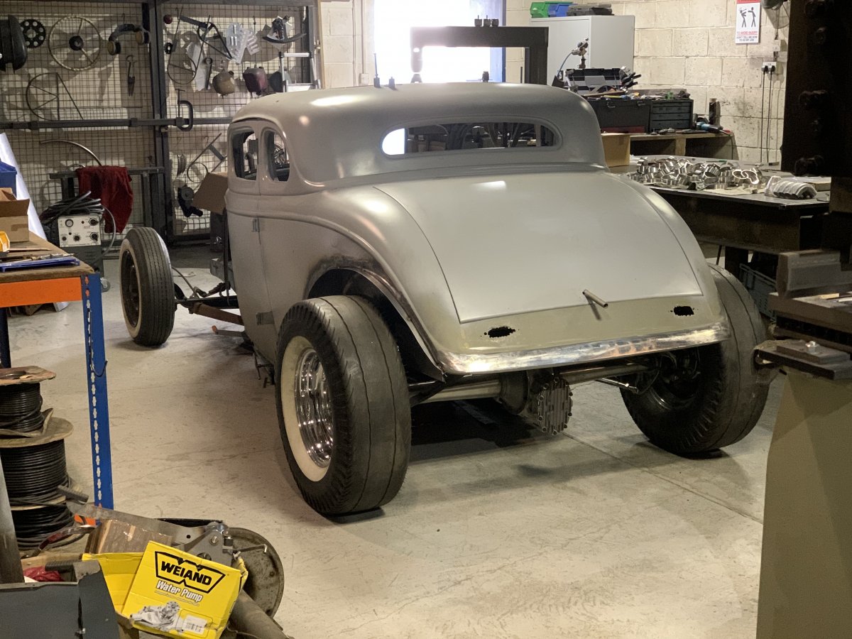

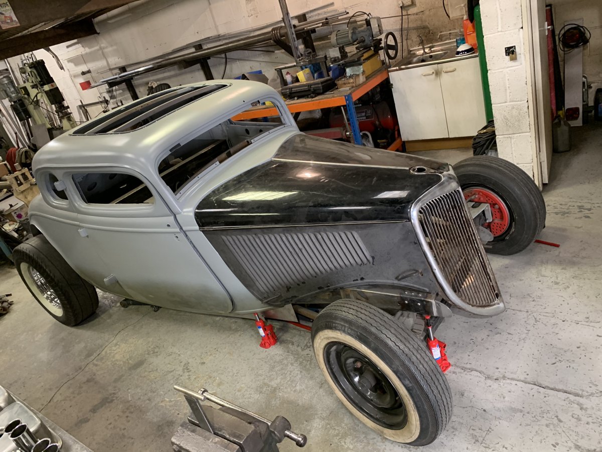

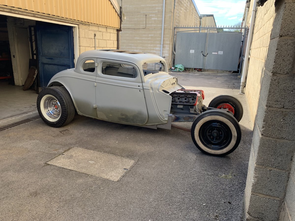

    start of the mock up with a winters QC and cheater slicks. You can now see where it’s going.

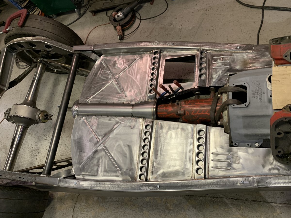

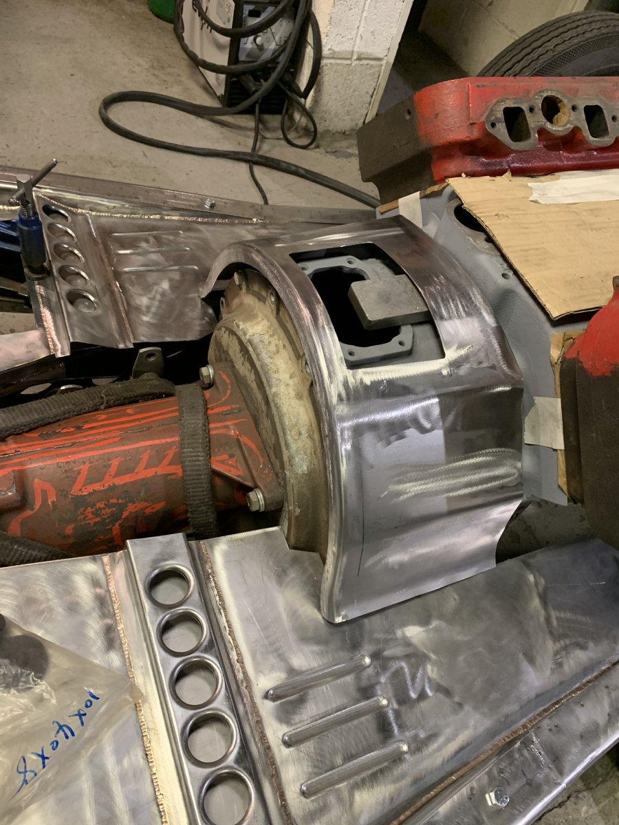

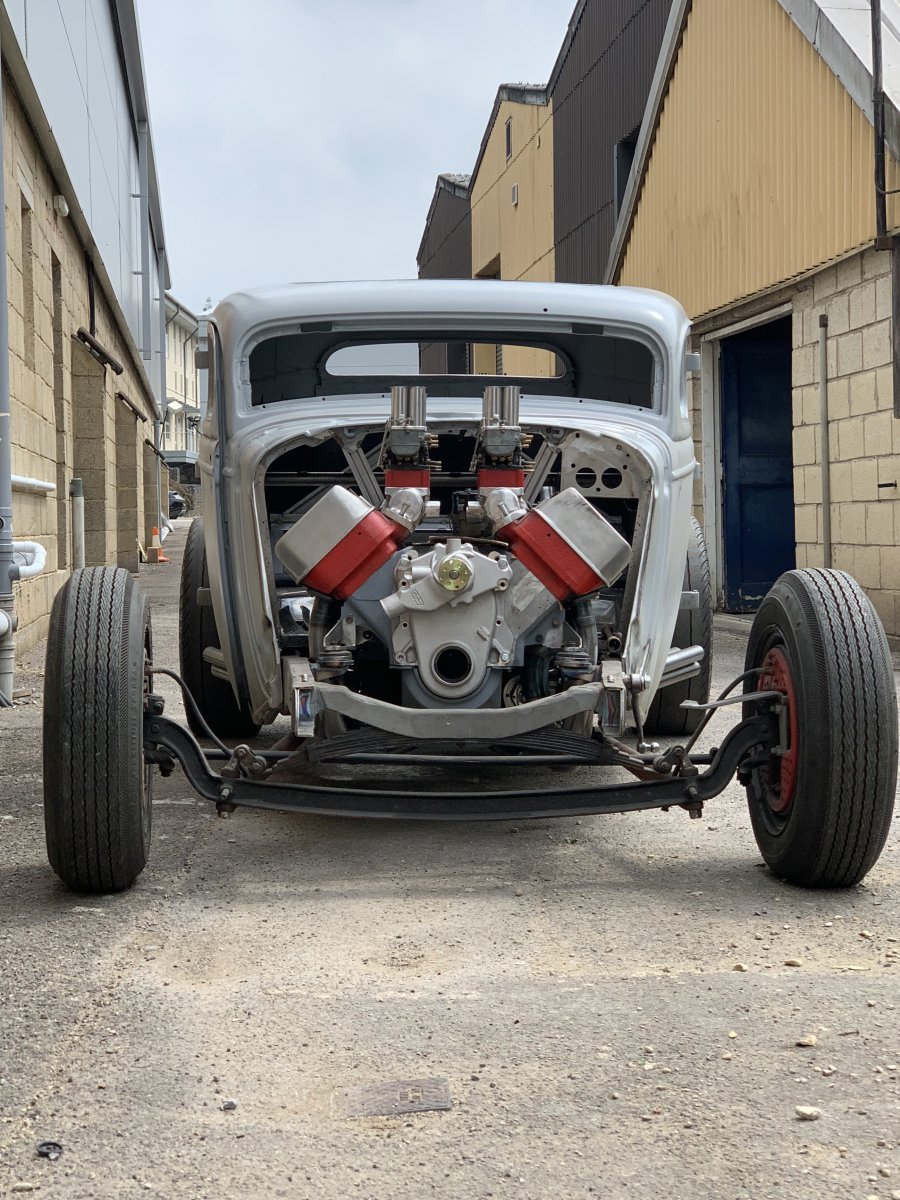

    As the car had no floors I needed to make them. I couldn’t just use reproduction floors as they had to be lower than the ch***is rails to get the required room.
    The owner, KFC on the hamb, found a pair of seats that were labelled Maserati. Whether they are Maserati or not, they’re ****** cool.
    Tunnel and ‘holed’ strengthening parts added
    7D2C9B39-F858-40AC-B863-566960089CCC.jpeg 8E97502D-F304-4EFA-B736-817989E0B4A8.jpeg

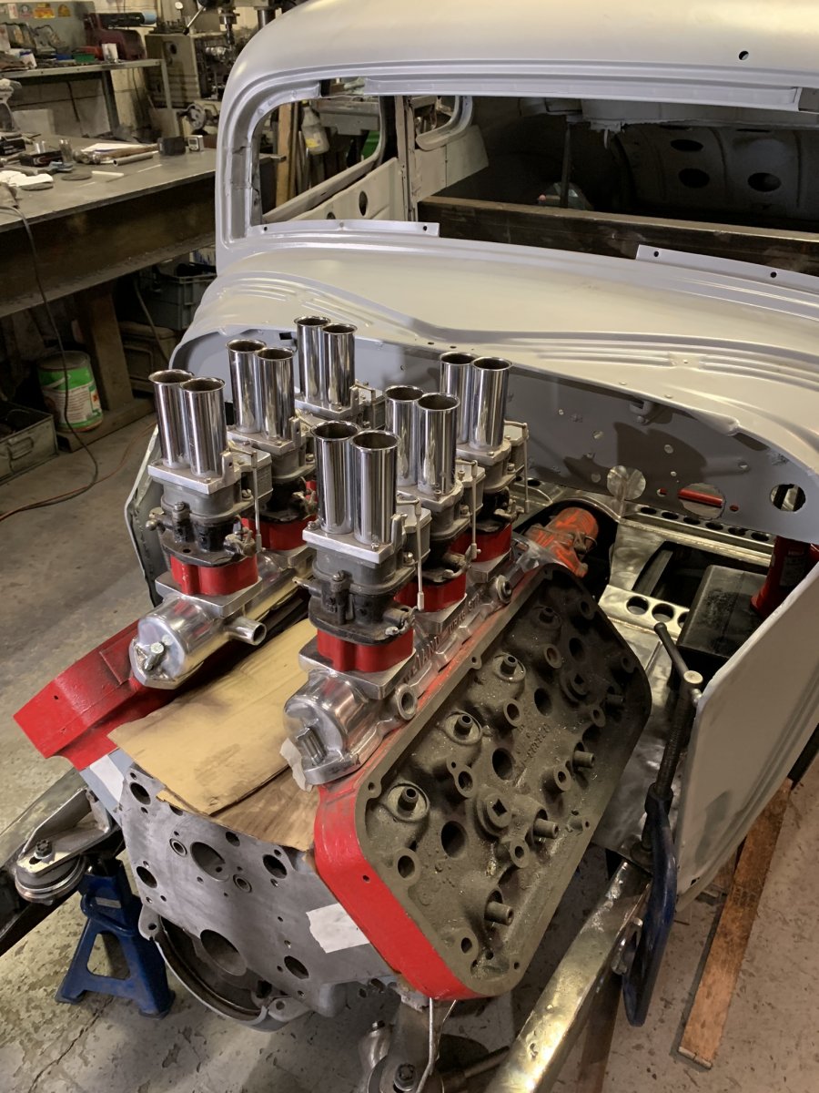

    Start of the trans housing. I needed to get it as close to the bell housing as possible so the pedals would work. It was going to be very tight.

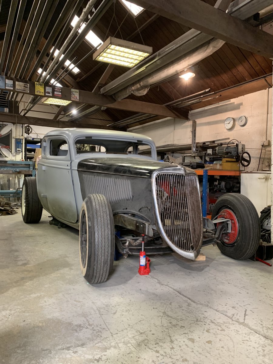

    With part of the floor in place the body was trial fitted to see if it all went together properly. And to push it into the daylight to stand back and get a better look.
    The obligatory “fit the carbs” just to check they’re the right ones, as if they wouldn’t be.

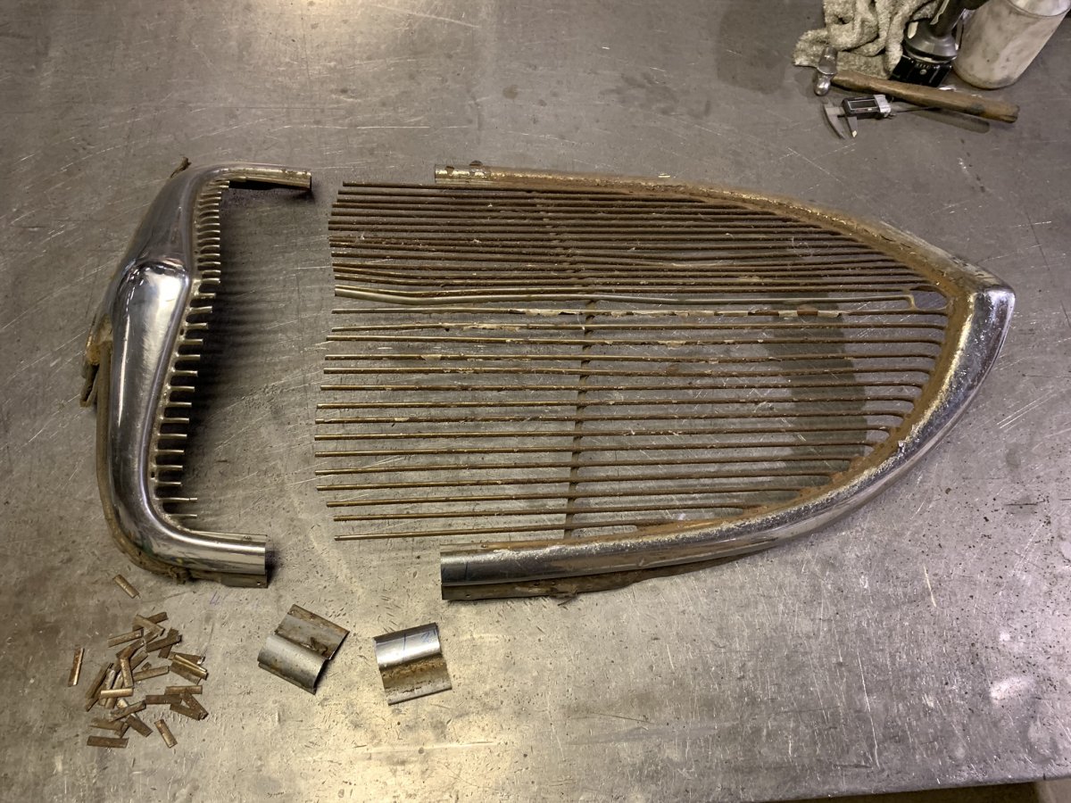

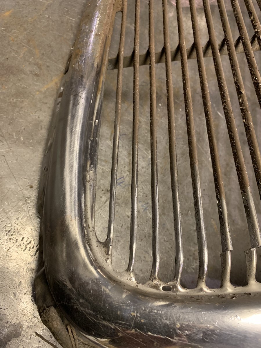

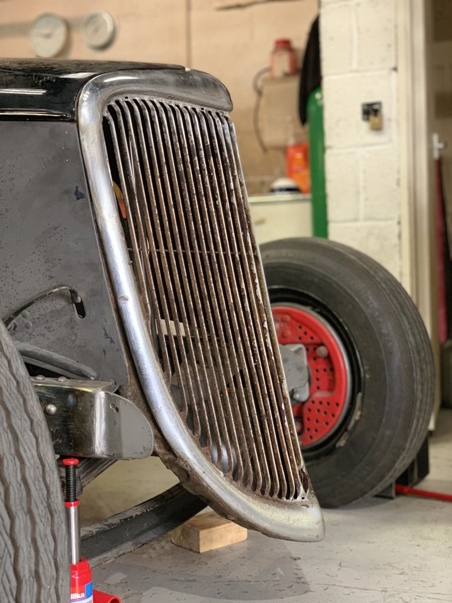

    Trial fit of the hood meant the grill shell was too long. The car was probably fitted without a hood and with the grill shell angled back. One of the rules of running with the VHRA at Pendine sands is that a hood has to be fitted.
    CA1247BF-AE0C-4774-B00E-9F6F7427489F.jpeg 9890E690-6630-4595-90E7-90D129F02BBC.jpeg 2785B29E-C286-4027-86A6-D4131512B568.jpeg
    So 2” was cut out of the shell.
    2C0784C7-4490-4807-8D3D-A8848E5BCE8C.jpeg 3BB899E9-A683-4DDF-A9D1-ED71441C976E.jpeg 1319B58B-0D5C-4ECA-9E0D-8BCF97CAA087.jpeg 2D27D941-1A3C-4704-8264-C5E04EDB13FE.jpeg 98B79AF0-959C-49C7-8814-4D5E24C1BBD5.jpeg 0A3A5D5A-03E0-4551-9396-BEA8B2BE5C51.jpeg 3184269C-C25B-44D9-BFF6-2040F01AECB5.jpeg

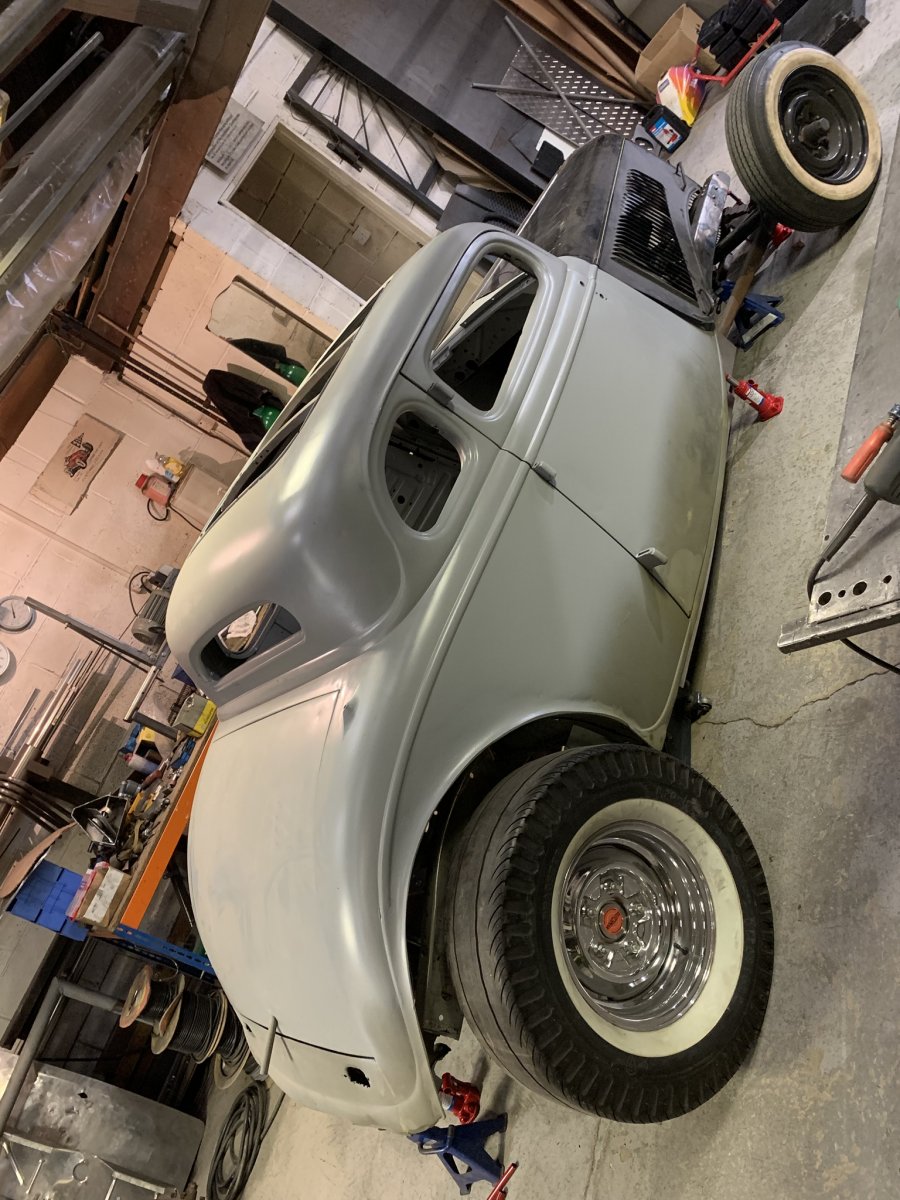

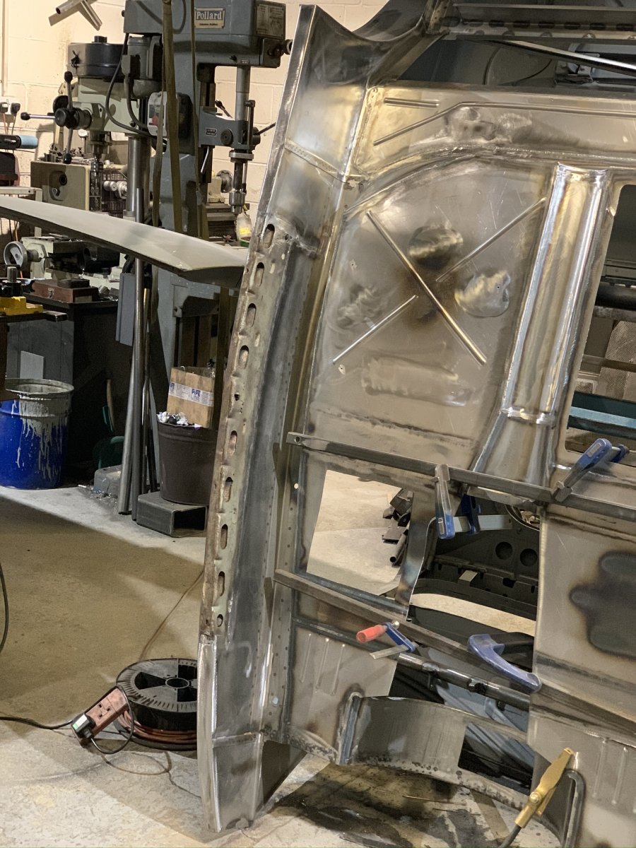

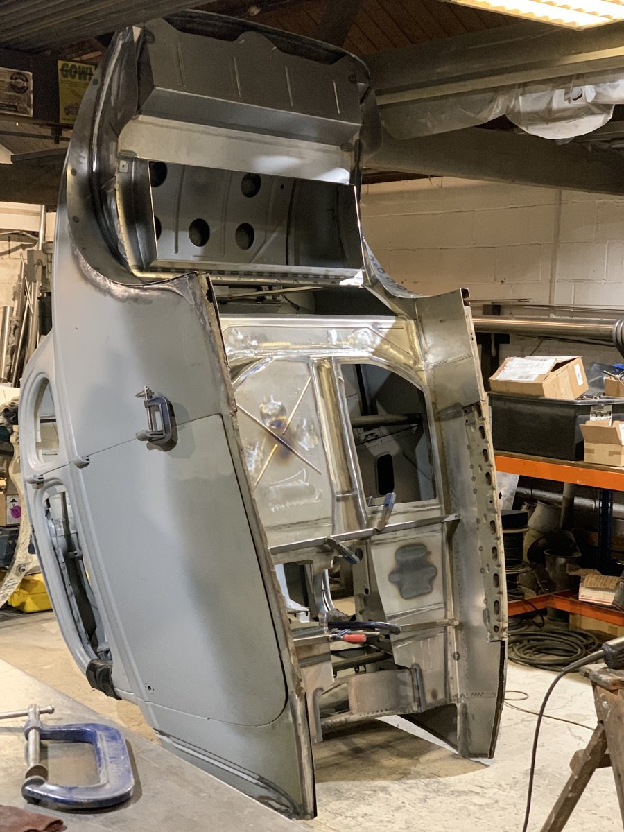

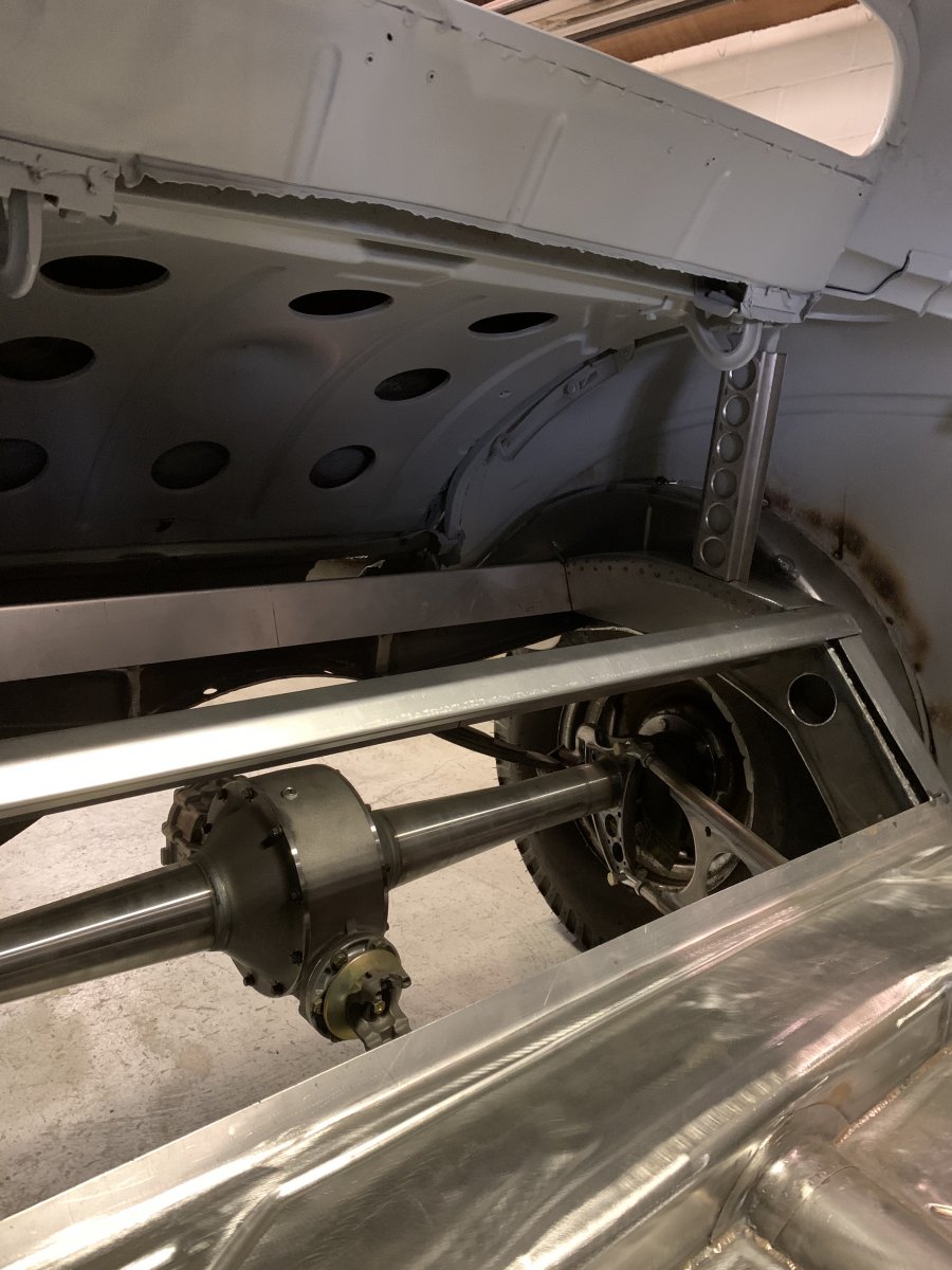

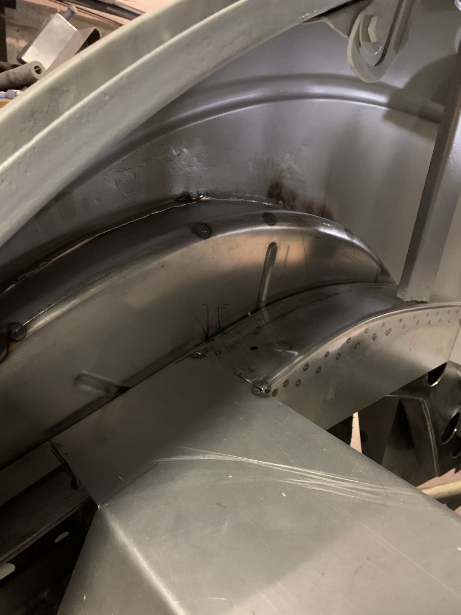

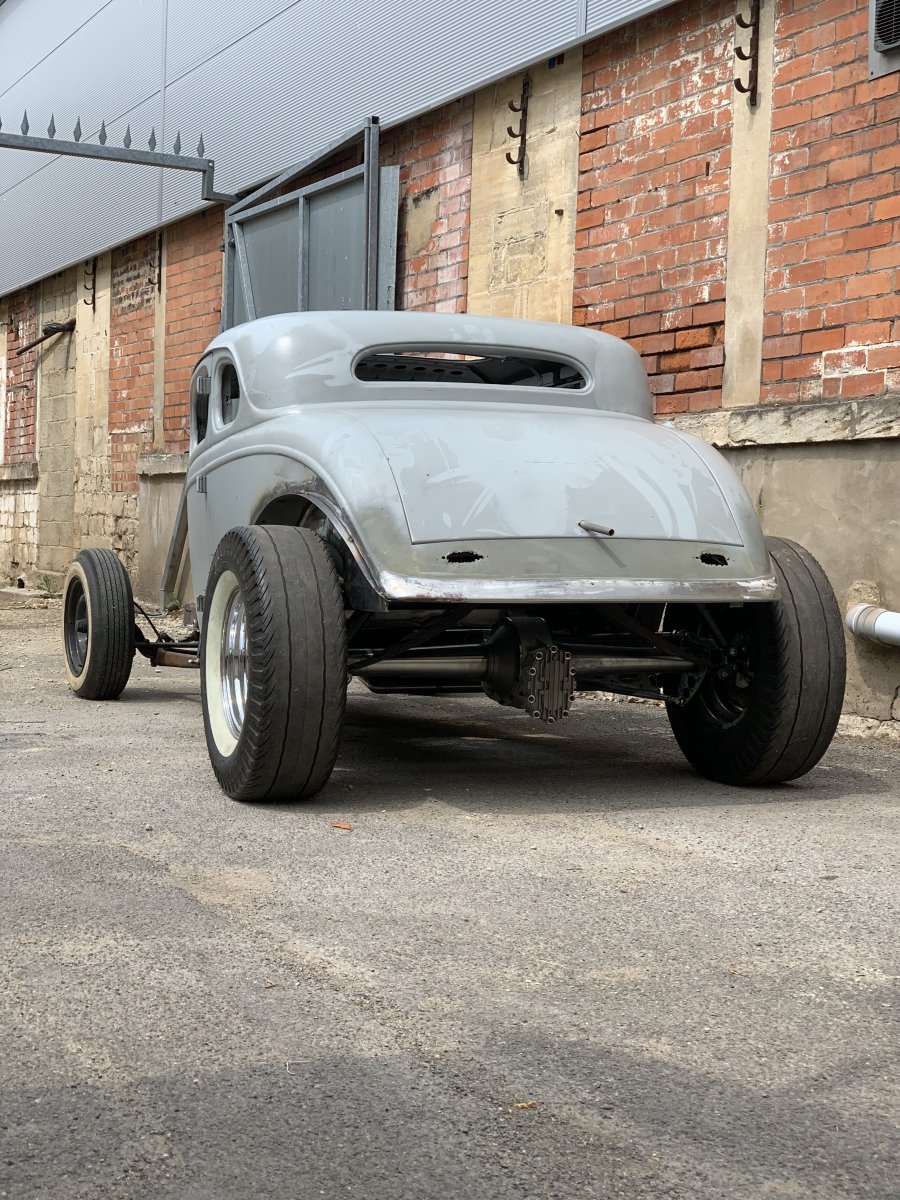

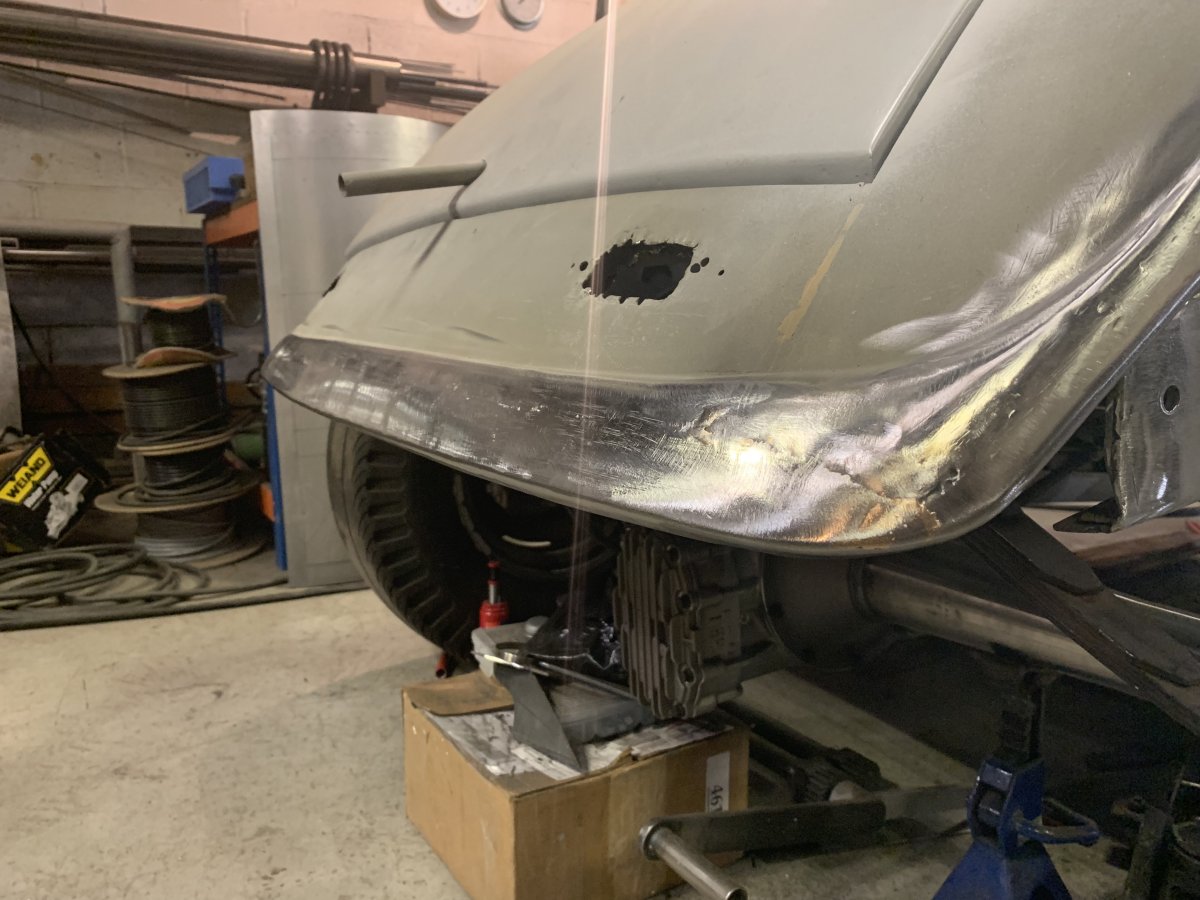

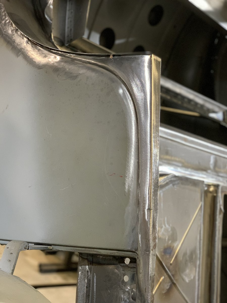

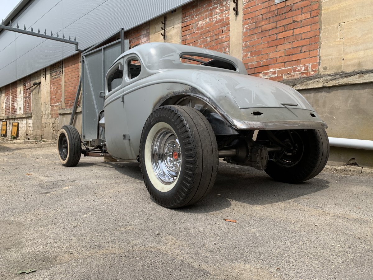

    With the body temporarily back on the ch***is I could work on getting the floors completed as well as the trunk floor and some bodywork that was in need of attention.
    The rear arches had been radius’d by cutting the old returns and swage lines off and beating a return in to add strength. This was in principle great, just in practice it lacked a bit.
    Some of it I cut out, other bits will be lost under a smear of lead.
    99A8DAAC-4CE7-4E0F-ACF3-89791DC62BCB.jpeg 1A4D247E-7D33-473E-A880-A5456B491CBE.jpeg
    I made new wheel wells. They now look like original ones that have been cut down keeping part of the crows foot. Having them cut down like this also exposes those diamond plates.
    on the original build it looks like the car was fully rendered with the fenders blended in with lead. At some point, probably when it hit the drag strip, those fenders were removed. But as they were leaded in they were just cut off leaving an inch or so sticking out. I have replicated this. Once a smear of lead is blended back in it’ll look the same.
    C8482342-EB99-4A44-B9F5-AFB15FF978B7.jpeg 07C7EF33-2BB6-40AB-9A09-F2A4F52BFAFC.jpeg 2053B8AD-7250-4588-8440-C230197AF2AC.jpeg 942A9349-9440-4098-8D9B-076877DAE31E.jpeg 2C394F70-8968-4CC3-B074-BC85E50F29DE.jpeg

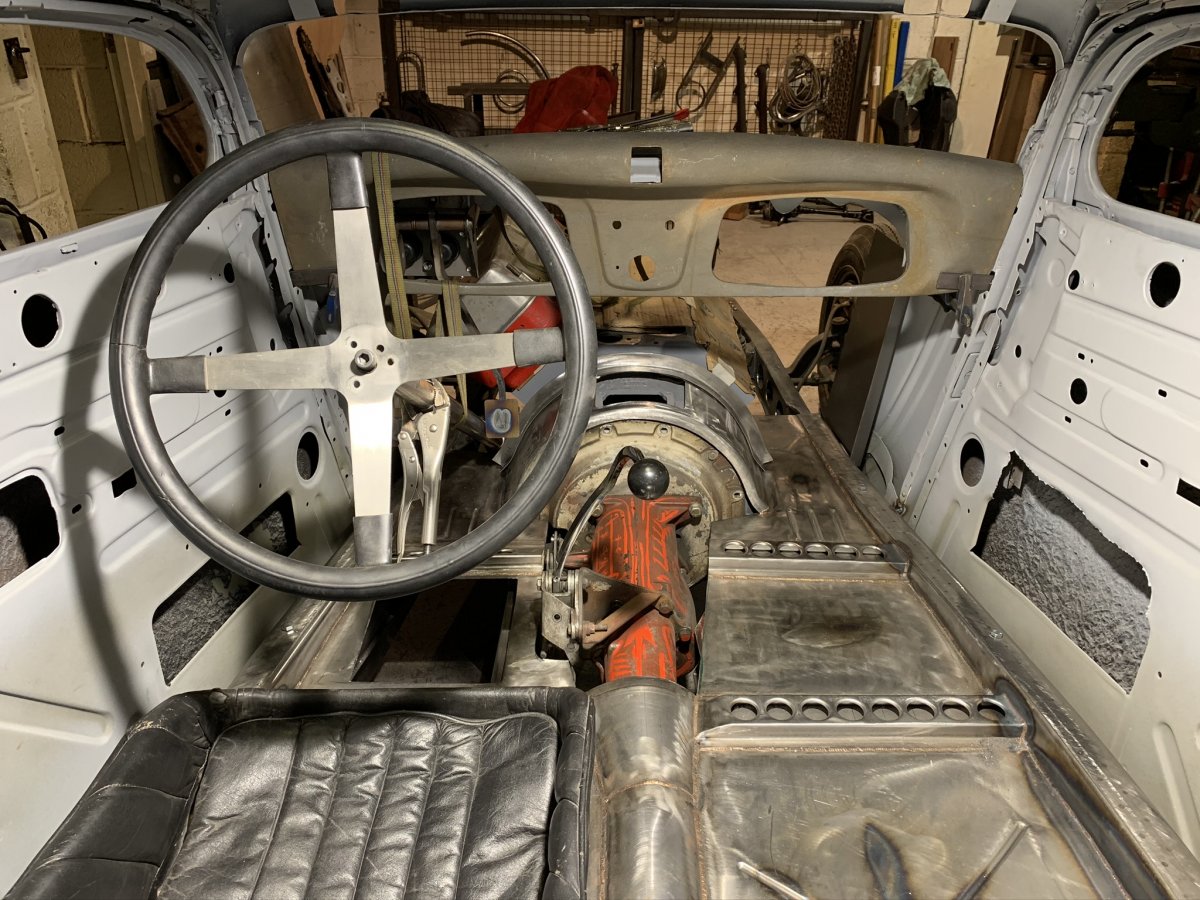

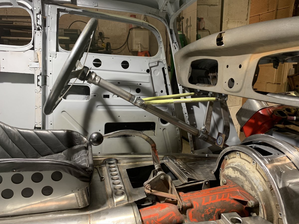

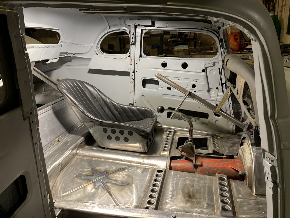

    Seating position was always going to be an issue. Chopped, channeled and with a long bell housing hemi set back in the frame, space was tight.
    the seat is placed well back.
    BB194601-9646-4356-B600-95E238D20F87.jpeg 76D34B52-5E6D-4B84-A099-2FBE4D03D7B5.jpeg 211078DA-A1A7-42C7-B4BF-E172D81C1CF7.jpeg
    The steering wheel is removable to aid getting in and out of the car.
    052625CD-44F7-4E8B-AF1B-17D0BBB6F73B.jpeg 75486901-3BBA-46AF-9E19-ADF3C5ACFFDD.jpeg C95BDE84-0269-493C-8A7D-83CB769B7901.jpeg

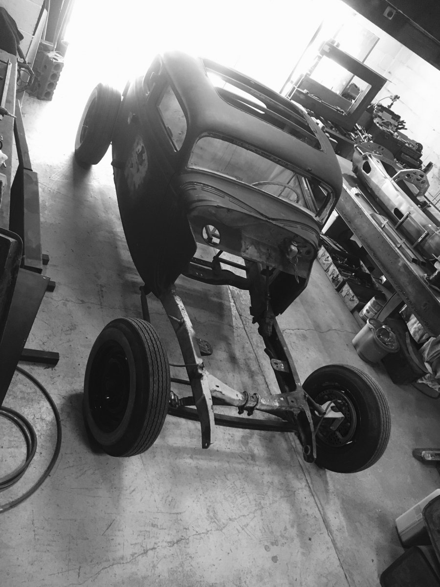

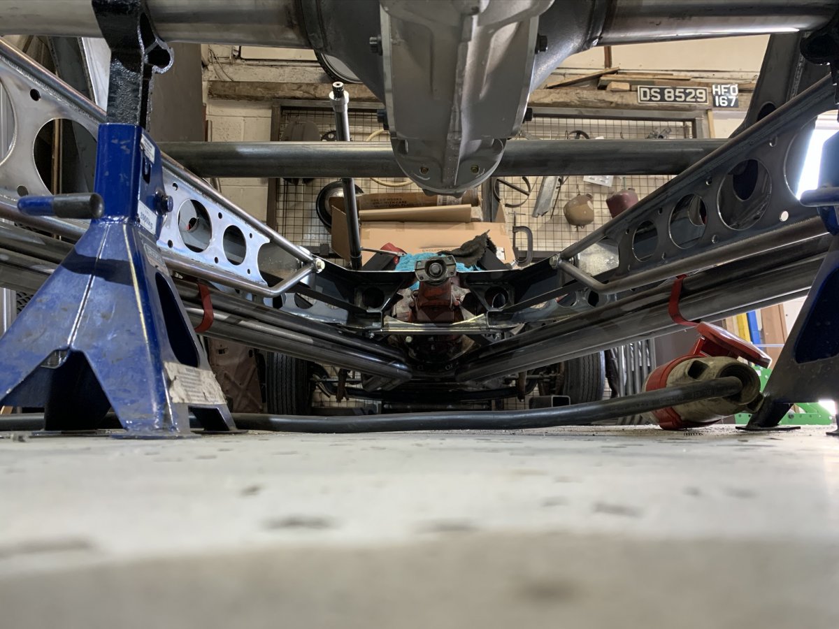

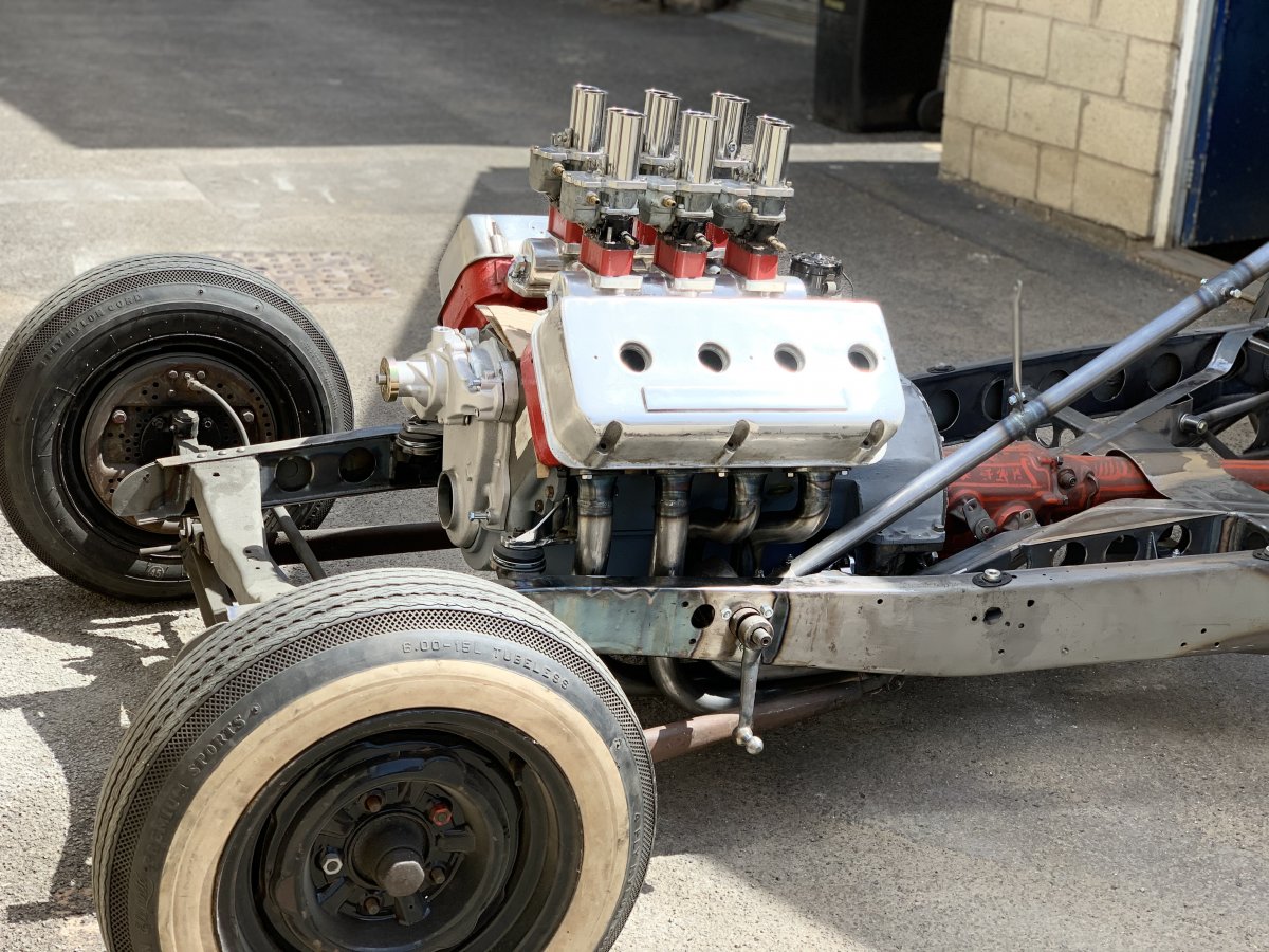

    It got to the time where the body had to come off the ch***is to allow all the underside parts to be welded.
    you can see how much the body is channeled over the ch***is.
    5406C094-2D39-49C9-AAE9-CDD98F4E0E1E.jpeg 302D6BB5-B19B-4588-84F5-3C524C1A8372.jpeg

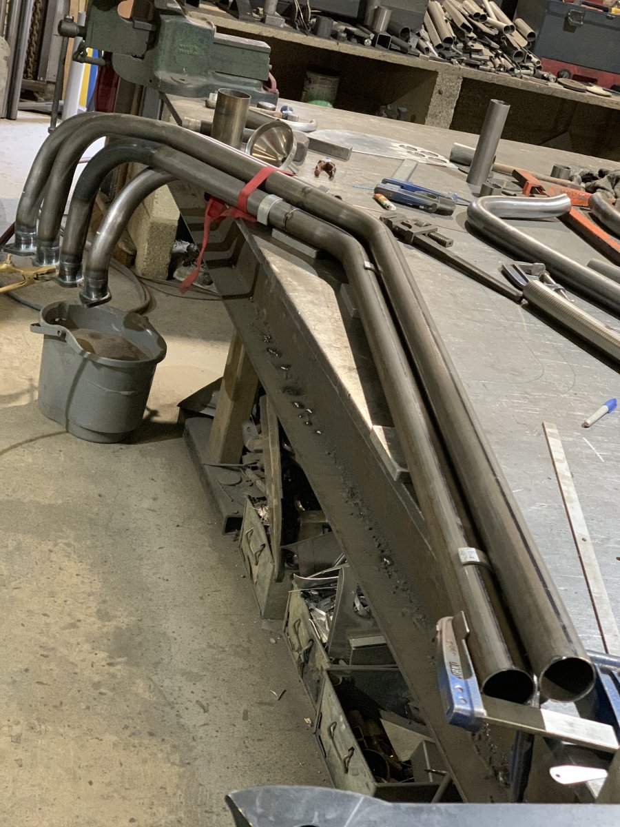

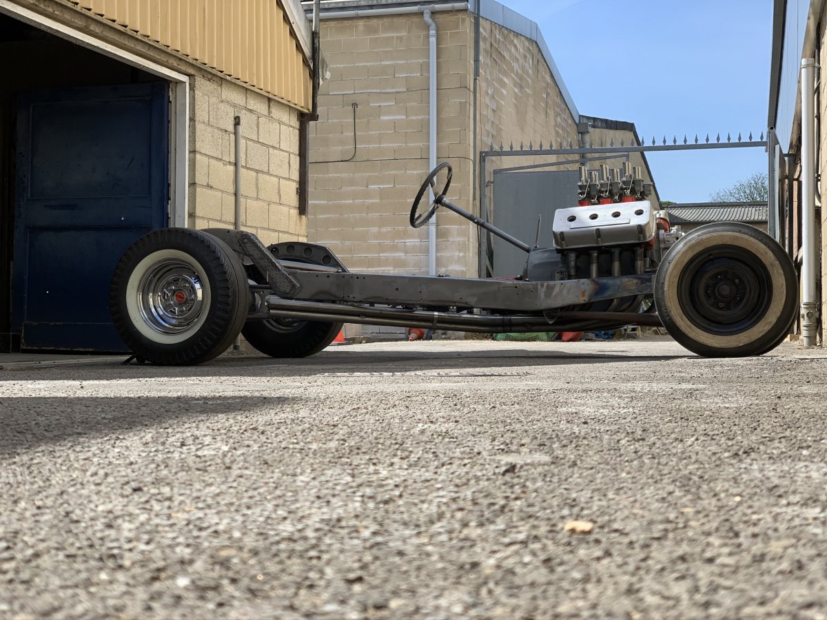

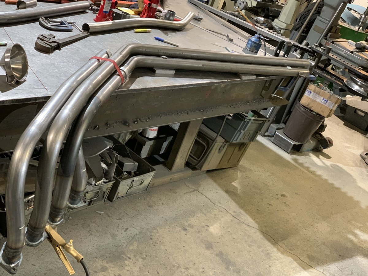

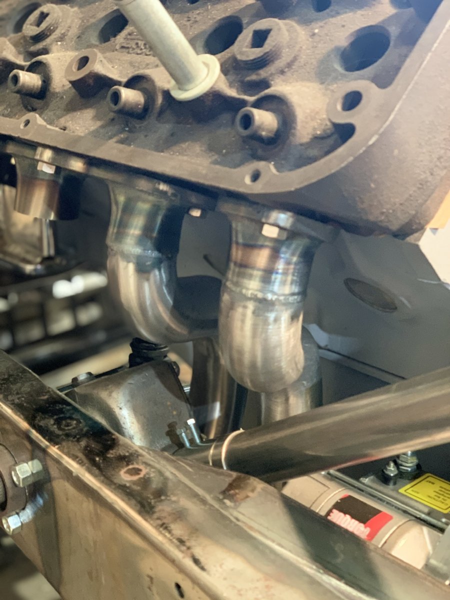

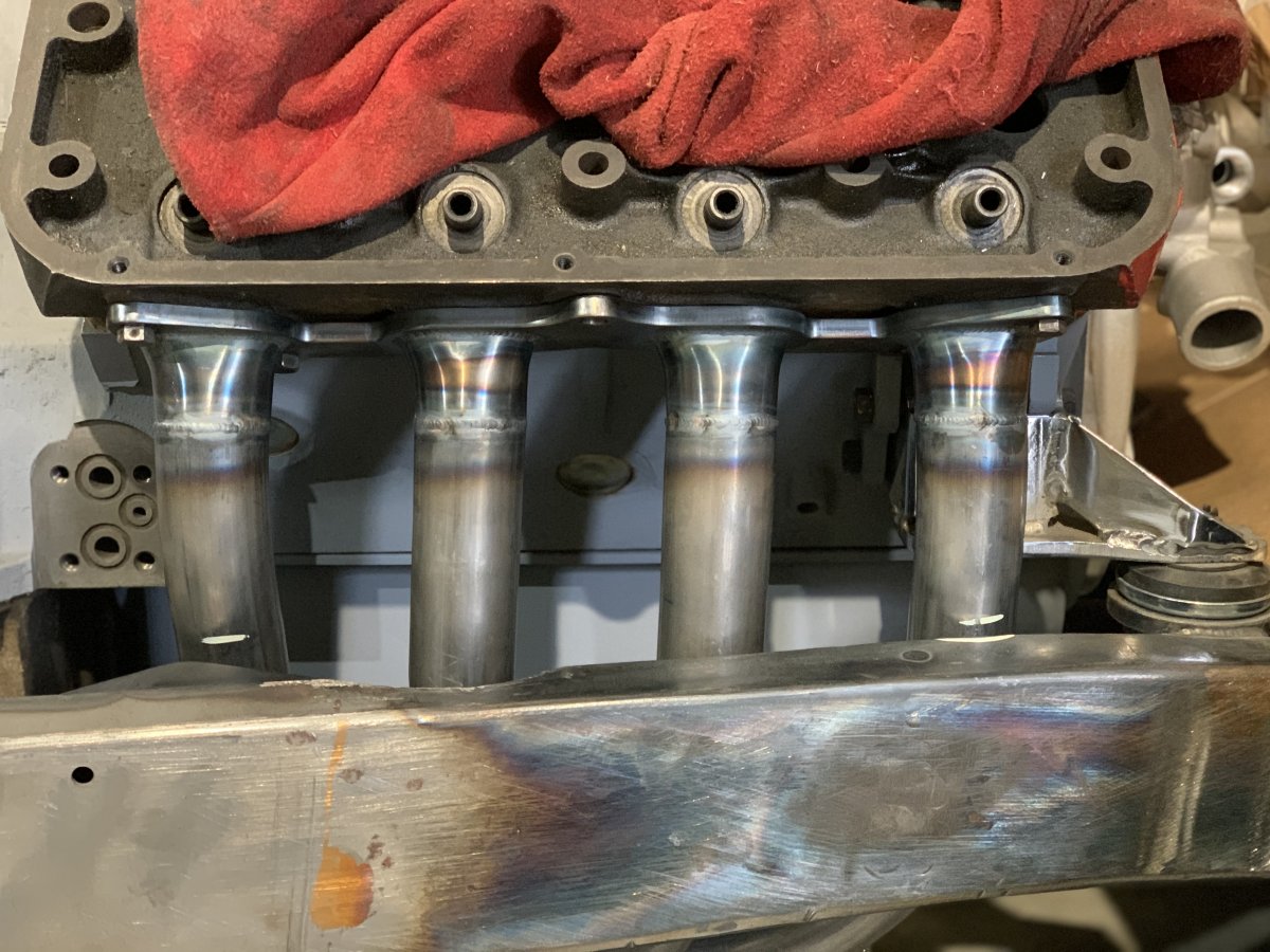

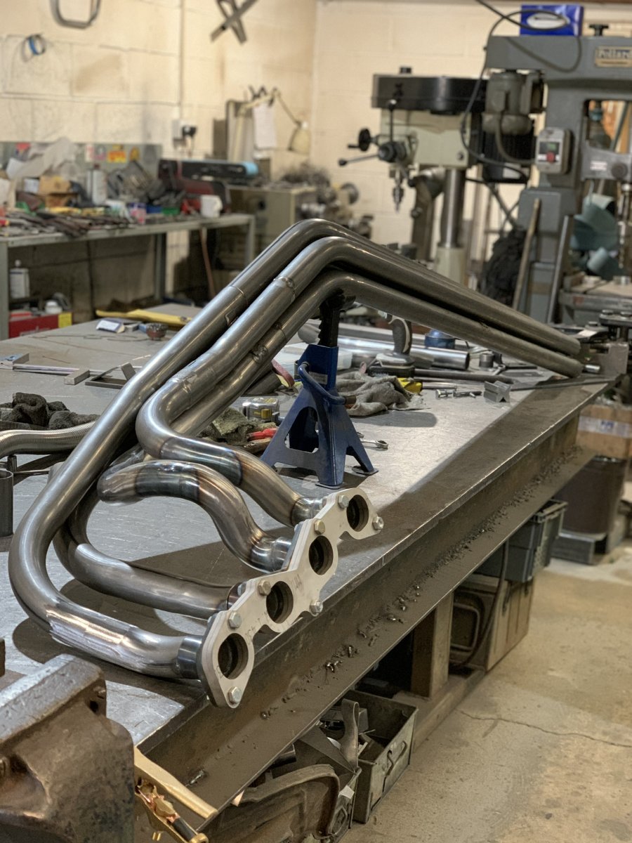

    While it was stood on its firewall I repaired the front lower wheel arch corners on both sides.

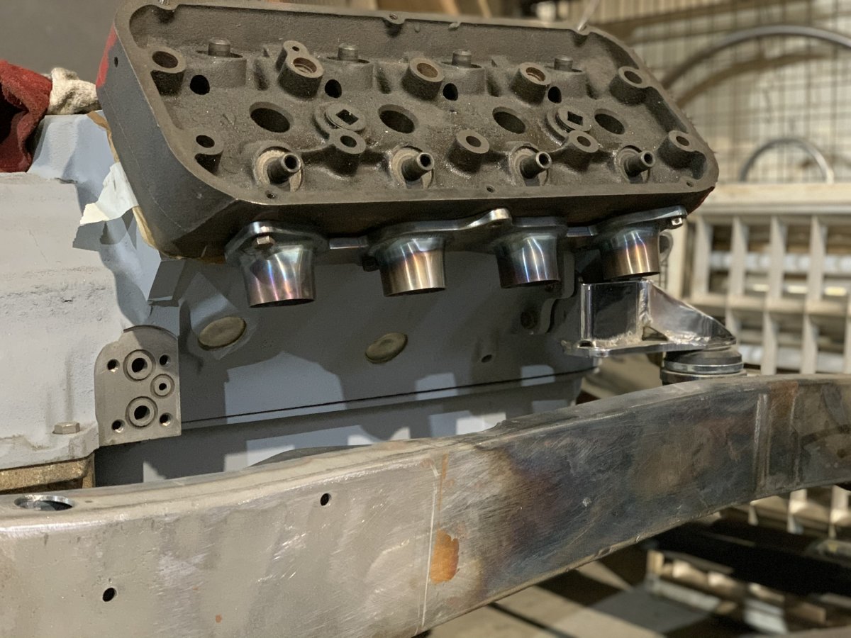

    I also started on the exhaust too. The heads that will be used are quite well ported so we used 2-1/4” pipes.
    8 into 8, exiting in front of the rear wheels. And because the body is heavily channeled, a d wanting to keep the pipes as high and tight to the ch***is it meant that I had to cut the body to let them through.
    The exhausts were a lot of work. My tube bender would crease the pipe, so each time I wanted to bend it it had to be filled with sand. For every bend!
    498C2F86-5C5D-436A-BEAE-69636AA8C52D.jpeg C4D98790-82DD-42DD-B6C8-183F2BF9884C.jpeg 5D18C11F-8E3C-4C2E-9E0B-C9679E754C28.jpeg 83B7D3A5-77F6-4473-A4DA-3A54704A28E5.jpeg 364B9B28-A62B-4CE0-B5FB-EAC210E980AC.jpeg CD93C1D9-F09C-4C9C-9B58-79C541BB9347.jpeg 3335BA7A-C948-4161-B80B-FA8BFB7F2207.jpeg 3A1D4615-468C-4B7D-8B5C-2B8CB8A3D04F.jpeg 273EF163-CCEC-4FFB-9D4C-B2FEB7CEBC8F.jpeg 0038C690-5BC8-4B3B-934A-4439C6F8AFCF.jpeg A5902AA8-F447-46D7-A312-7F932AF50D3D.jpeg 86943C35-15C6-45EB-AF16-BC23F09818F3.jpeg B8B0CADB-3633-41F8-B937-5C8D6ADB550F.jpeg 2F1CE771-FDC6-431B-A4D7-ED35223F5846.jpeg 2BB4B74A-26BF-46F0-86CC-3770FDD64E69.jpeg

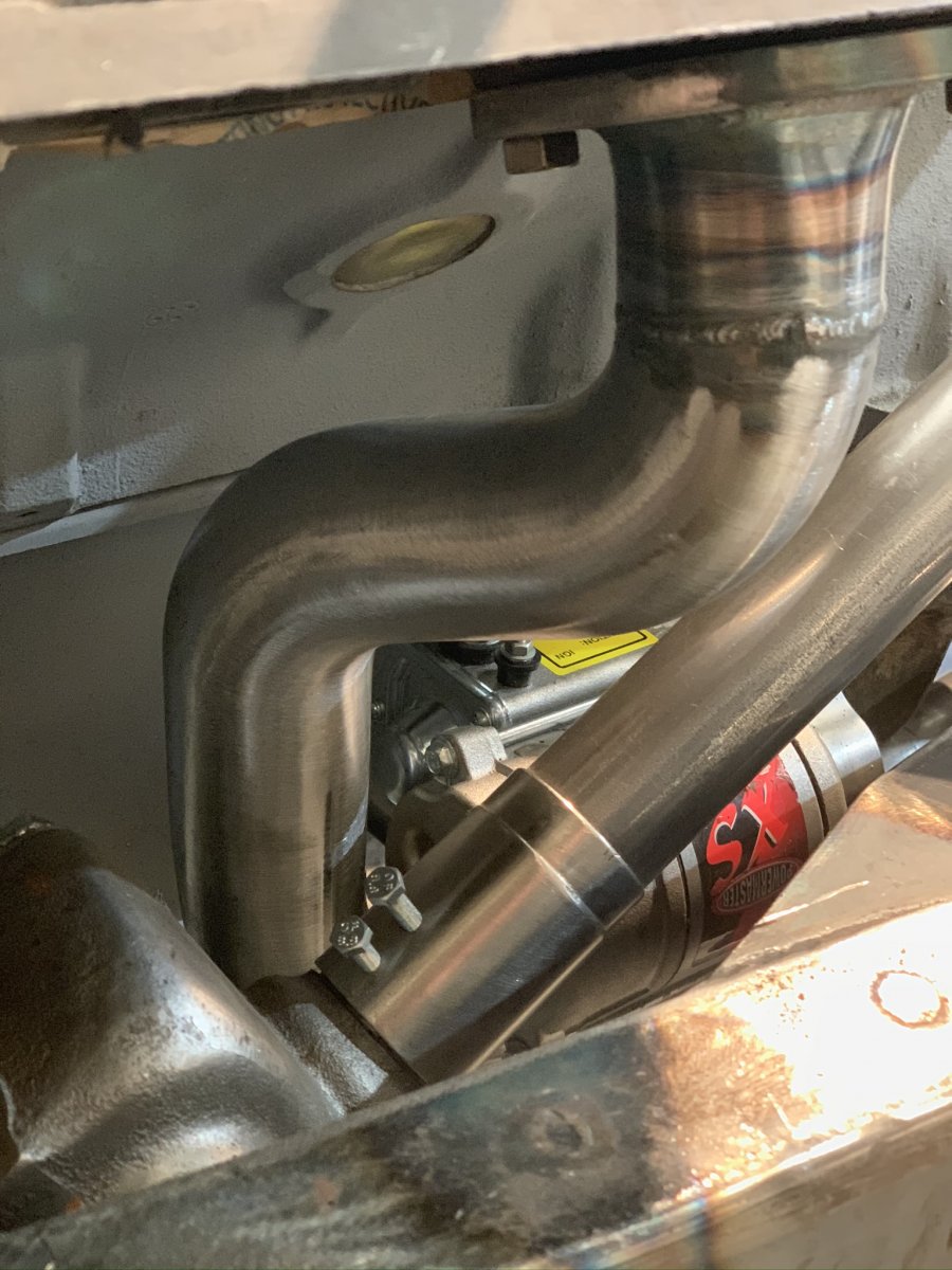

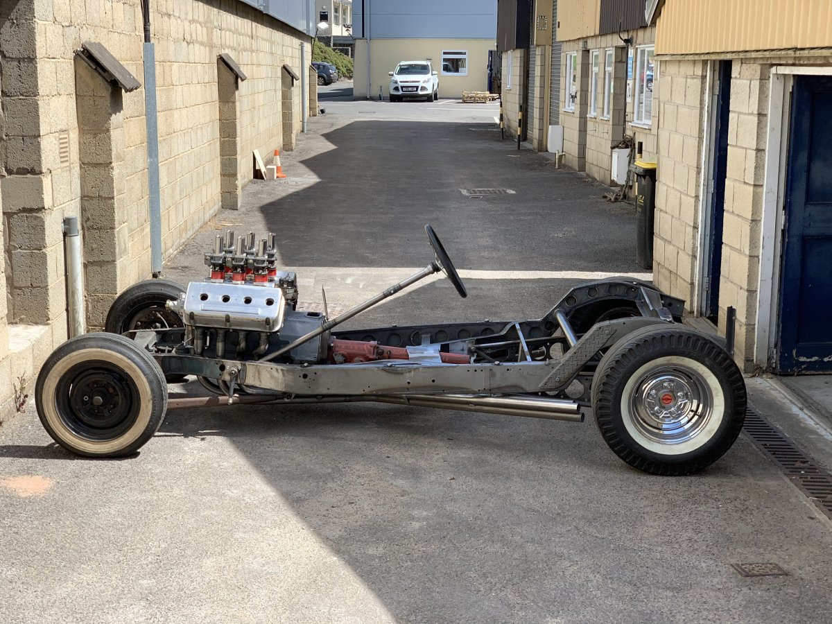

    Exhaust fitted, wheel it outside to check it all in the daylight
    793D9FE2-2429-46D2-BDDA-A3BAB3B96A81.jpeg 3536AC6D-E919-446B-9538-56B328BF1460.jpeg FD6E4425-DBBD-4161-87F4-2C1CF46181E1.jpeg 822A3FD8-26CD-4177-BD34-5131D05D626F.jpeg
    You can see underneath how the 8 pipes run nicely each side.

    Happy with the ch***is we gathered some people and fitted the body back on. Not quite for the last time, but pretty close.
    Wheeled it outside to my favourite bit of backdrop wall to take photos and get the chance to really look at the ca4 fron a distance to check the stance.
    I think we got it right.
