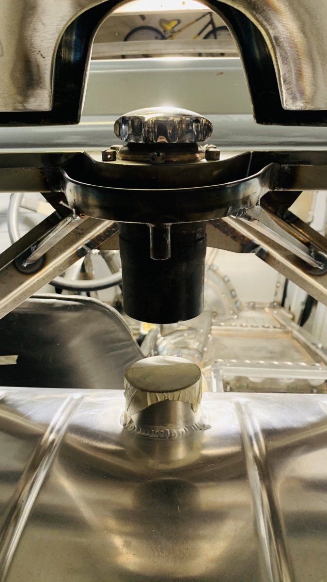

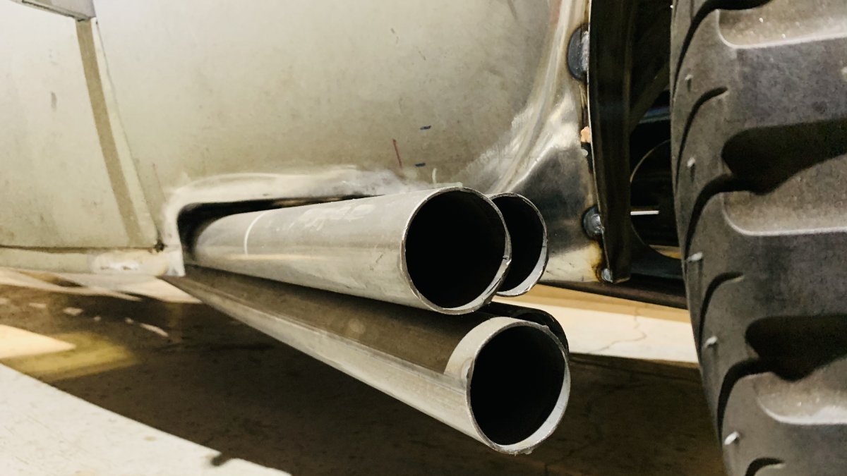

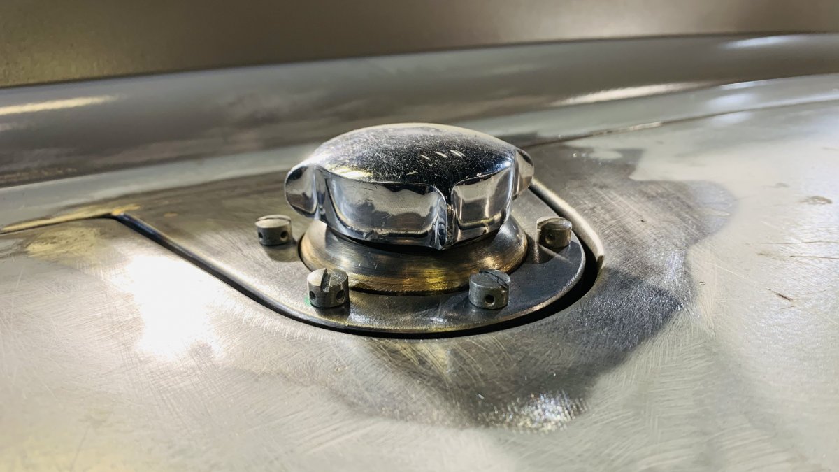

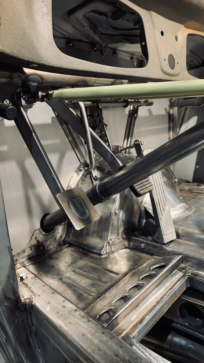

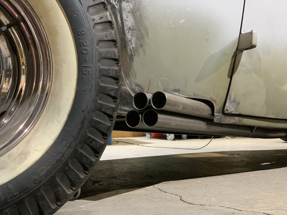

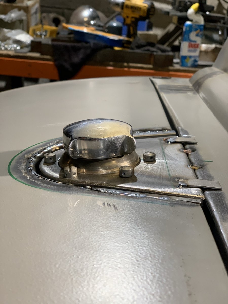

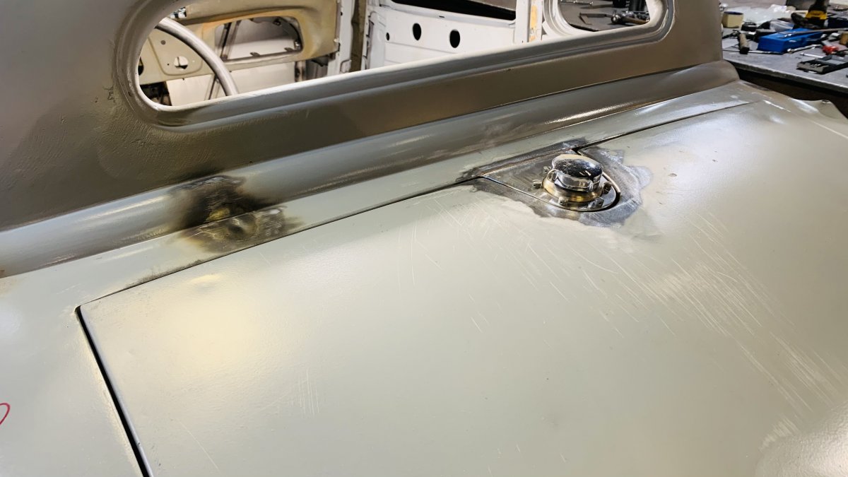

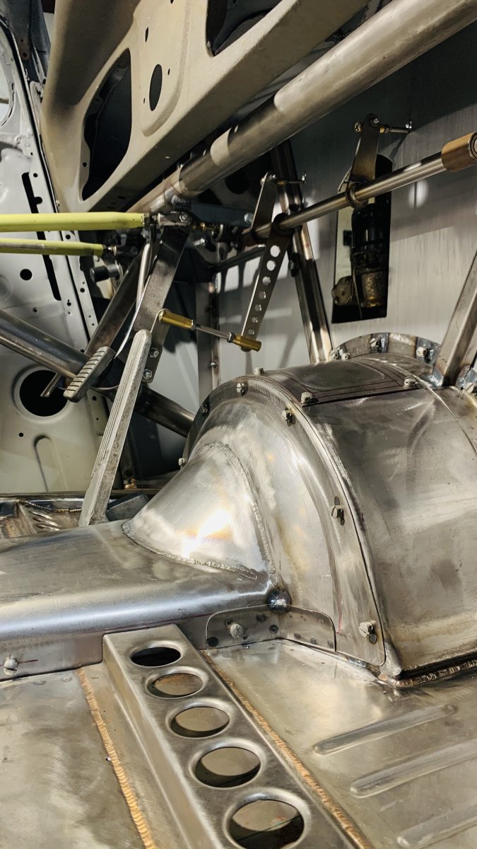

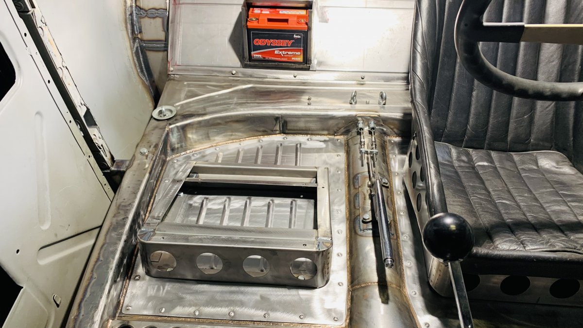

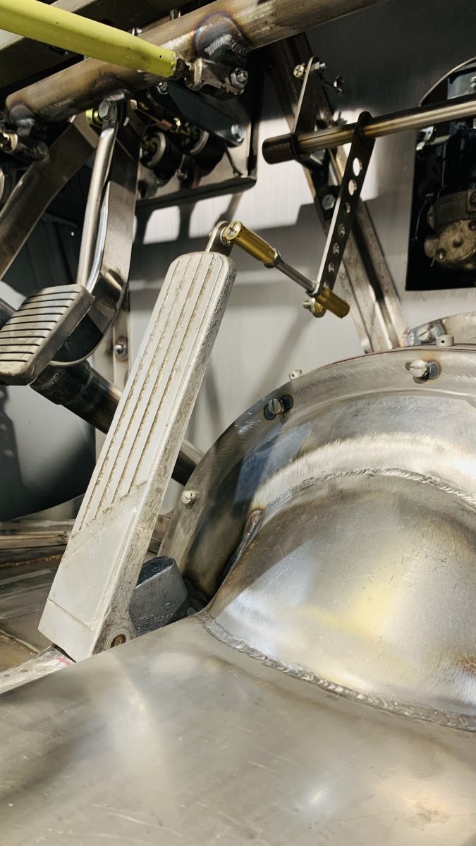

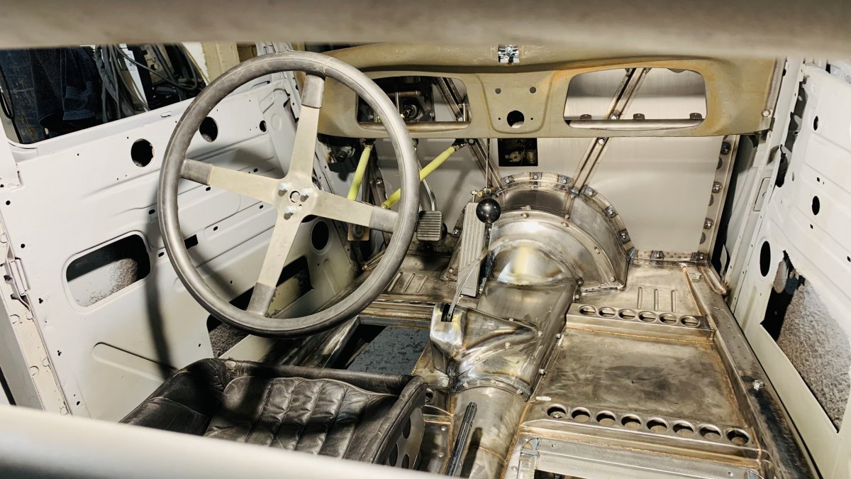

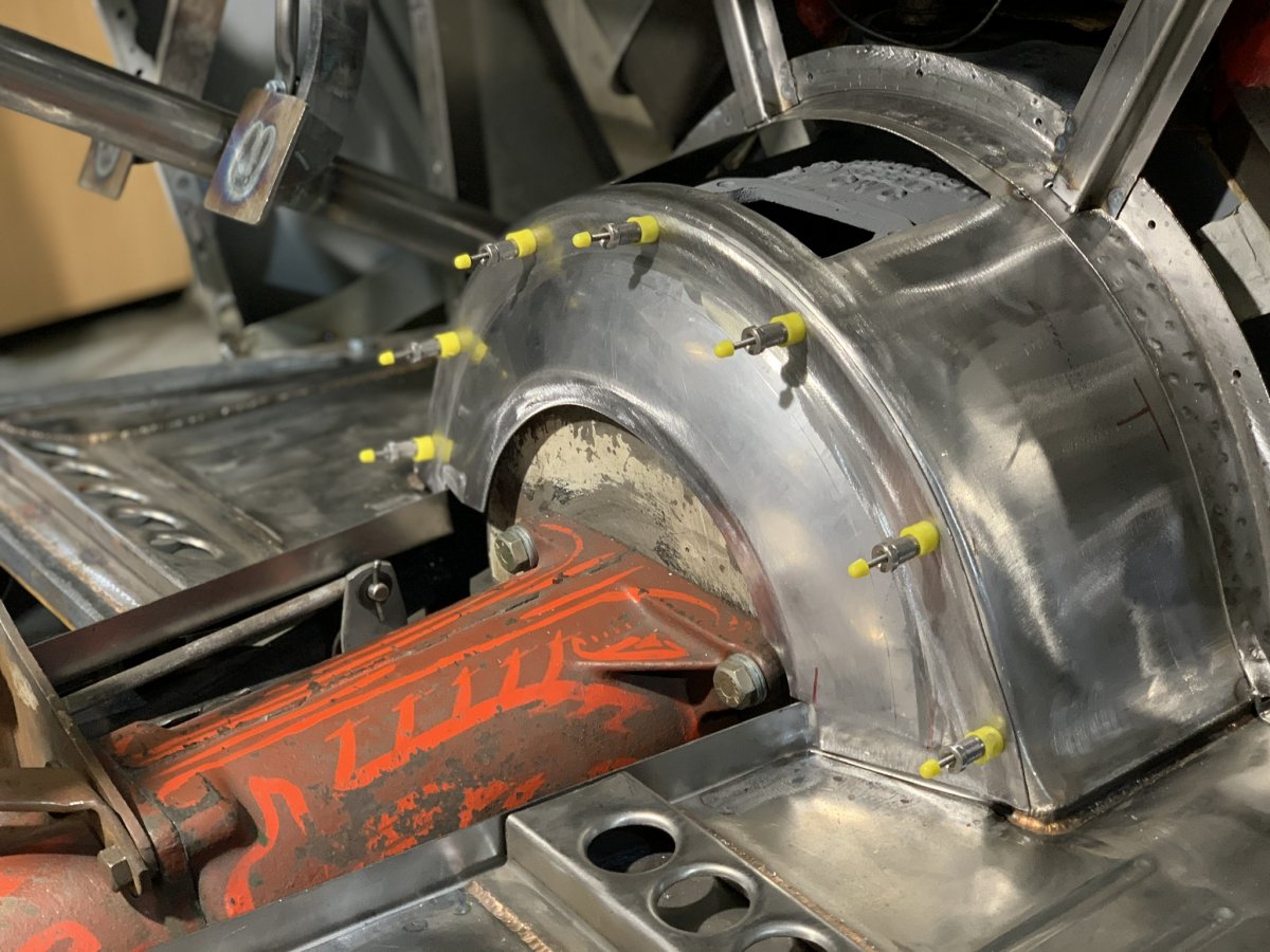

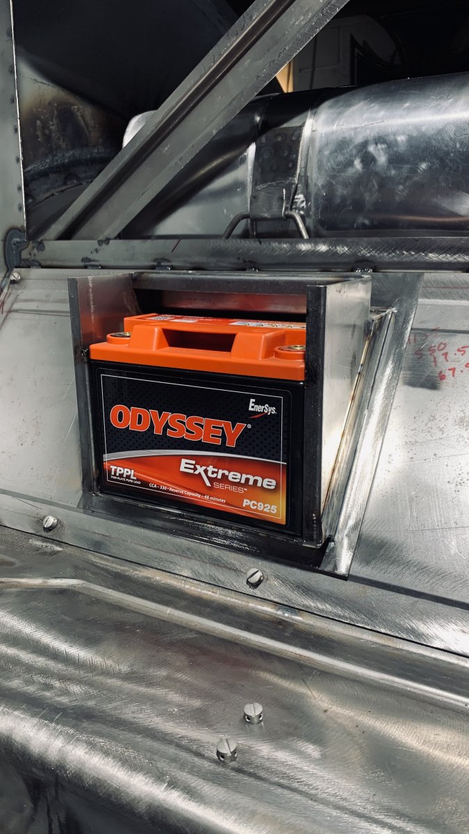

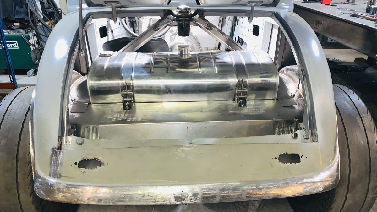

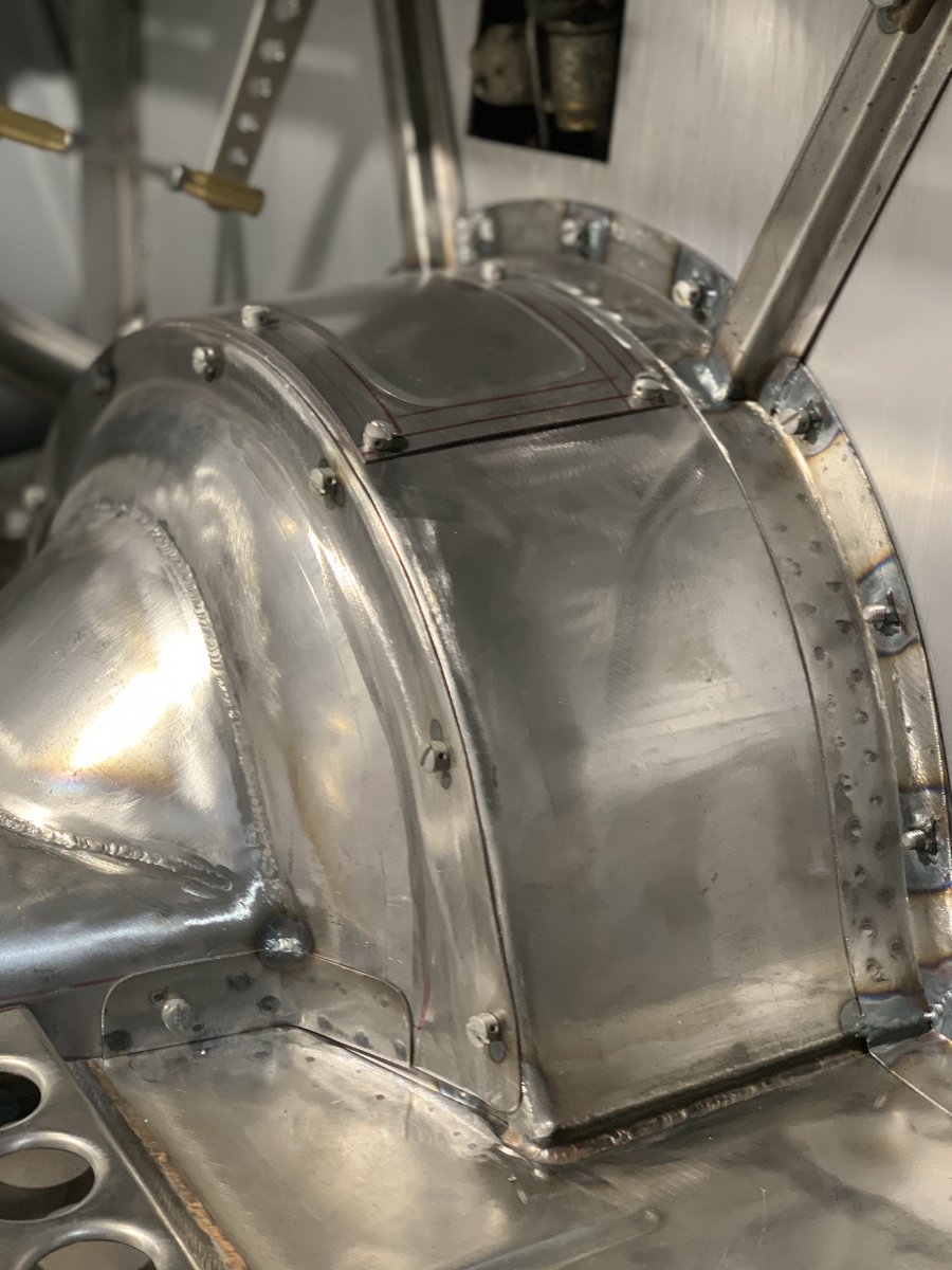

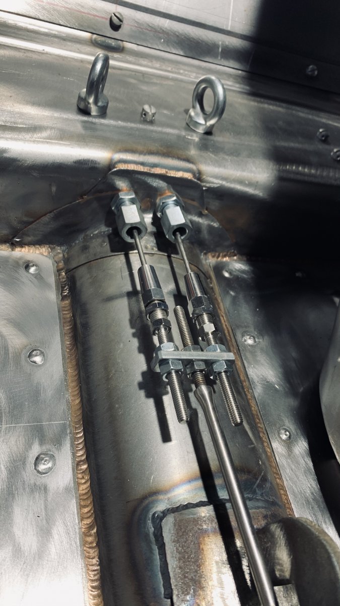

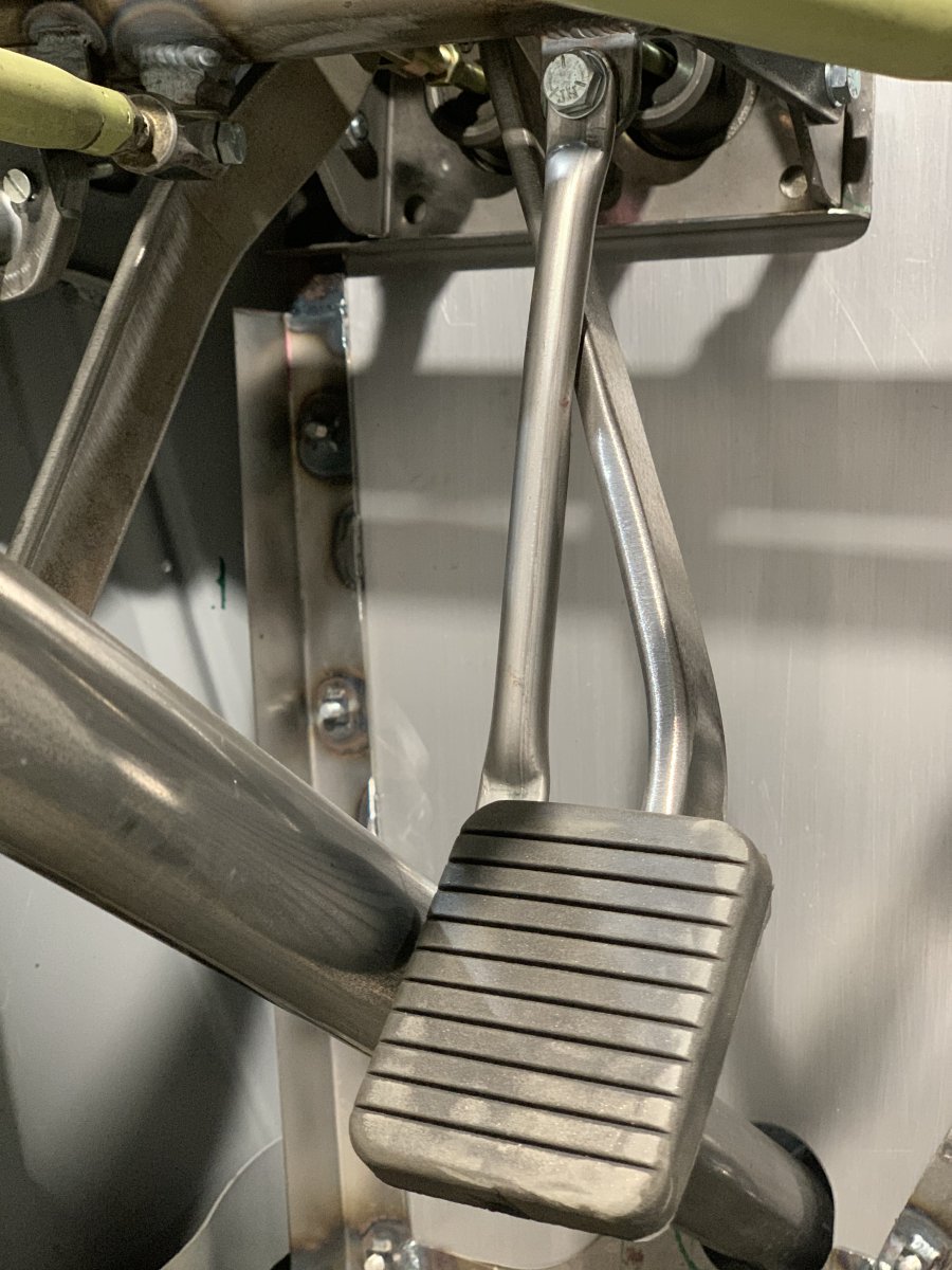

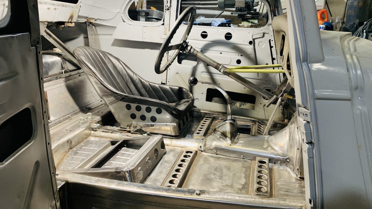

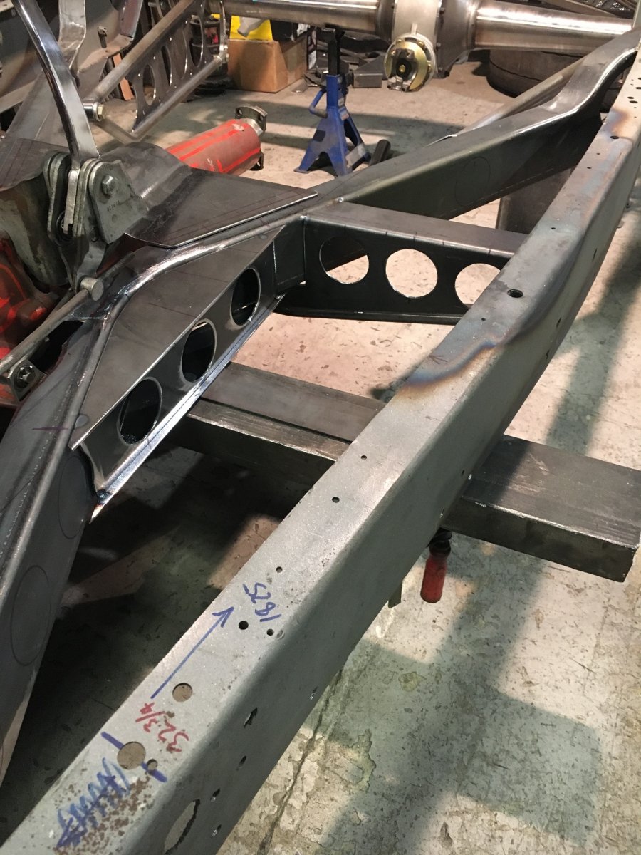

    With the body back and the under fully welded, with captive nuts welded on where needed I could carry on and finish up the floors.

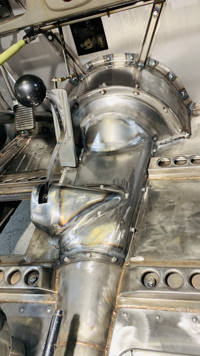

    the trans tunnel needed to be tight to the bell housing and tunnel to give as much room as possible for feet.
    548A0C93-2F2E-4289-97D8-A469F6BD7ACE.jpeg D01C4C4A-469B-4EFB-94D0-6EEC7FB28EF6.jpeg

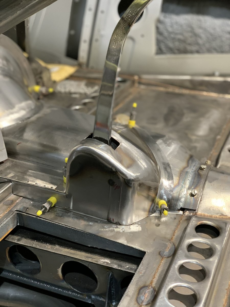

    hurst shifter
    Cutouts for the exhausts.

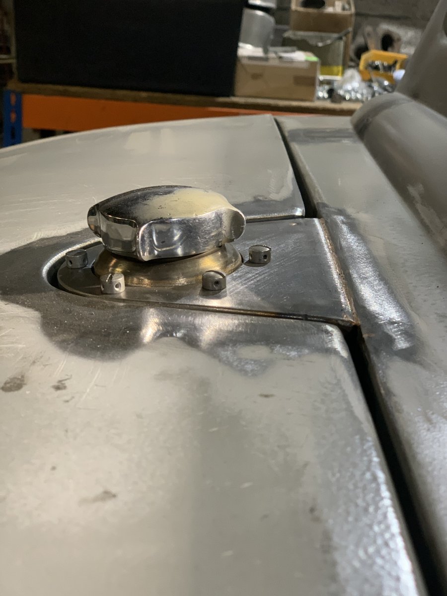

    Fuel tank filler.
    DD0B3B43-823B-4D5F-95EF-937680DCA996.jpeg 04761847-0F6D-41D8-8BE0-B2678C1DD2C9.jpeg

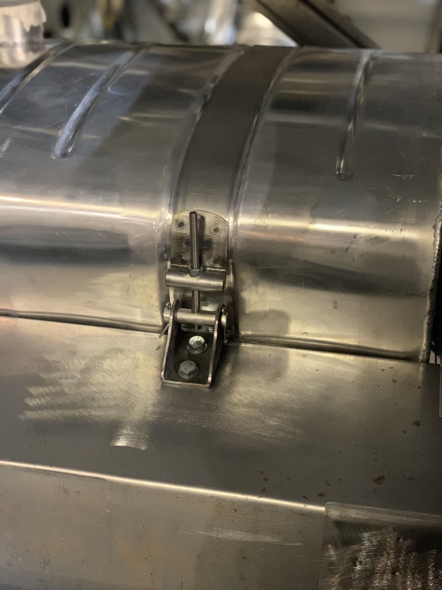

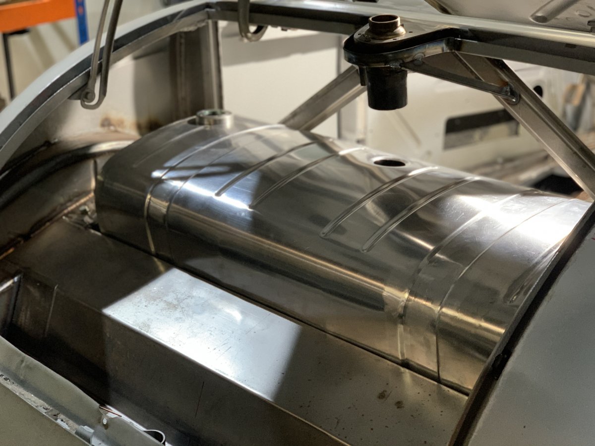

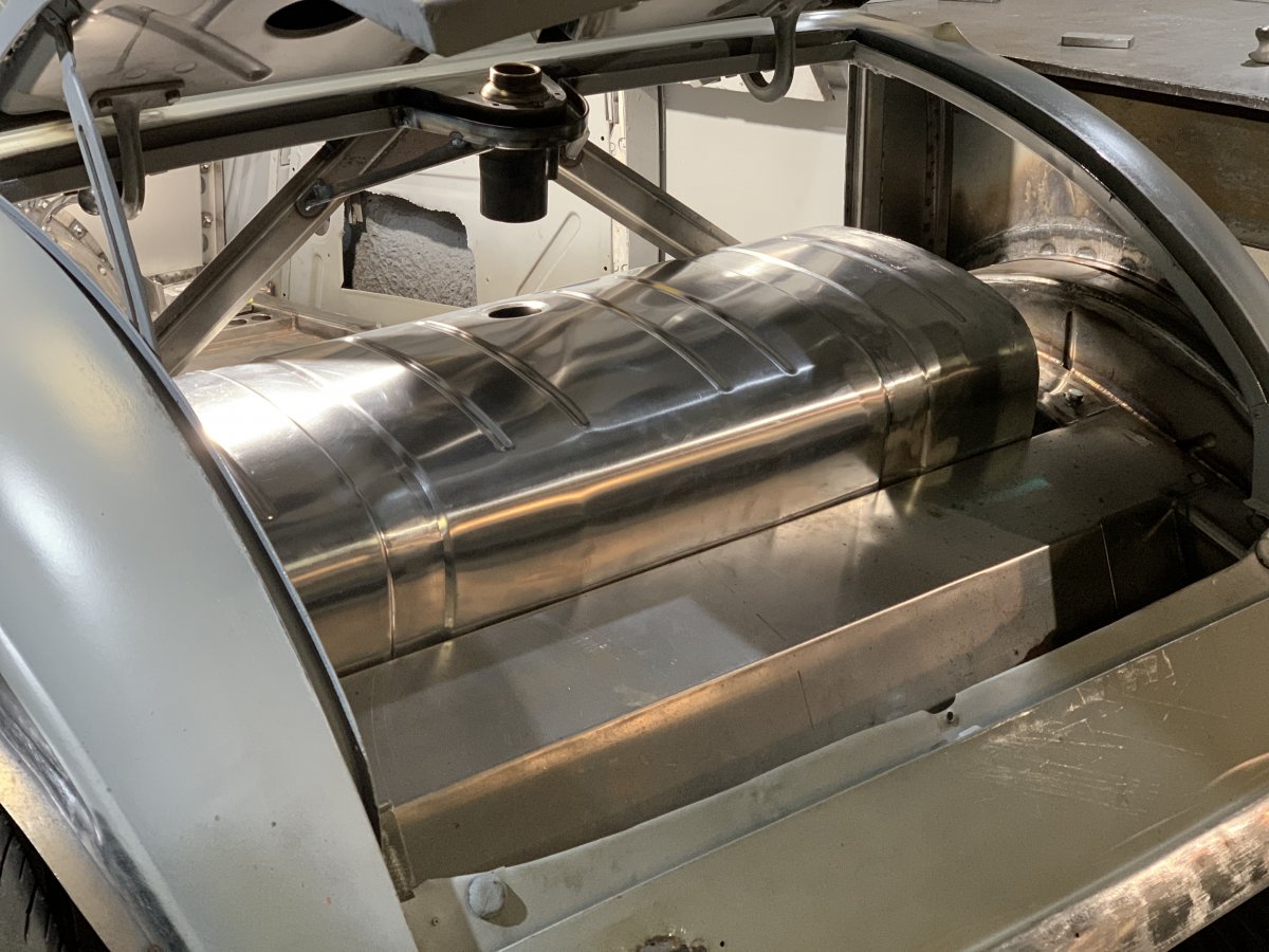

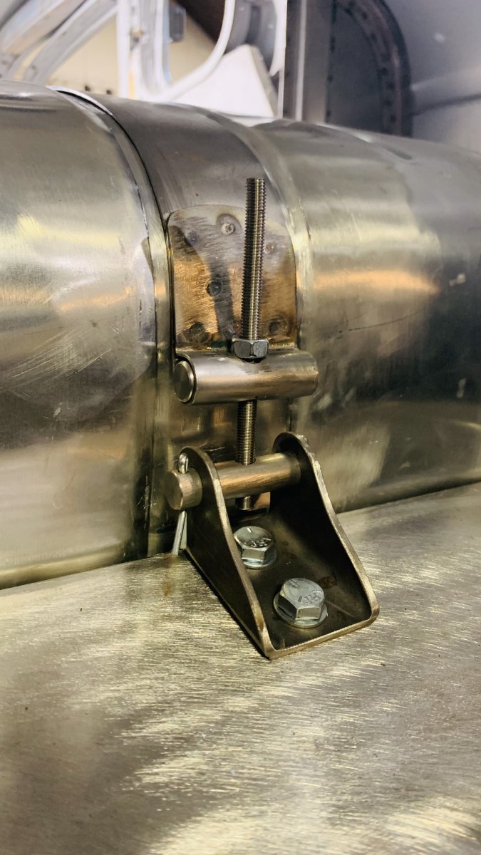

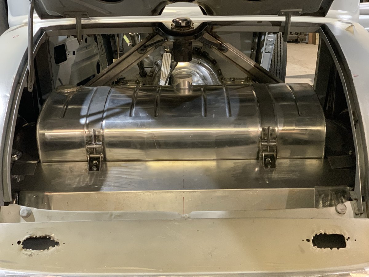

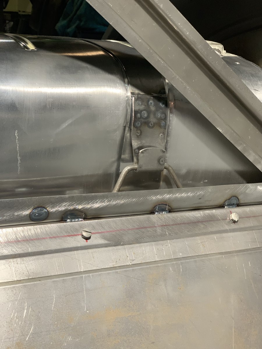

    And very large ally fuel tank.
    69F1EF36-2439-4BE1-B346-317D799B848F.jpeg 91B55C73-DC87-462A-B2CF-4A4FF5C7782A.jpeg DC2DE5C8-8CE8-4AF8-AA06-ACF06D643B4C.jpeg 3E88F566-5554-41B6-96F7-E021ADB884EC.jpeg 11AA669D-F01E-4D40-88B1-A5A375B04B3F.jpeg

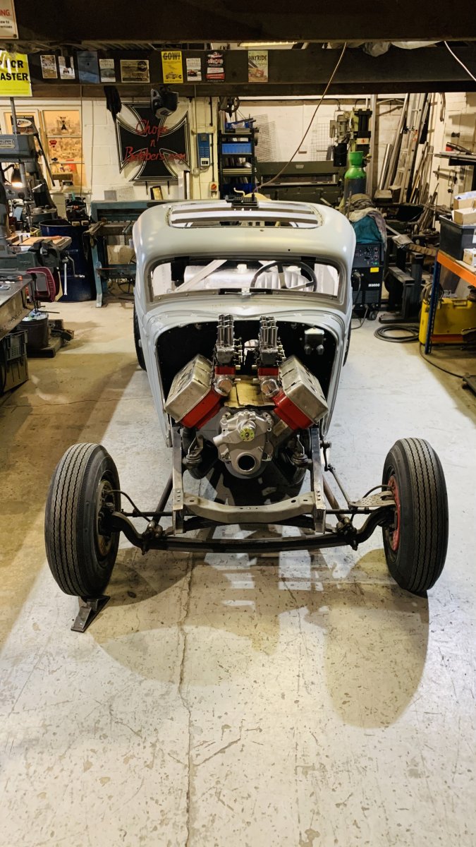

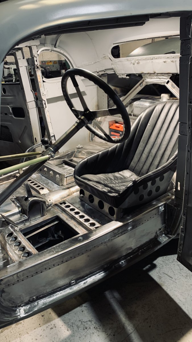

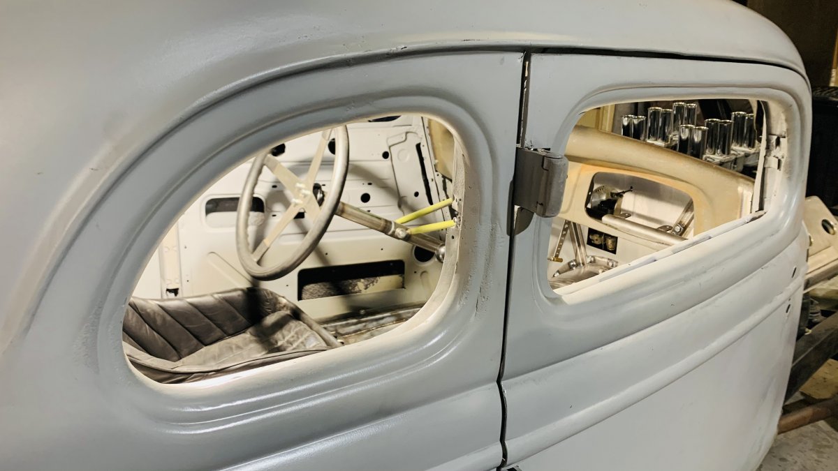

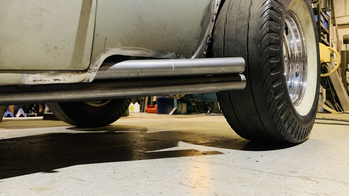

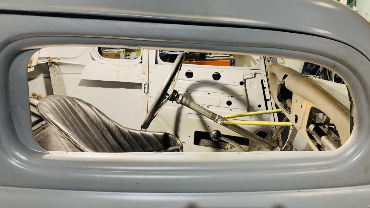

    We’re now up to date. There’s still a bit to do over the next few weeks before it goes back to its owner to have the motor built and finish the car. Rik will do most of it himself, he’s a capable car guy and will finish it properly.
    I’ll leave you with a bunch of random photos for now and I’ll update as progress is made.
    Thanks for looking. Pete.

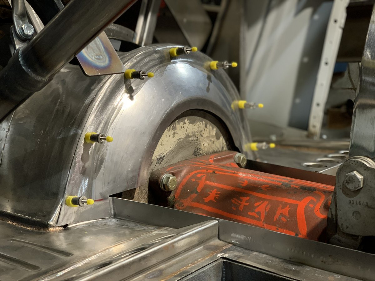

    Dayuum...What a lucky Hotrod...;)
    @nutrocker what's the story on the brushed lettering on the ******? Asian American Heritage? Just curious...

    Wouldn't that be something if it had a connection to Larry Shinoda back in the day...
    @KFC these are the details and soul that makes the story and journey that much more interesting and restoration a balancing act...so awesome you chose to leave something that could easily have been s****ed off...
    The tailight holes are another bit of that soul...48 Chev perhaps?...
    You certainly have a builder extraordinaire performing the magic...
    You must be pretty excited and I'm sure you are helping Nut with the vision moving forward...;)
    Perhaps one of our Japanese Hambers can chime in with a translation...that is if it is in fact of that language...

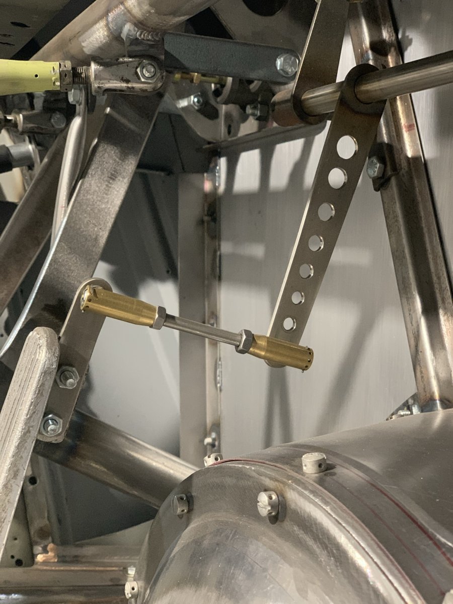

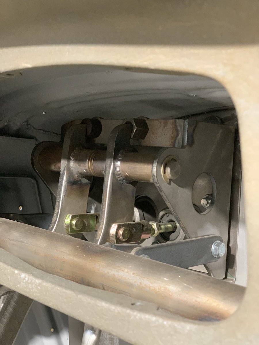

    Man I’m loving all those under the dash detail shots!
    few questions.
    I’m curious if you plan To make a bead or anything around the exhaust cut outs in the rockers?
    How do you get the drivers side header on and off? The bends around the steering are fantastic but it’s got to be a tight fit dropping them down and it doesn’t seem like there’s space to remove the steering box to make room to wiggle them out.
    do you just fish the long end down and threw?
    Really curious how you thread the needle on that install!
    And my last thought, the vertical face of the trans cover in the front. It’s got that fantastic dish shape after the flange. How did you form it? I’ve gone back and looked at it half a dozen times. Just something about it. Really dig that shape.
