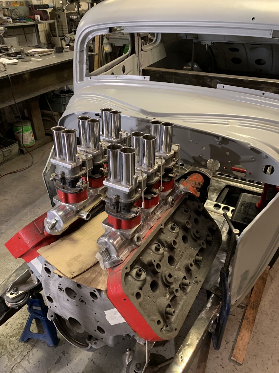

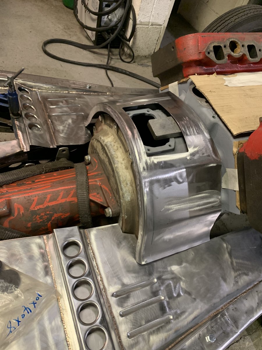

    to answer your questions,

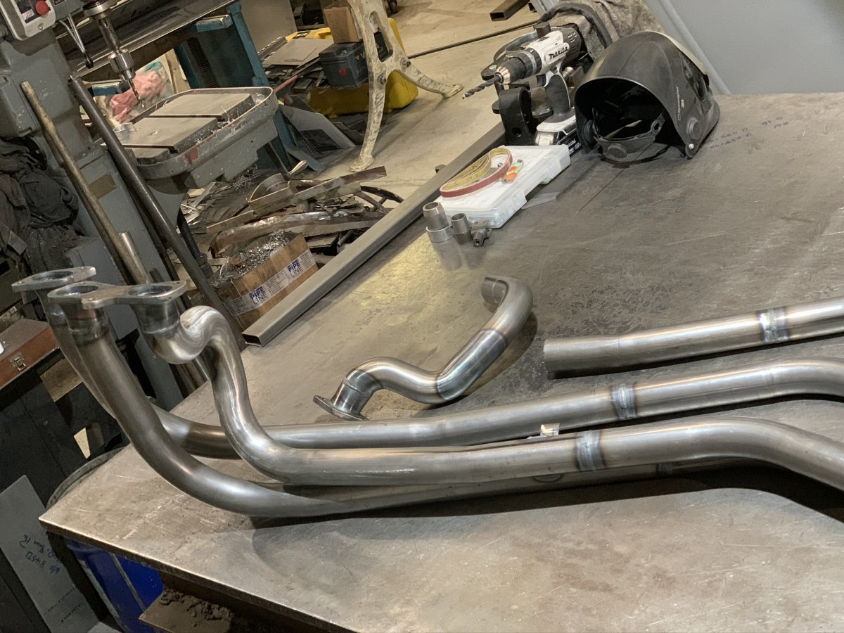

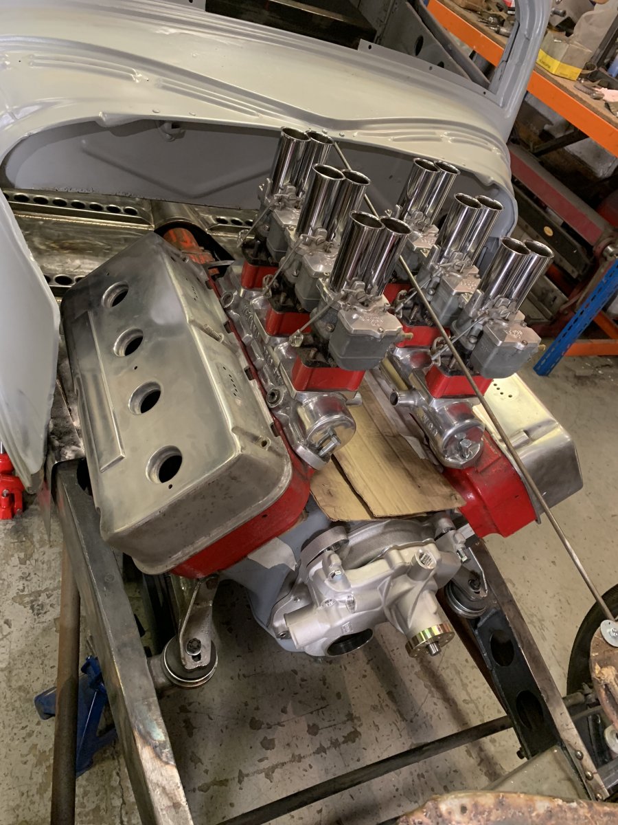

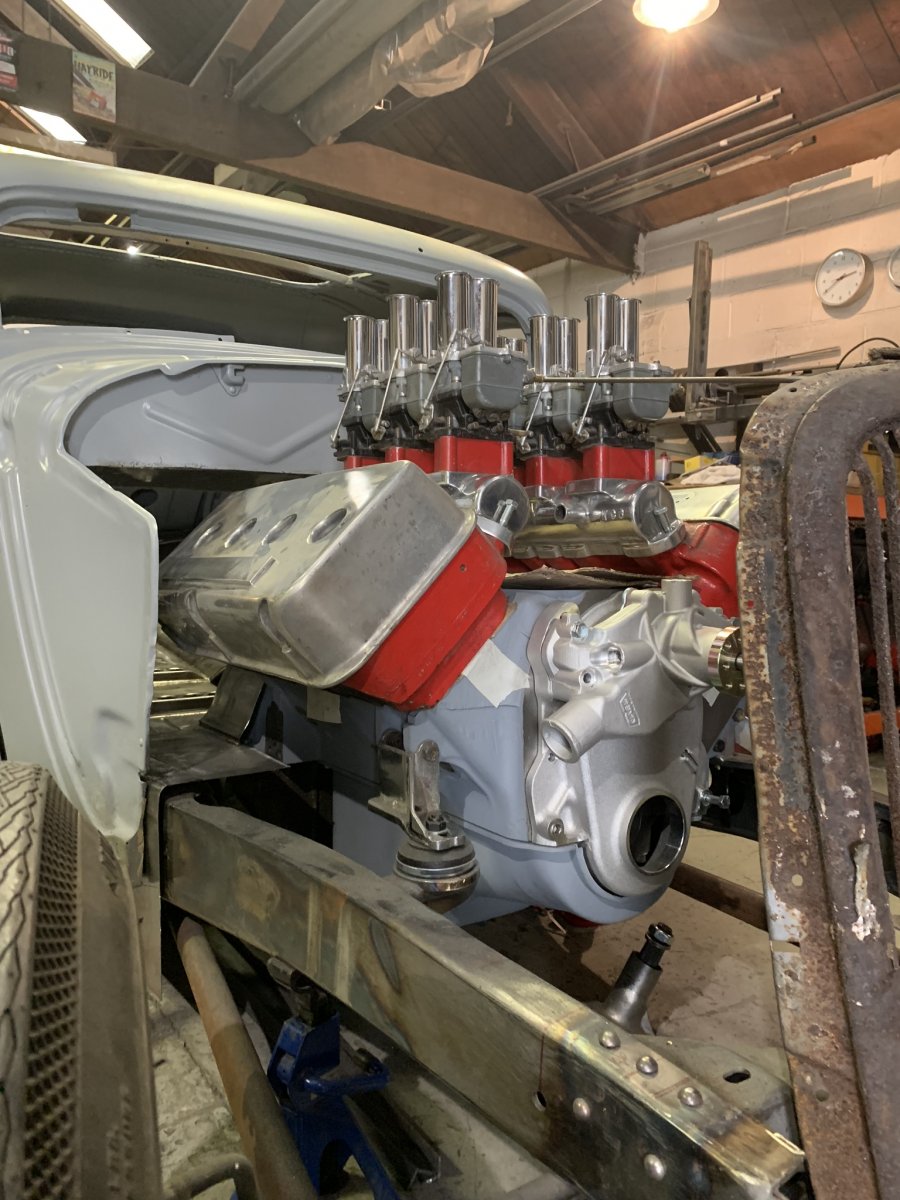

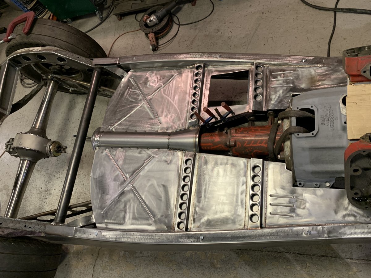

    the cutout in the body for the exhausts has been plated to join it to the inner panel, but that’s it. It was discussed whether to put a bead around it but decided that with the way the car was built it wouldn’t have been done, so it was left as is.
    The driver side header has a small section on the last pipe that is removable. This allows the starter to be removed without taking the whole system off. The rest of the pipes can then be pulled back a bit and drop straight down.

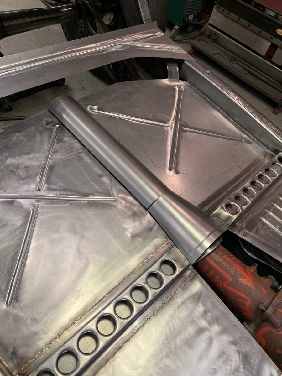

    The dish piece you mention was formed on a wheeling machine (English wheel) from a half round. Once I had the right shape I then flattened the outer and inner flanges.
    Pete.

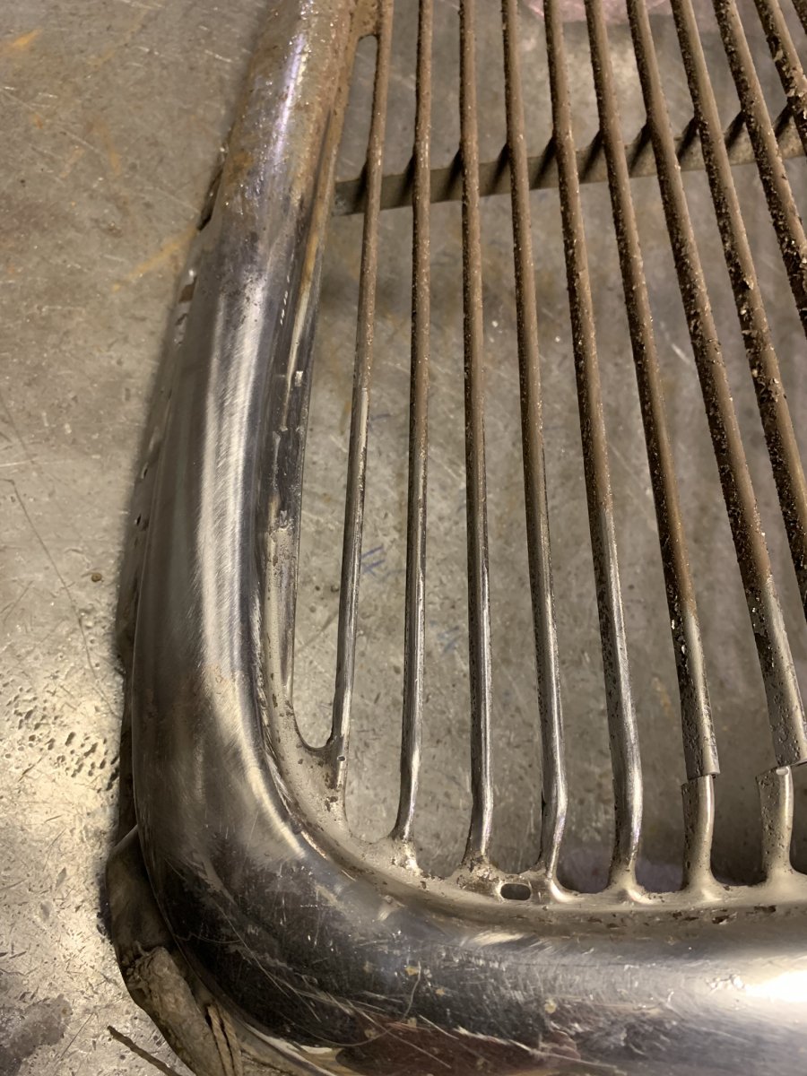

    Wow, what nice work. Thanks for do***enting the original work and keeping the skid plate. Can't imagine how on earth you welded and ground those grille bars back together.

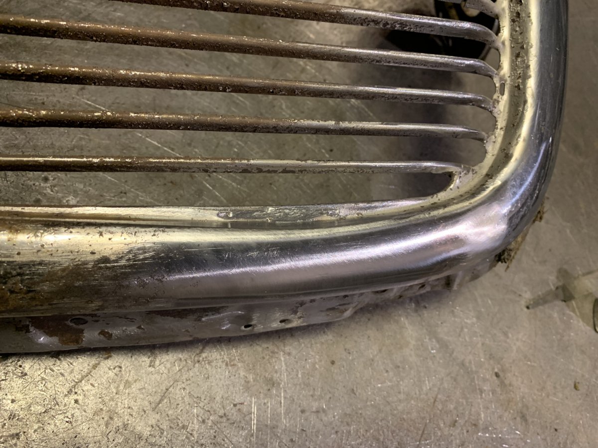

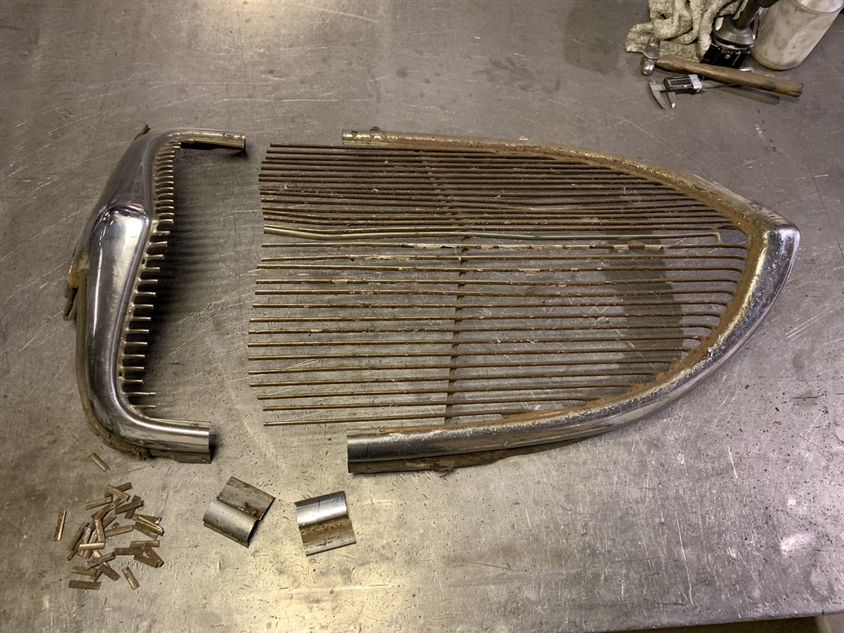

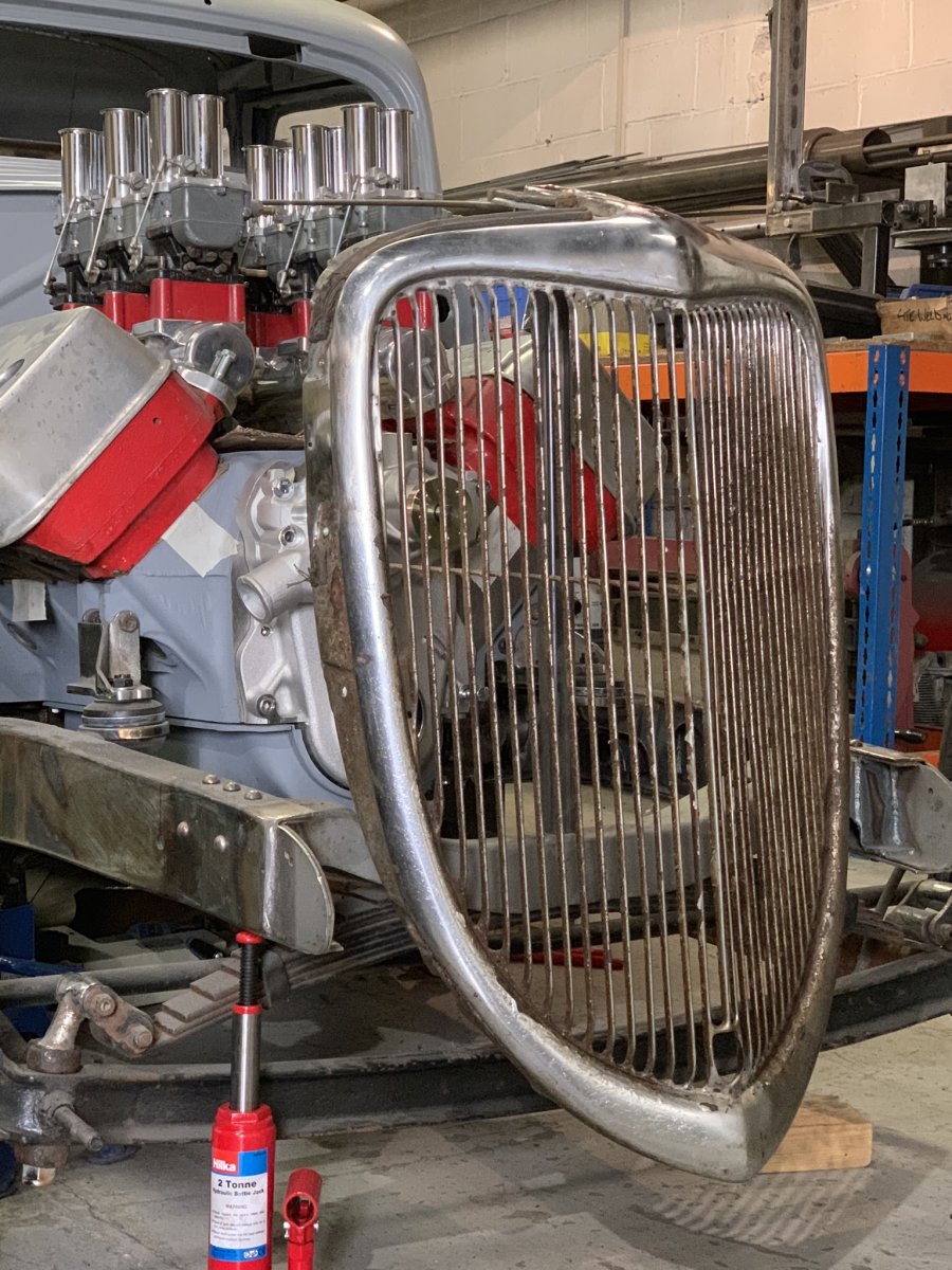

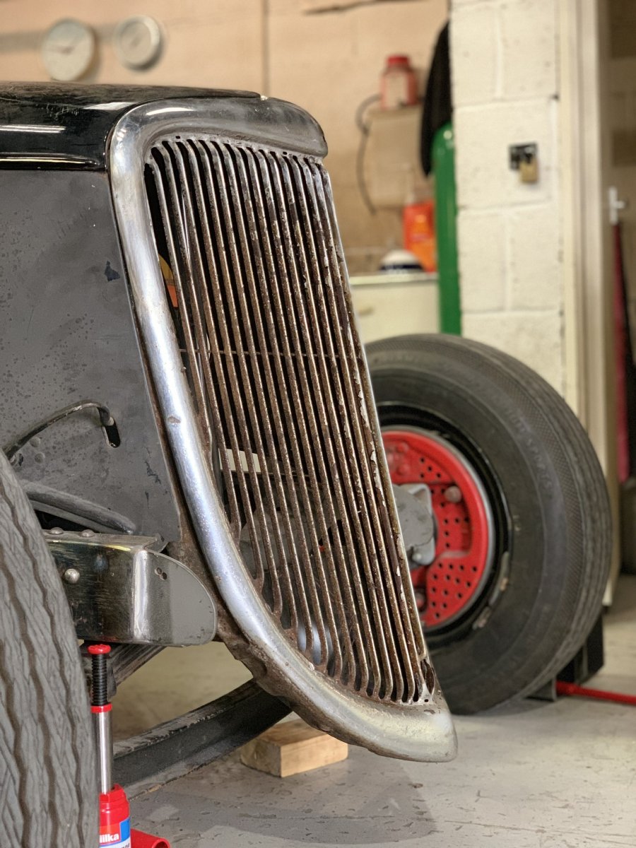

    When you sectioned the grille, how did you go about it without warping the bars. They are so flimsy just looking at them, they almost want to start moving.
