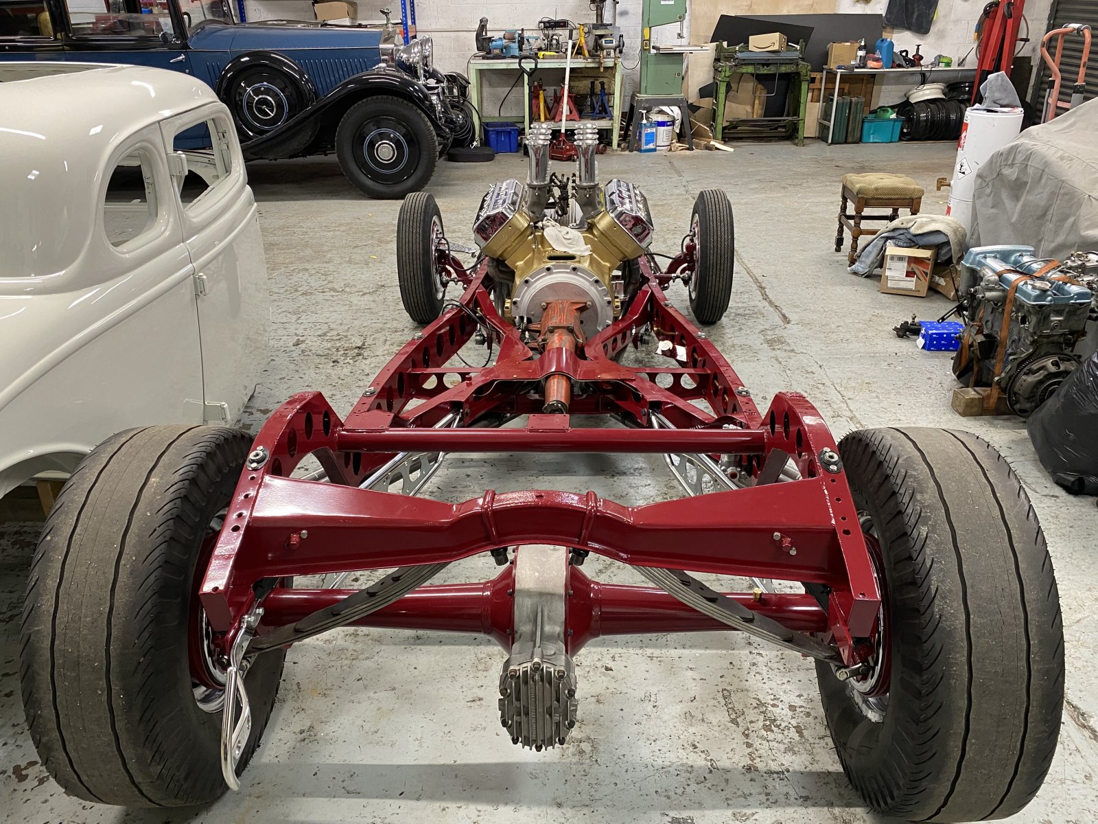

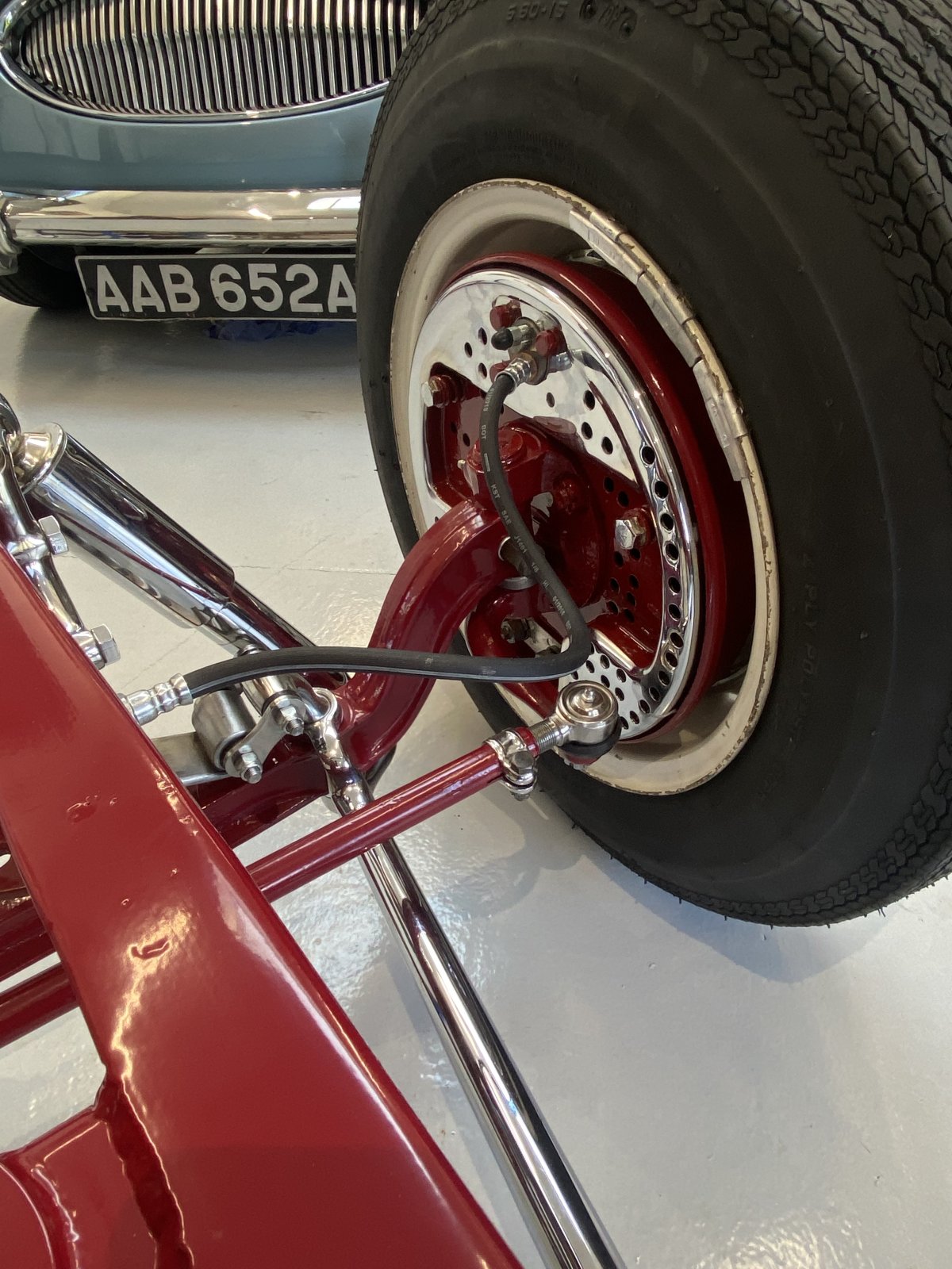

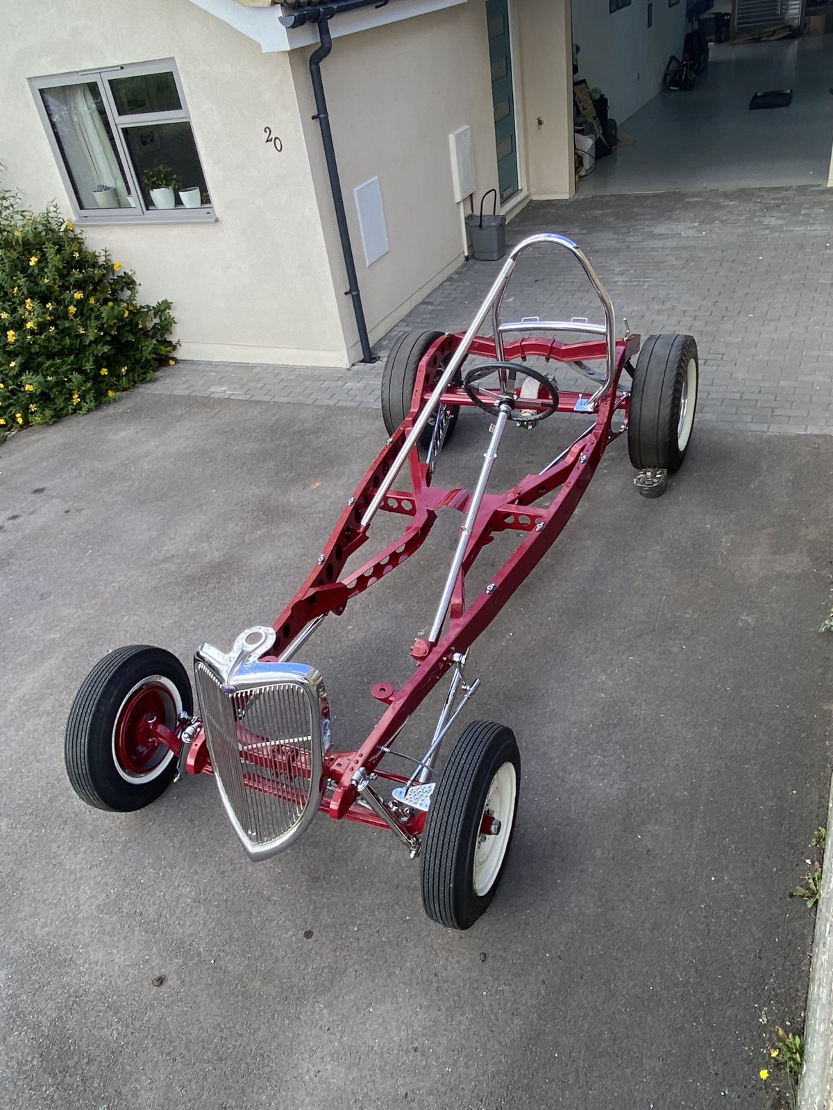

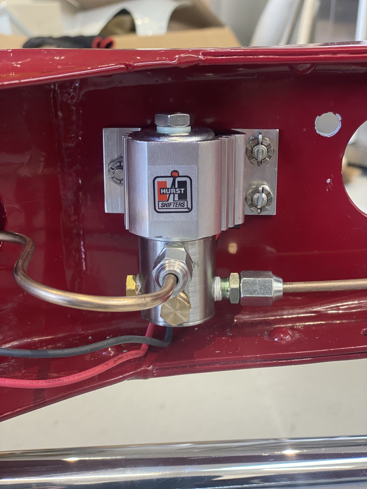

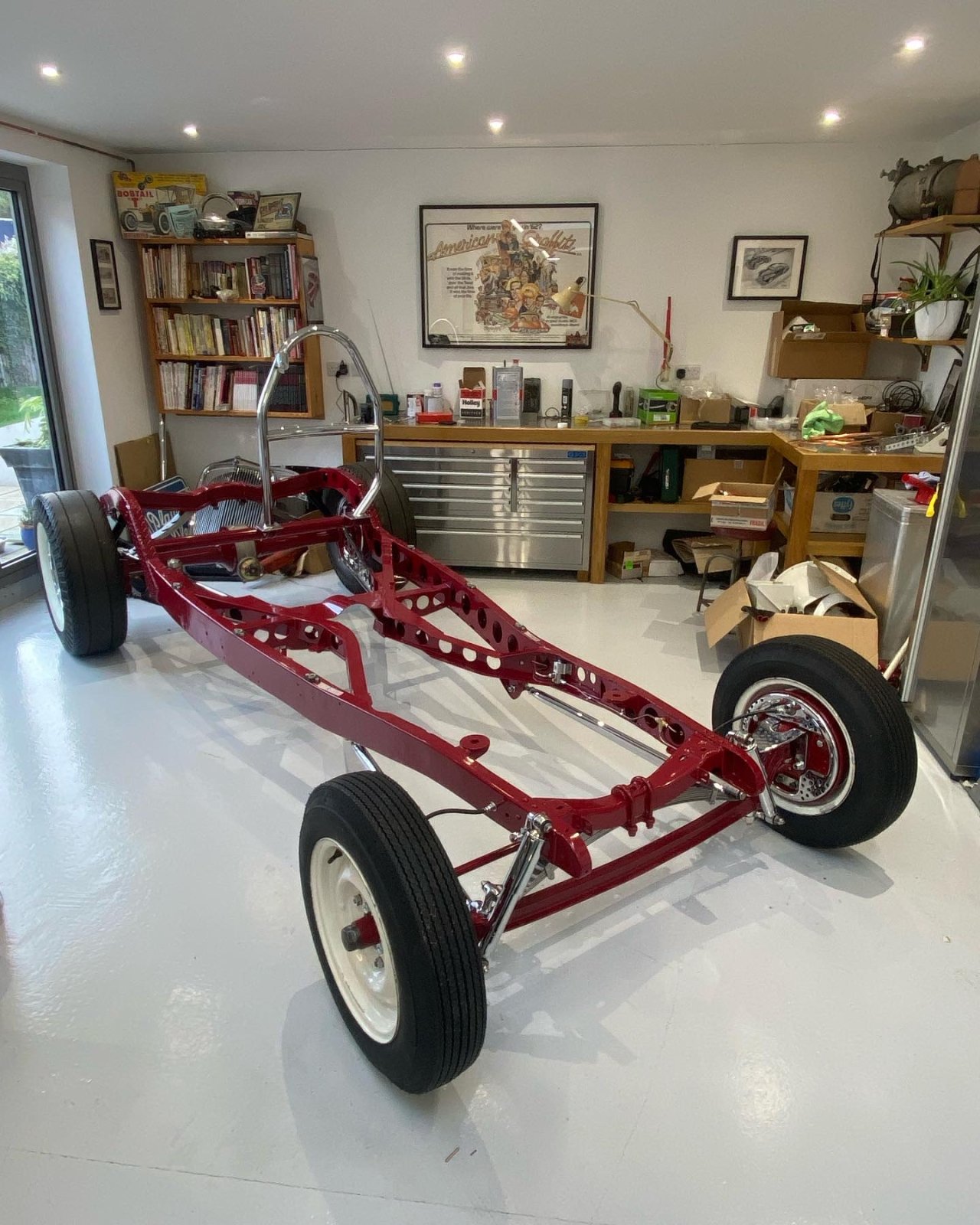

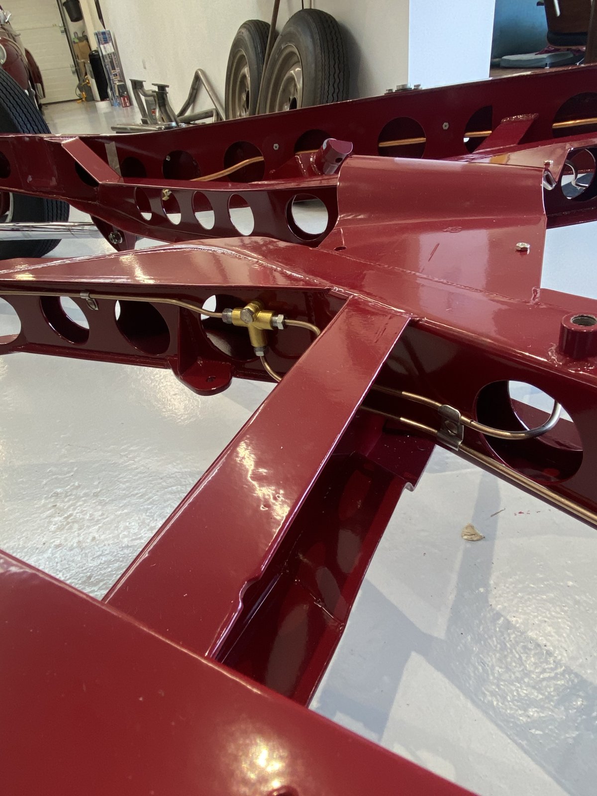

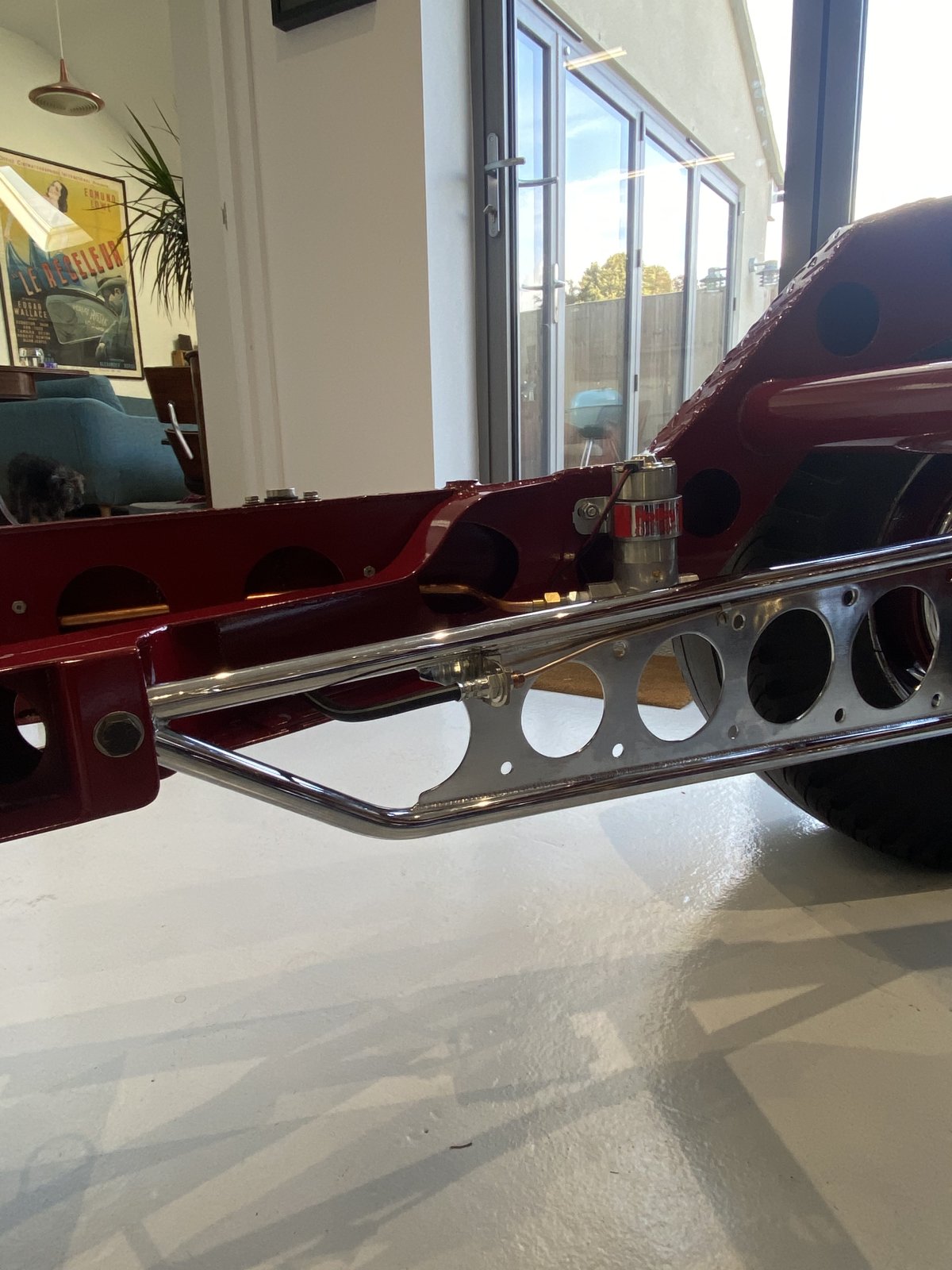

    been a while since the last update..
    Got the chassis plumbed, the front brakes back from chrome and built up. Various chassis details buttoned up.
    7C6E2D61-1437-43C7-B52A-5E5DDF064A43.jpeg BA88519B-FA8E-4A86-8D3A-B7DA5549FB25.jpeg 581FDE03-B4FF-49A1-B399-56AC5BA07E51.jpeg 4D2E2524-AC49-480B-9717-CE7DF334031E.jpeg 98BF810C-7975-43C1-9EF9-85C9476F476C.jpeg B2520CCB-2FDF-4BA4-B98C-3B6EDCFE33A3.jpeg

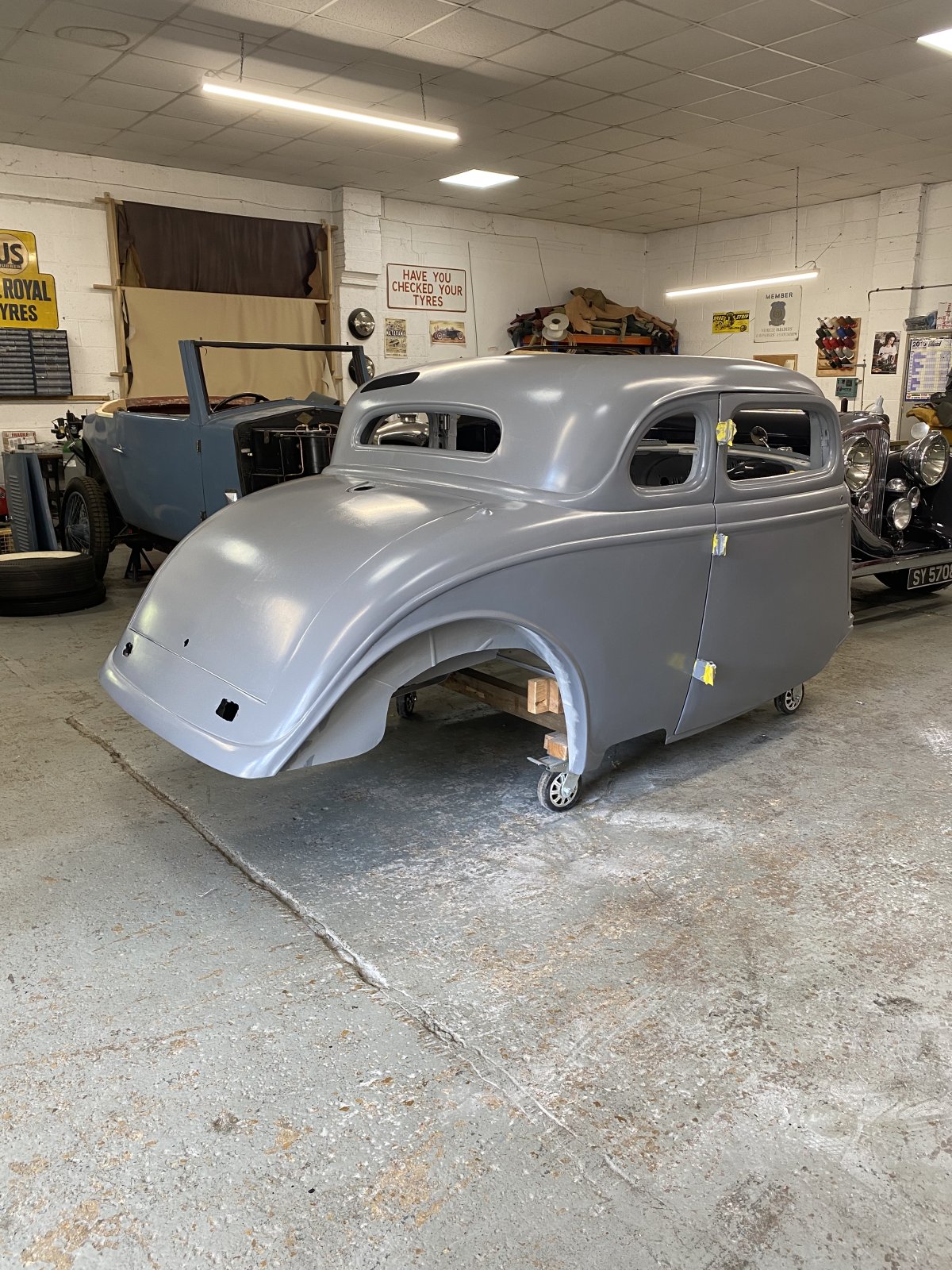

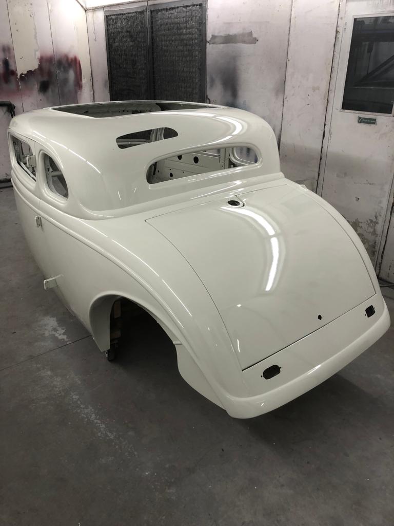

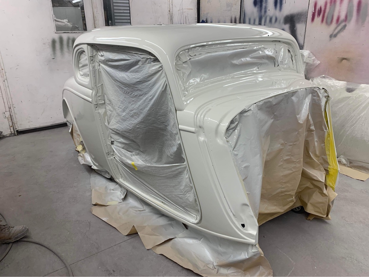

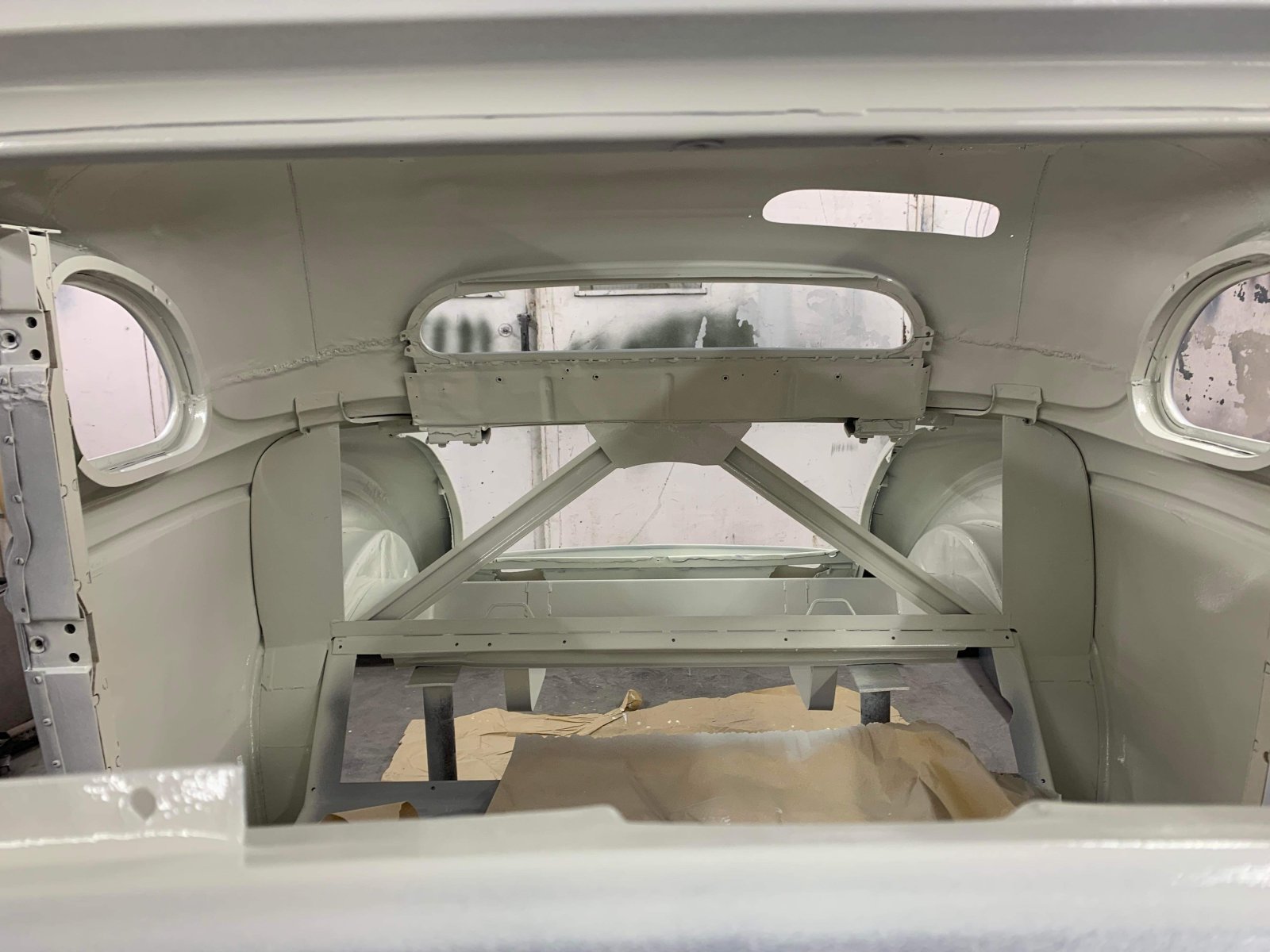

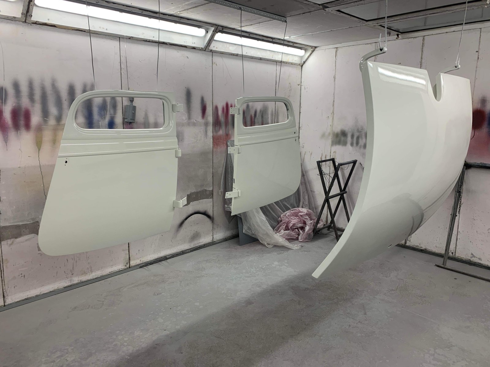

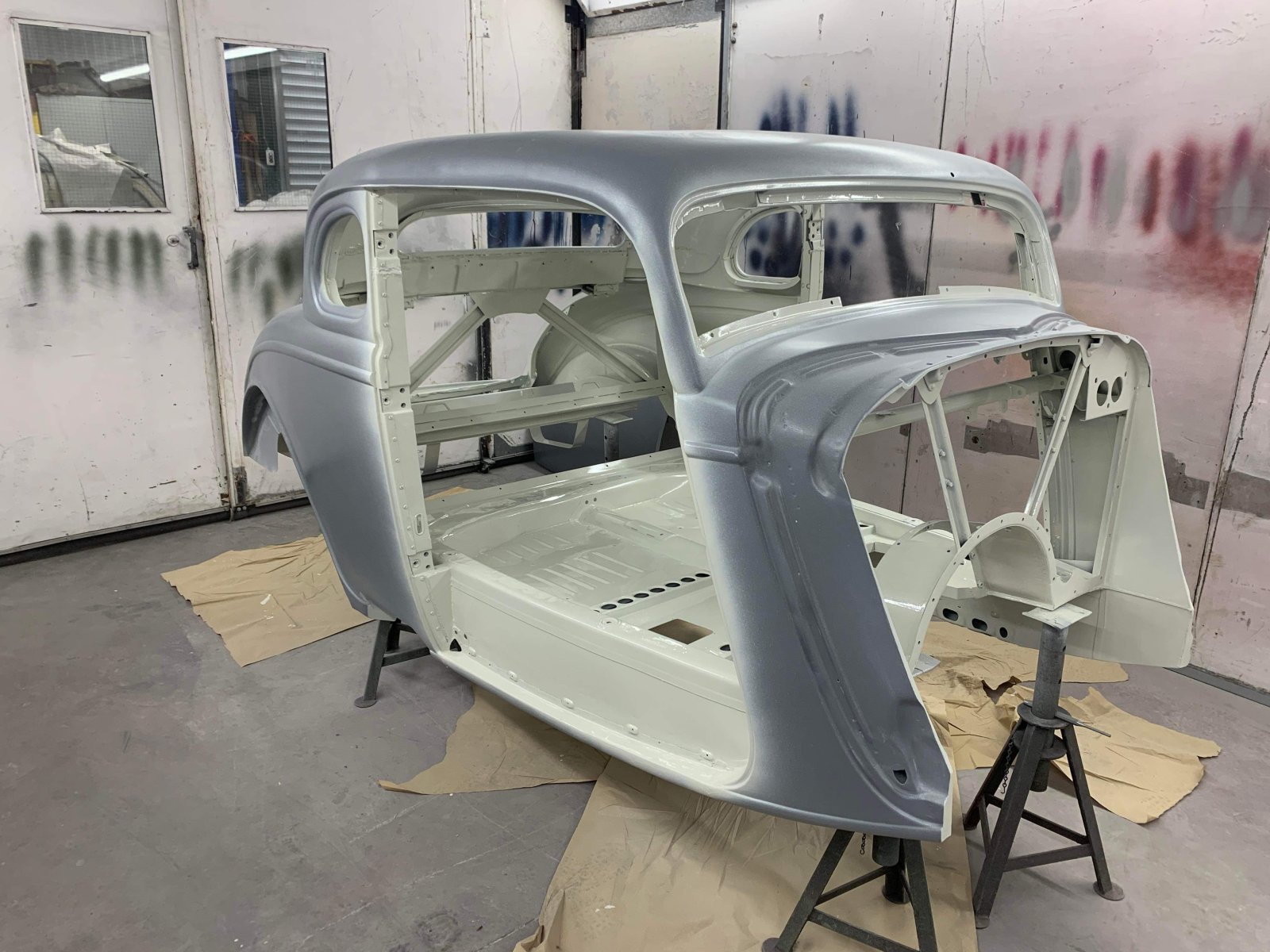

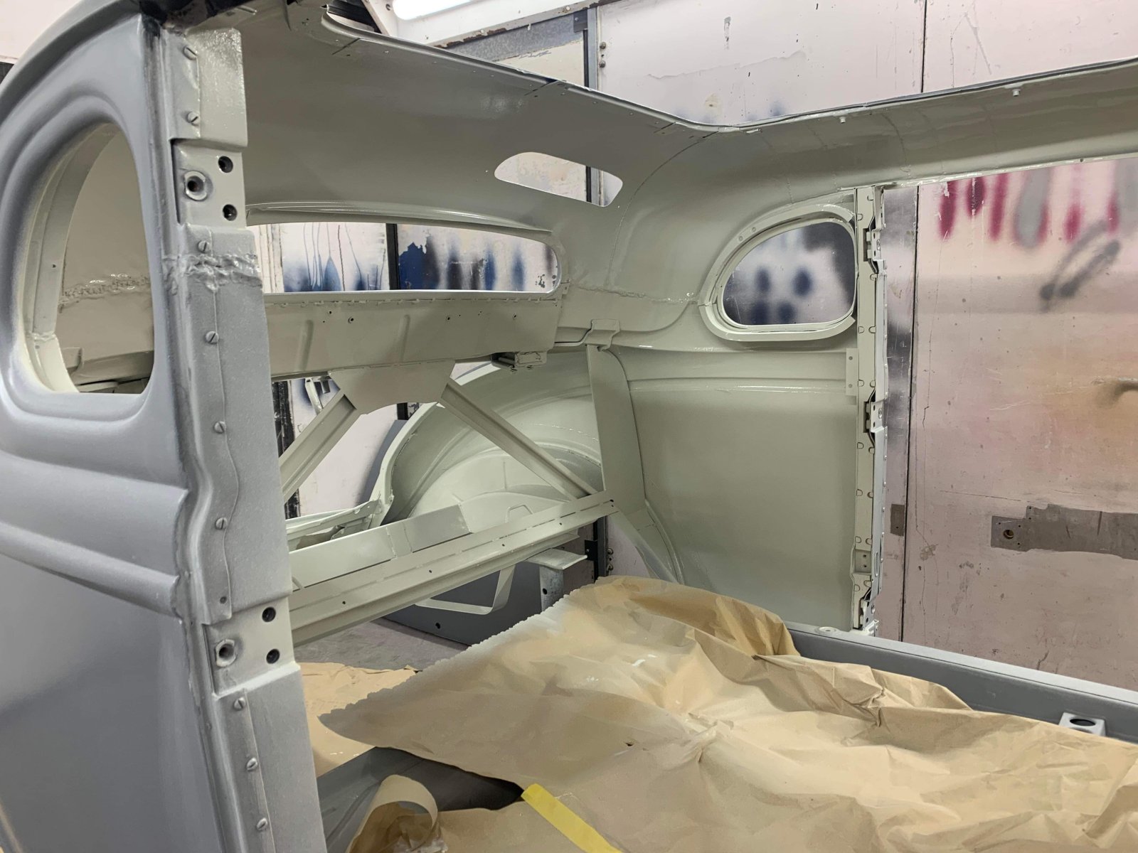

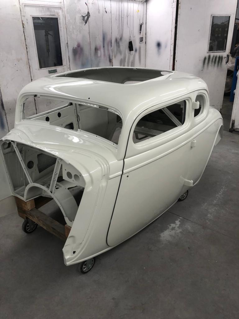

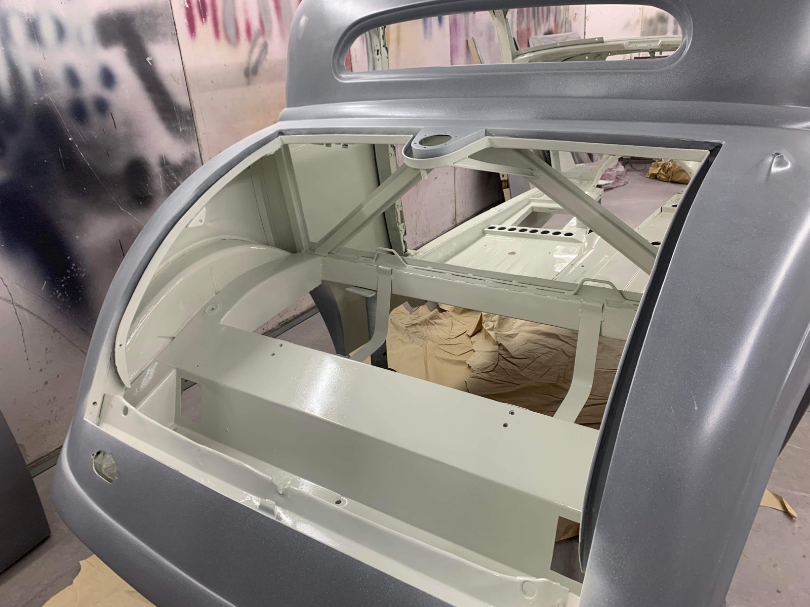

    meanwhile the body got shipped out for final wet sanding and top coat, underneath inside and outside
    It’s now back waiting to go back on
    F1E0029F-FB57-4E73-A92E-50FB235B86C0.jpeg 7B196EB8-374B-459D-AE23-85953930CA1C.jpeg B991988C-C825-4972-ACC5-E764CAA3C60E.jpeg 9A54F6FB-78F1-4679-BC04-6884D67E47F1.jpeg 345835F6-33CB-4829-B0AB-335669DB0E6C.jpeg 89E223B9-4DAA-412E-A5F6-0D3441546A8C.jpeg E058A908-B3DD-4F50-9A25-4462B714C56E.jpeg C0D6BFA5-D6B9-405A-AF4D-9230C436EF81.jpeg E87E94CB-A060-4402-B88F-EC2634A42FC4.jpeg D81327C2-27F0-43B5-A0E0-7C66AA9CA0D2.jpeg

    Such an awesome hotrod! So many nice details, it has a mean stance! Details such as the roll bar & spring leaves make sense when the thinking & background are explained. It these Details that set the car apart! I am looking forward to seeing the body in paint :D

    Thanks, it’s been a lot of work and that is paint!

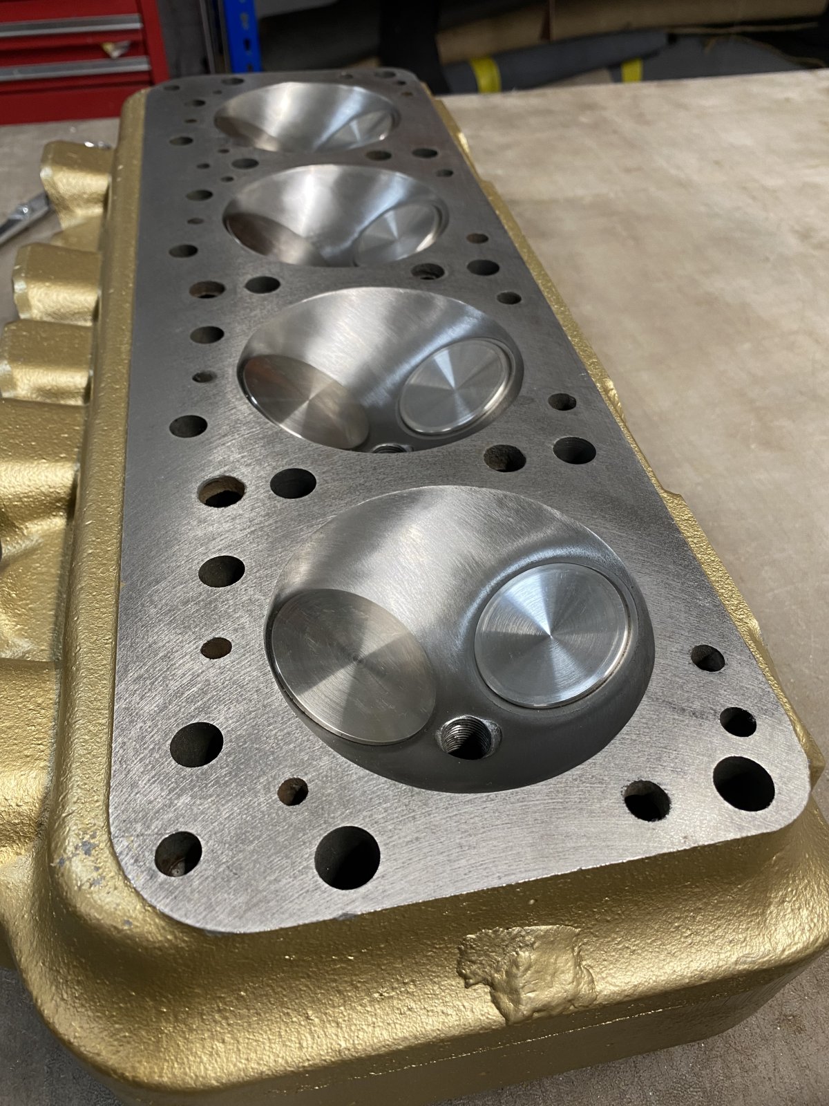

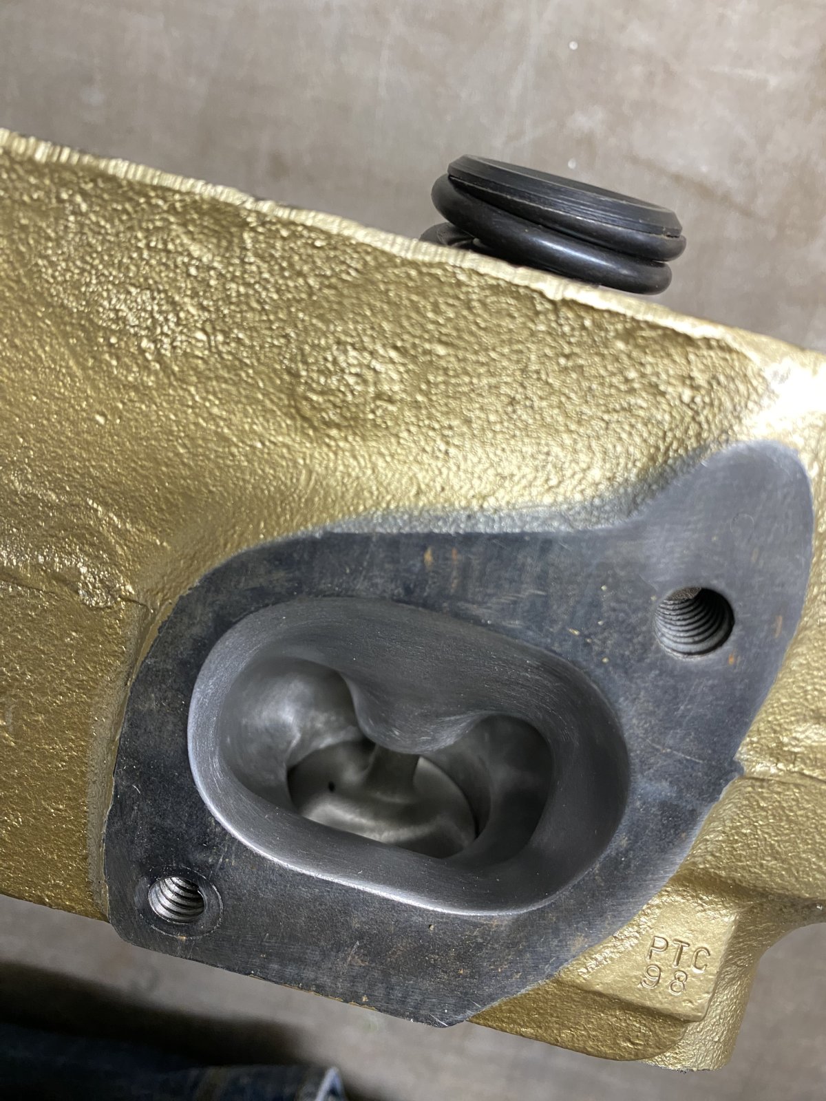

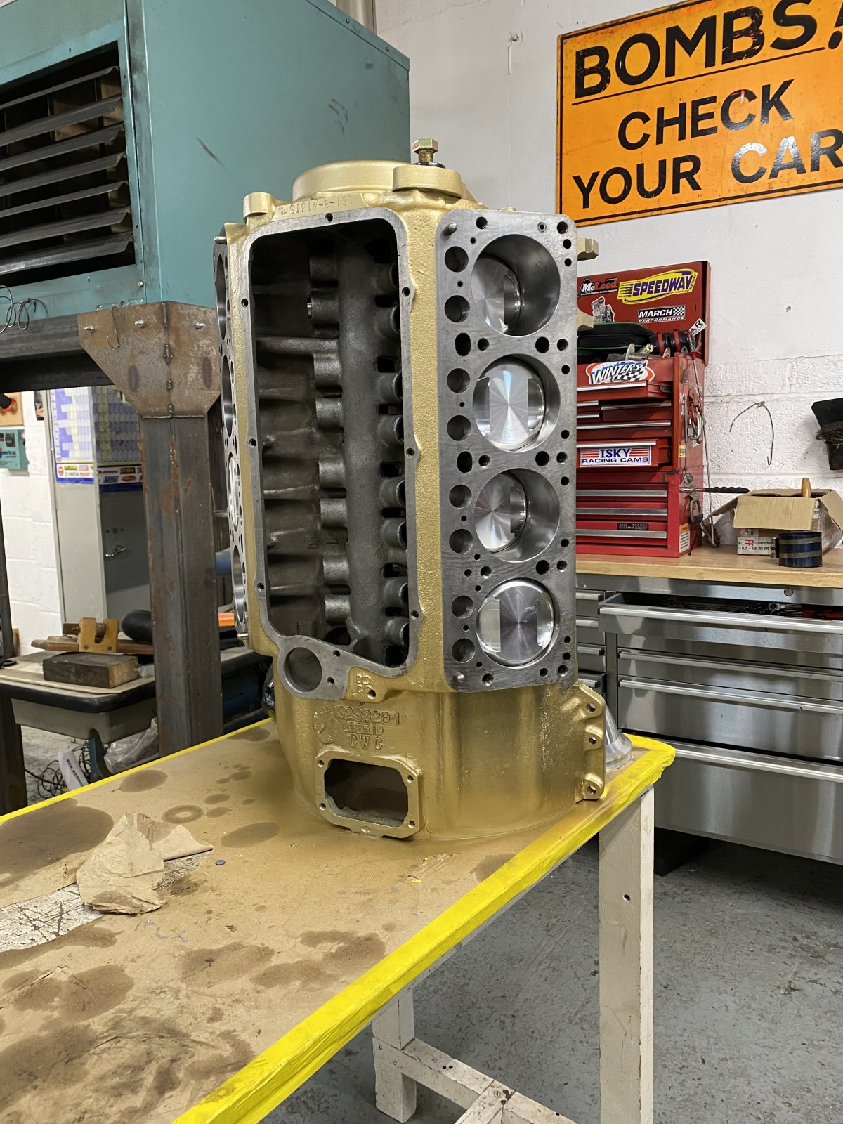

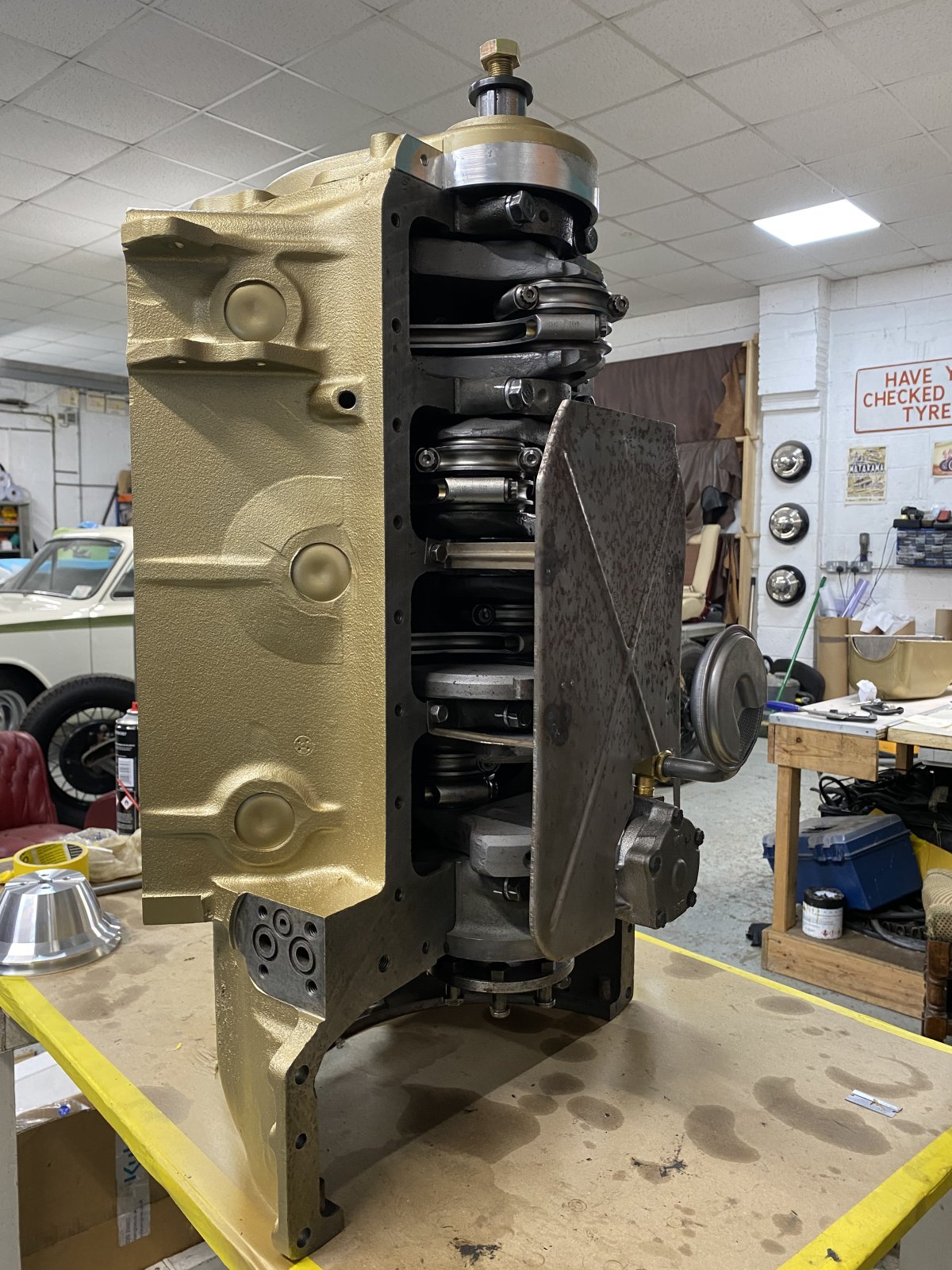

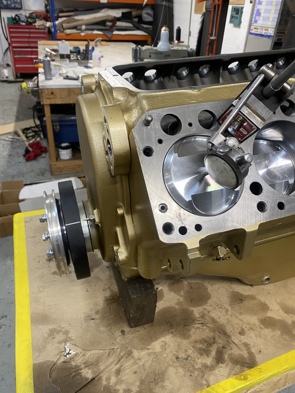

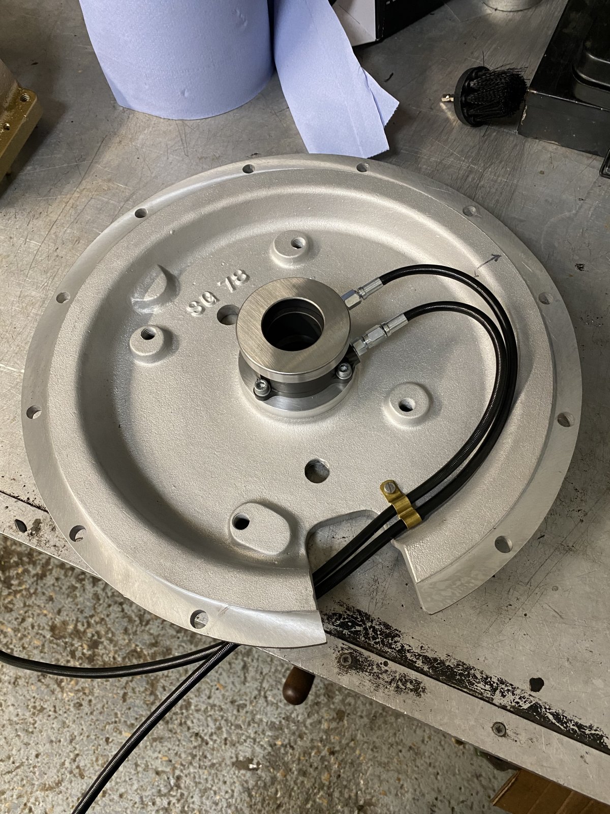

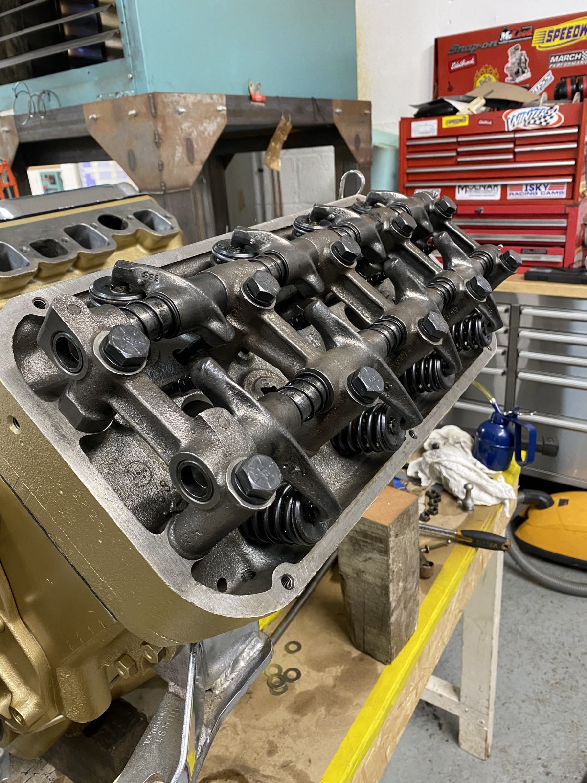

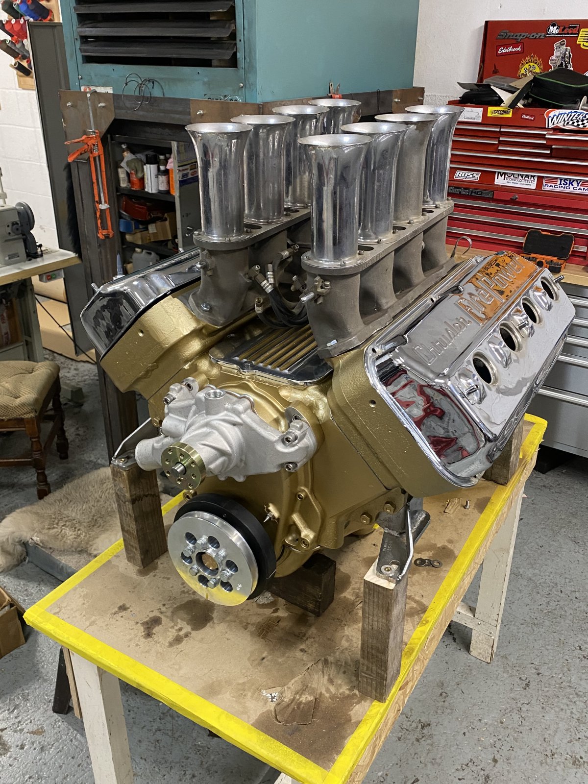

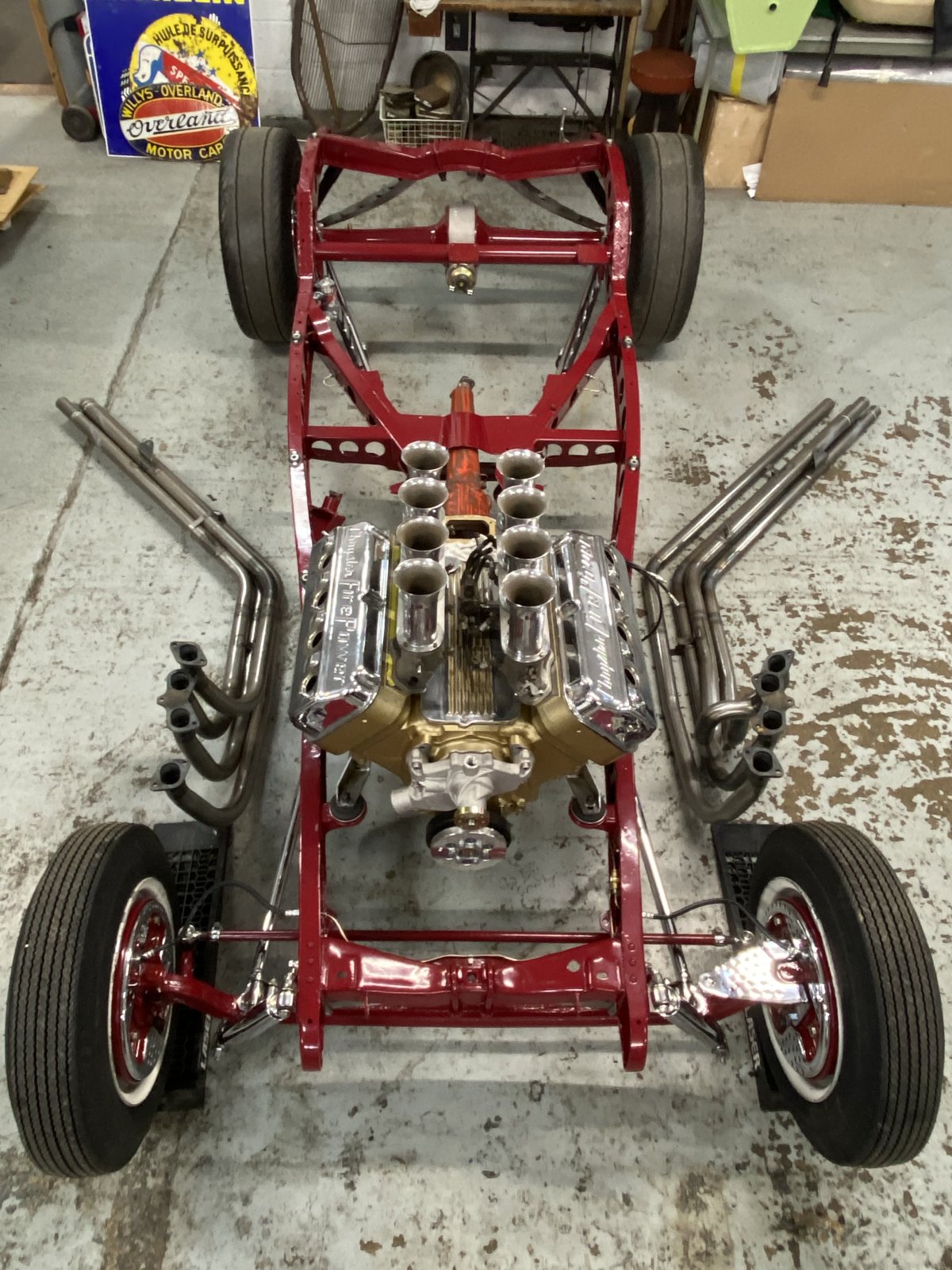

    from UK
    Next up was the engine, ‘51 long bell housing 331.
    Basic specs
    .060” over
    354 crank (old one was scrap)
    Molnar rods
    Ross pistons 10:1
    All the hotheads mods, oil pump, balancer, water pump etc.
    354 heads 2.02” inlet 1.75” exhaust, ported and polished
    Isky solid lifter cam B777 I think
    Ali flywheel and McLeod clutch
    Lasalle side shift trans
    E78ECD88-8EC9-4DDC-9899-6A9C6EA4374D.jpeg FE7927B9-2080-43C9-BD49-A4B28CE23588.jpeg 730882F9-C816-43C5-9FBA-5C6346DB0EF2.jpeg

    I won’t be running the Hilborn but it does look good
    F4915F6A-36BB-41C1-B916-FC9E6243F21F.jpeg 11F596A3-C072-43E3-87DF-D7DD15973360.jpeg A5810E9D-0438-4461-ABF6-D269C0064ADF.jpeg 36F75E6B-496F-4582-907D-F2DDB9F5666C.jpeg EB6D610C-51FF-4BA2-98A7-9218A6B8AF39.jpeg

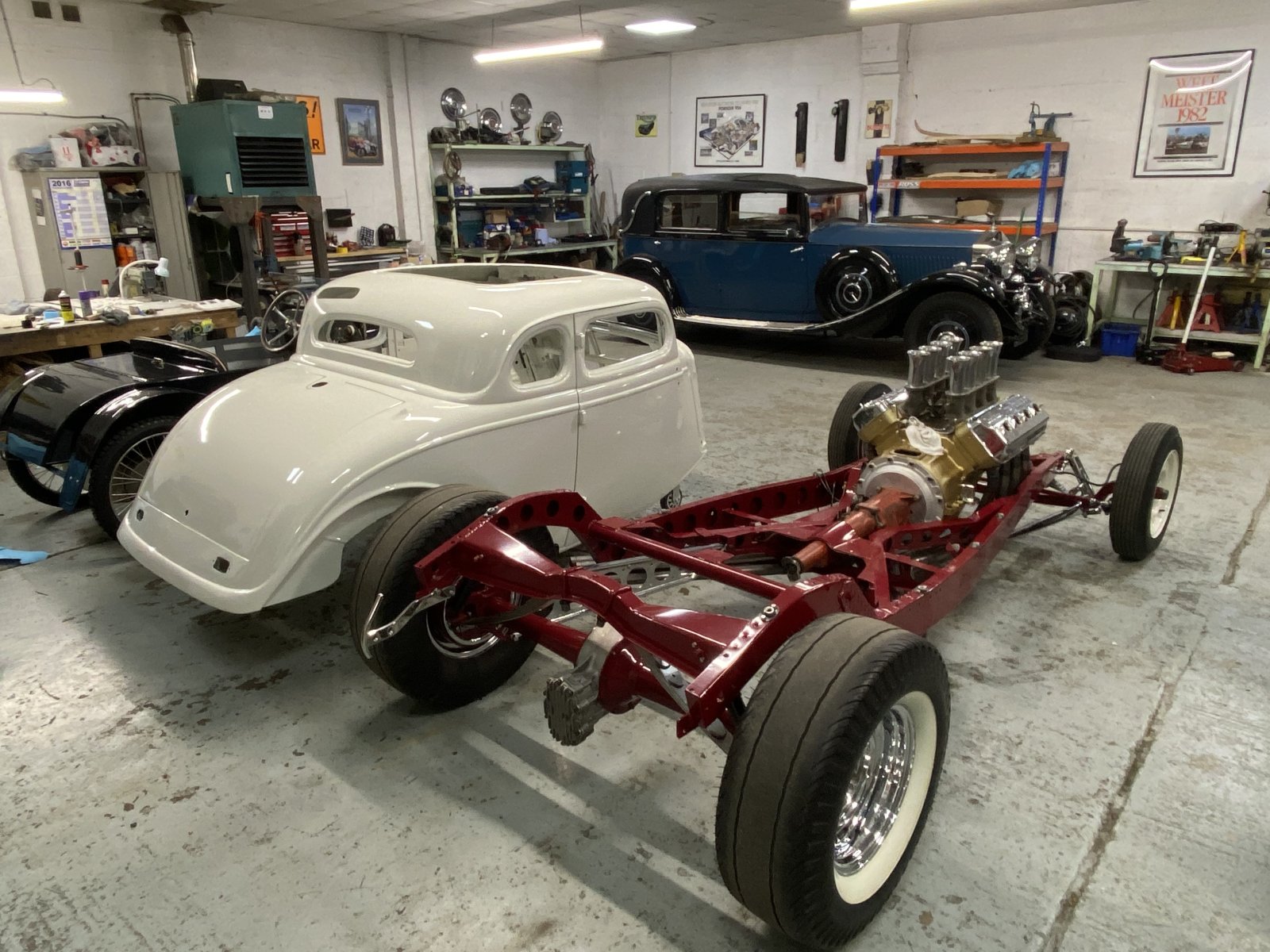

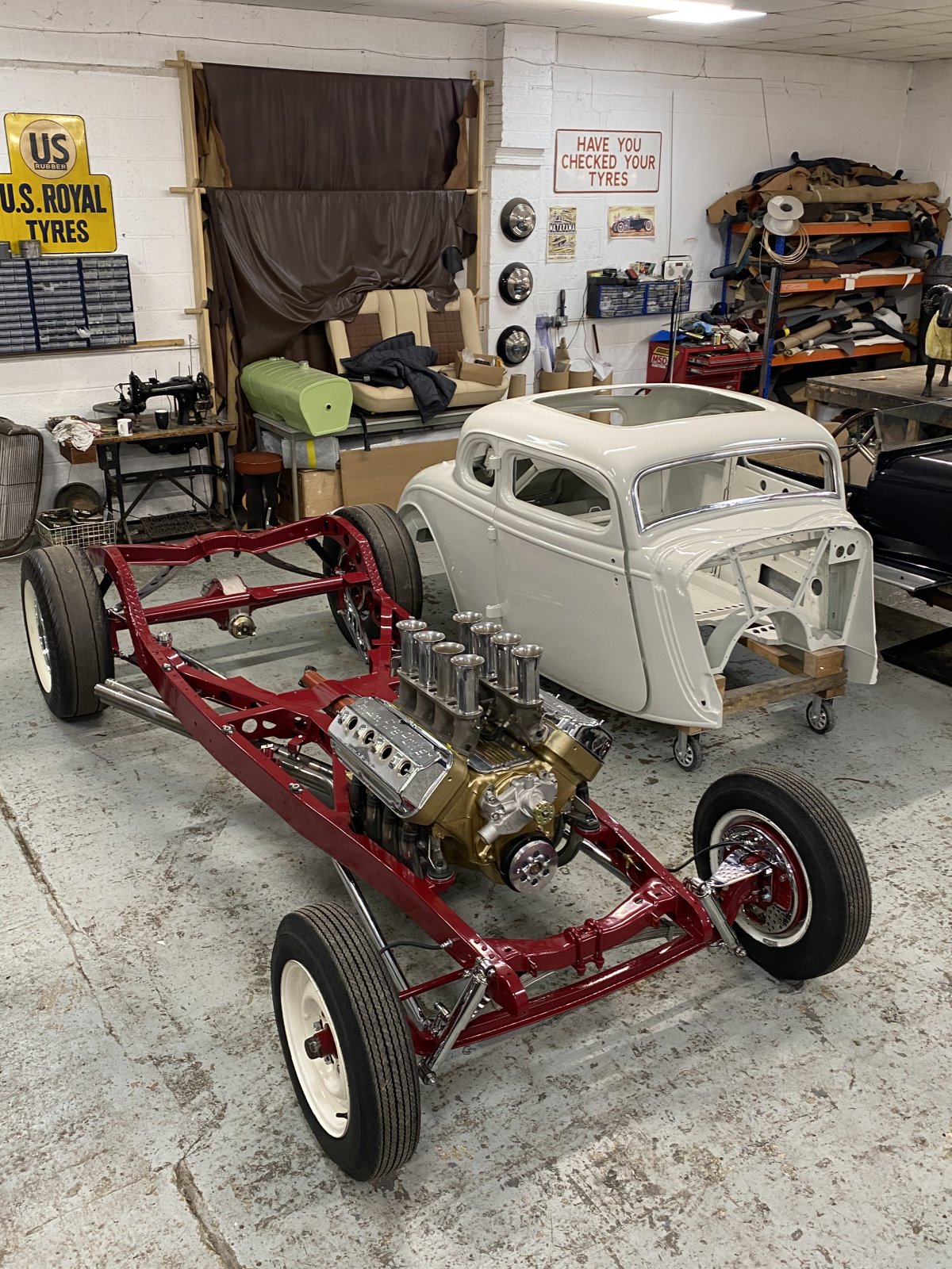

    Thanks, should have the engine in the chassis tomorrow
