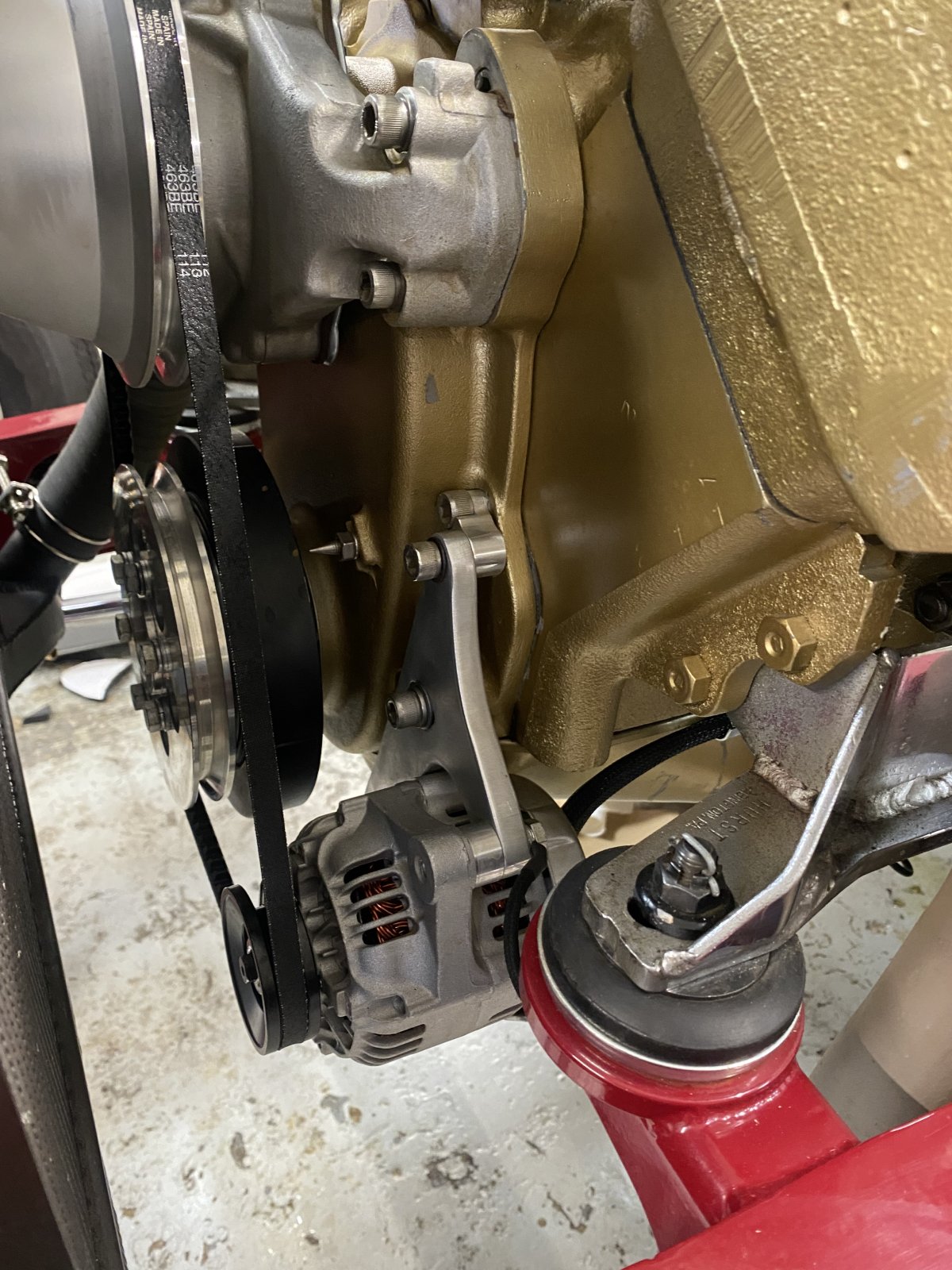

    Alternator mounted chopped up hot heads mount to fit a small Bosch alternator

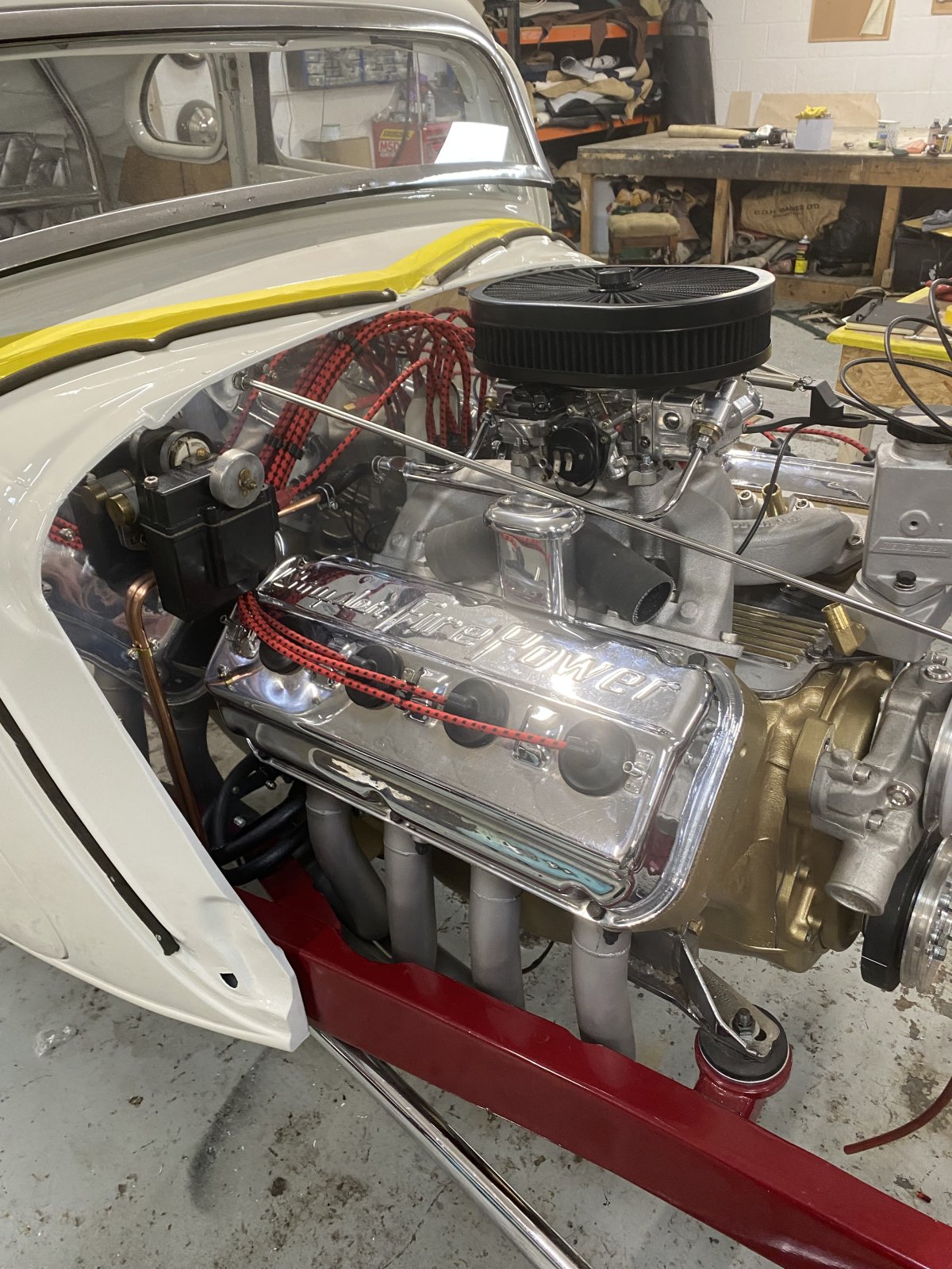

    IMG_2584.jpeg aluminium bonnet in progress to cover it all, expect hood scoops
