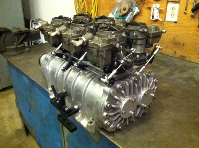

    I figured I would post a little update. I've been working on getting the blower on the truck this winter. Even though I'm going with a blower I still feel I need to keep the 6 2's. I just feel they are kinda the personality of the truck. I just couldn't go with a couple of Holleys. Plus that would be too easy. :)
    When I first started mocking everything up I wanted the keep the setup the same as it was on the manifold. But no matter what I did it kept looking like shit. The large base 2G's just take up too much area to look right side by side. So I flipped them side ways.
    The only thing about flipping them was the linkage. It was going to be much more complicated. I wanted to keep it progressive just like it was N/A. What I came up was to run the front left 2 carbs as the primaries and the other 4 as my secondaries. Which actually made the linkage fairly simple. I just bought 2 supercharger linkage kits, which gave me all the pieces and parts I needed. All I had to do was add the extra carb on each side and setup the back carb as the progressive one. The action flips off of the same back carb by extending the one shaft and adding an extra arm, then tying the 2 together.
    Hopefully I won't have to mess with the idle and crusing tune much and just have to play with WOT. That's my theory at least. :)

    Have you thought about using Webers? All those 2Gs seem to give it a cluttered look.

  26. I nope I am not bursting your bubble for Uniqueness!!! You need to go carbs with fuel injection modifications or turn everything around to work properly. I would say that your carbs are too physically big to work properly. It will be fun watching you though. In the late 50's thru the 60's we all tried to mount carbs every which way. Only to quickly find out that your fuel in the bowels will be all over the place!!! You may never get those things to run with forward momentum. It would be a nightmare to set your floats and keep the proper level inside the bowels in order for the carbs to perform period. Unless you find away to make them into injectors so that you can keep that CRAZY lookin' contraption on top of that 671 BDS. A big block with a roots booster will have all kinds of torque!!!!!!!!!!:eek:
    Someone mailed your blog to my Email is how I got involved here. But I have been down that road years and years ago on the strip and on the street.:mad: Just tryin' to figure it all out back then without all of the today's knowledge accessible was NOT fun!:(
    If you do get it to run, AS CARBURETORS, then I would like to see and ride in that thing! :confused:
    If I missed something here as I see you have a several page thread please fill me in. The truck is really mean lookin'. I use to channel and chop like yours on several cars in the past but today at my age:D I can't twist my neck like I could at 20 to 30 years young (then!) so my cars today are taller. Not because they look mean:cool: or cool it is because of arthritis and old joints! So I couldn't ride far in that thing (truck):eek:

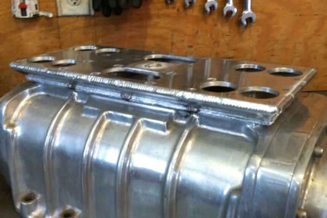

    I LOVE your Tig welding done on your manifold! Keep up the good work. Again You have a nightmare to work on and keep it tuned. Only carbs that you will have to idle adj are the 2 primary center carbs. The other's should NOT leak ANY air until they are opened.

    I guess looking somewhat cluttered is one of the drawbacks of running multiple carbs on top of a supercharger, especially these. To me I don't think it looks any more cluttered then guys running 8 97's. Plus I think turning them sideways really helped the top heavy look.
    As far as the Webers, truthfully I never really thought about it. In all honesty if were going to spend a bunch more money. I would of kept the setup the same as it was N/A a put a couple of F-1 Prochargers on it blowing trough the Rochesters. That's what my first plan was, but I didn't want drop a bunch more cash in it. I've had this 8-71 for years and even tried to sell it a couple of times. One day I saw it in the basement and I thought why the hell don't I toss my Rochesters on top and give that a try. Plus as it's starting to come together I really like it. The Webers look too high tech, I'd rather have my primitive 2G'S. :)
    Fuel slosh is one of my concerns turning these sideways. Why do Holleys run right sideways? I guessing center hung floats? My plan is to get it all together then hammer out those issues. I was just looking at my mockup carbs. I think if I had to I could make a bracket to drop in the bowl to change to center hung floats. I don't know it's just an idea right now.
    I'm always open to people comments or experiences on this. Does anybody else have any experience turning carbs sideways and float problems/ fuel slosh?
    Joe you're welcome take a ride anytime!
    It is tuned really good N/A so I'm keeping my fingers crossed I can do it again supercharged.
