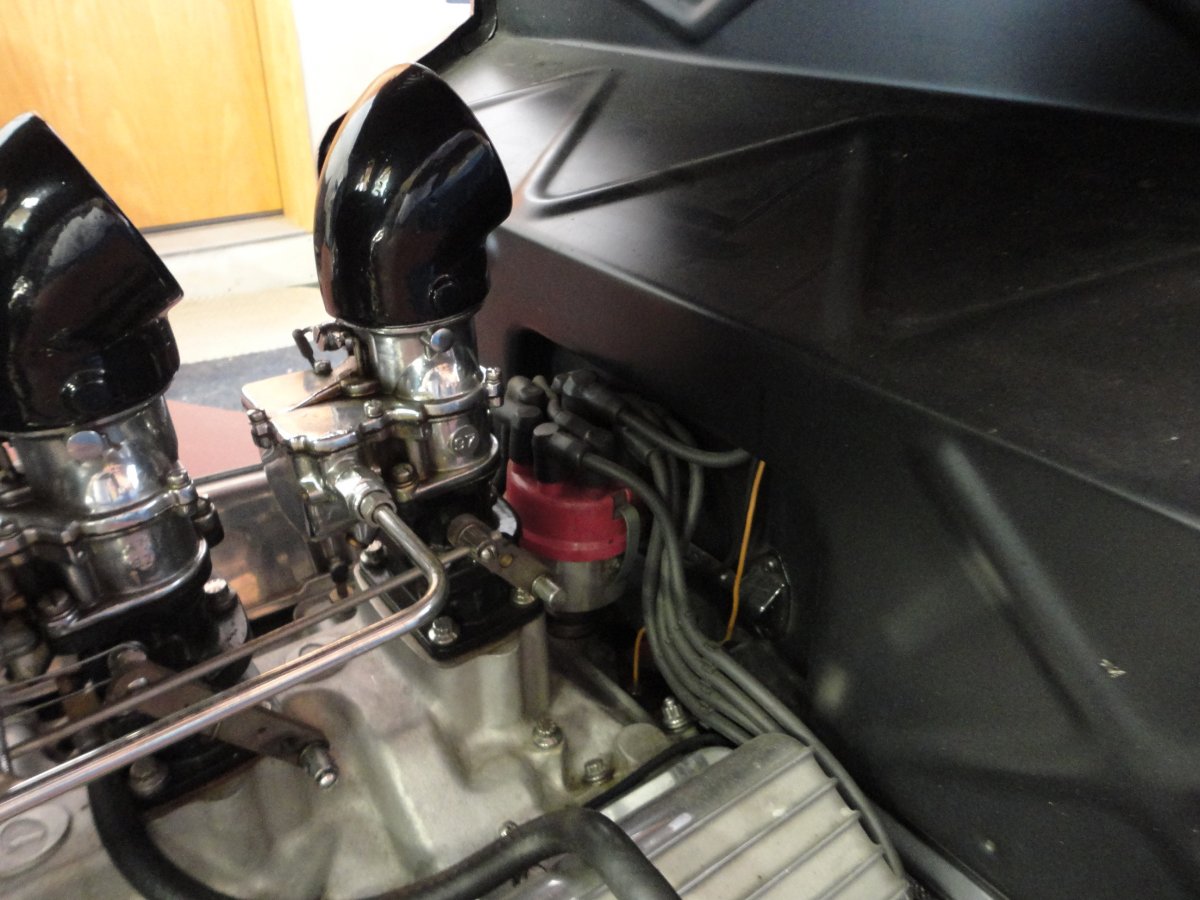

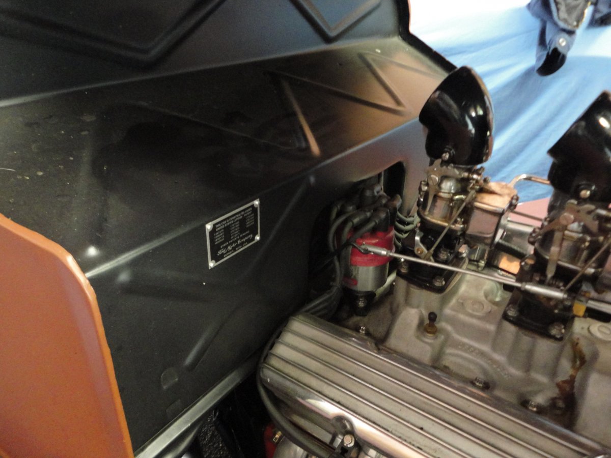

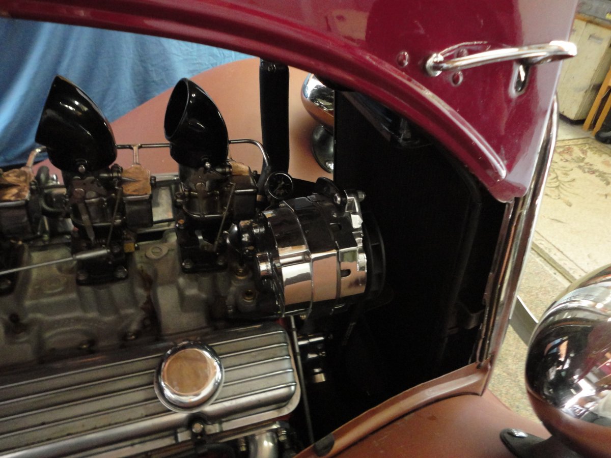

  7. Johnny99
    Joined: Nov 5, 2006
    Posts: 1,180
    Johnny99
    My buddy Mike's three window. Made the stock Ford recess a bit deeper, uses a Hurst style mount, short water pump, small base distributor, and mechanical fan. Yes he can remove the dizzy if needed. Plan on doing this to my 34.
    John
