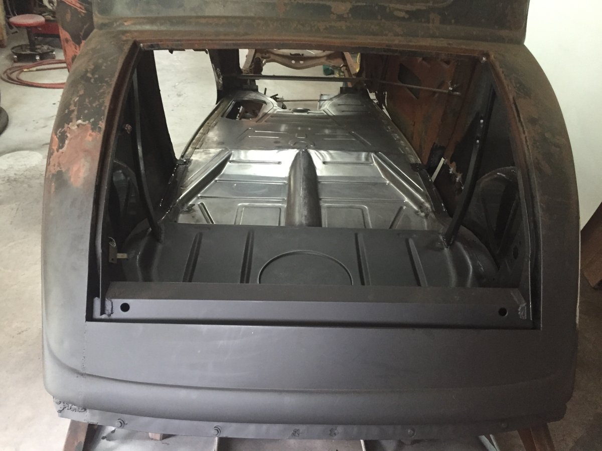

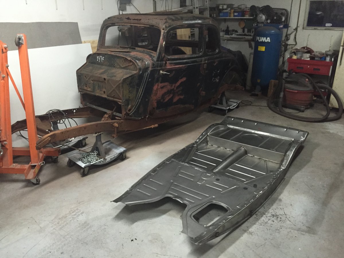

    Congrats on finding/buying your doors. I needed a pair for mine and settled for a pair of door shells from a 4 door. Paid $900 plus shipping and still had to replace bottom inners and outers and used 2 door sedan door tops.
    Did you get a deck lid with your car? There's another $1400 if you want louvers with it.

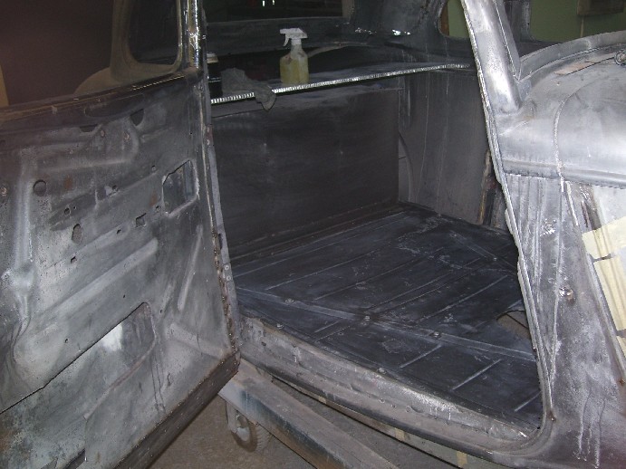

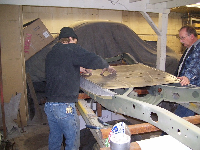

    Floors are pretty simple to make if you don't want or need the depression under and behind the seat. I wanted mine flat so we made 'em up from 18 gauge with plenty of beads rolled in.

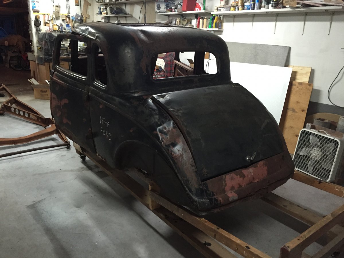

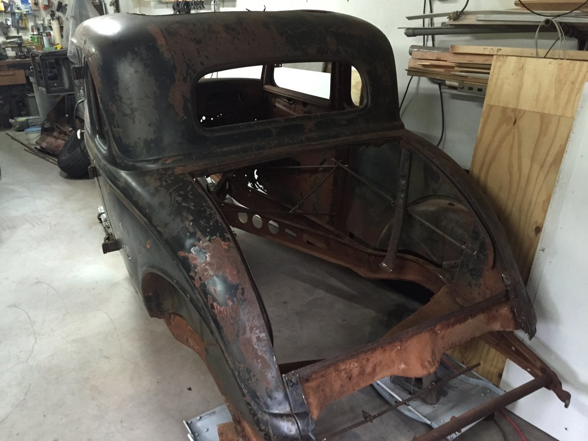

    I hope my '34 looks as good as yours when it's done. I was very lucky that I only had to drive 3 states away for the original Five Window Coupe doors from the H.A.M.B. Seller. I did not get a Deck lid with the Car. I bought an original '34 deck lid from a guy in Chicago that needs a new skin that is in the picture attached, but unsure where to get a new skin ? Any guidance would be appreciated. I have heard that Steve's Auto Restorations makes a very nice reproduction Deck Lid.

    Steve's Autorestoration in Portland makes excellent parts. I have one of their decklids and the quality is second to none. Get one and you won't be disappointed.

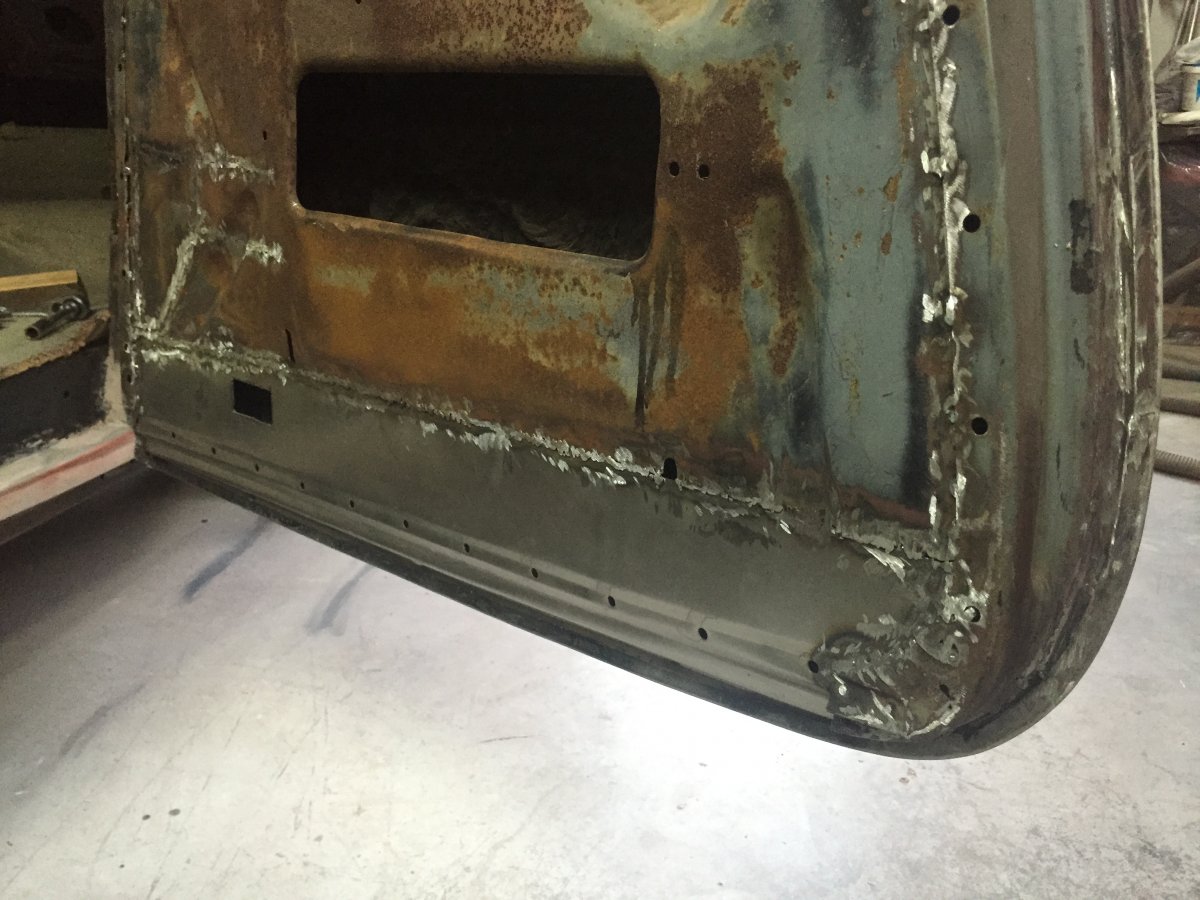

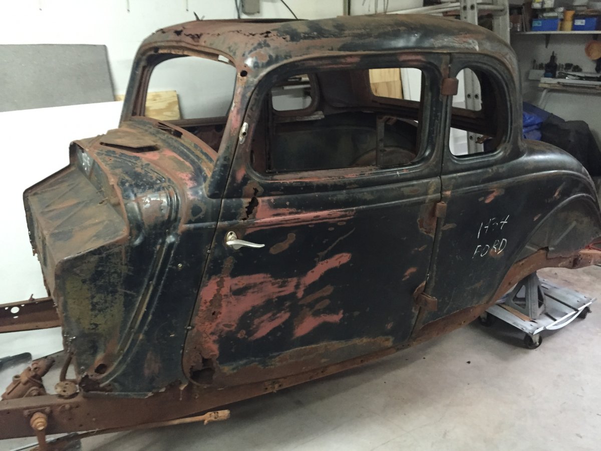

    Starting on replacement original drivers side door that I found on the H.A.M.B. with lower patch panel.

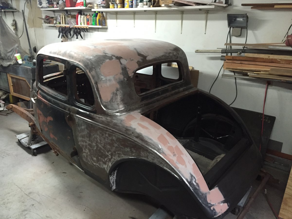

  16. MR CLEAN
    Joined: Nov 25, 2015
    Posts: 104
    MR CLEAN
    Greatly appreciate all the input I have received from H.A.M.B. members on my builds both good and bad and will continue to share progress on my '34 Ford going forward. When bringing back 70 year old plus wrecked and rusted original bodies there are many different ways to start out. Some builders with better condition bodies will sand blast or soda blast the entire body, but I have chosen the brushed acid wash method to neutralize rust or my wrecked and rusted builds would be a large pile left in the blasting booth. Having clocked over 600 hours of bodywork in a recent build with a rusted original body, it is a fact that plastic mud is used by many builders to achieve perfection in some areas when needed. I am no expert, but still unsure how ***umptions can be made of work not pictured, but in any case it doesn't matter anyway. My goal is to simply share and receive idea's with everyone.

  20. Blue One
    Joined: Feb 6, 2010
    Posts: 11,578
    Blue One
    from Alberta
    It isn't that plastic mud is a problem, applying it over properly prepared metal is the important part.
    Good to know that you are doing so.
    Share with us your technique for what you are doing.
    The brushed acid cleaning is not something I'm familiar with. ( I always thought that blasting followed by epoxy primer was best.)
    Does it neutralize and stop the rust ?
    Always good to see something different if it works.

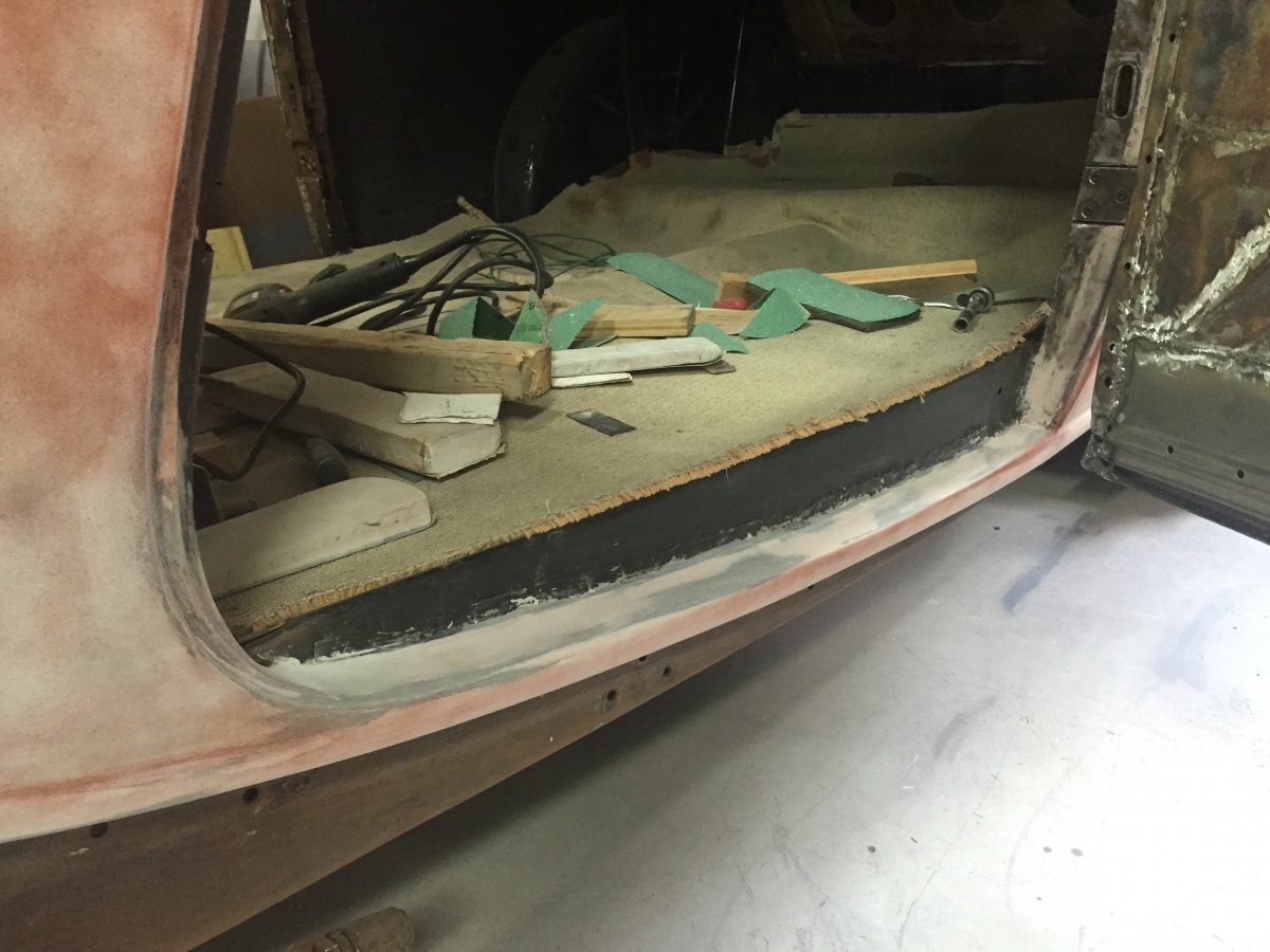

    Very nice find & repair. Any more pictures on roof header repair & roof insert. Must have rested on front roof into dirt for a while. Great save - will be watching the finish of this one.

  25. MR CLEAN
    Posts: 104
    MR CLEAN

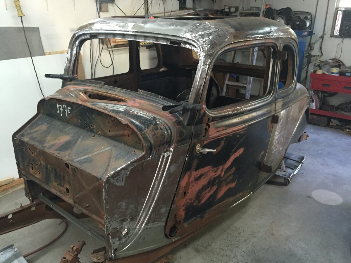

    Since sand blasting or soda blasting this entire body was not an option with this build, or my wrecked and rusted build would be a large pile left in the blasting booth, chose the brushed acid wash method to neutralize and stop rust. First step is to grind off heavy rust surface areas, then use Prep and Ready Rust Remover & Pre-Primer in a Spray Bottle(Straight Acid, do not mix with water). Keep treated area wet with spray bottle and work with scotch brite pad for 20 minutes. Wash treated area with straight water and use epoxy primer as soon as treated area is dry.

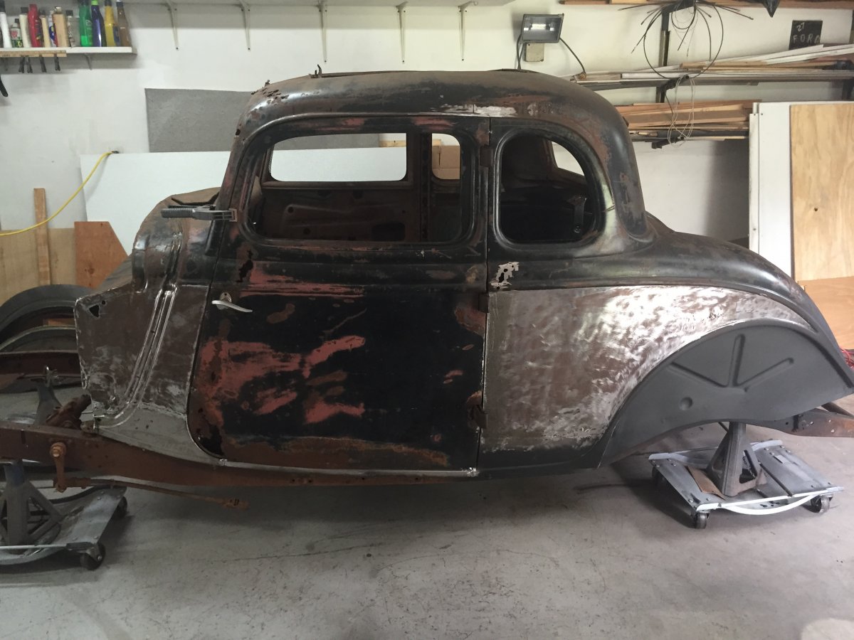

    Finished fixing the replacement of original drivers side door found on the H.A.M.B. with inside and outside patch panels from R & J Enterprises in Arkansas City, KS at 620-441-0032 Still need to work more on Door Gaps to get Perfection.

  29. Blakmerk
    Joined: May 15, 2002
    Posts: 322
    Blakmerk
    from St.Joe MO
    I see no filler above the belt-line. Does this mean chop time?:)
