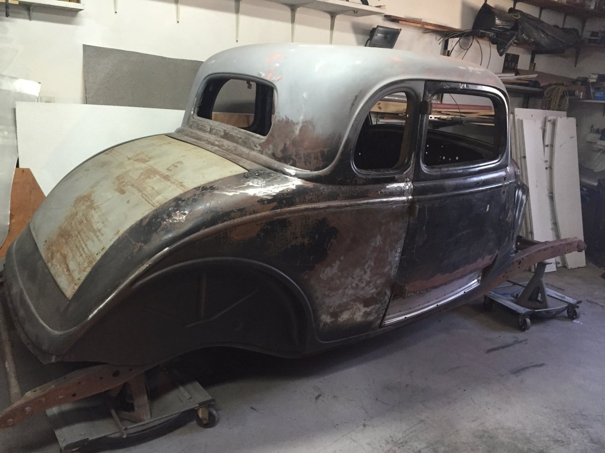

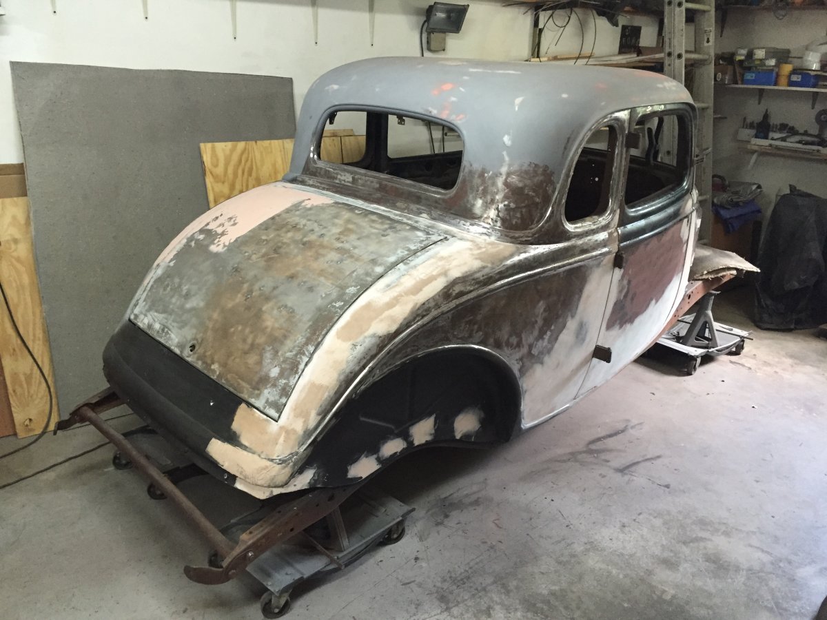

    Chop time is in the future, but still have a long way to go as need to finish the replacement of original p***enger side door with inside and outside patch panels. Finish original firewall and finish original '34 deck lid found on the H.A.M.B. pictured below as there was not a straight panel on this build when started. Once Pete and Jake's built frame is rolling on '35 wire wheels with quick change rear end, planning to cut it between 3 to 5 inch on chop with leaned posts and angles.

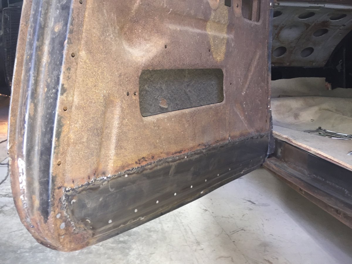

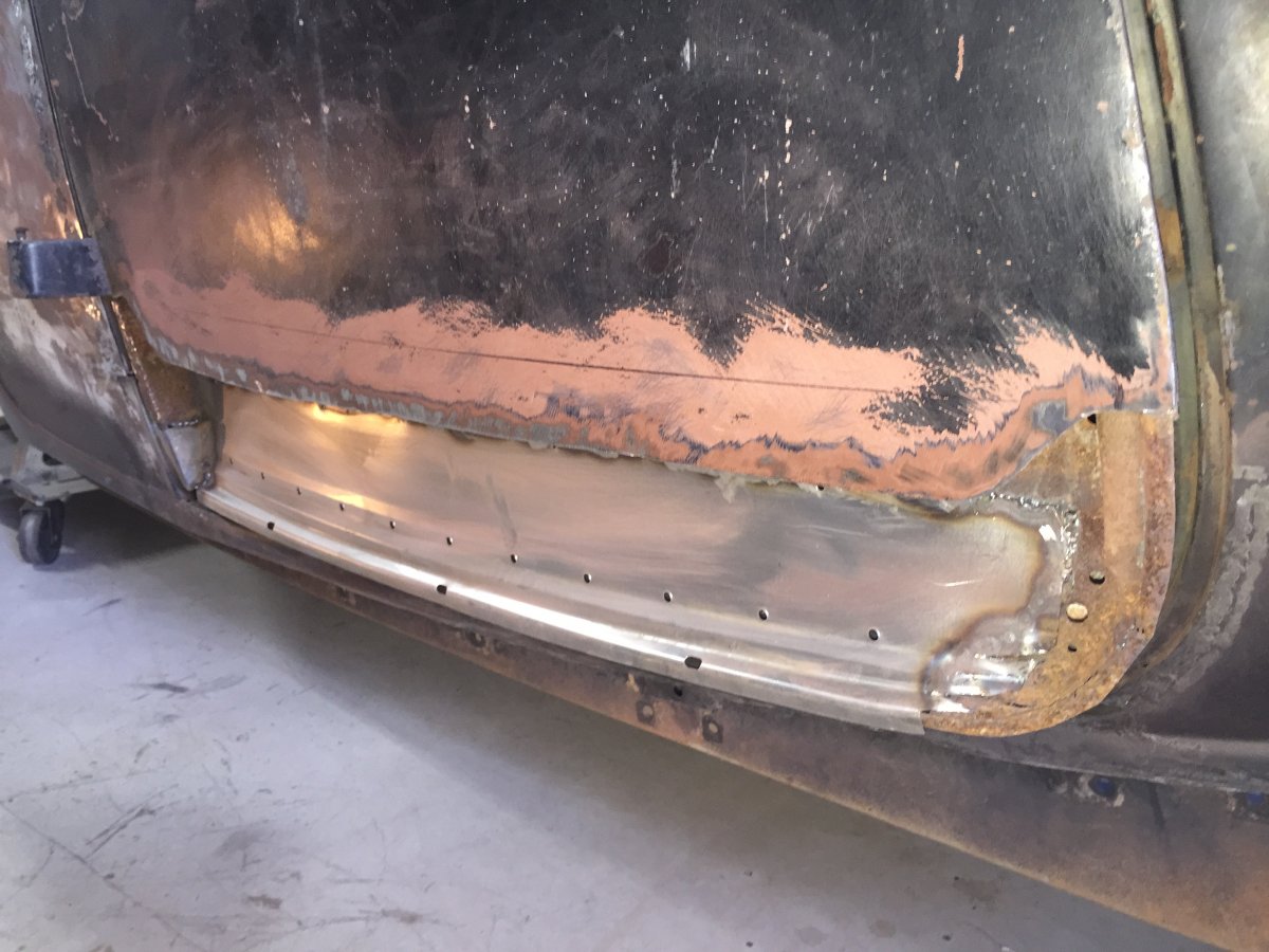

    Fixing the replacement of original p***enger side door found on the H.A.M.B. with inside and outside patch panels from R & J Enterprises in Arkansas City, KS at 620-441-0032.
    kidcampbell71 likes this.
  9. dumprat
    Joined: Dec 27, 2006
    Posts: 3,573
    dumprat
    from b.c.
    That is really starting to look like something! Nice work.

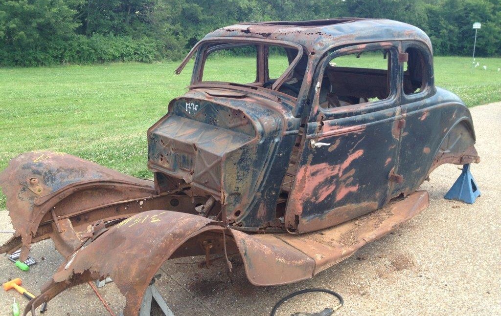

    I greatly appreciate your and everyone's feedback on the H.A.M.B. as this build is a very slow process towards perfection. I have full fenders on my '37 Five Window Ford Coupe, but will not be running full fenders on this '34 Five Window Ford Coupe build considering what condition the original cars front fenders, running boards and missing rear fenders were in as seen in picture below. My friends thought I lost my mind taking on this project, but it had to be saved and that's what Hot Rodders do!!!

    Finished fixing the replacement of original p***enger side door found on the H.A.M.B. outside patch panel from R & J Enterprises in Arkansas City, KS at 620-441-0032. Will start on the original '34 deck lid found on the H.A.M.B. next.

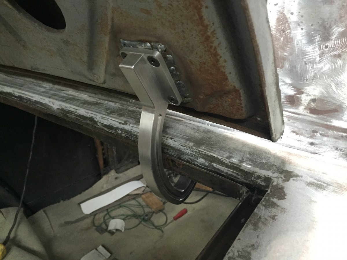

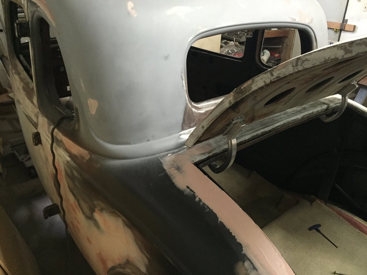

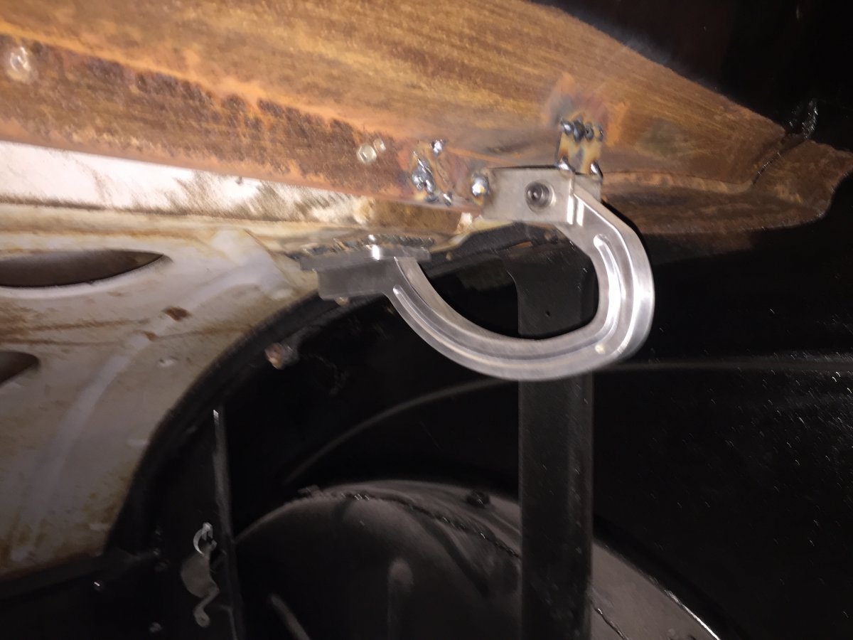

    The original '34 deck lid that was found on the H.A.M.B. was in nice condition for an original piece. Purchased Billet Hinges from Rocky Hinge Company in Girard, Ohio 330-539-6296. The deck lid body gaps will be the next task in this build.

  23. Coming right along, nice work.what was the fit and contour like on the inner and outer R&J patch panels?

    Thanks Duncan, The patch panels outlines and shape were perfect from R & J Enterprises in Arkansas City, KS 620-441-0032 with the original '34 doors.
    I highly recommend R & J Enterprises which specializes in '32 thru '34 replacement patch panels. R & J Enterprises is the one stop shop for everything needed on this type of build as Tom makes a great product.

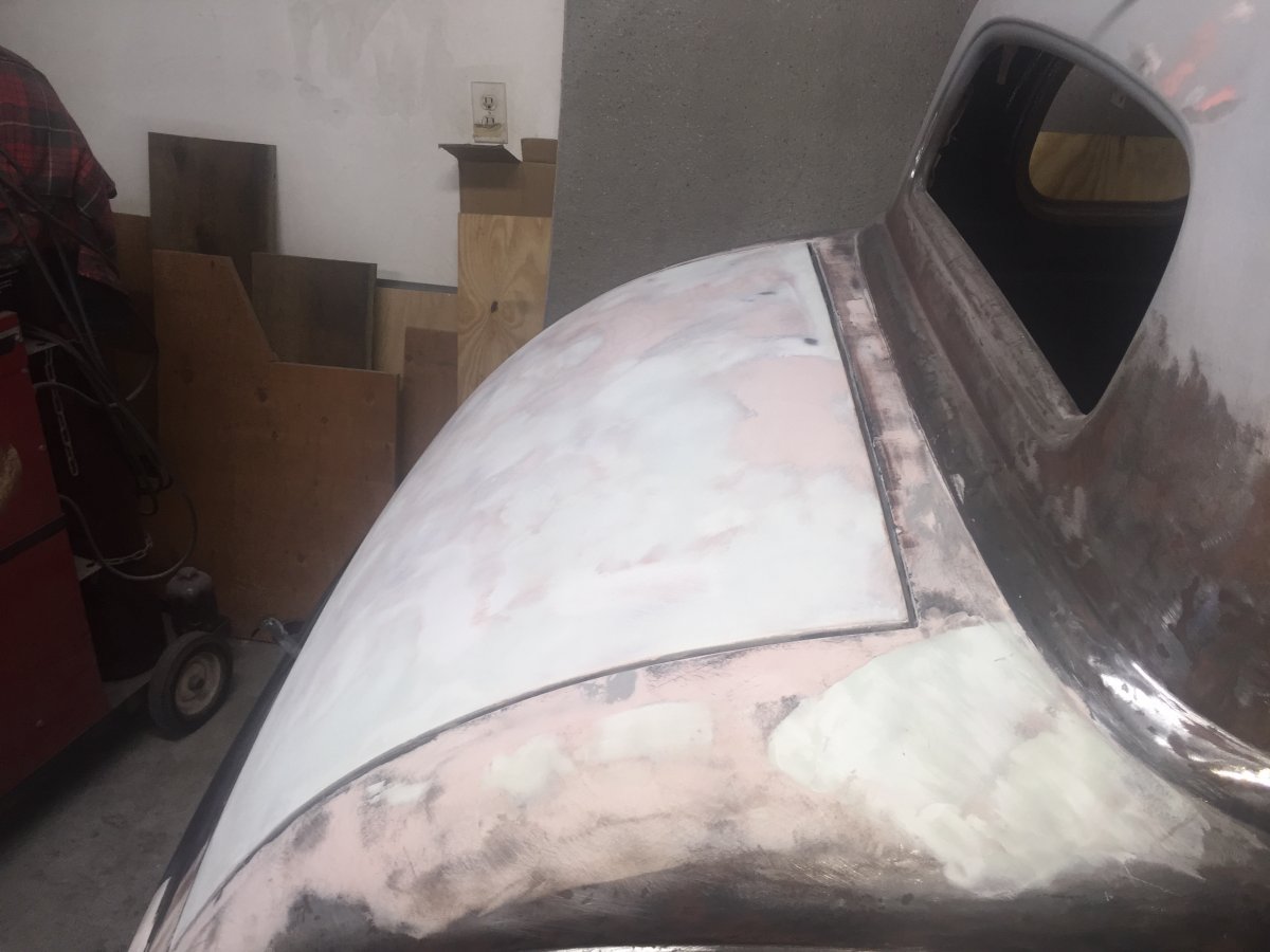

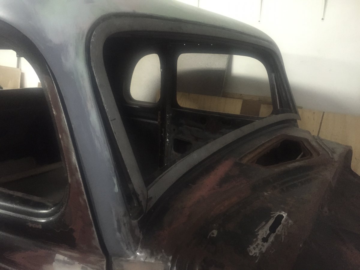

    The original '34 deck lid body gaps needed to be addressed and the results are pictured below. The large gap between the original '34 windshield frame and the roof line will be the next task in this build.

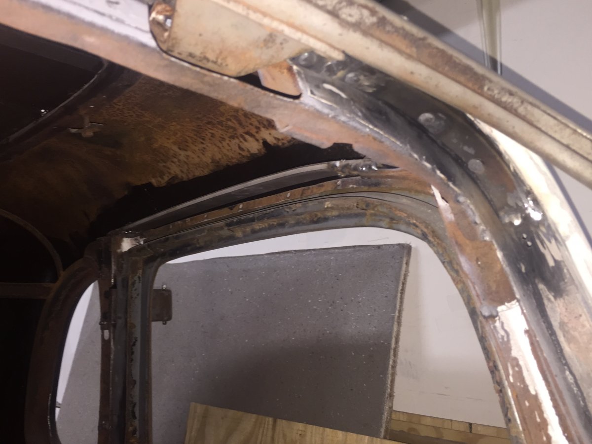

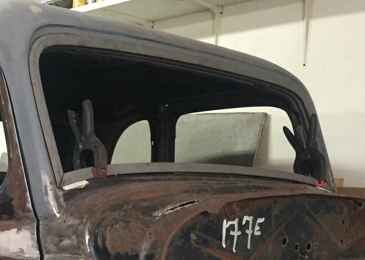

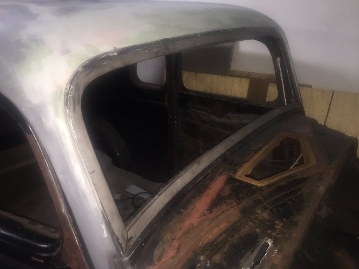

    The large gap between the original '34 windshield frame and the roof line needed to be addressed and the results are pictured below. Filling in the large quarter size holes in the '34 factory firewall with will be the next task in this build.

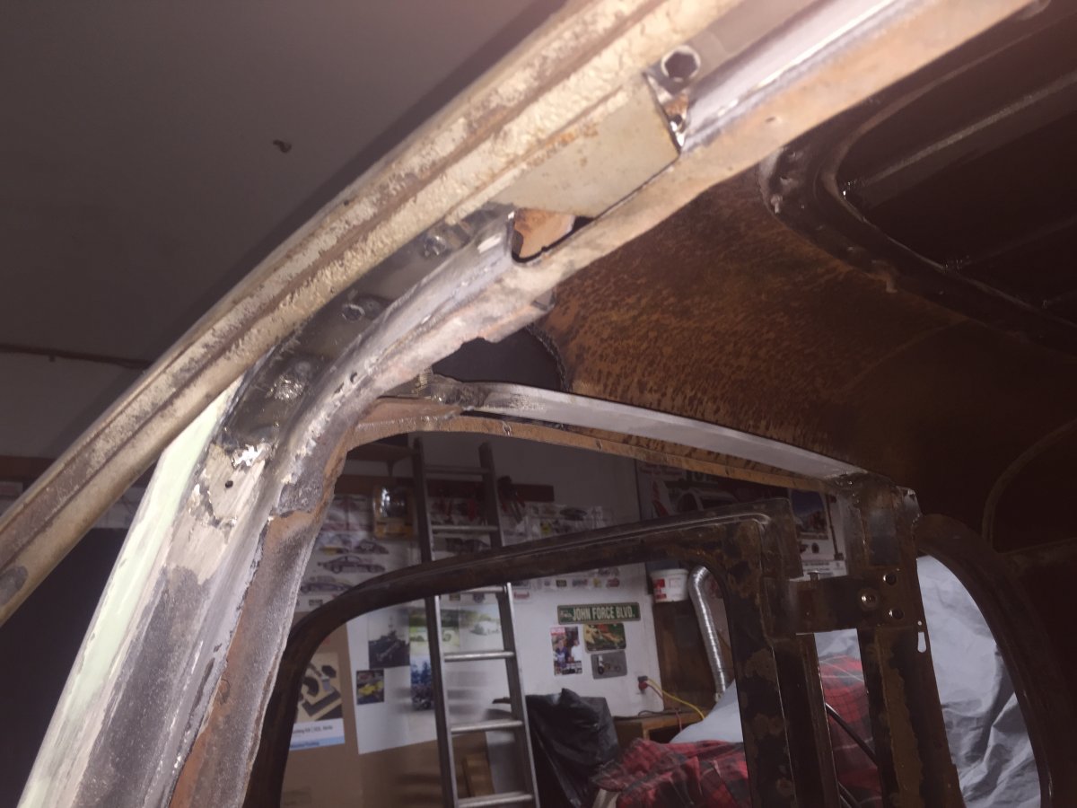

  29. How did you address it?
  30. MR CLEAN
    Joined: Nov 25, 2015
    Posts: 104
    MR CLEAN
    Halibrandsteve, I addressed the large gap between the original '34 windshield frame and the roof line by test fitting a 1/2 inch down piece of 20 Gauge Steel from Roof line. Then used Metal Brake to bend 20 Gauge Steel piece 3/8 inch inside and drilled inside holes so piece can be held with bolts. Then cut out 2 slots for inside '34 windshield frame brackets. Finally, welded test fitted 1/2 inch down piece of 20 Gauge Steel to Roof line and bolted metal piece in place and the results are pictured below.
