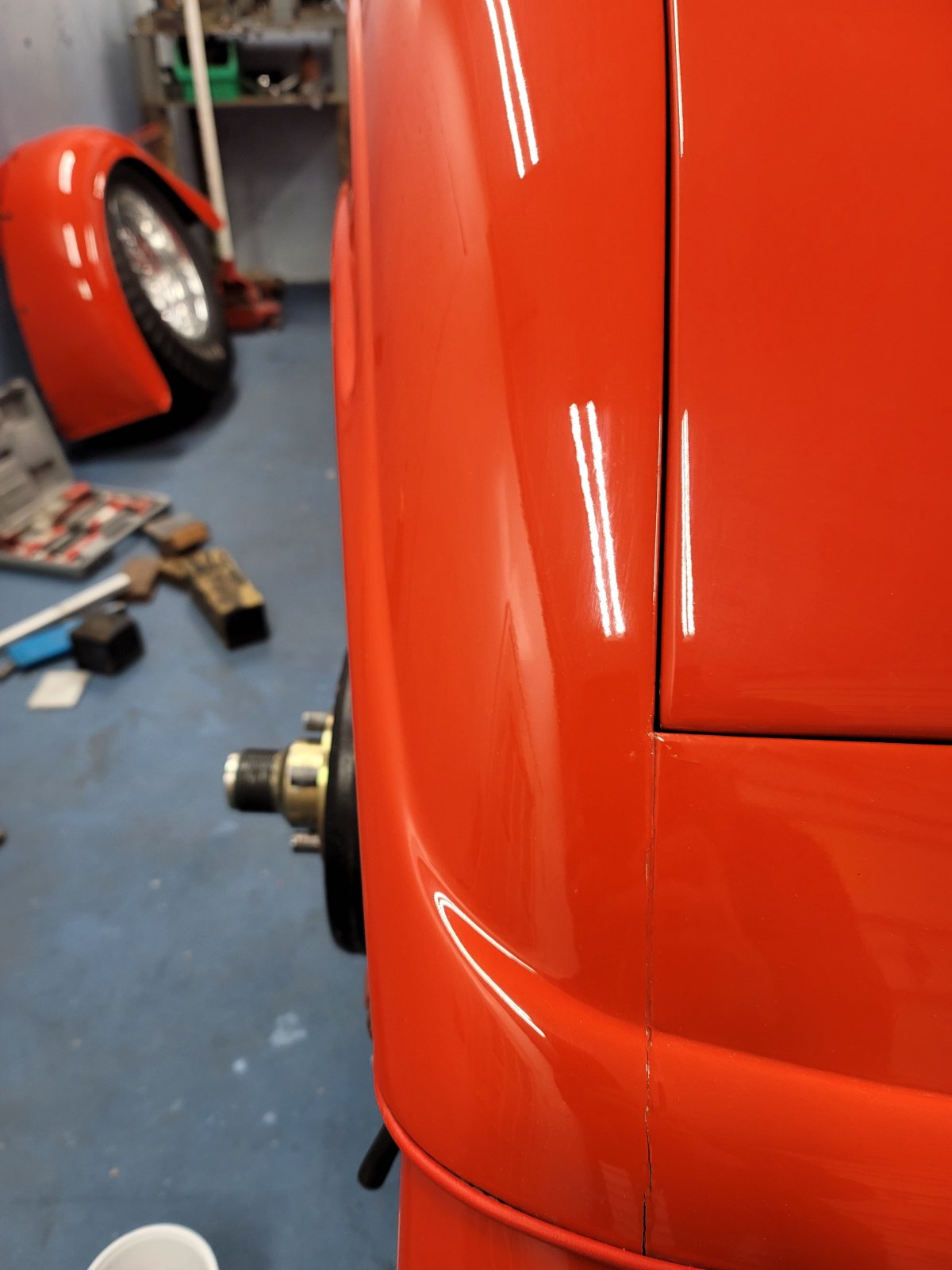

    This past spring we were on our way to Deuce days in Victoria B.C. when we hit rain and standing water. Those Firestone cheater slicks didn't like it. Went side ways into a median. Wasn't going very fast, but on the median was a reflector mounted on a piece of steel. It broke off after the running board hit it. Running board folded up and put a dent in the door. So I'm going to repaint the car.
    Pretty much have the dent in the door out but there is damage on the quarter panel that I can't get my head around. The fender was not hit and has no damage. One section of the quarter lower reveal either has been pulled down toward the wheel well or the quarter has been pushed out in that area. Ideas, help!?
  2. Side angles of the quarters. Damage on quarter about where reflection of axle spindle is.

    board pulled the fender that is mounted to the quarter panel.

    For an experienced professional, probably 45 minutes. . . . . For me, 8 hours

    Best place to start, is sand the paint off so you know exactly what's under there. Might be bondo that you could remove and do an even better job than the previous guy. Or maybe you find Henry Ford black under there and can see the actual dents and creases caused by the sign. Won't know what present you get til you open the box.

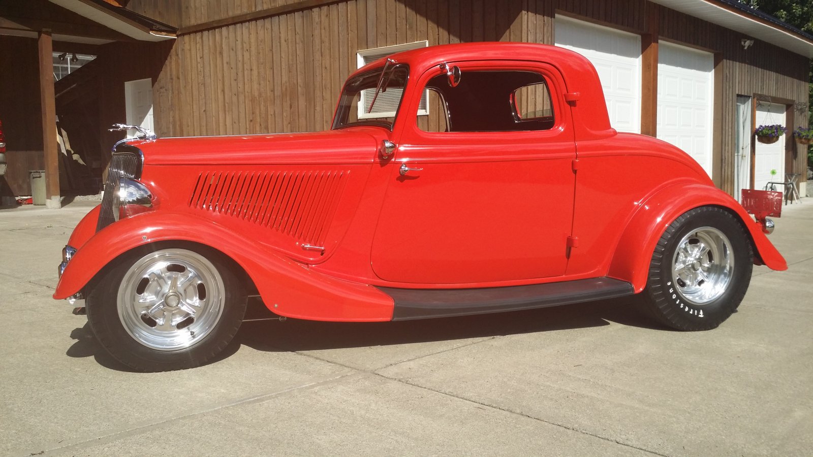

  7. So to be clear the quarter never took a hit, just the running board. Obviously a tweek took place from the quarter through the rear fender to quarter. Fender doesn't have a mark on it. Picture is of the car before it was painted in 1990.

    Oh man that was so near perfect before all the work got done to it.
    IronFord, HSF, Blues4U and 3 others like this.
  9. What I liked about it was that other than the roof being filled the body was left stock. side.jpg

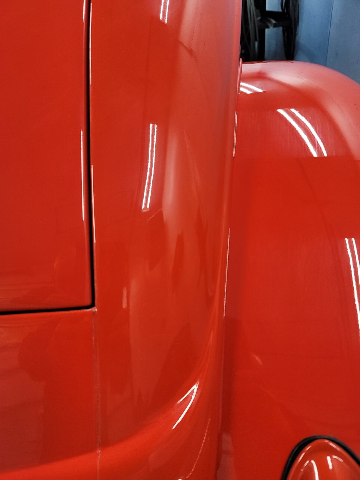

    Other than the running board is toast there seems to be little damage. I have the door dent gone, its just the quarter that has me stumped. I have noticed scrutinizing the car that he quarters don't seem to be symmetrical.
    Looking at the outside body line near bottom of the trunk the drivers side is more rounded. I never noticed it before but since I have seen other cars with the same issue. Is there a fix, its the way they are, thoughts?

    The computer that scanned the clay model must have had a glitch, and when they CNCed the stamping dies nobody noticed the discrepancy at the plant.

    Before any body work is done, you need to bolt the Rear fender back on, then the new running board and then the front fender. This will allow you to check fit of all panels that will meet up on the side of the car that may or may not need adjustment. I'd say what you have is when the running board folded up, it pulled on fender which may have pulled out the quarter a tad. It may or may not have done any damage to the steel, fitting all the panels together to check fit will tell, but the flex of the pull on the quarter may have only just been enough the crack the paint and make it look worse than it actually is.
    As far as these cars being perfectly symmetrical side to side, they are not. There pretty close but there not exact. Every panel was fit by hand by a guy whose job it was to fit jus that fender and running board perfectly in just a few min of running down the ***embly line, so he knew what he was doing. My own 39 Sedan has over an inch of difference in the rear fender depths from wheel well to fender lip between the p*** and driver side, and these are the original paint original fenders to the car. So they are far from perfect.
    But if the fenders and running board all line up and gaps look good you are probably just fine to repair and repaint.

    Wow. I love the 1990 pic it had so much potential for a cool old hot rod. Personally i think the then owner did the car a disservice by putting it on a kit ch***is and making just a regular sbc powered street rod just like thousands of others.
    rpm56 and warhorseracing like this.
  24. Wow. I love the 1990 pic it had so much potential for a cool old hot rod. Personally i think the then owner did the car a disservice by putting it on a kit ch***is and making just a regular sbc powered street rod just like thousands of others.[/QUOTE] I hear you. Times change, we change. Looking back it would have been awesome to leave the paint that was on it.
