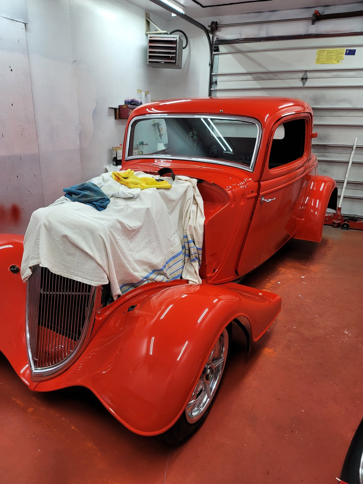

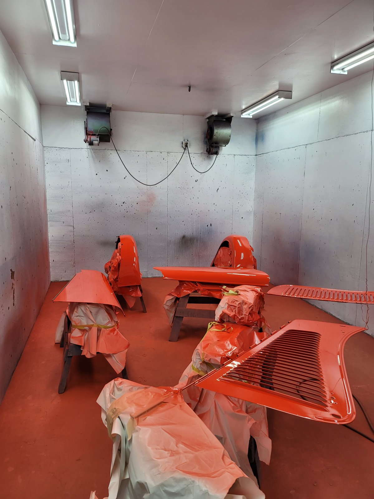

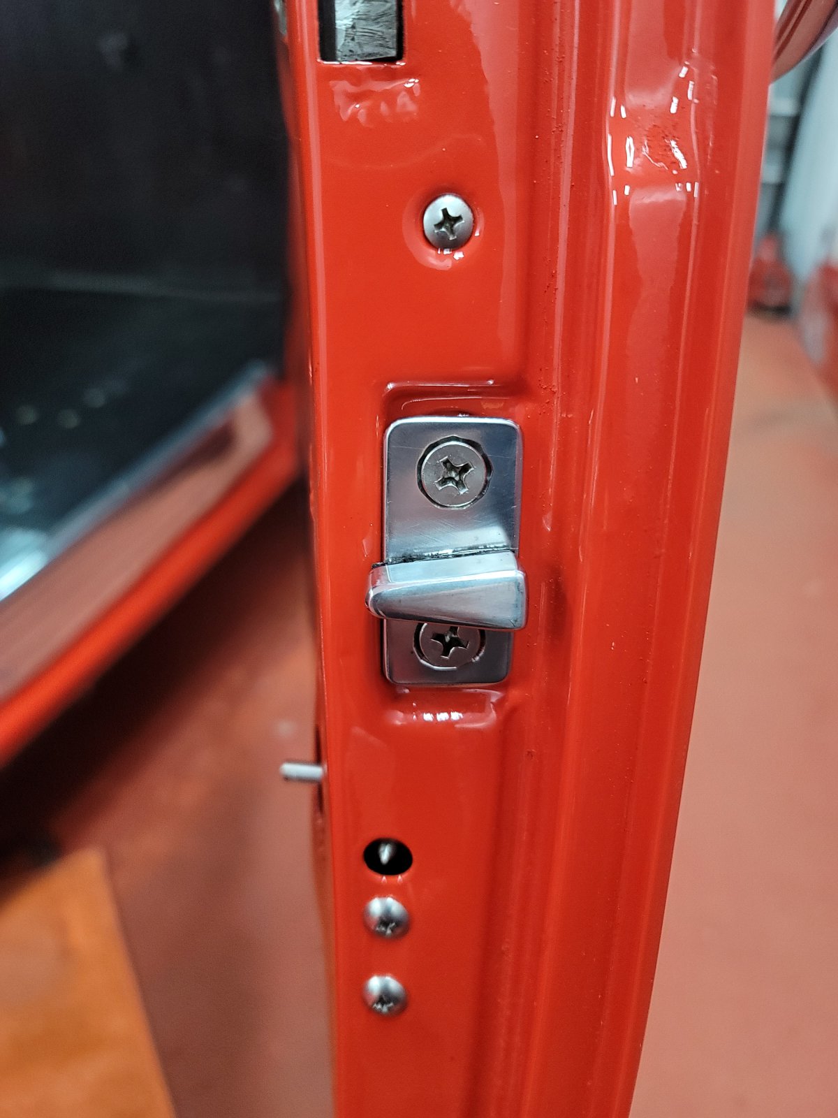

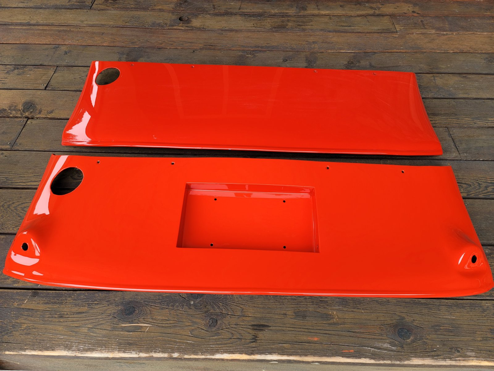

  20. Progressing. Been colour sanding/polishing and ***embling panels. When I bought this car it had bumpers. I ran without them and had bought and painted a gas tank cover, Howel I think, without bumper holes. As mentioned in previous posts I have been fighting with making bumper holed panel fit properly. I have decided to buy a new stock panel. I was really not liking the recessed license box anyway.
    Hot tip: After washing my polishing pads it is hard to get them dry this time of year. Heated towel rack works really well. Lol

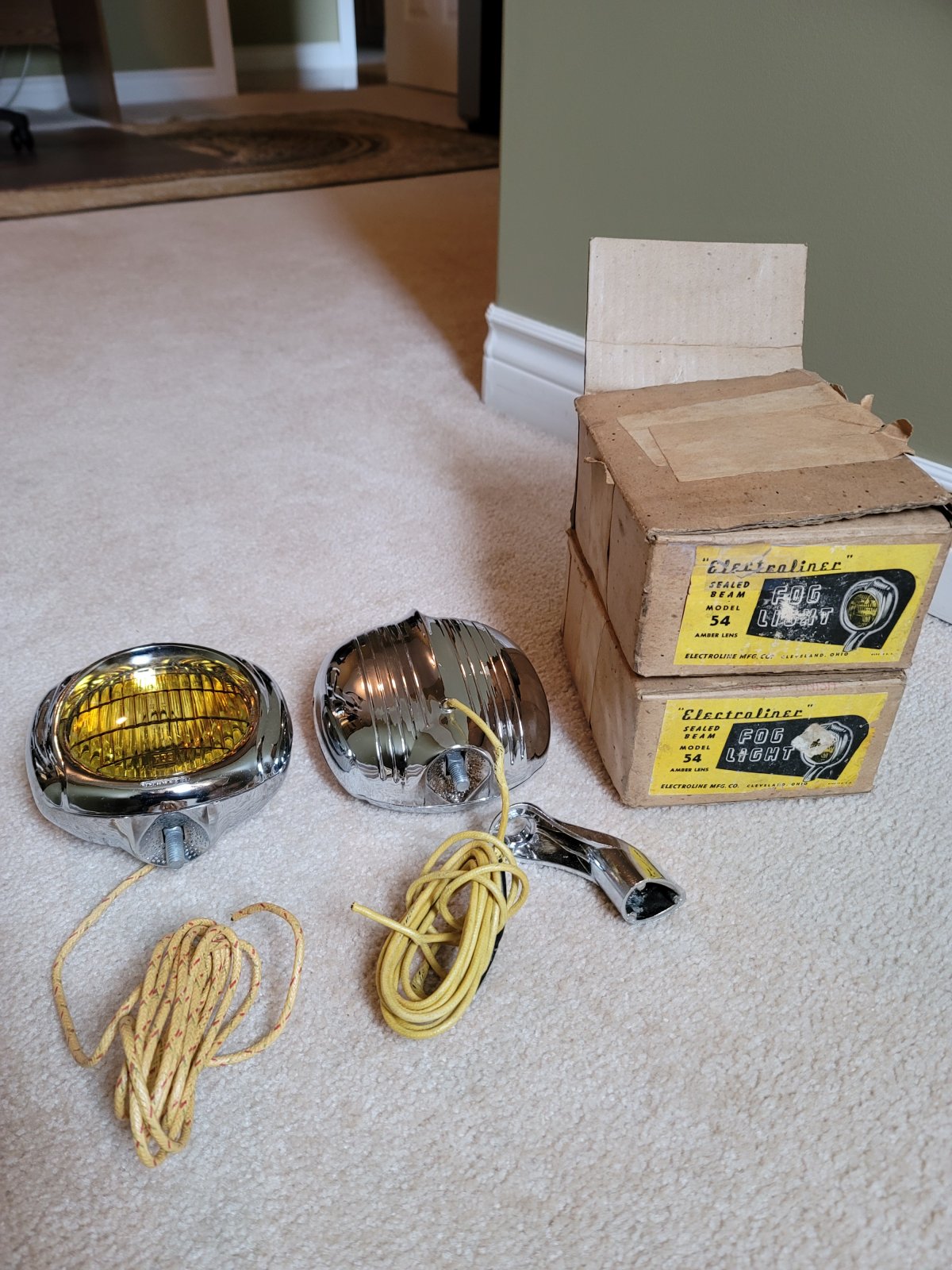

  21. I have a "thing" for vintage fog lamps. Have a pair of Marshal Fantastic lamps on my Tourliner. I have had these Electroliner's for sometime. Their going on the 34.
