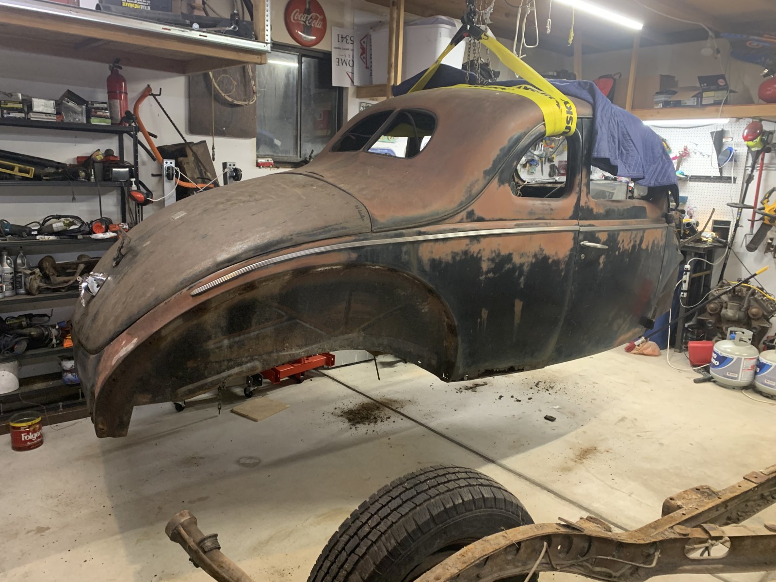

    My brother and I held up shell in my avatar while his son rolled the ch***is out from under and placed a couple sawhorses.

    Thanks guys for all your help. I think that I'll just put 2 4x6's across the trusses and hang it from there front and rear.

    I added some 2x4 bracing to the rafters in my garage to hang my 40 body. Then just a 4x4 across said rafters with a chain hoist hanging from it. When all was said and done, I don’t think the bracing was necessary but it made me feel better about it. I’d guess my 40, with trunk and doors was about 400 pounds.
