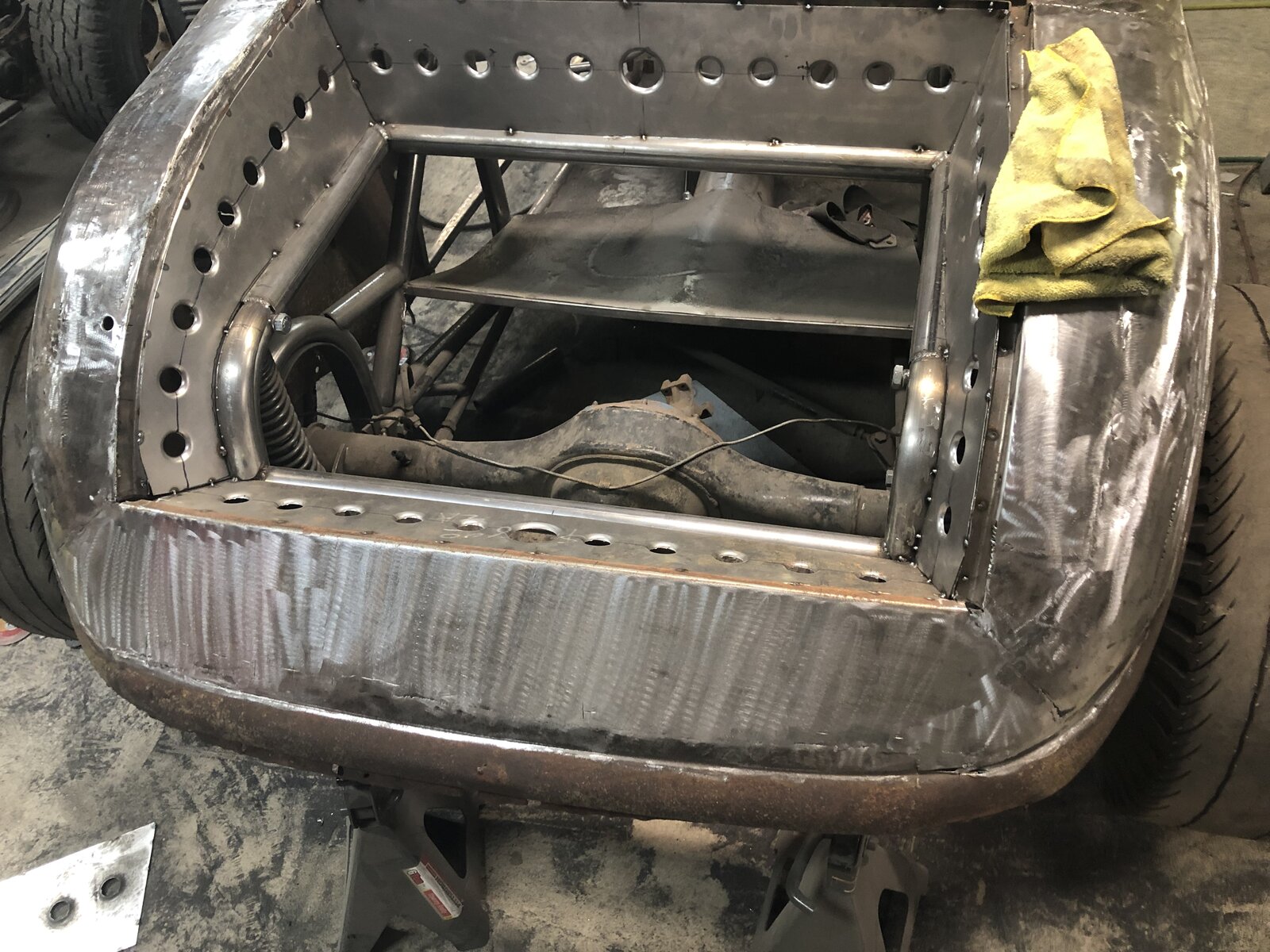

    JimSibley
    726F3040-89B7-4C85-A568-A1CB8017112F.jpeg Just a little update. Holes, holes and more holes.
  17. Stogy
    Joined: Feb 10, 2007
    Posts: 26,948
    Stogy
    Holey Schmoly...Your updates are very inspiring Hotrodder...awesome work Jim...;)
  18. Atwater Mike
    Joined: May 31, 2002
    Posts: 11,618
    Atwater Mike
    Jim, have you a wall thickness on that wavy Plymouth axle? Mine sounds (and weighs) thinner than my wallet!
    loudbang, Stogy and Thor1 like this.
  19. JimSibley
    Joined: Jan 21, 2004
    Posts: 4,004
    JimSibley
    Not mine. It weighs a ton! And , when I altered it I was welding on my highest setting and it penetrated like crazy with no blow through.
