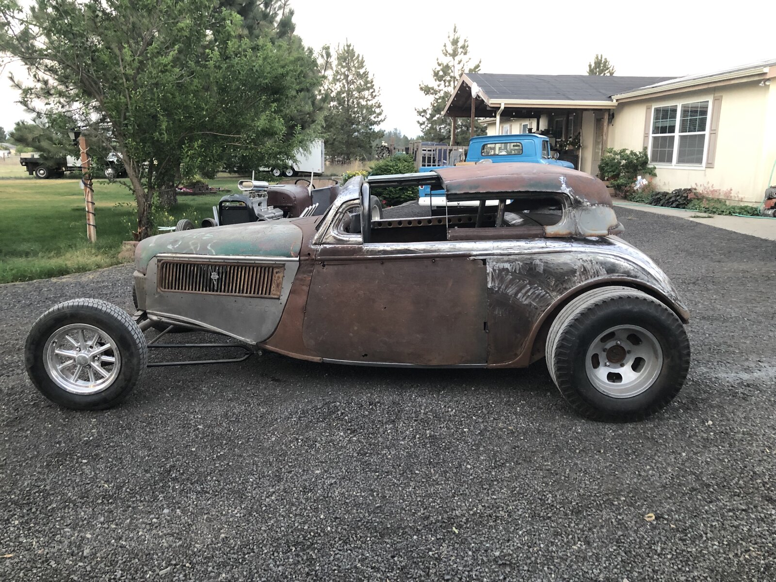

    Love your vision on the roof. Im sure you will work out any kinks with the mechanism. Have you tried getting in without a stepladder? :rolleyes:
    Thor1 and loudbang like this.
  2. Peanut 1959
    Joined: Oct 11, 2008
    Posts: 2,188
    Peanut 1959
    The main thing I can think would be a concern with the sliders is that they'd have to be 100% parallel. Not sure if your ****pit is tapered or not.
    loudbang and Thor1 like this.

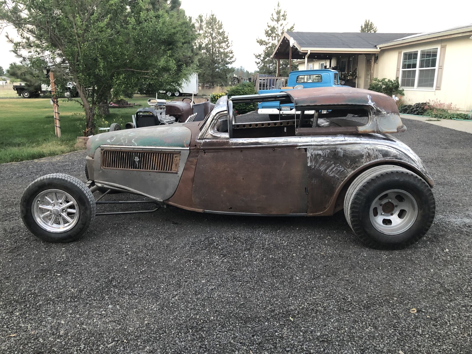

  3. JimSibley
    Joined: Jan 21, 2004
    Posts: 4,072
    JimSibley

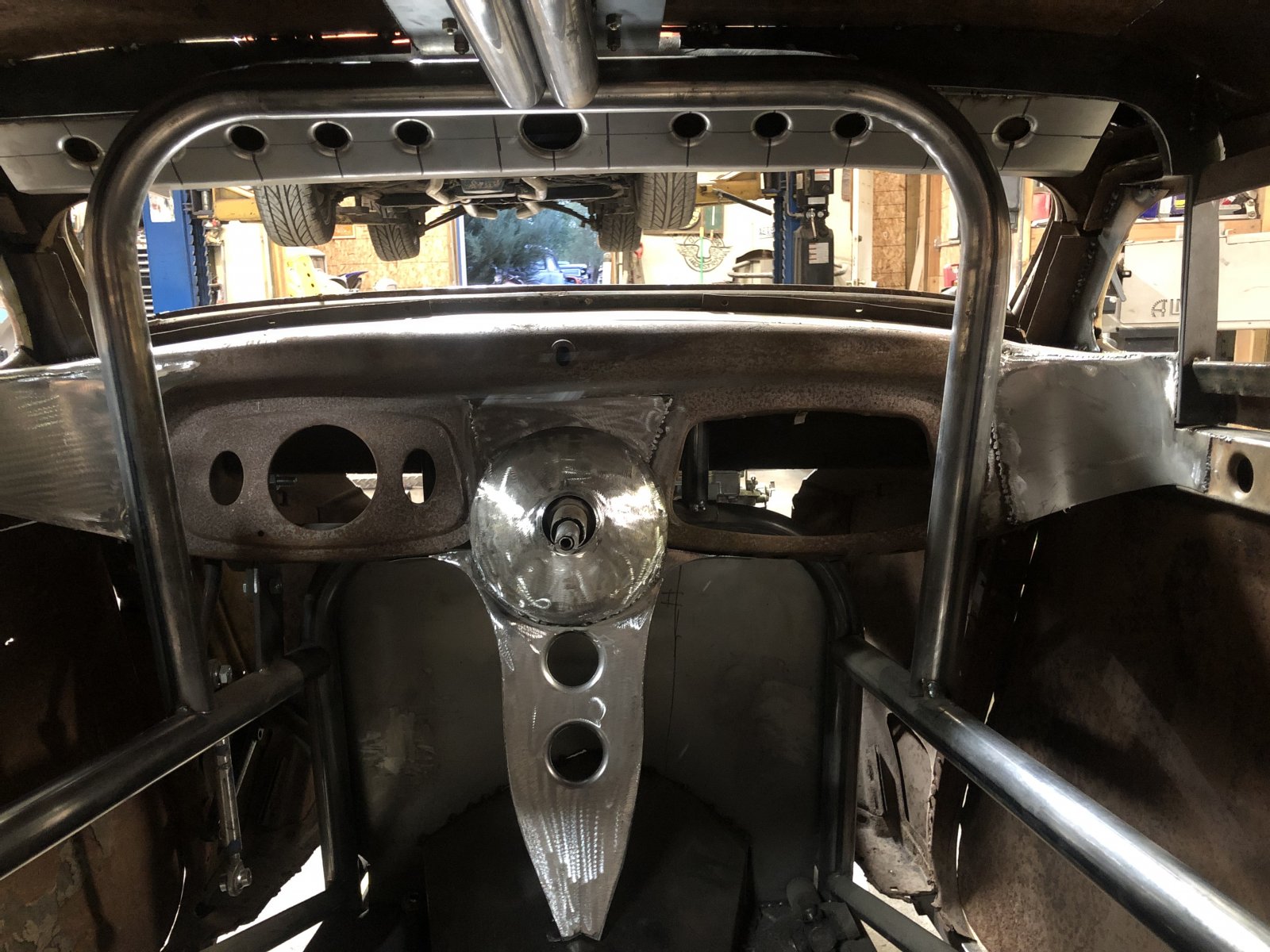

    B46BF529-CF06-45BA-B4EC-0D504B69F43B.jpeg It’s pretty low. I can hop in over the door pretty easy. I’m not above putting a couple of foot wells in the side if it needs them. As for the tapered ****pit, I am fighting that fight right now. The cage is pretty square, I might attach the roof to that instead of the body. One good thing about building outside of the box, there aren’t a lot of rules!

  5. JimSibley
    Posts: 4,072
    JimSibley

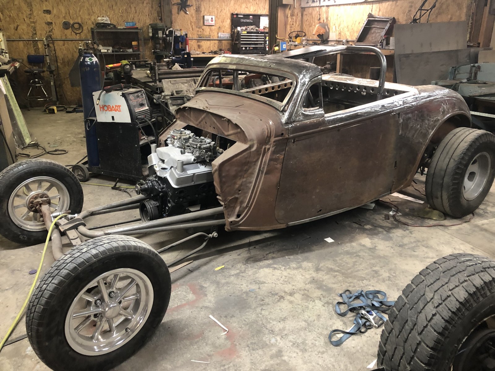

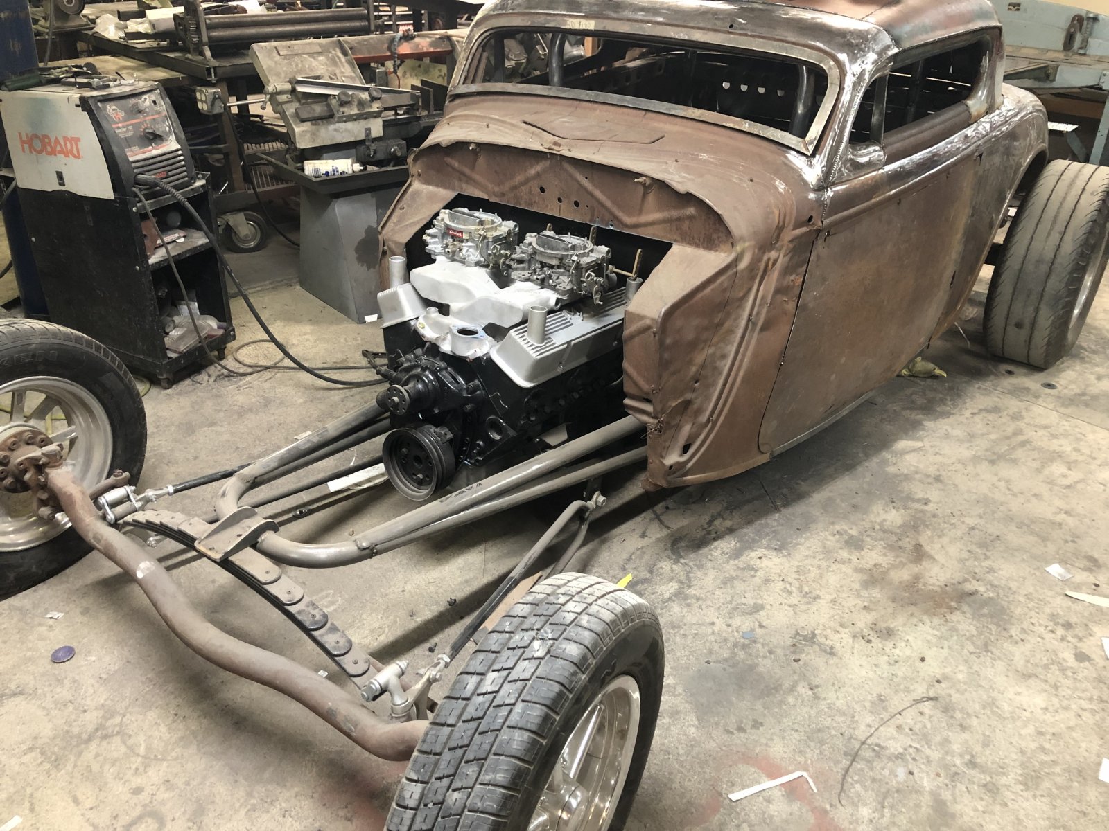

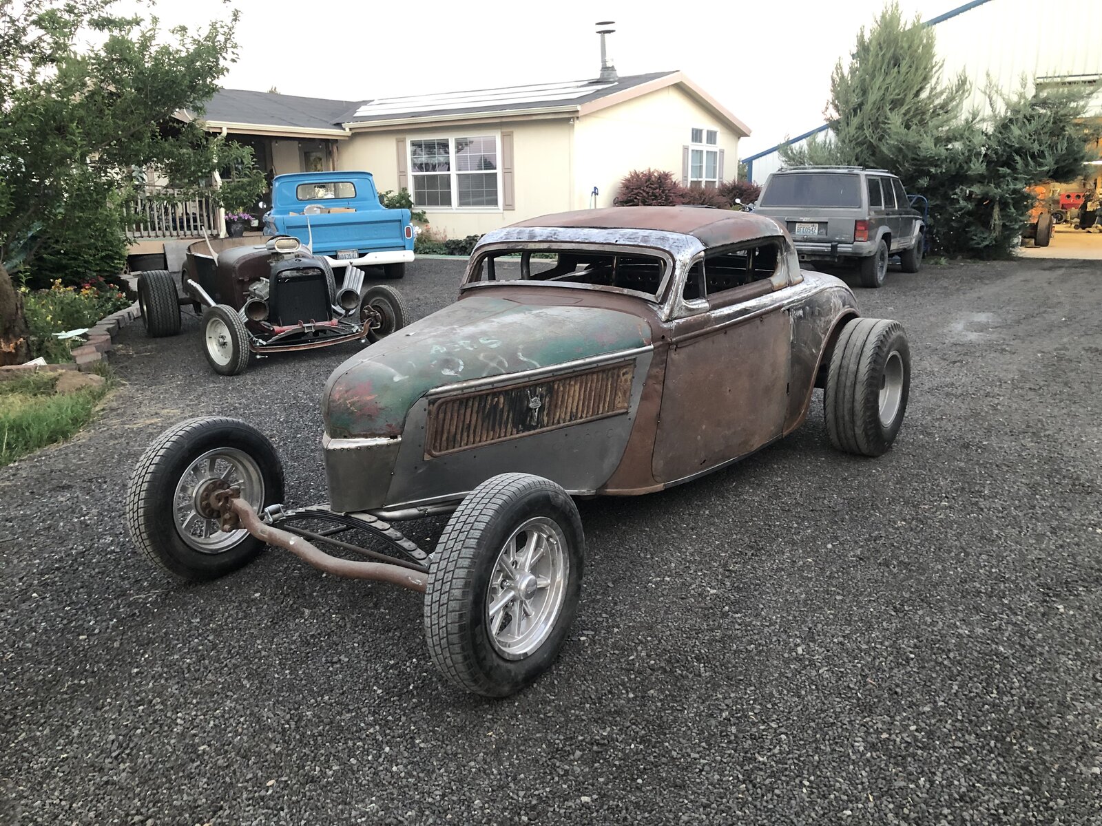

    Well, it works. I got the roof to slide. Still needs work, but I know it will work. Took the car outside for some walk around shots, and so I could clean up the work space a little. 0374C196-5B68-43E9-818B-D9DAEB114FB1.jpeg BD72D00D-56F1-4131-968D-E6042B3962A9.jpeg 91E54CA3-6B5C-4086-AC7D-9799C8A58F3D.jpeg 052C7593-B114-45FB-940E-4D65E5B9EBBB.jpeg

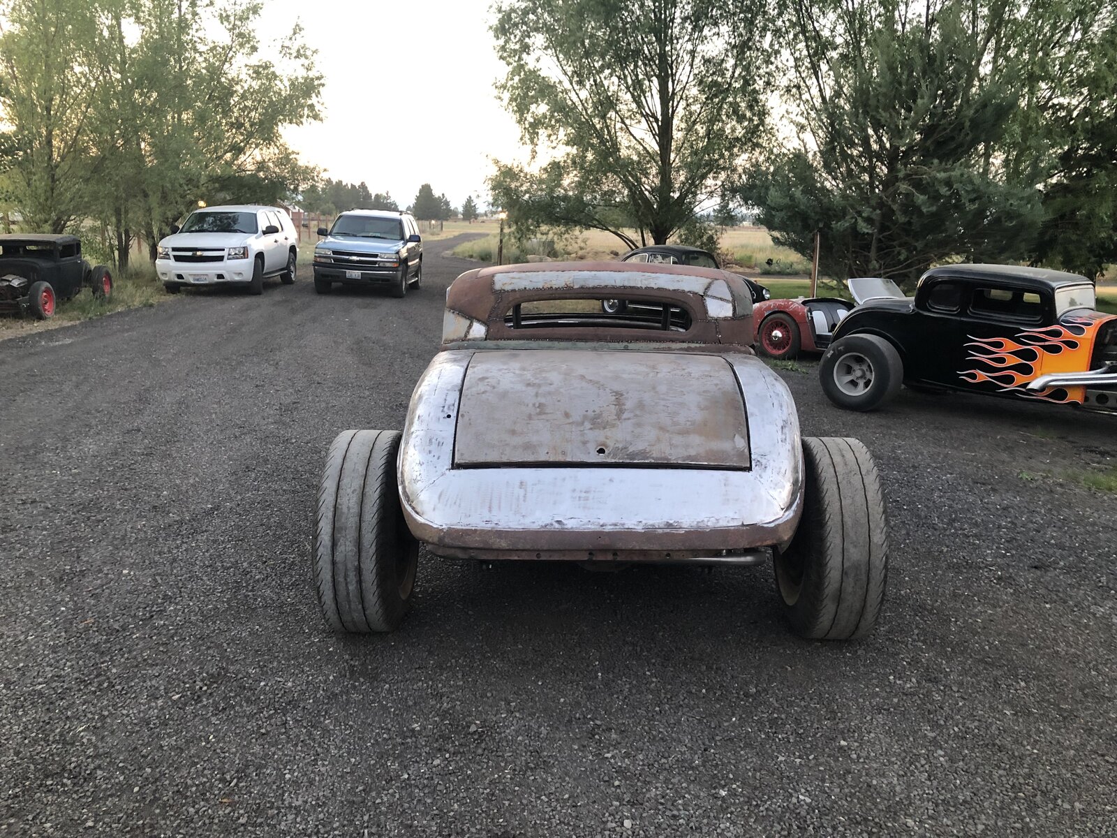

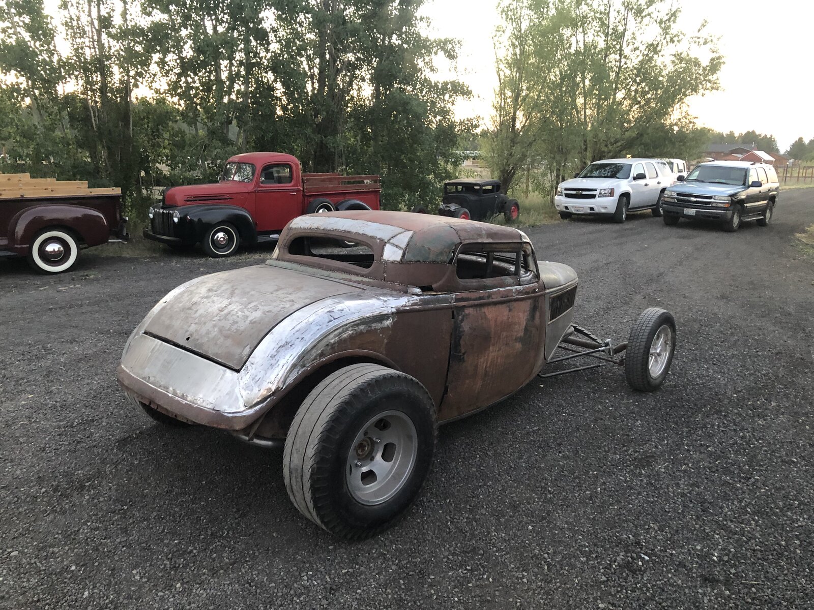

    A couple of overall shots, just because. C193D3CE-D41C-49A8-BF12-24C9E60DDEA6.jpeg 1FB55A6C-8936-4015-8DD2-5F910144D747.jpeg F3962A57-E86A-4558-AAFA-04E124961CAA.jpeg

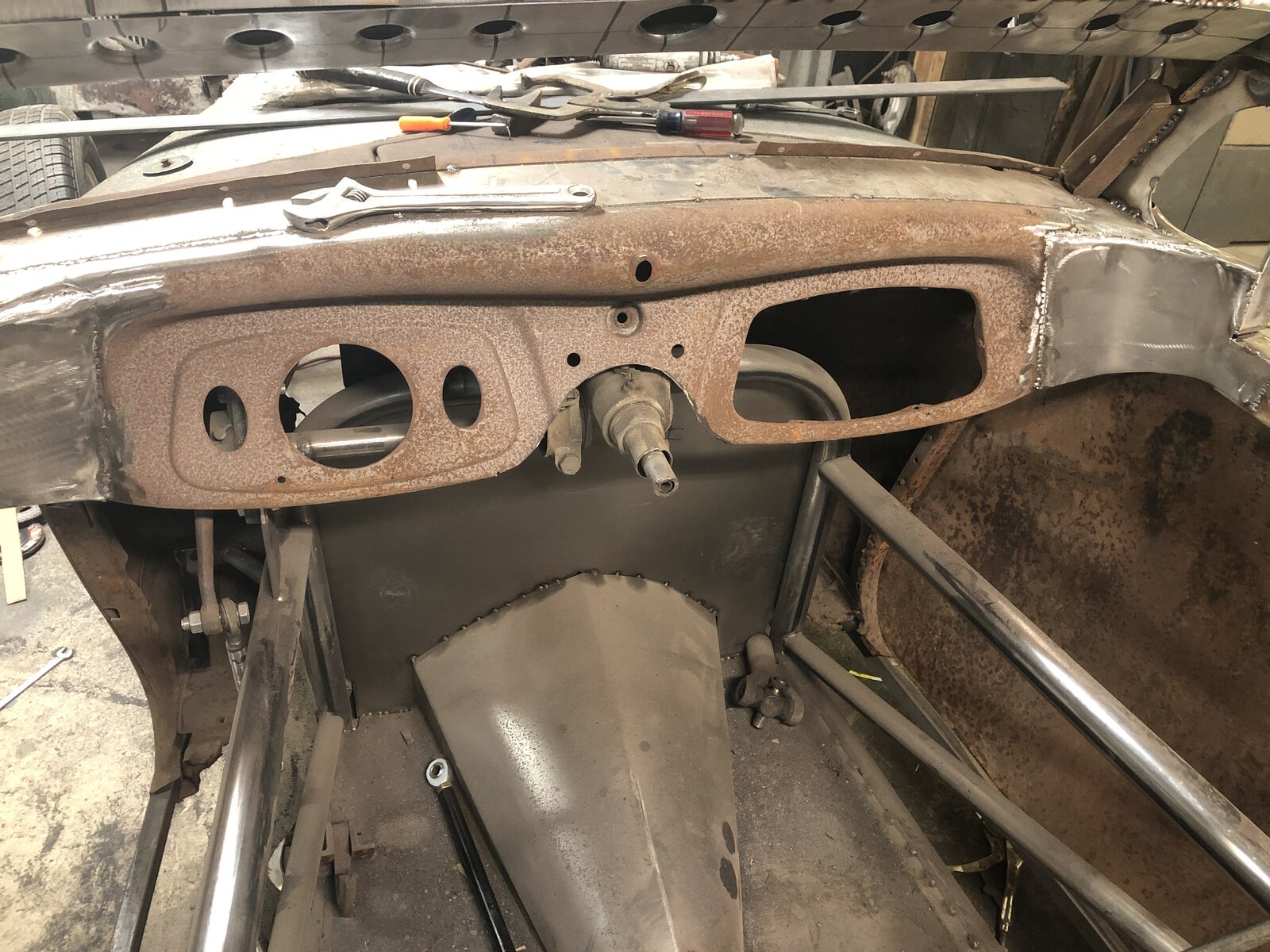

  13. JimSibley
    Posts: 4,072
    JimSibley
    70F6C994-36C5-4BBE-BFD5-B1C1D1731456.jpeg 12E243FC-FC78-4490-B45A-3A555E82BECD.jpeg A little interior work. I’m thinking a center console full of gauges. This thing is so fun, I love building from junk, nothing to lose and I can be as freaky asi want .

  14. JimSibley
    Posts: 4,072
    JimSibley
    I took the hood off, i forgot how far back this things motor sits. Oh yea, and a little more interior work. 3B05080B-812D-435B-9D19-FF0AEA2F5390.jpeg F2D72B93-A2BD-4B43-AAA8-967E8C41340D.jpeg

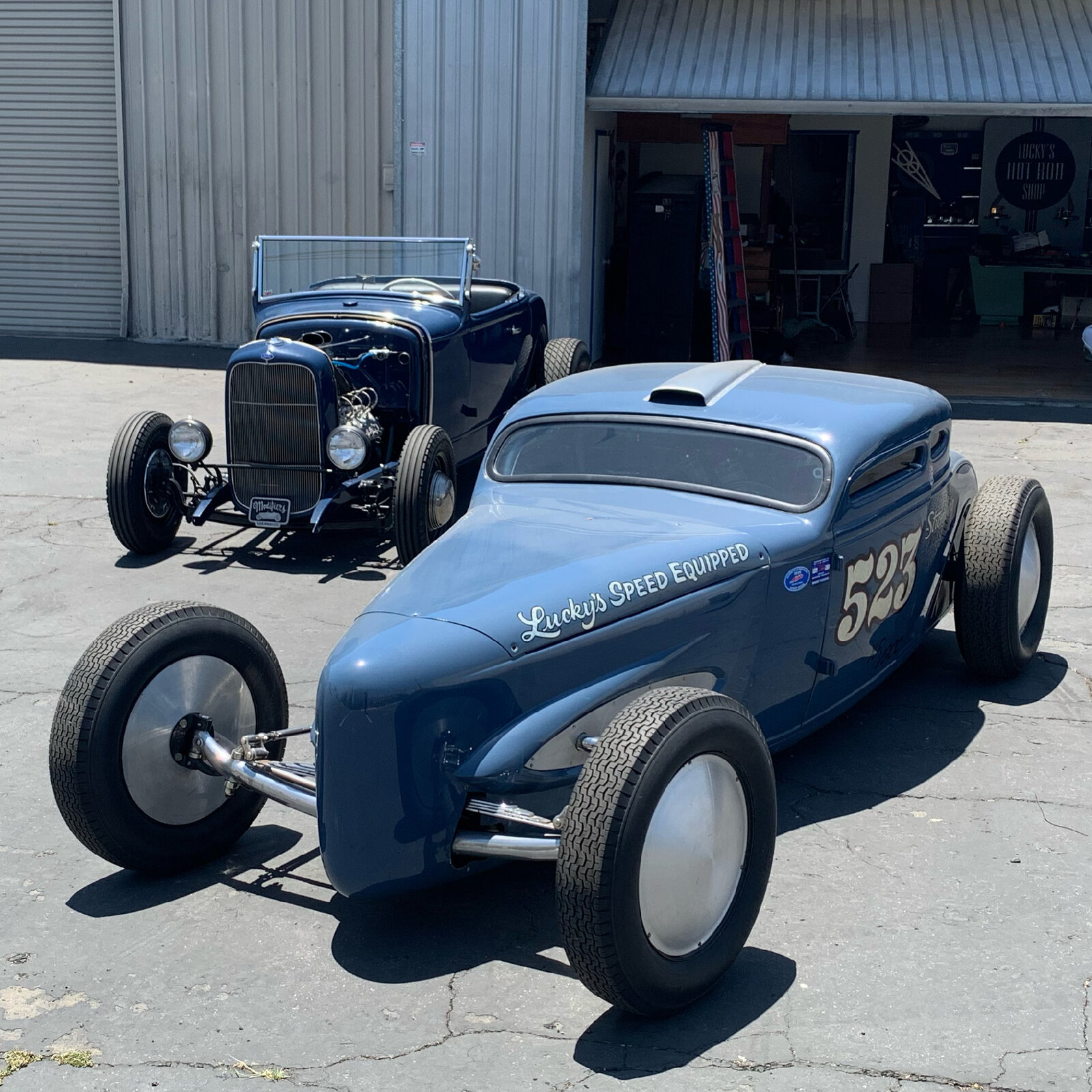

  18. No doubt about it, under your care the hood and body make a great match. I also liked how the body and frame are joined. Art and engineering in the same project, nice work, thanks for sharing. Hagery drivers club issue 64 has something similar on the cover. I read the publishing restrictions and don’t think I can ad a picture, without permission, but a simple search brings it up. I still like yours better, the wavy Chrysler front axle, the hood, the rear end finish, so very cool. Looking forward to see what you do about lights on all 4 corners, enough for now.

    Hamber @Lucky Burton I'm going to go out on a limb and ***ume is the Owner/Builder of the Hotrod you speak of...and he has a build thread...I can easily see that influence you see in Jim's Hotrod...
    https://www.jalopyjournal.com/forum/threads/lucky’s-speed-equipment-coupe.1161066/
    :rolleyes:...this is a summary Thread which has links to his Build Threads of which there are 2...
    https://www.jalopyjournal.com/forum/threads/race-car-and-street-car.1232426/
    :rolleyes:...Inspiration is a beautiful thing...with Lucky being inspired by the Chrisman's Coupe of the 1950s...
    https://www.jalopyjournal.com/forum/threads/the-chrisman-coupe.318287/
    Credit to Photographer, Owner

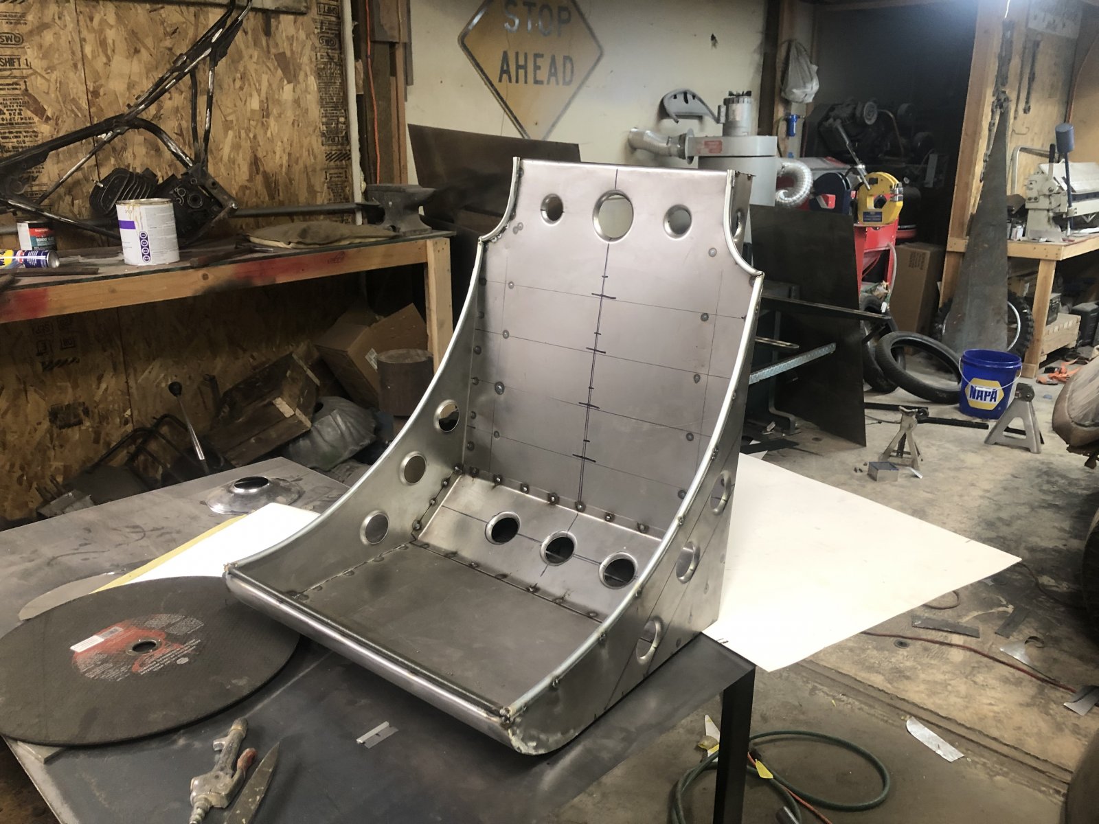

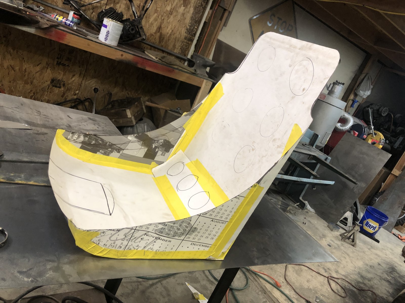

    I spent the day with some water damaged old calendars from a local club, building a low budget bomber seat. After the paper seat was fit to the car, i recreated it in 18 guage steel. Im pretty happy with the end result, and again, it was all made from stuff i had laying around. 02562D9F-E122-403A-87DA-D5EB80E08105.jpeg 445DD819-7063-45A8-9B5C-5B39A8BFD42F.jpeg 726344B1-177A-4EC0-AA31-877AD26E6DDA.jpeg D4591EB4-78C9-4909-B09C-6BC7688EA8F1.jpeg

    There's a seat fit for a parachute...Templates, a Builders best friend...looks real good @JimSibley

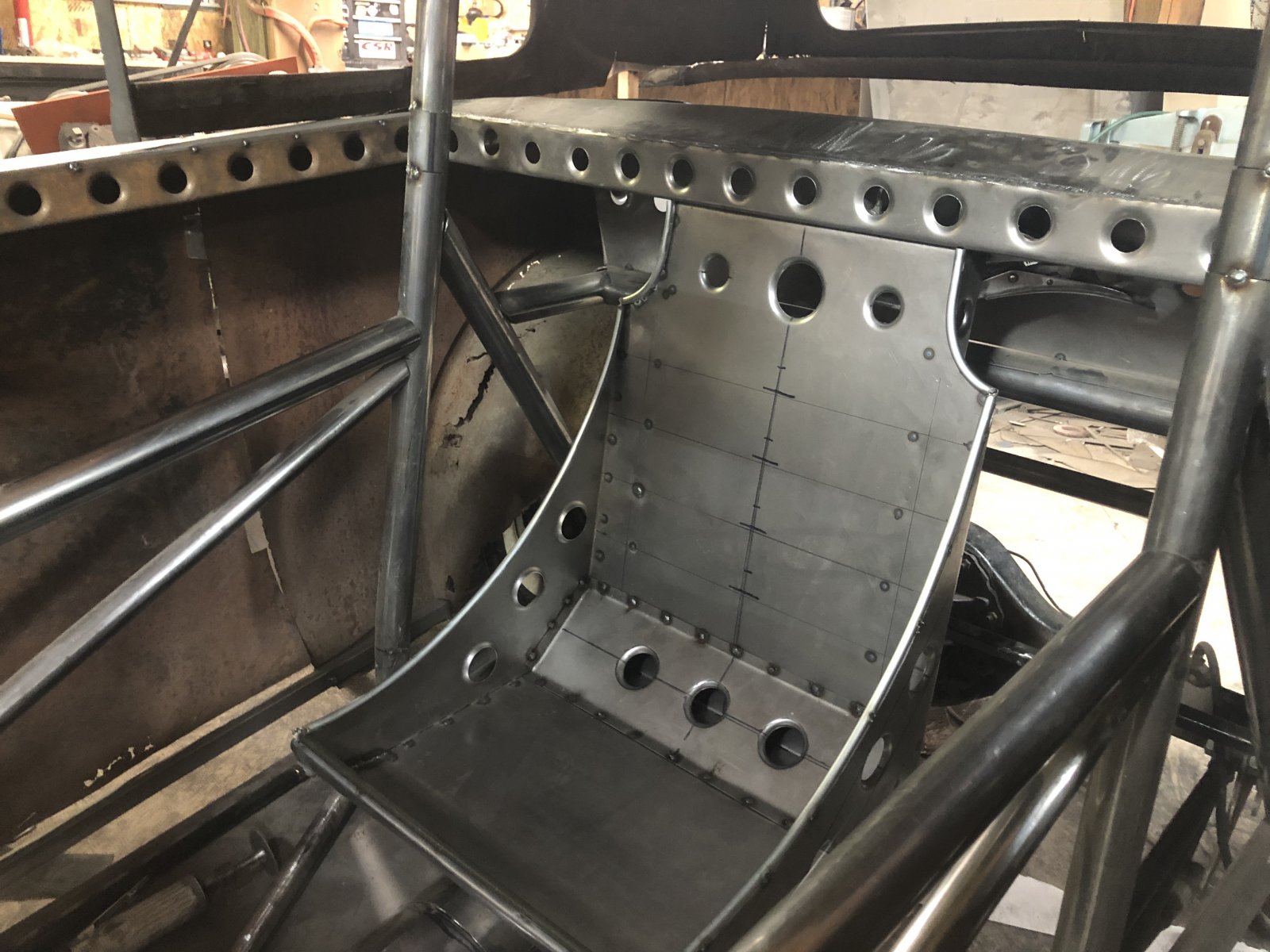

    Started building the actual floor sections. Man, its a lot harder when you cant just open the door. I have to climb in and out 100 times a day. Took the roof off, which made it a lot easier. I kinda like it with no roof. Next, i need to fill in the gap from ch***is to body, im thinking of making a bunch of spars, like a plane to keep it rigid, and then just build bolt in filler pieces from the ch***is to the bottom of the car. In the last pic you can see my first attempt at a spar. It really helped make the car stiff, and it keeps with the airplane look. 627C2527-9340-4489-A58F-713349691A5E.jpeg 8FB8B675-EF85-4587-96B1-FC5BB976C3FD.jpeg 32D8325D-5059-4BEA-B291-EEBDB737C5DE.jpeg
