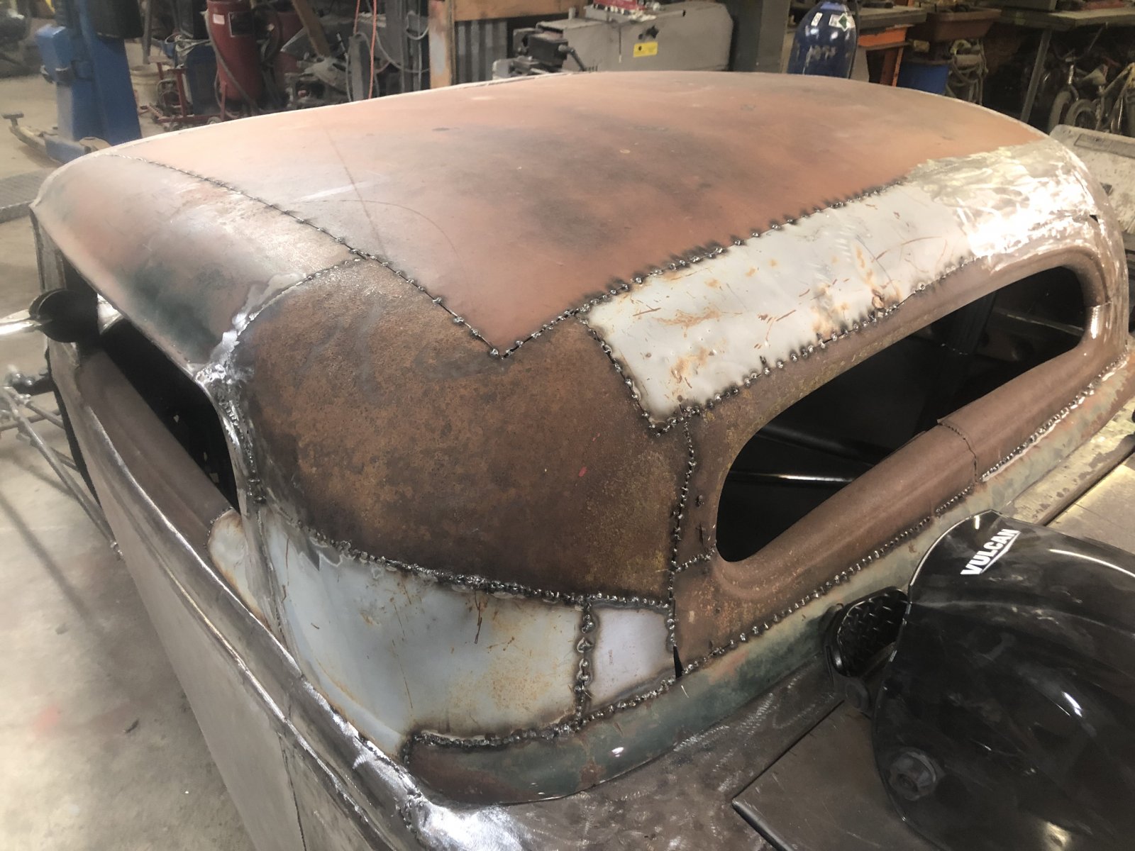

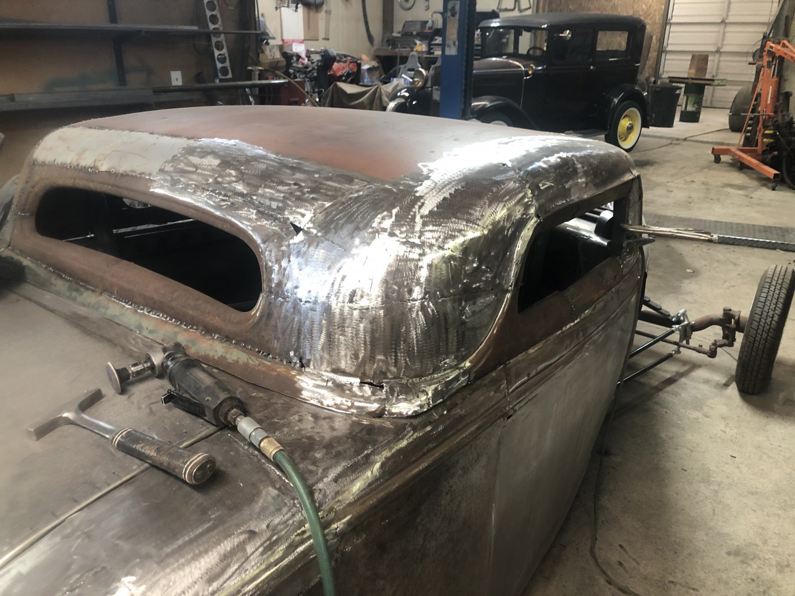

    And a little more quilting. This is getting a little old. I will be ready to switch to ch***is by the time this patchwork is done. 6E1C3CBB-3F5B-40BC-A02D-29CC76D4BBFD.jpeg 66C9AF7B-1C3D-49E7-9F48-9D5F85FB0171.jpeg

    I've referred to it as "Tetris" in the past, but I do like "quilting", I might have to adopt that term.

    To me,Tetris is the art of cutting and tacking the pieces together, while quilting is the never ending act of sewing all of the chunks together with a welder. Then come the fun of “decorating the cake.” Yhis consists of icing the whole car with a skim of bondo to get rid of weld lines. All of this is then followed by hours and hours of “ fun with primer”! It all sounds better if you make a game out of it.

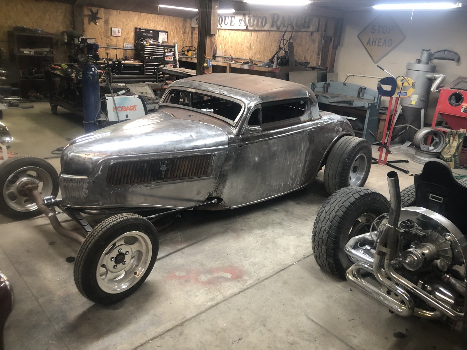

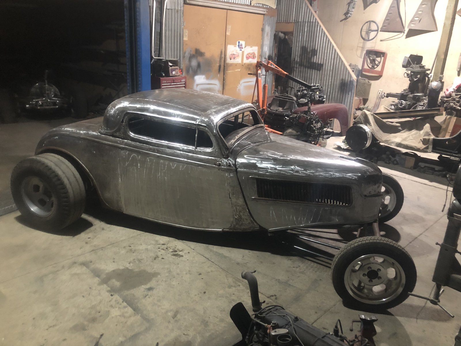

    I am convinced that a naked car looks as good or better than most things, naked. Lots of grinding and quilting, but its just about ready to dis***emble and make it run. First i am going to clean up the roof slides, and fit the decklid and hood better. FF29EFE3-070C-45B3-93D0-A3DAE90F3CFE.jpeg

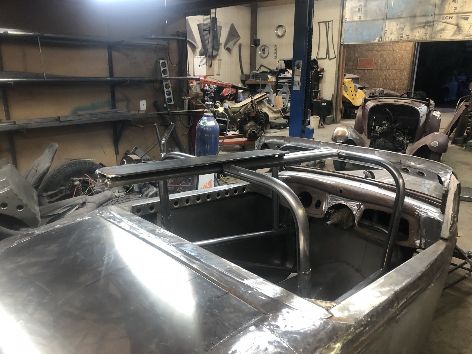

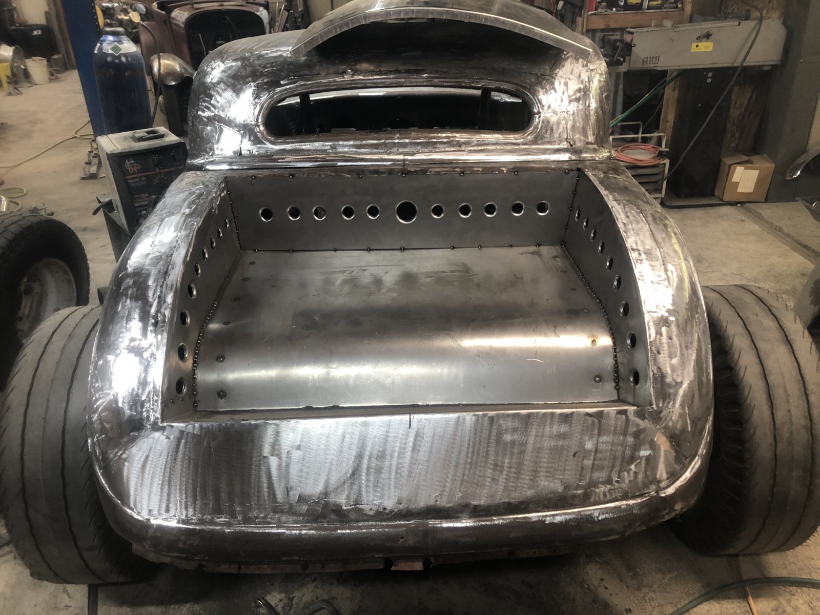

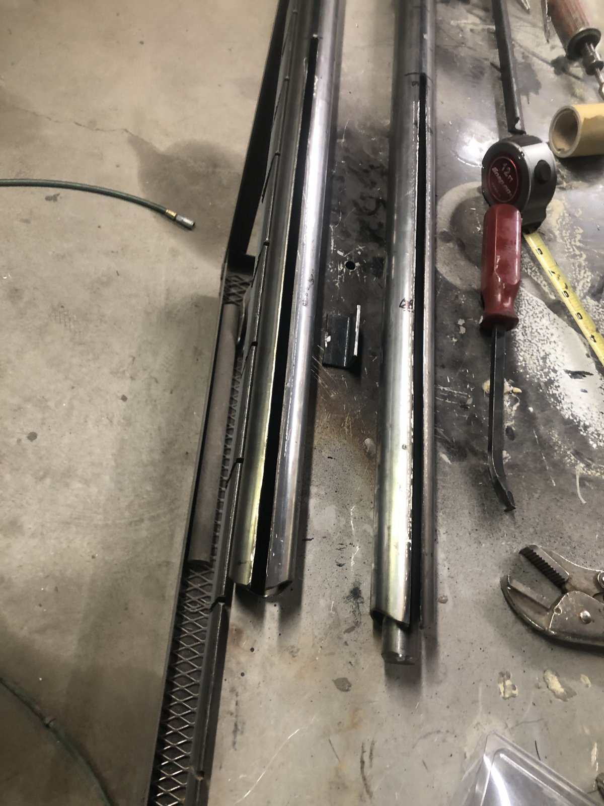

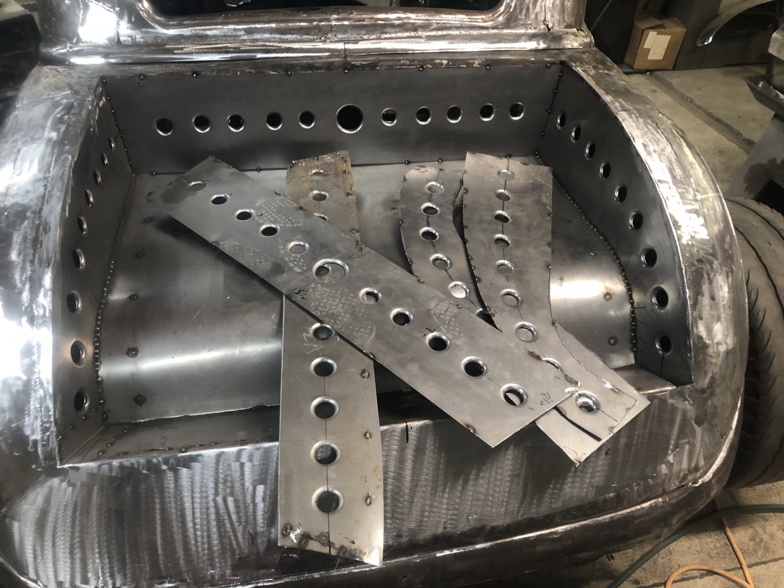

    350CF30B-A7D9-407C-AC38-3DE15D4231C2.jpeg 7223E142-2EE0-4D14-82A3-7DFBC51C9168.jpeg 14DDE868-0FDA-488E-A704-23D78D35DBE2.jpeg 6B8BE1EC-BA7E-437C-9E28-F974D27FA1D0.jpeg 34306660-EAC7-45D5-92D5-26191BDD0E57.jpeg 568F8E08-CCB8-444A-9F5E-47AEA1B1F792.jpeg 2F94A596-BA2D-4FEF-AD62-EC938C399254.jpeg Had a pretty productive labor day weekend. I replaced the clunky, bulky slide mechanism with a cleaner, home built set up. Upon finishing the slide, I made a few measurements to set the roof on straight. Everything was going great until i measured the trunk area and realized that it was 1 inch to the right of center. After a few minutes of trying to justify leaving it, i cut the back out of the car and rebuilt it all!
