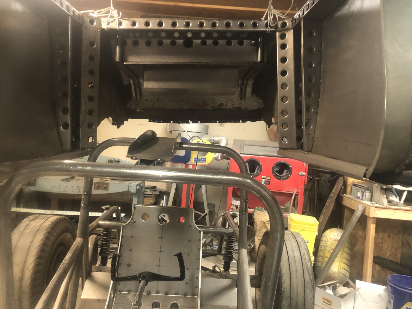

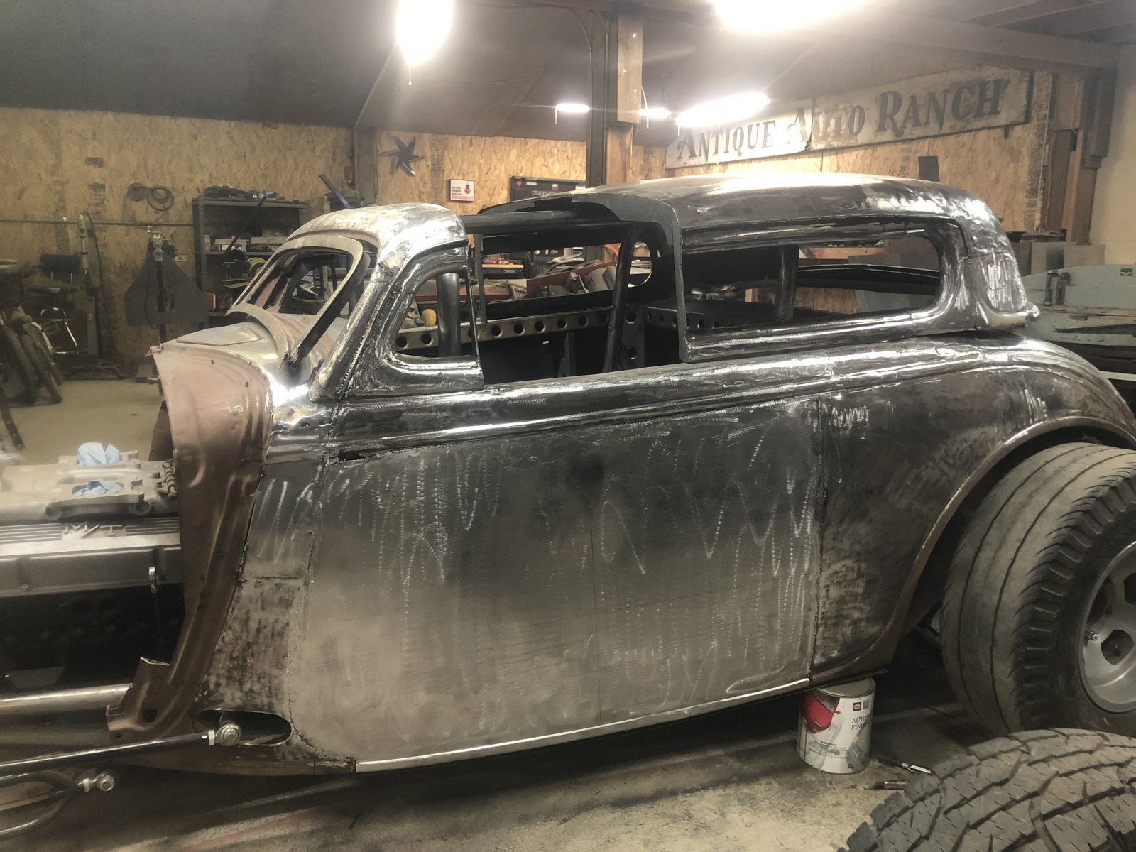

    The new slide, with no visible slide mechanism. I am so stoked that this worked. Now to line the hood up, hinge the decklid and tear it apart , so i can get it running! 0BD64289-ACDD-4CA7-9CC3-2E24C64BE0AC.jpeg E7E959A5-BD7C-49DF-A9D1-6819087562B0.jpeg C47ADBBE-6762-4C31-8499-A570C8C19653.jpeg 5286643E-FD2C-4C22-97E5-07FCA62E1FD7.jpeg

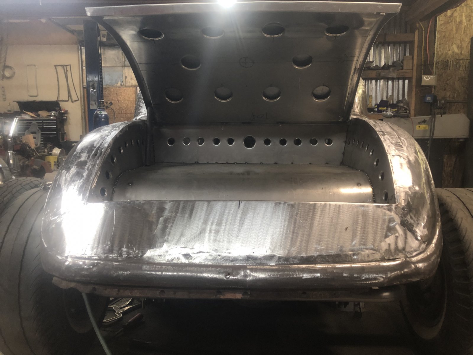

    Finally got the decklid welded up and hinging. I am pretty happy with my little

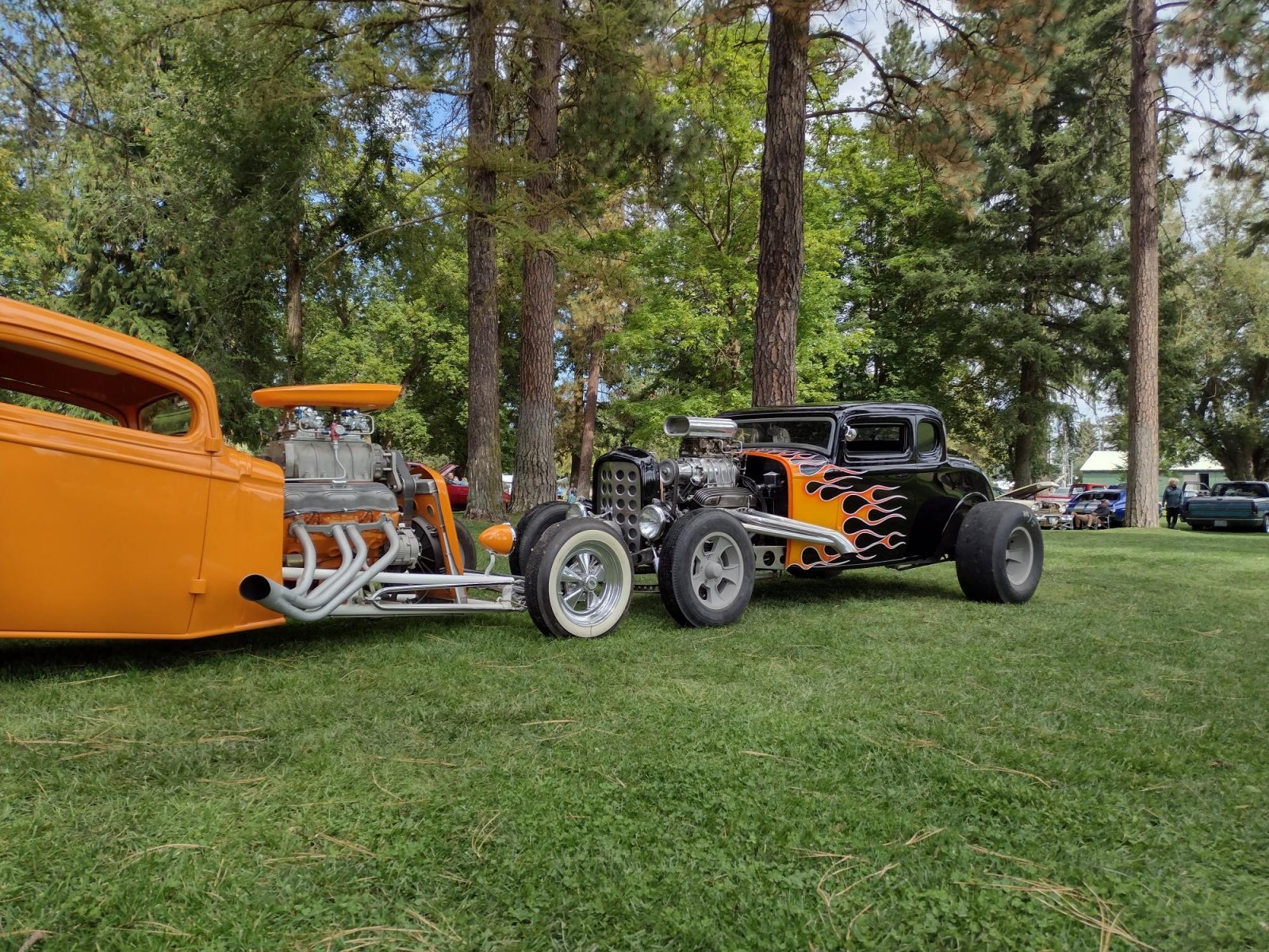

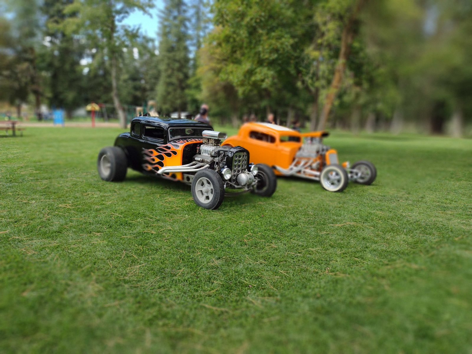

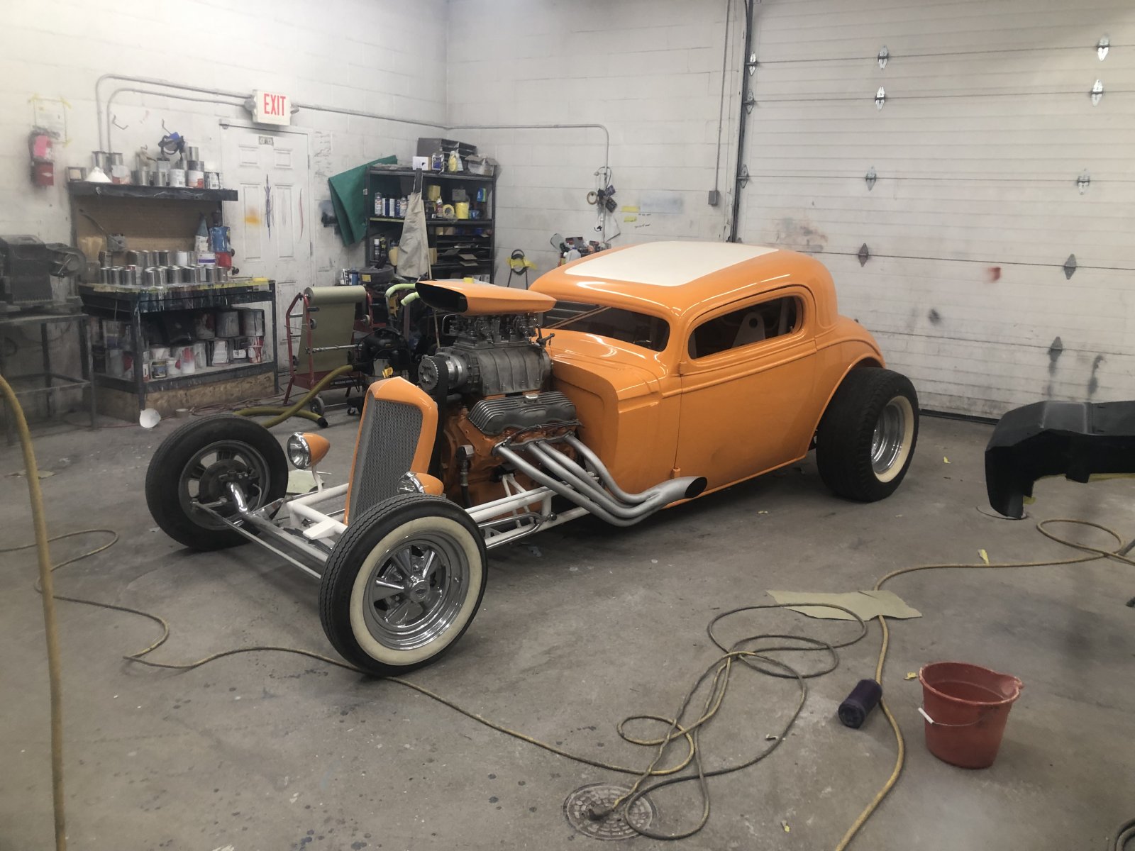

    7821DF32-E8BC-44B5-A03A-3A93859F9A6C.jpeg The show and memorial went well, 200 cars showed up. I asked my kids friend to take pics, he only shot my cars. Oh well, heres a couple of pics, but enough of that, back to work! Theres cars to be built! 2F840EAD-3C46-494E-8D69-092F05D55E2B.jpeg

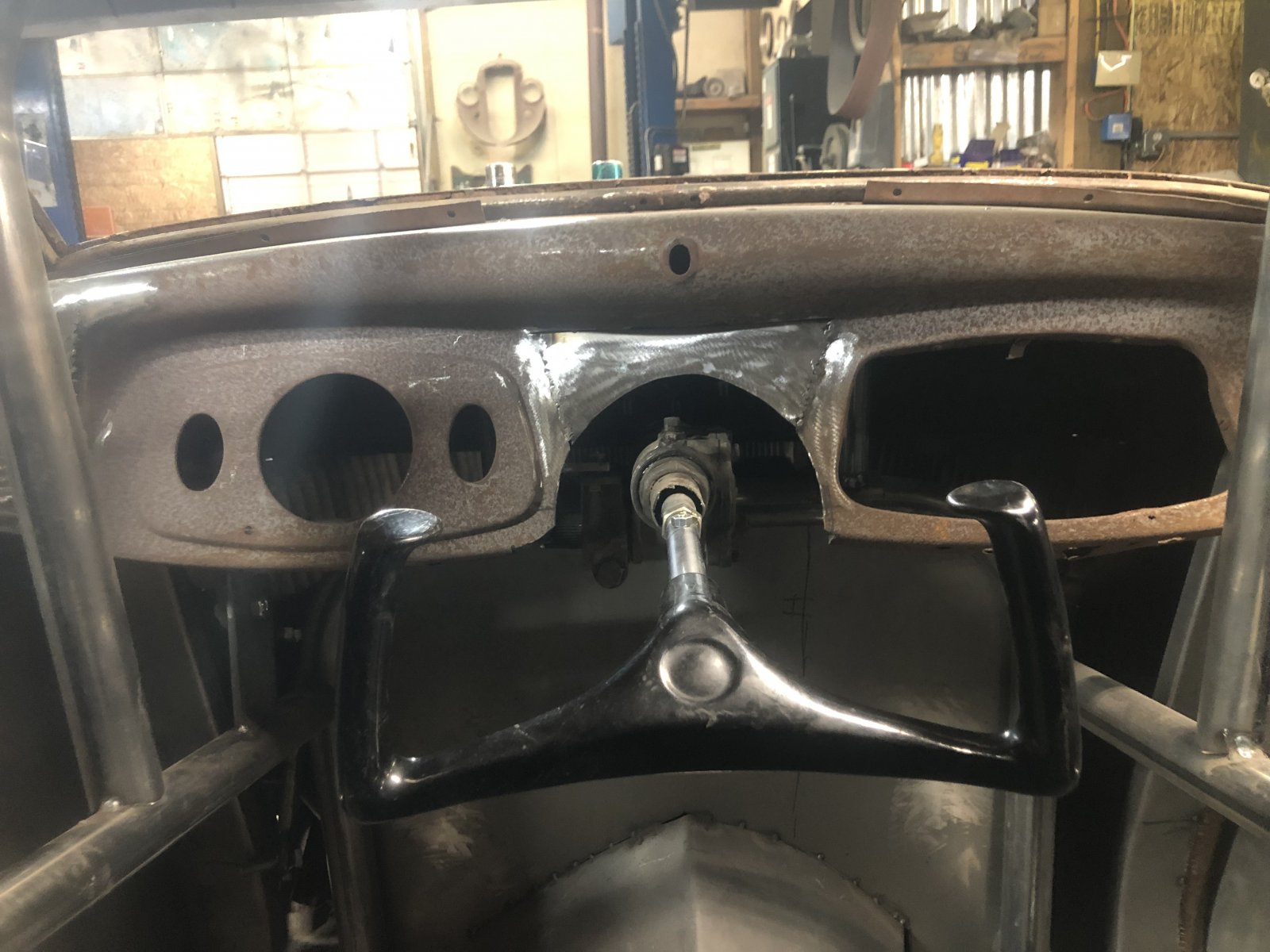

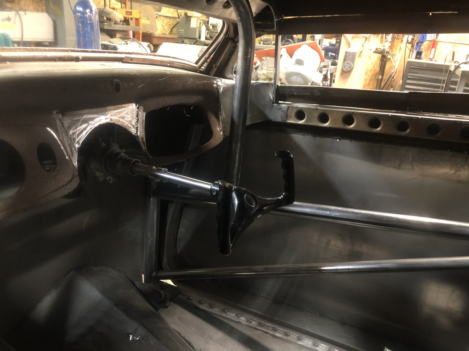

    Early Cessna steering wheel, check! My dad would be so proud FAE66F6C-F17B-4B09-9311-0CFF2025081B.jpeg F1518C39-7315-43BC-8F86-9FA8C832272F.jpeg .

    RodStRace
    Check entering/exiting with that yoke, it looks like 'straddling' it would be painful!

    I can get in and out. Im glad i left the car full width. I am a pretty small guy, that helps.

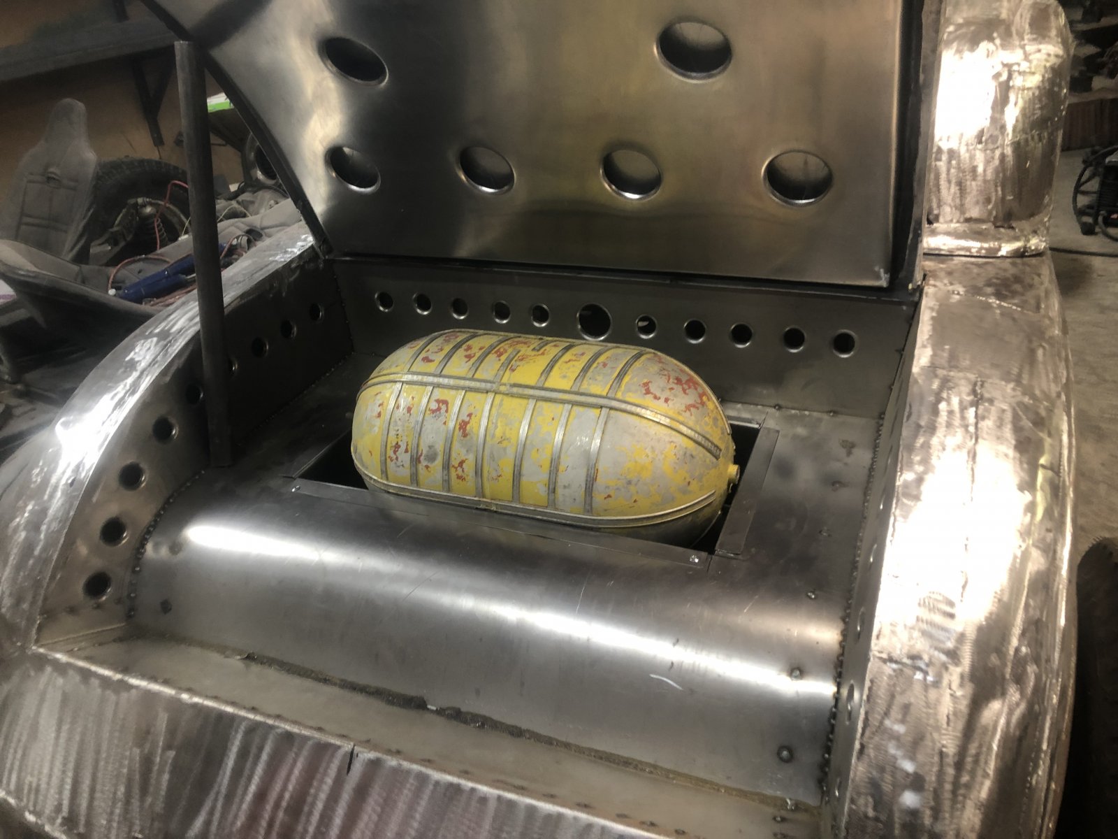

    How about a fuel tank made from a b17 breathable air tank? 7273C437-4788-489B-8ED1-F6FAC98851DC.jpeg
    mad mikey, ClarkH, Stogy and 16 others like this.

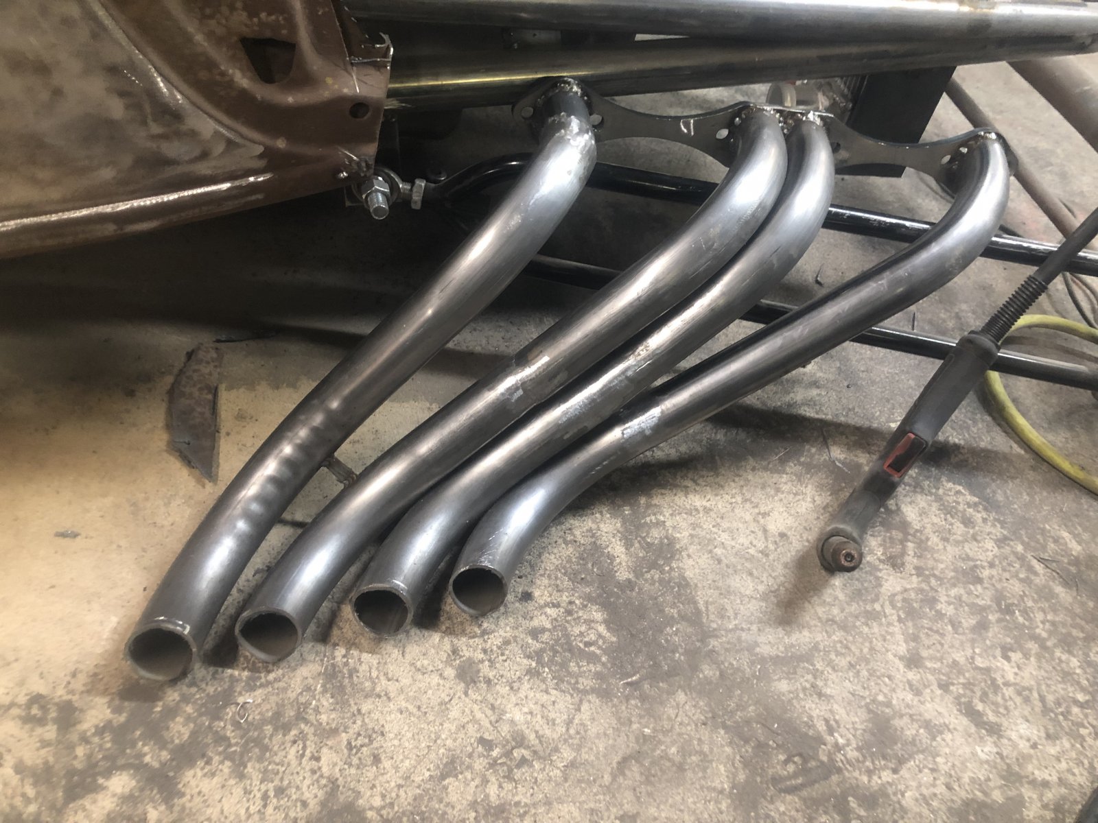

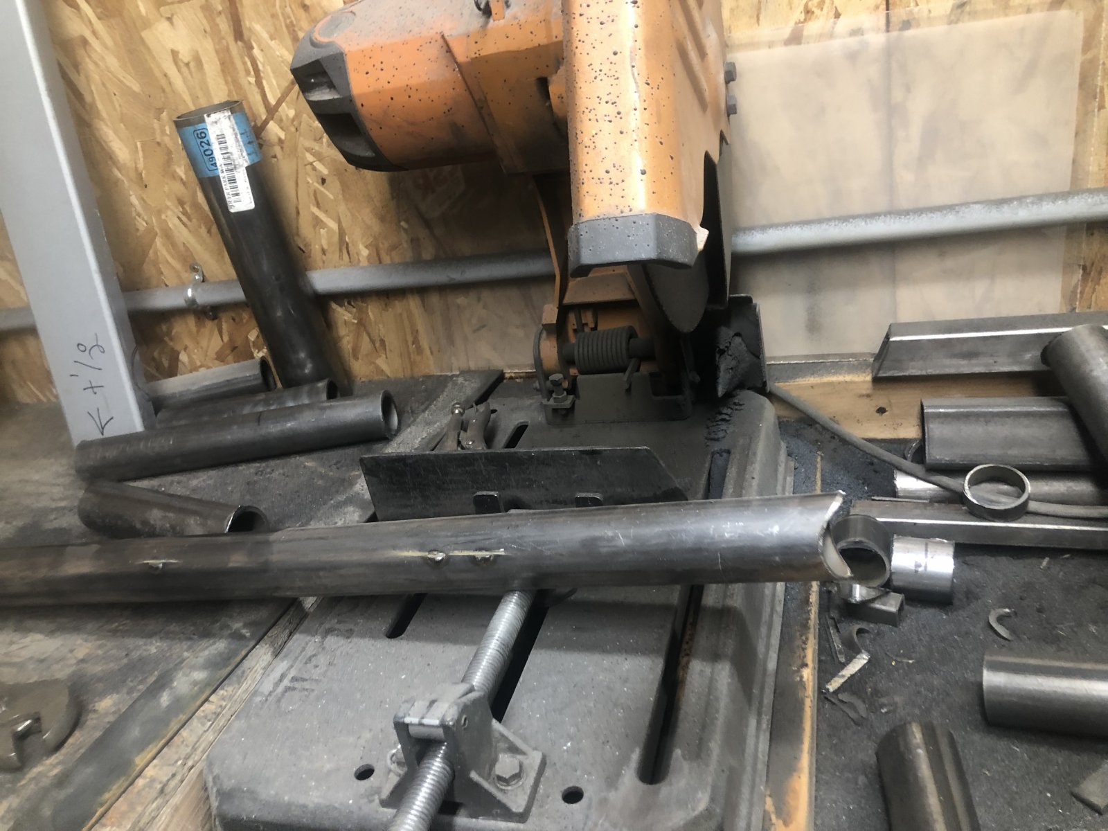

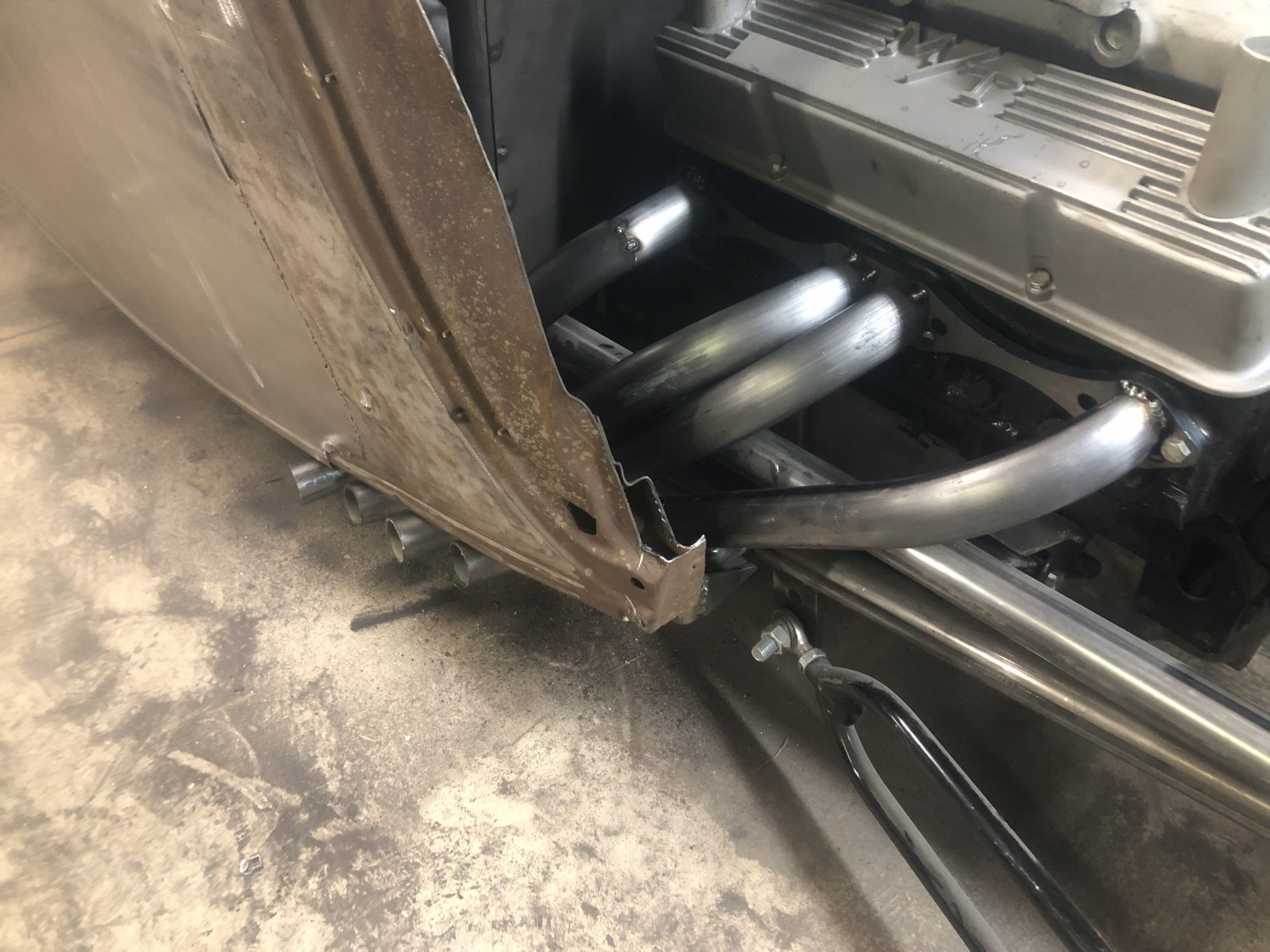

    Updates are slow. I am way busy at work, but today I had enough time to build one side of the headers. Its going to be loud! Keeping with the theme of the build, all of the tubing used on the header was sourced from the original roll cage that i changed out in my austin healey . A little thick for headers, but i had it, so I used it. 75B565CA-7042-422F-9A44-E966B4675AFF.jpeg 69C7ECDB-4593-4A28-87B0-F8BD9E47240D.jpeg 7CF79377-A4B4-4047-952F-B7DBA11A0D99.jpeg 0661B035-8901-4440-A539-D1F011208863.jpeg

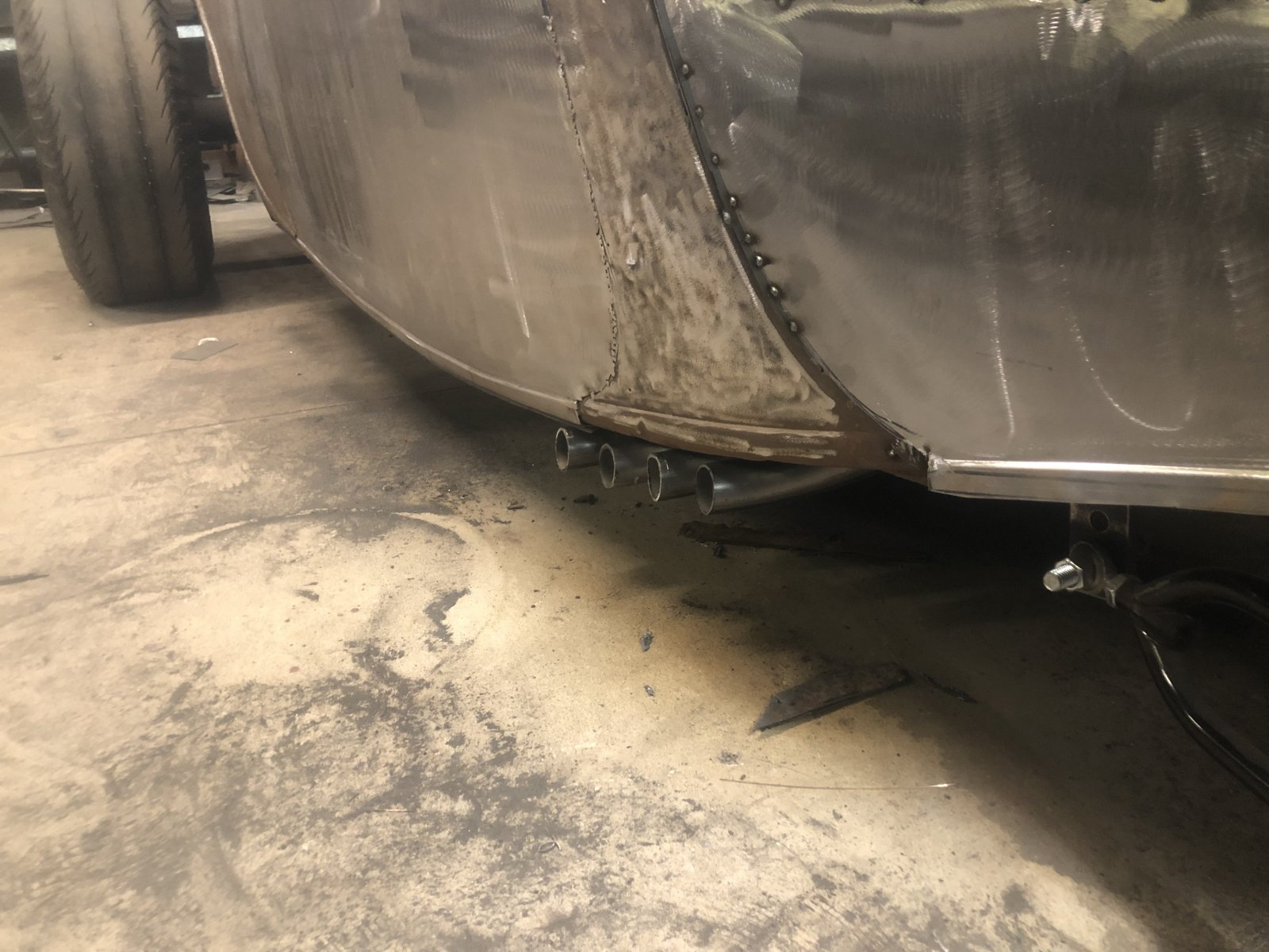

    I really like how the headers look, especially since they were made from s****s and only took a few hours to complete. 8C1BCE34-E182-4C23-ABD1-04C83EA57763.jpeg A4BAE4B9-5320-4D31-A883-A4BF5900EFB8.jpeg

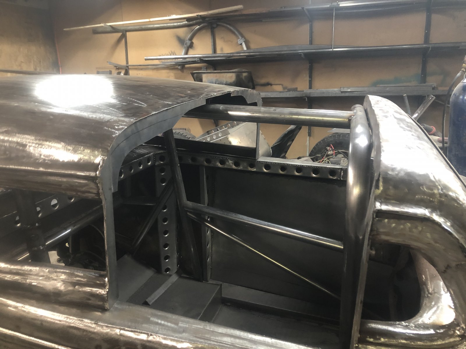

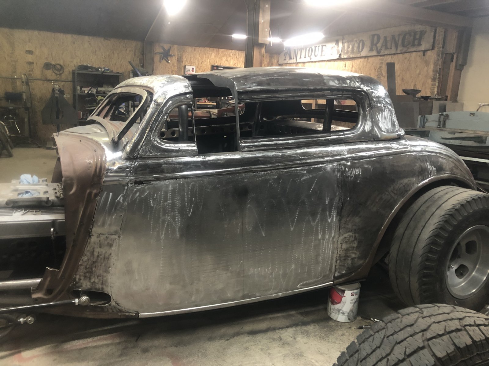

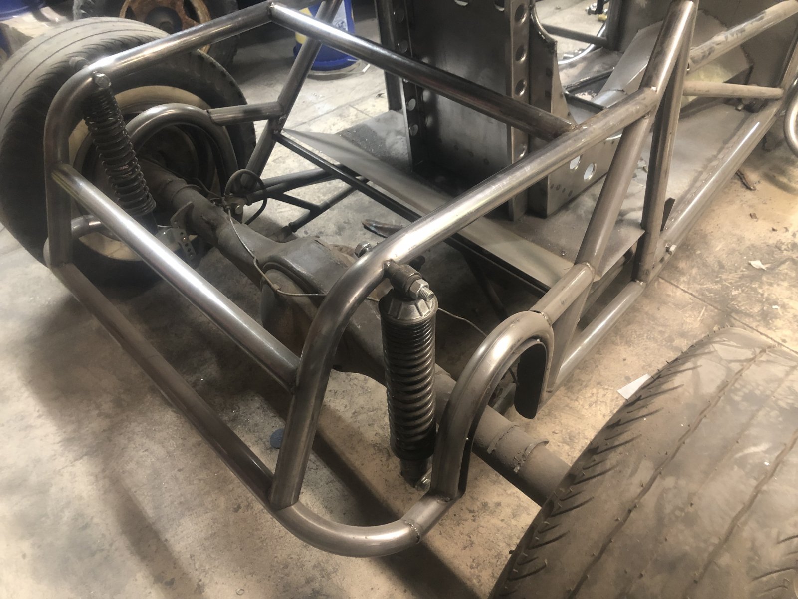

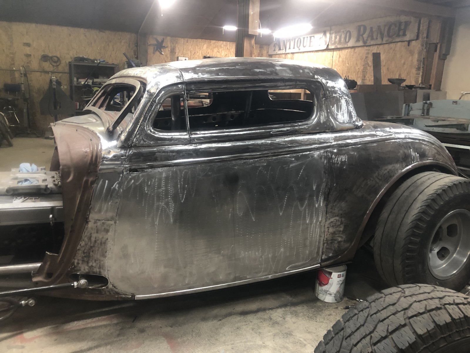

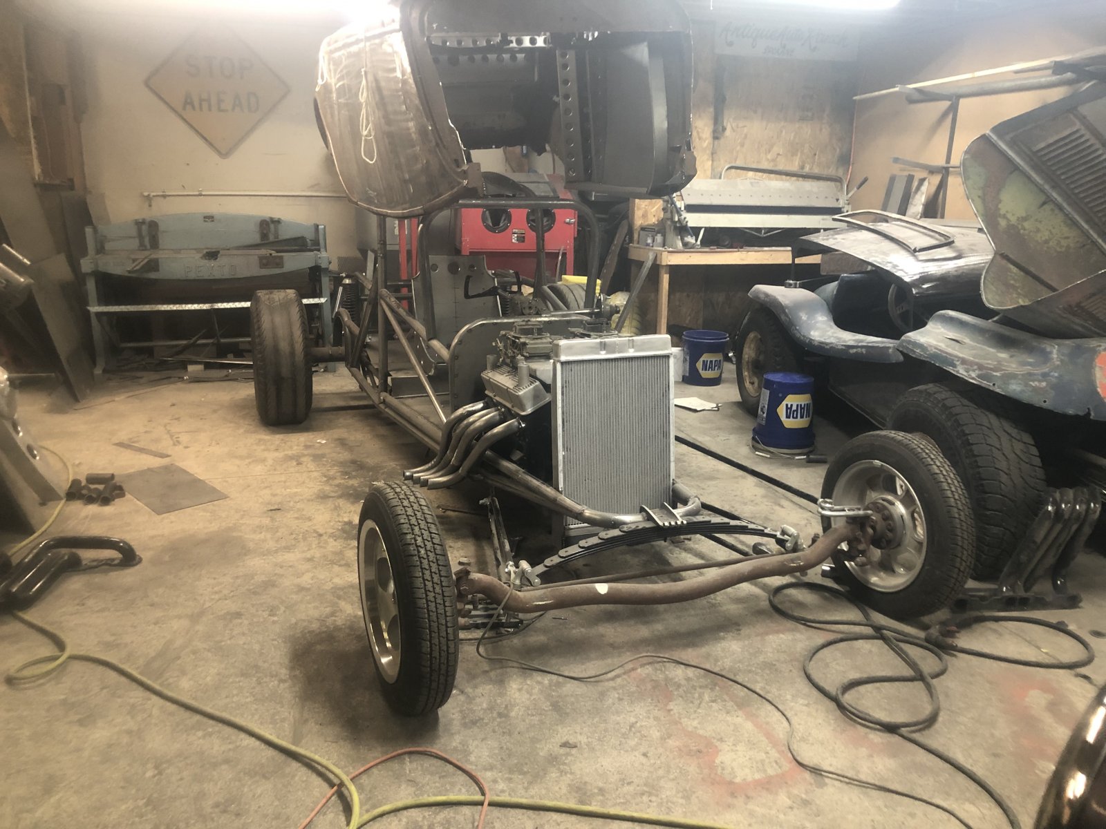

    Just a little update. Got the other header done, pulled the body up, and next comes making it run without its skin. 8E59F83B-C77D-4F53-A4DC-21E112EB2E39.jpeg 6B20D920-EB69-42DF-8761-7991E43ED640.jpeg 72722AF6-1D8D-4DDE-9822-C879F4677BF3.jpeg CF38A80E-2B34-463B-9155-237CCDE42395.jpeg 6D3D0C69-D25F-4E8B-A3D4-240AA4043BDE.jpeg
