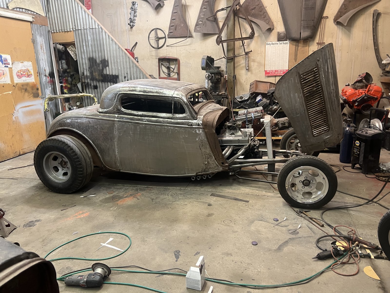

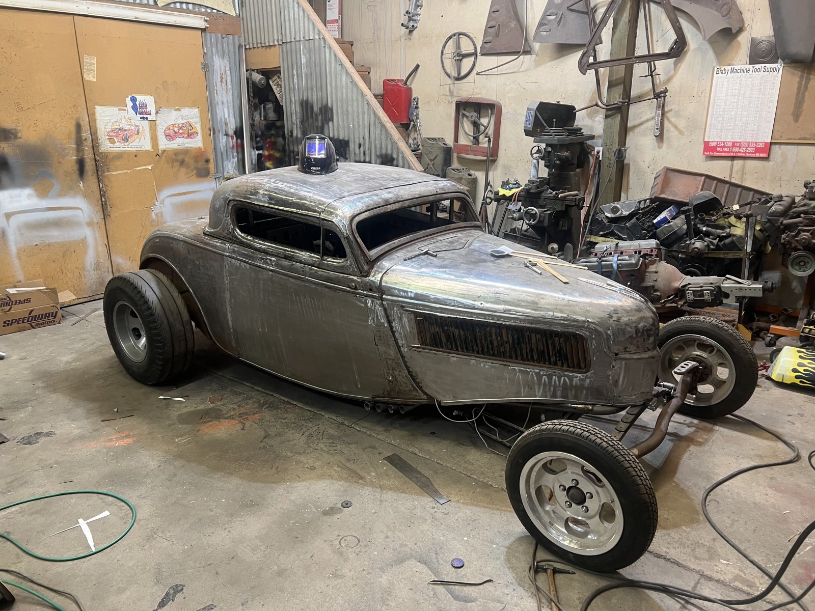

    902432CE-56B7-4D49-8F10-4041B962B871.jpeg 7E18EDE4-1FEC-422B-A840-D2A99A9CF4DD.jpeg F04558CF-25D3-4879-9F0A-80C1C28457C6.jpeg 997780C9-D58E-4C64-90D0-6494F29E196B.jpeg Got the wheel well all in, did a little cleanup on some of the metal work. I really like how it is starting to look more like a real car. I thought this would be a good time to take a few pics in its current state, just for fun. Its turning out much better than i had hoped. Stoked!!!
  12. panhead_pete
    Joined: Feb 22, 2006
    Posts: 3,718
    panhead_pete
    Its not too late to have a Vicky :)
    ottoman, 1biggeorge, Lil'Alb and 8 others like this.
  13. SEAAIRE354
    Joined: Sep 7, 2015
    Posts: 553
    SEAAIRE354
    Maybe make a roof insert that folds down when the roof is back and have a Vicky one day and a coupe the next.
    love this build. Car is looking great. Glad your back on it.

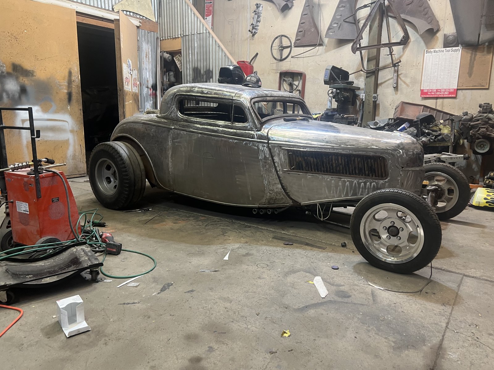

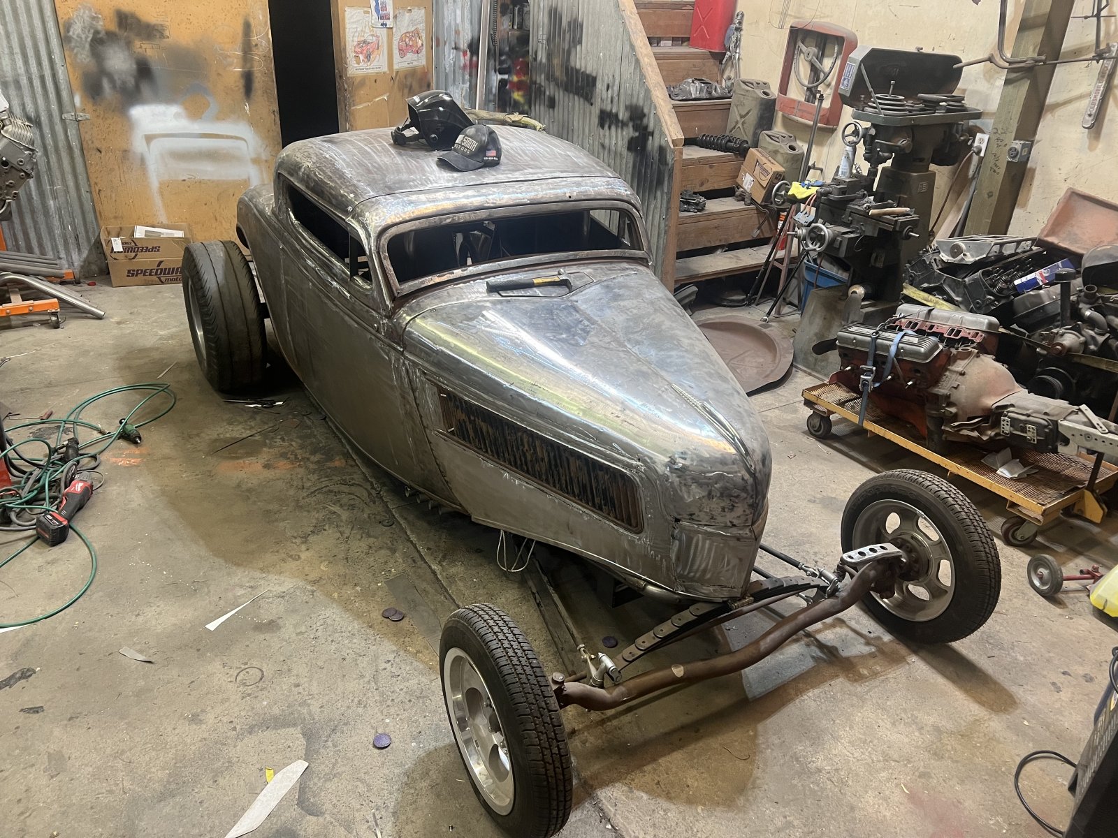

    5E73D27B-C766-4136-83DA-A6E27F14C3FB.jpeg 9C9F163C-25C9-414D-B7F3-9751C334C4CA.jpeg Now is the time where I spend hours and hours fine tuning the body. Its hard to see but, this weekend I put 20 hours into picking and filing, welding and shaping, just to stand back and look at the same car when I was done. Oh well, the roof fits better, and I am slowly edging up on getting to the next step. Heres a few pics anyway, just to make me feel
    Like I did something. View attachment 5539310 View attachment 5539311 View attachment 5539310 View attachment 5539311 View attachment 5539310

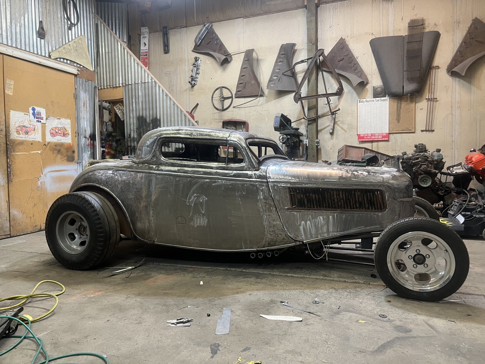

    I got the hood to fit and welded up the little holes in the nose. I am really starting to like this car a lot. B8FB6D76-FB0B-48A0-A63D-A8B6735E072E.jpeg
