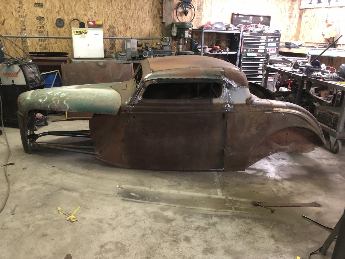

  23. JimSibley
    Joined: Jan 21, 2004
    Posts: 4,072
    JimSibley

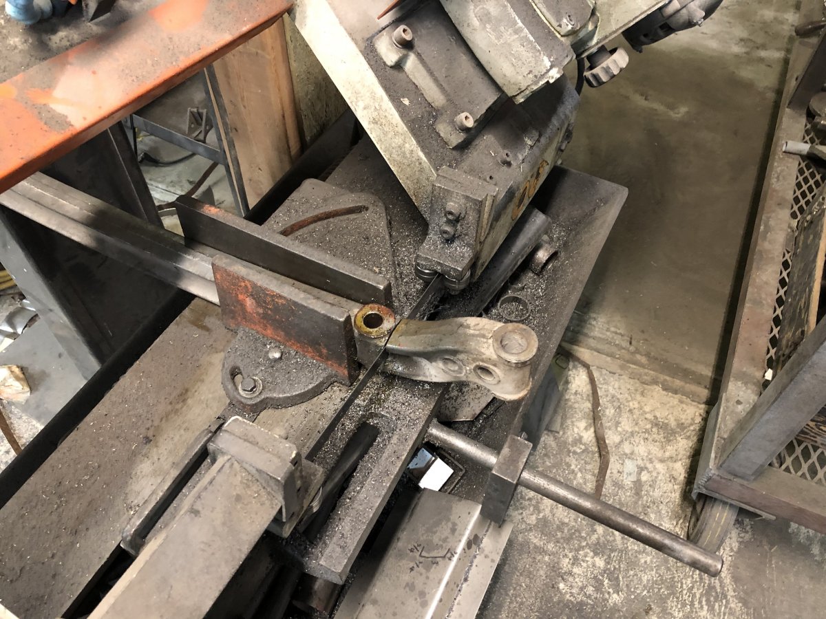

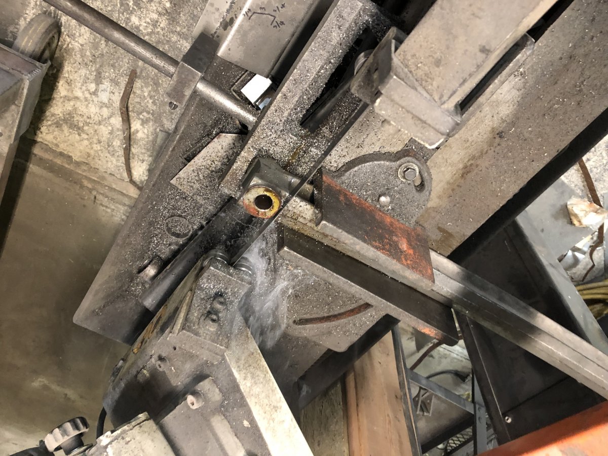

    D5043712-0498-4841-9492-058BBF850643.jpeg 9DF84DC6-D0DE-4848-954B-844BF02A9C74.jpeg 0D341031-5EA3-4495-946D-EB594D19057A.jpeg 4FB6DCC4-3775-4FFB-8561-6DD63457076C.jpeg 6C21F1B5-E828-4CED-B680-F108A3AED01A.jpeg Front end work. Took a bent up 40 ford front axle and cut the spring perch mounts from it, machined them to fit the wavy axle. Tacked them on for now, I’ll heat the axle and weld them hard when I get it all as it should be. A lot of work, but I think the wavy axle has a look that I want and it was all junk, so it fits my build.

  26. Corn Fed
    Joined: May 16, 2002
    Posts: 3,435
    Corn Fed
    Your axle idea is brilliant. I have never seen one done that way. It surely is the best way to get the spring behind the axle that I have seen yet. I have always been nervous of guys simply drilling horizonal holes in the bones and about mounting perches in shear but this totally eliminates that. And its a new way to tackle mating that Mopar axle to a Ford spring. Cool!
  27. JimSibley
    Posts: 4,072
    JimSibley
    Thanks. This is the second one I did like this. The other axle was a tube from an old sprint car that I put under my model a coupe. It worked real well , so I did it the same way on this one. Just need to make sure that your weld is hot, that’s a lot of steel there to melt together., but the original axle is a really nice forging and the tube axle is so thick, I’m real happy with how they come together.
    Outback, loner2, Just Gary and 6 others like this.

  29. studebakerjoe
    Joined: Jul 7, 2015
    Posts: 1,185
    studebakerjoe
    Jim, that really is a great idea. I have a model A axle that a guy cut up with a torch, but the perch holes are fine I couldn't toss it. Now I think I know what to do with it since I have a couple wavy axles. You do realize you've probably raised the prices on 4 door 57 Buicks now don't you.

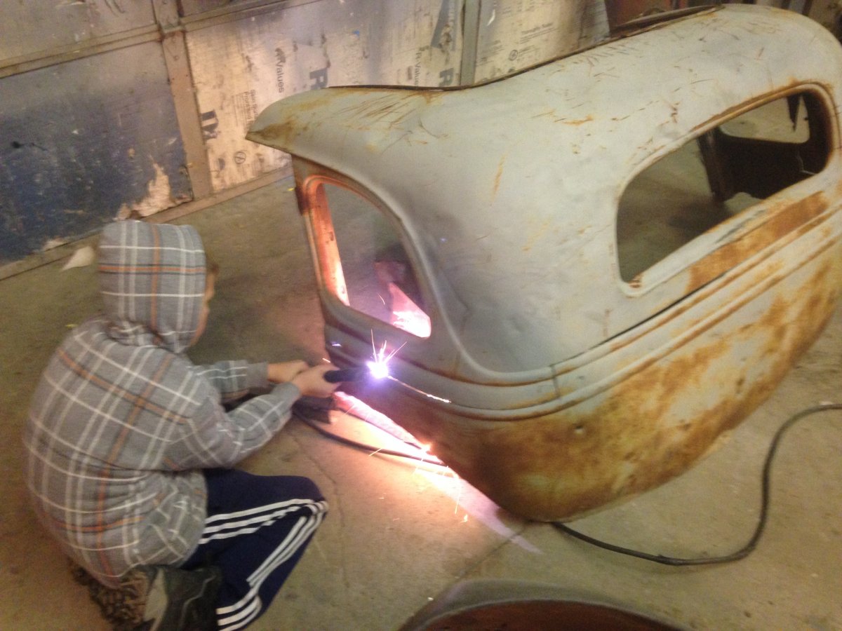

  30. JimSibley
    Posts: 4,072
    JimSibley
    The roof really fit perfectly. I think the curve is even there to repair above the rear window area on a 34 that’s been smashed, I mean it fit that good.
