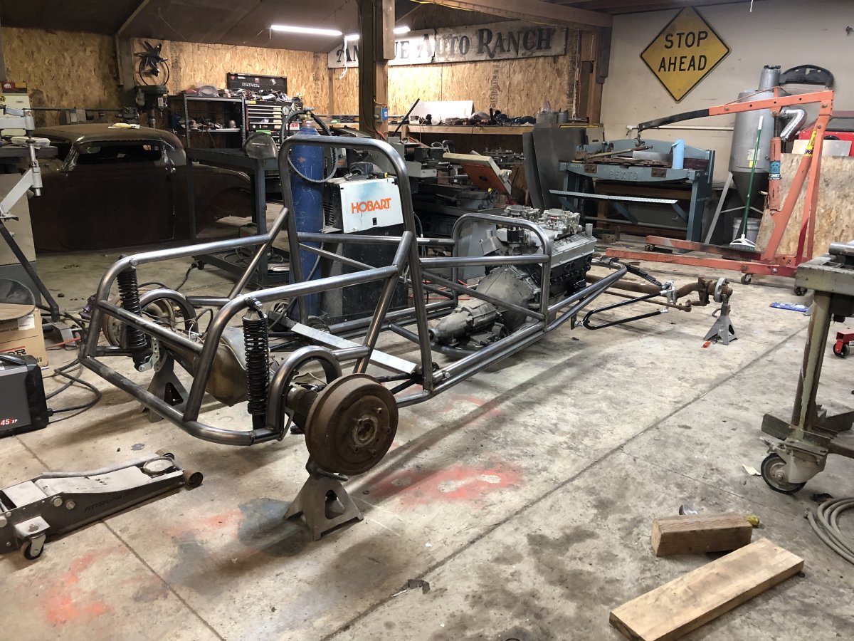

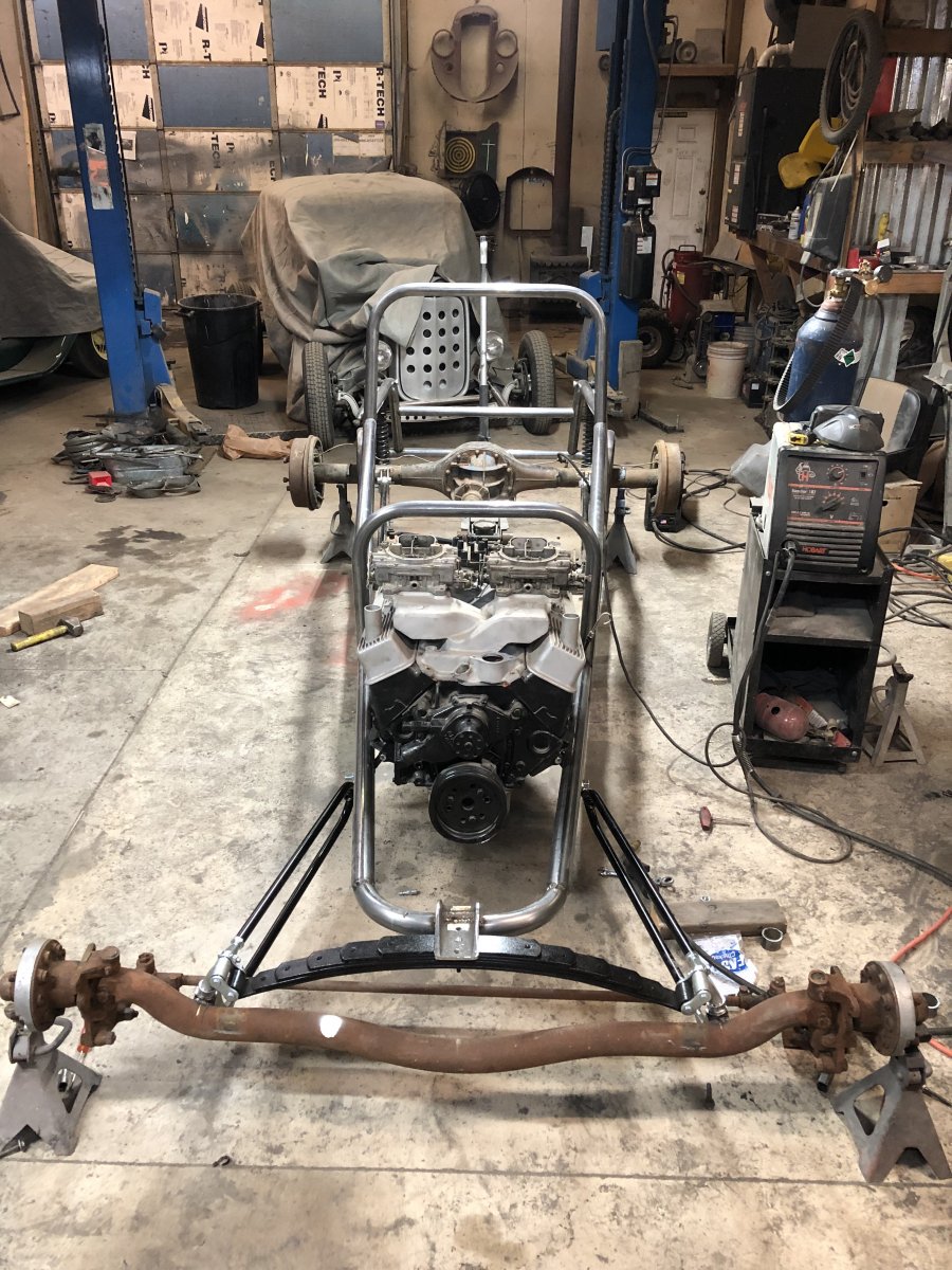

    FA3F94D5-8B96-4E48-9A3D-7CB016B681F9.jpeg 6EEC2FCC-0172-4114-A51F-A20504A9B2B6.jpeg 82379EA6-36FB-4DB1-8440-3FA226B69C07.jpeg A little progress. Mounted the engine, trans and front end. The car is at ride height in the pics, ***uming I run a 29 inch tire in the rear and a 24 inch tire up front. Not a lot of room for the tunnel, but I’m short, it will work.

    Looks Wild Jim, Like Your Eyes...:D...apart from having fun you actually highlight how close we are to what Powers us to the checkered flag...at least the pumpkins behind you...:)
