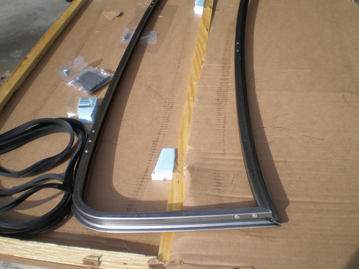

    Then remove the upper hinges and the either separate the windshield regulator from the windshield frame, or remove the dash panel and remove the regulator from the dash. 34 Ford Windshield Hinges.JPG 34 Windshield Regulator.jpg
    Then the windshield and windshield frame will pull away as one unit. Move it to the workbench, and separate the lower part of the windshield frame.

    Those are just pictures I googled to show the steps in order so he can pull the entire windshield frame and work on it on a workbench instead of trying to do all that with the windshield still on the car. I was at the office when I posted the reply, so wasn't able to actually go out and take pictures of my car.
    FWIW, I also had to drill out a couple of the screws on the bottom channel of my windshield frame, then welded them back up, re-drilled, re-tapped that little "L" shaped bracket thingy that holds the pieces of the windshield frame together.
