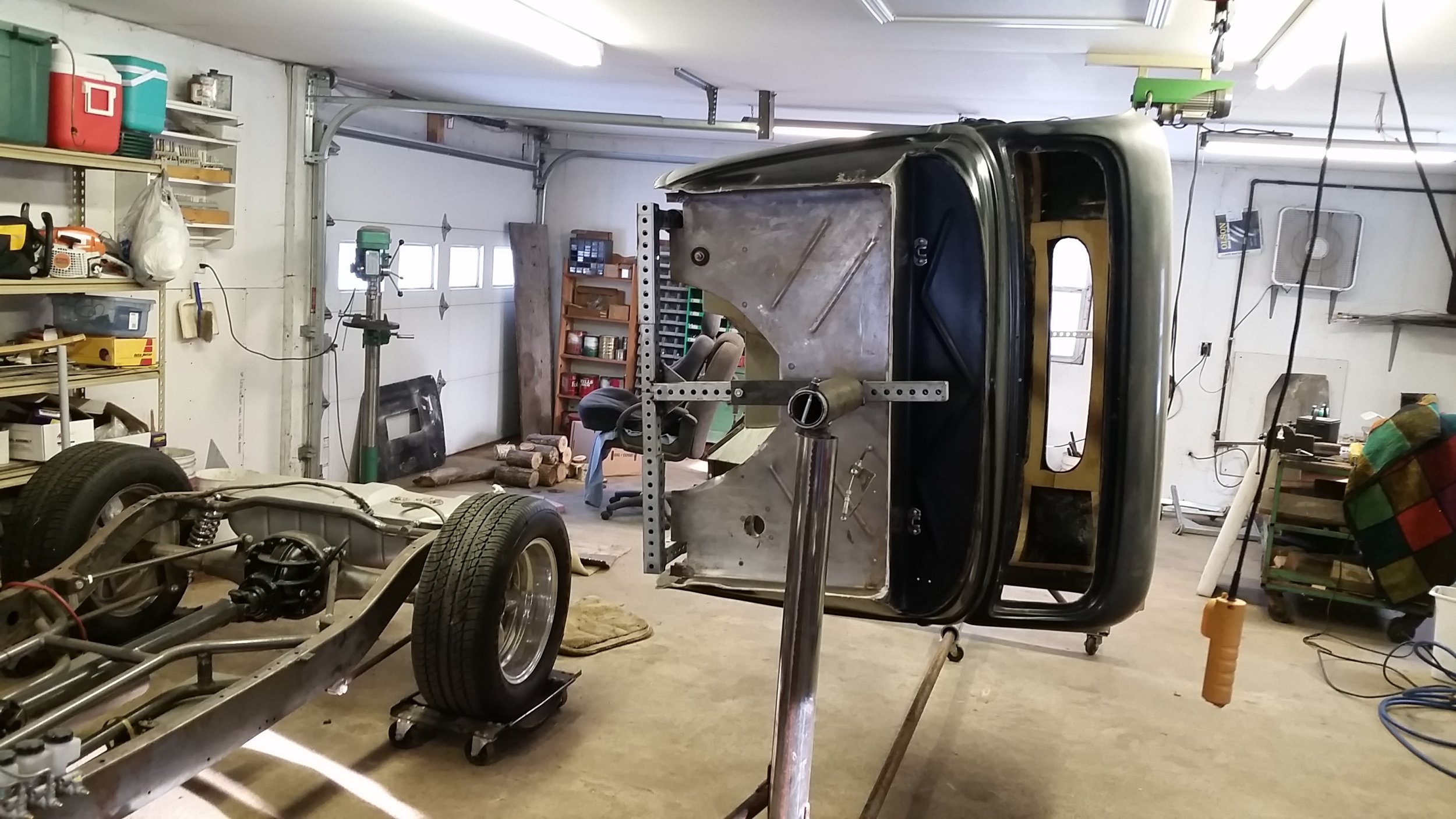

  14. TwistedMetal
    Joined: Nov 2, 2006
    Posts: 185
    TwistedMetal
    from Wisconsin
    I used Lord Fusor bonding agent to bond this steel firewall I built to gl***. At the time the 3M stuff required a special gun. I think the Lord fuser used just a caulk gun. Did this about 8 years ago. Has held up well. no cracks to the bond or paint.
